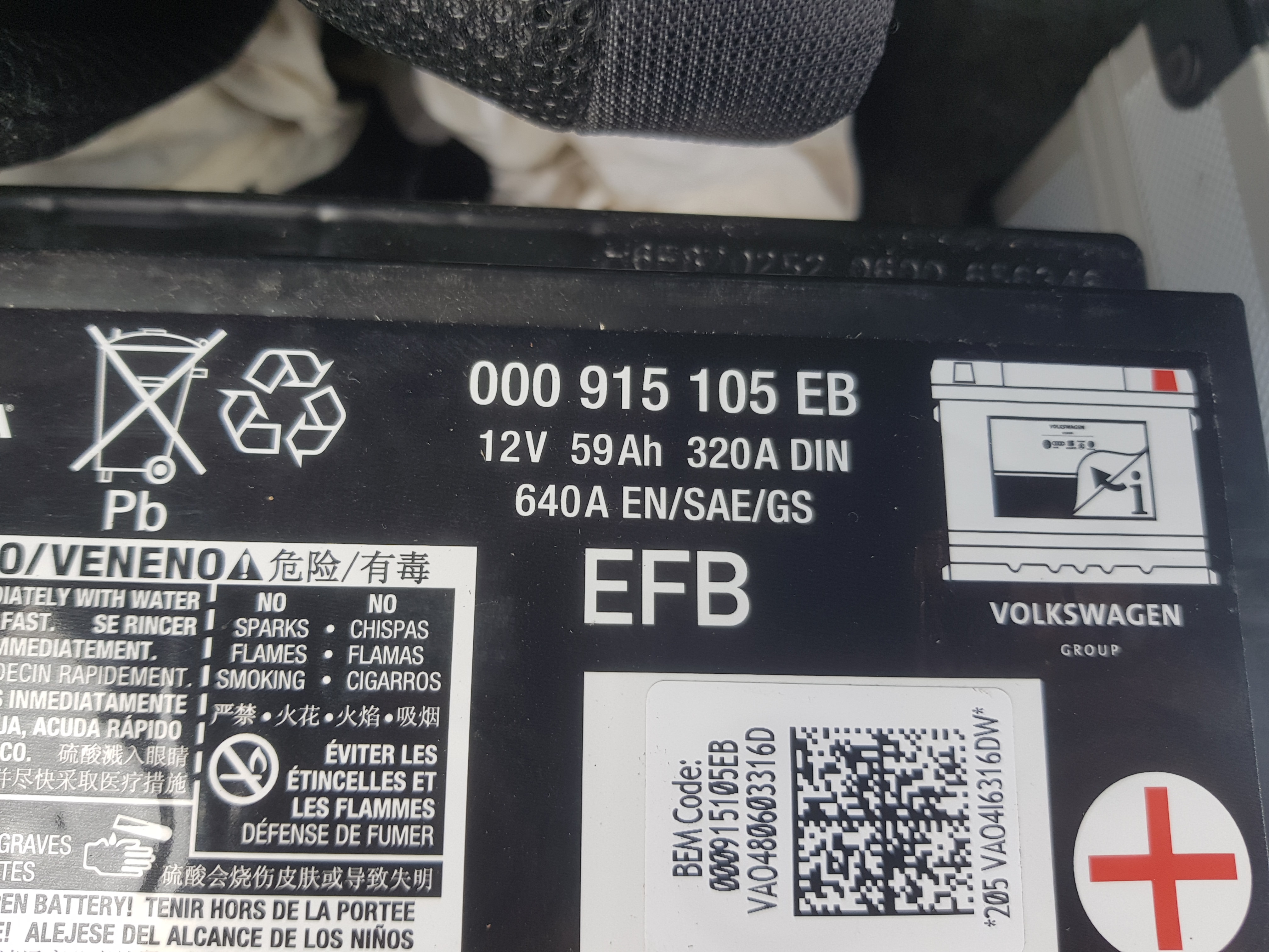

iichel wrote: Wed Feb 07, 2018 8:06 am remember to tell your "61 battery monitor" module that you installed a new battery. I think it's somewhere in adaptation, you'll have to encode the new battery type (same as old) vendor, capacity and a few digits of the S/N.
a trick that a VW employee taught me, since you're probably changing to the same capacity and type, to simply change the last digit. i'm not sure what to think about it. it's clever, but could confuse later on.
Hey iichel, I just installed the new battery, but I can't find the Serial Number :/
VCDS tells me that it needs to be a 10 digit code...
Even when I look at an old vcds log to check on the old battery where the SN is, and I cannot find it haha
Posts: 6685
Re: [ORiOn] VW Polo 6R BlueGT
You can see the full BEM code next to the plus sign. VAO...
ORiOn
Posts: 239
Joined: Thu Sep 18, 2014 9:00 pm
Drives: Polo BlueGT / Audi S5
Location: Switzerland
Post by ORiOn »
iichel wrote: Fri Aug 31, 2018 11:41 am You can see the full BEM code next to the plus sign. VAO...
The BEM code is the part number, then there's a number under it, but it's more than 10 digits...
Even if it was the BEM code, it has 11 digits.
