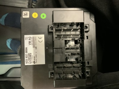

Posted: Thu Apr 30, 2020 9:32 pm
by Robbo770
For info this is my BCM in a 64 plate SEL
