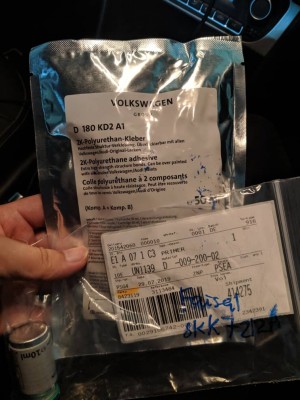

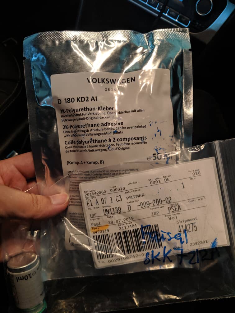

Hi, may i know is the primer you applied resulting the black shade?MaDwArLoCk wrote: Sat May 19, 2018 7:53 pm High Beam Assist
I was following Fernando's manual viewtopic.php?f=56&t=58703&p=503577&hil ... nt#p503577 Thank you!
Necessary parts
Old mirror mounting
I used Firegrafik's stencil
Applied primer
New mirror mounting
Mirror on the place
New rain/light sensor
HBA -ON
And all light indications are ON
To activate Front Fog Light indication is necessary to change Byte in eeprom
Byte 02D4 from 7C to 7E
And Fog light should be connected to BCM or a wire T32a/30![]()

I can't find both original primer and adhesive here in Malaysia.
Do you guys have any recommendations for after market brands with similar performance?

Oh yess, got it! Show you guys when it's done!
