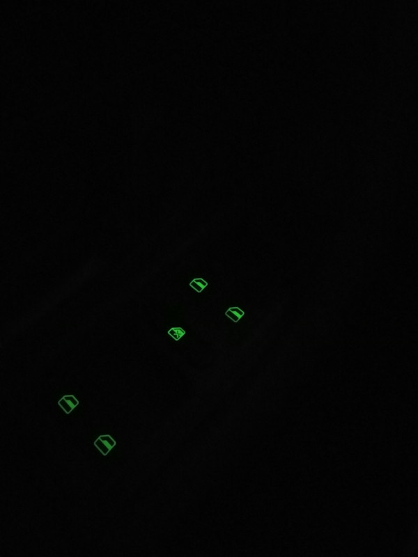

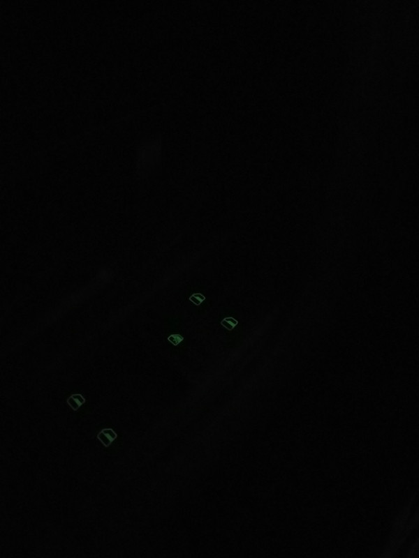

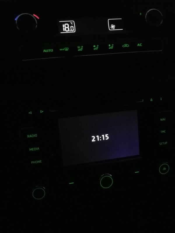

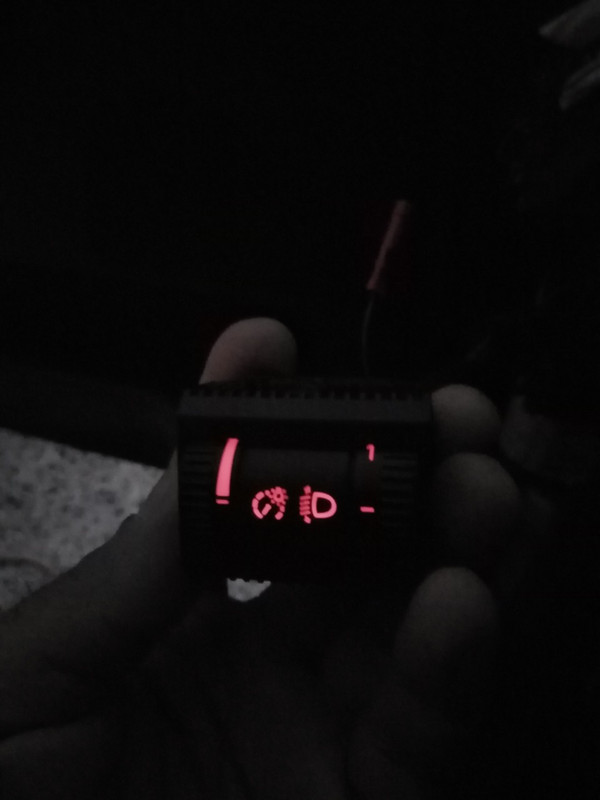

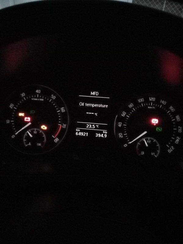

Hello master (Fernando) , polo 6r dimmer works fine with no problems or errors
photos above
photos above

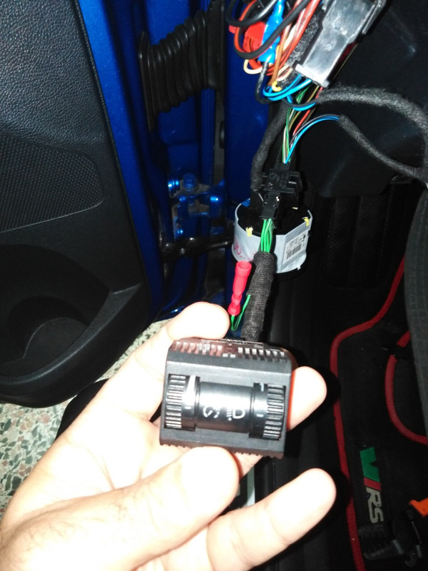

- Posts: 8865
Re: Skoda Fabia VRS 2012. Auto lights retrofit OEM
Perfect!
Have you checked the headlights range regulator?

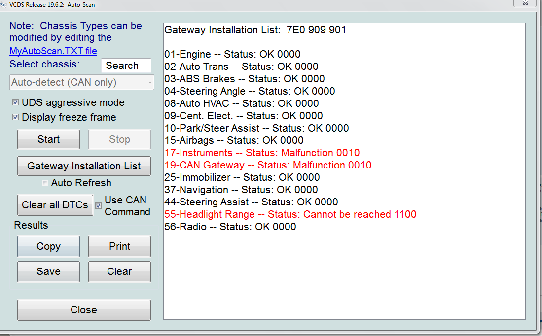

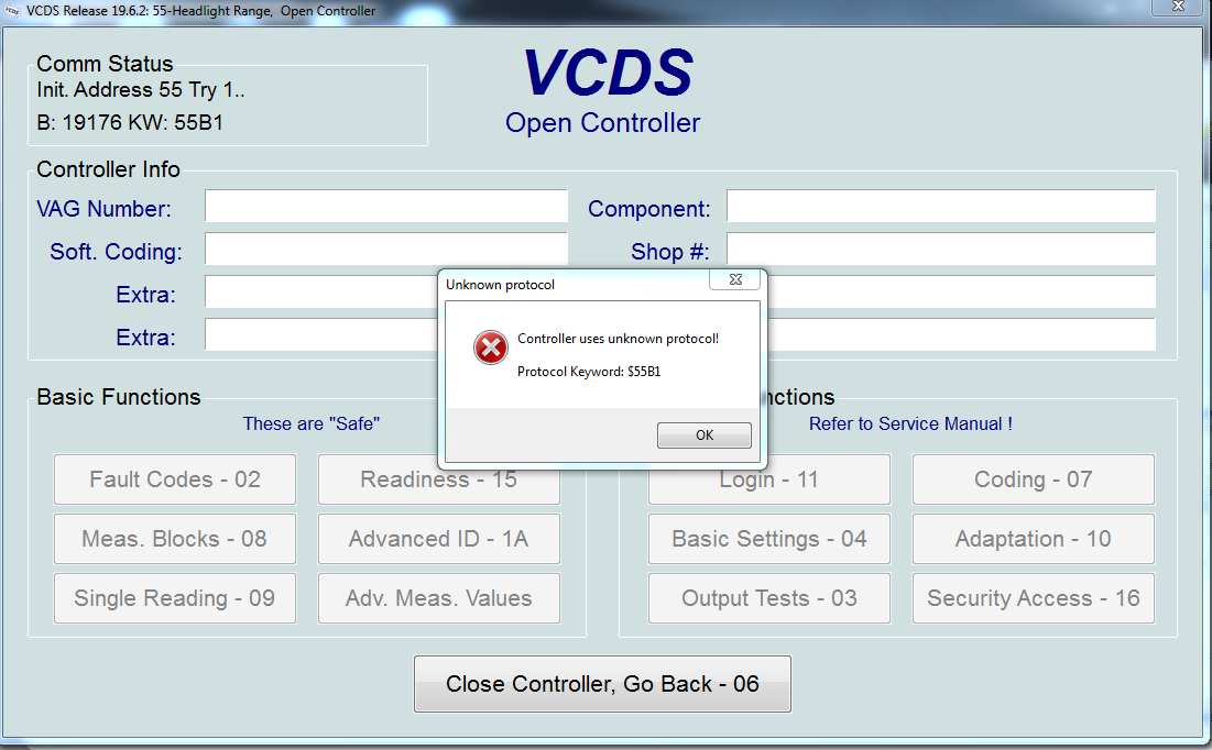

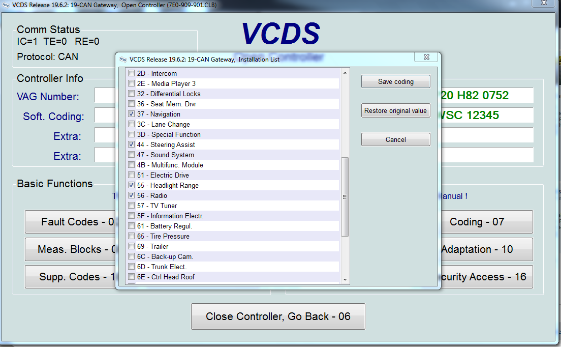

Hello Fernando , your help please with address 55 , autoscan above
Friday,04,October,2019,18:02:17:38567
VCDS Version: 19.6.2.0
Data version: 20190930 DS308.0
www.Ross-Tech.com
Workshop Code: 123 12345 012345
VIN: TMBEP25XXXXXXXXXX License Plate:
Mileage: 65020km-40401mi Repair Order: afs installation
Chassis Type: 5J-SK25 (7E0)
Scan: 01 02 03 04 08 09 10 15 17 19 25 37 44 55 56 0B
VIN: TMBEP25XXXXXXXXXX Mileage: 65020km-40401miles
55-Headlight Range -- Status: Cannot be reached 1100

1 Fault Found:
13639168 - Function Restricted due to Missing Message(s)
U1111 00 [009] - -
Fault Status: 00000001
Fault Priority: 6
Fault Frequency: 1
Reset counter: 228
Mileage: 65020 km
Date: 2019.10.04
Time: 17:58:20
Part No SW: 7E0 909 901 HW: 7E0 937 090 C
Revision: B9082001
Coding: 032204
Shop #: WSC 12345 123 12345
VCID: 68DFE32C9BE57C0F0F-803C
1 Fault Found:
01771 - Control Module for Headlight Range (J431)
004 - No Signal/Communication
Fault Status: 01100100
Fault Priority: 2
Fault Frequency: 1
Reset counter: 228
Mileage: 65020 km
Time Indication: 0
Date: 2014.02.24
Time: 17:57:04

Address 55: Headlight Range
Cannot be reached

1 Fault Found:
U1111 00 [009] - -
Fault Priority: 6
Fault Frequency: 1
Reset counter: 228
Mileage: 65020 km
Date: 2019.10.04
Time: 17:58:20
Revision: B9082001
Coding: 032204
1 Fault Found:
Fault Priority: 2
Fault Frequency: 1
Reset counter: 228
Mileage: 65020 km
Time Indication: 0
Date: 2014.02.24
Time: 17:57:04
Component: IMMO H04 0305
Shop #: WSC 00000 000 00000
ROD: EV_Immo_UDS_VDD_RM09.rod
VCID: 6ADB99248DE94E1F19-803E
Address 37: Navigation (J794) Labels:| 1K0-035-27x-37.clb
Part No SW: 5JA 035 193 E HW: 5JA 035 193 E
Component: RNS315-EU H85 0501
Serial number: SKZAZ2R0659899
Coding: 040000110400000000000000
Shop #: WSC 44700 231 72242
ASAM Dataset: EV_RNS315EUV2UDS 001705
ROD: EV_RNS315EUV2UDS.rod
VCID: 3A7B6964BDC93E9FA9-806E
Data medium:
Subsystem 1 - Part No: 3AA 919 866
Component: EUR_W_V11 0073
Part No: 6R0 423 156 B
Component: LenkhilfeTRW V277
Coding: 11241
Shop #: WSC 13765
VCID: 2F6D4830EA8BEB370E-807A
Cannot be reached
Address 0B: Sec. Air Heating Labels:
VCID: 55A1DAD8AC97F1E7A4-95D0
End-------------------------(Elapsed Time: 02:53)--------------------------
best regards
Vasilis
VASILEIOS1972
- Posts: 182
- Joined: Tue Feb 12, 2019 2:53 pm
- Drives: Polo 6R 1.2 tsi , Skoda Fabia 5J Vrs 1.4
- Location: Greece
is it possible to tell me what to look ?
- Posts: 8865
1. You should have done this check before installing the J745 unit.
2. Have you registered address 55 in the Gateway-address 19 installation list?
VASILEIOS1972
- Posts: 182
- Location: Greece
first of all yesterday headlight regulator works fine
yes I have insert in coding list of gateway address 55
- Posts: 8865
OK.VASILEIOS1972 wrote: Fri Oct 04, 2019 7:20 pm first of all yesterday headlight regulator works fine

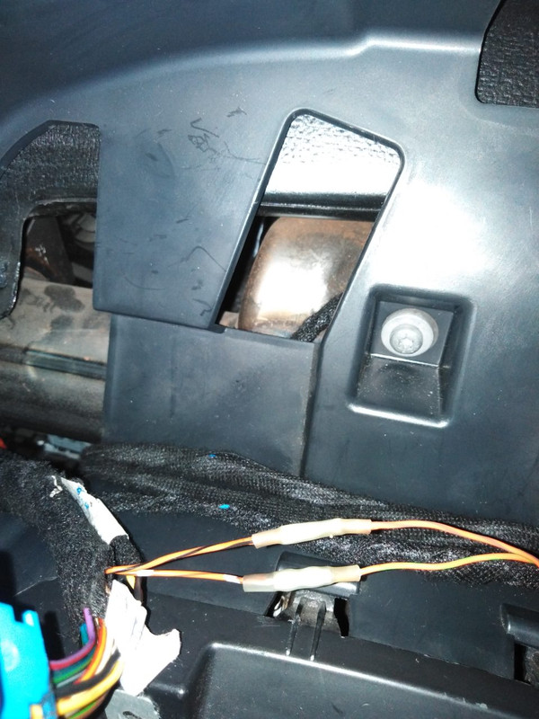

Take pictures of how you connected the CAN lines for the J745 unit, in IC harness (old CAN lines) and T18 connector.
VASILEIOS1972
- Posts: 182
- Location: Greece
VASILEIOS1972
- Posts: 182
- Location: Greece
VASILEIOS1972
- Posts: 182
- Location: Greece
to be sure I have all ready change places for pin 13 and 14 in t18 , but the problems still exist
