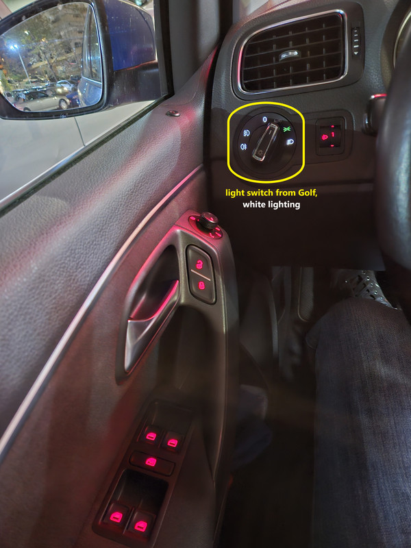

When i retrofit the RLS sensor, i bought a light switch (from Ali) made for Golf.
It fits perfectly and works fine, but..... it has white lighting.
I knew this when I bought it, it was just a really good price. I tried changing the white LEDs to red ones, but the lighting was very weak, even though I expected the opposite (because red LEDs need lower voltage.)
I'm thinking of painting the white LEDs red with special paint from a model shop.
Any other ideas?

just buy a second hand Polo light switch?

This is definitely a safe choice.
I like to experiment and create, as with most DIYs. However, IF I can't do the red color change myself, then I will probably choose to buy a used regular switch.

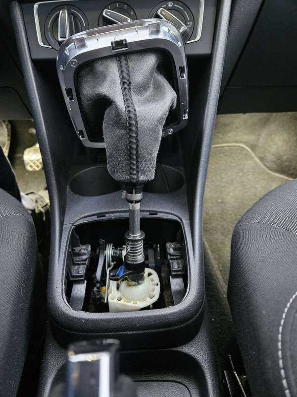

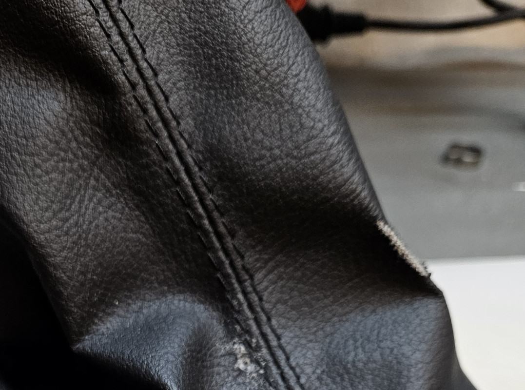

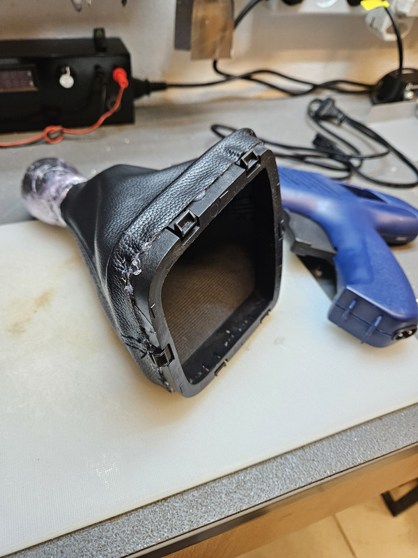

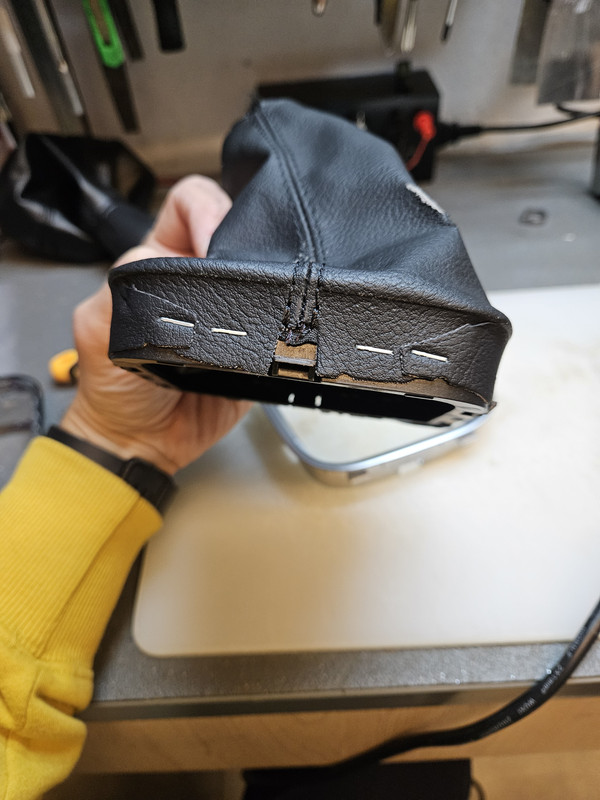

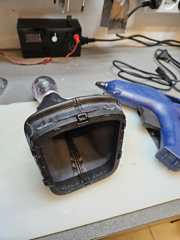

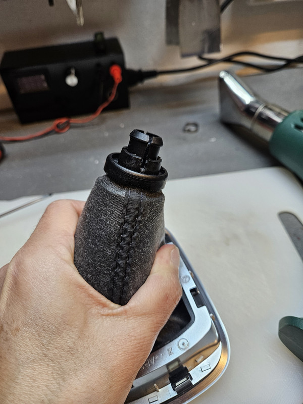

#Gear lever leather
The leather on the gear lever had been worn out for a while. In fact, it had been like this since I bought the car.

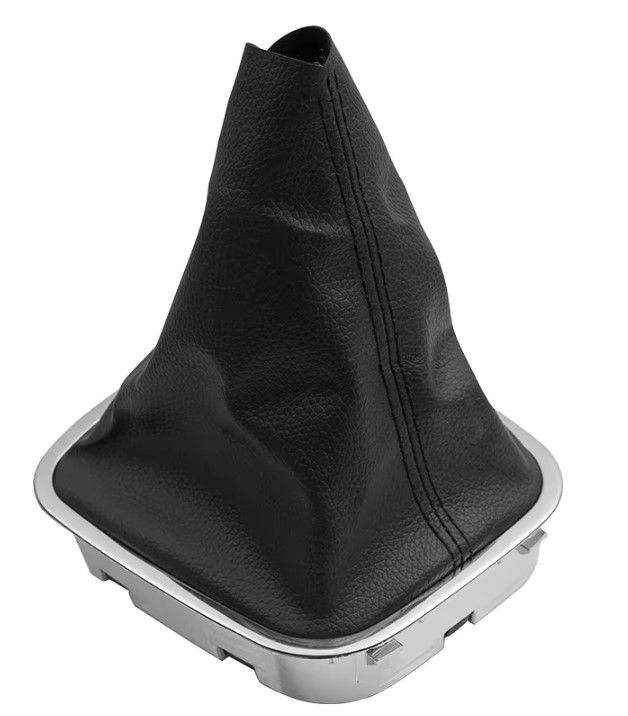

I decided to buy one of these from Aliexpress
I found this for 7 euros.
The change happened today within about an hour.

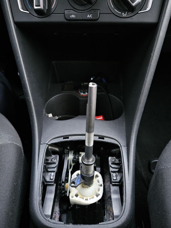

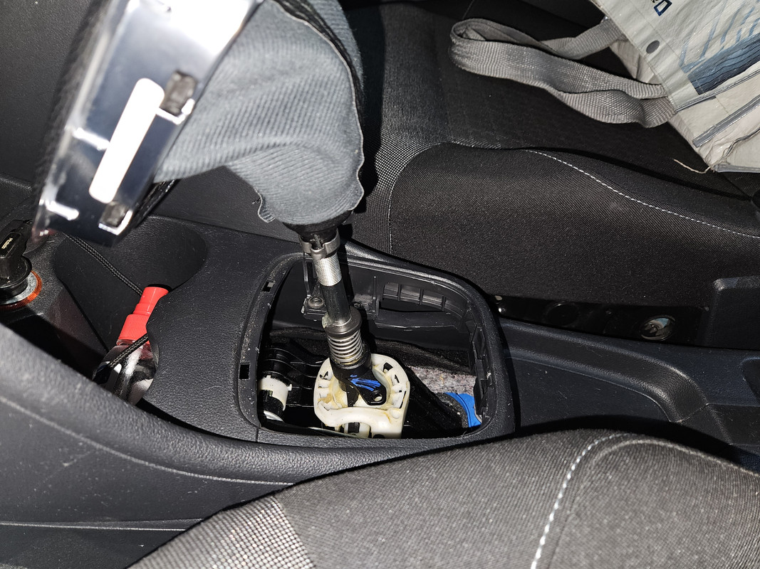

Removing the lever.

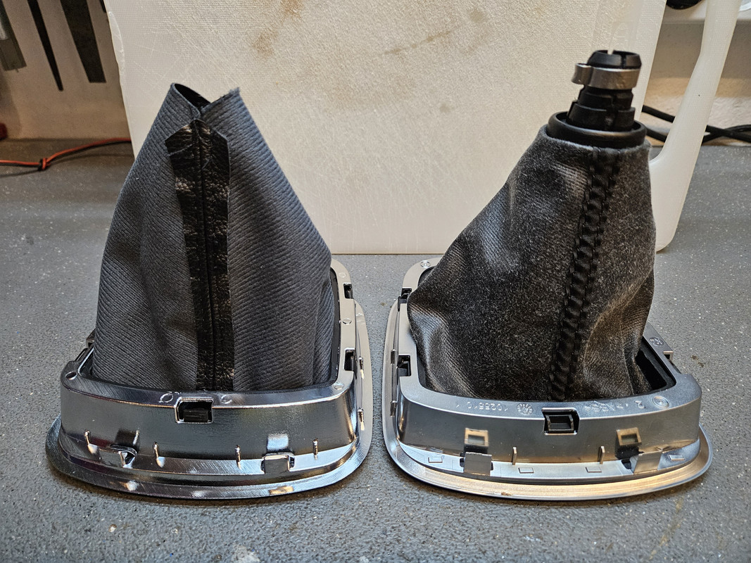

On the left is the new one from China, on the right is the old one.

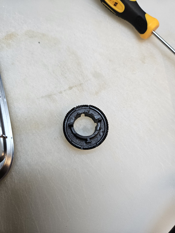

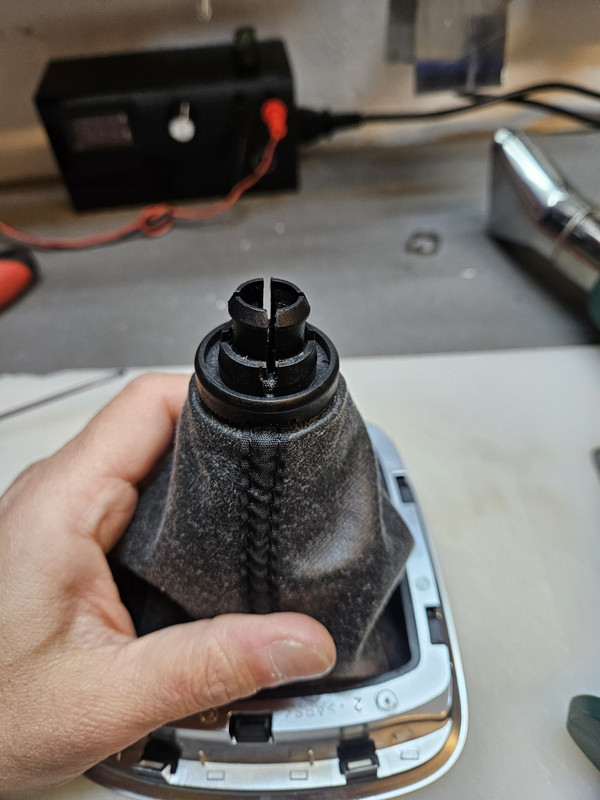

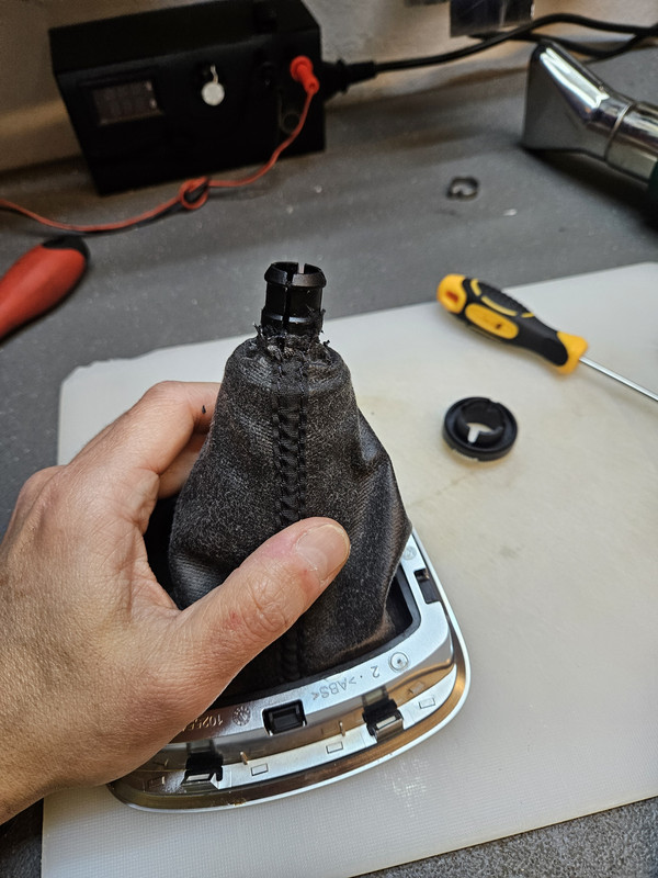

Removing the button

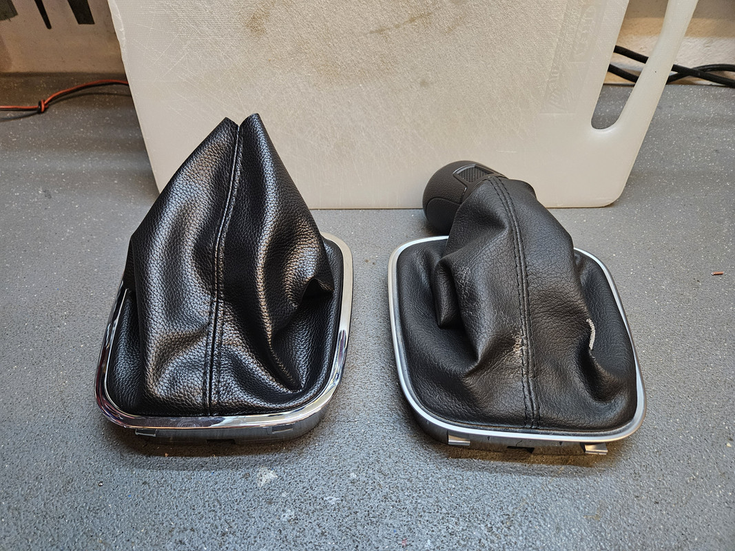

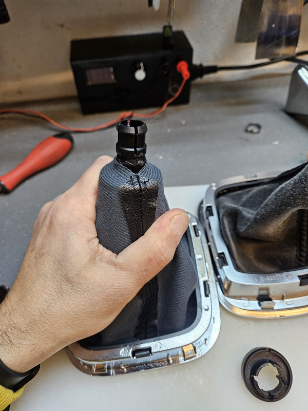

Placing the new leather

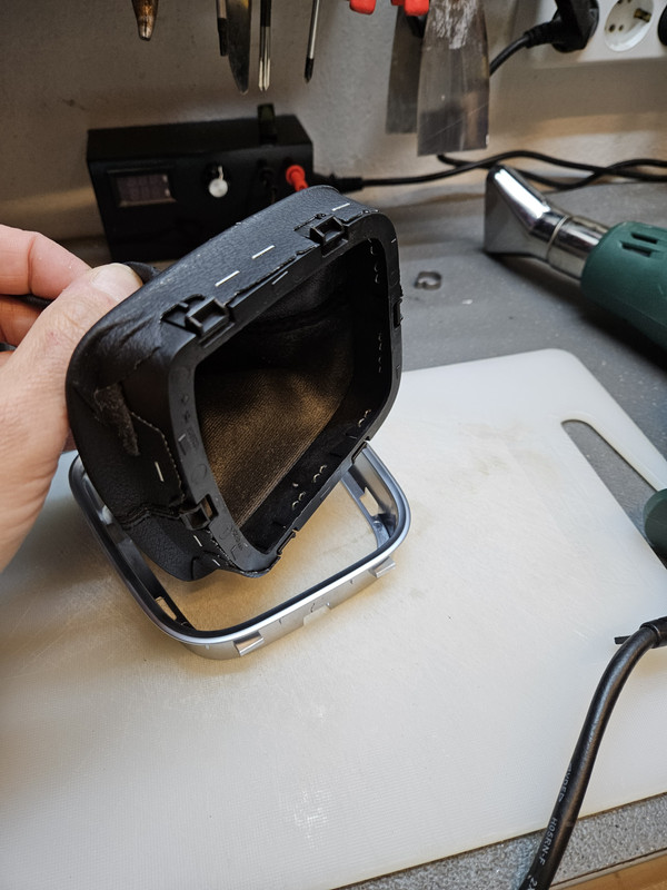

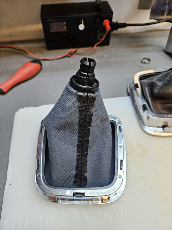

I could have placed it like this, but I preferred to use the original base, I liked the color of the nickel better.
So I removed the bases and adapted the old base with the new leather.

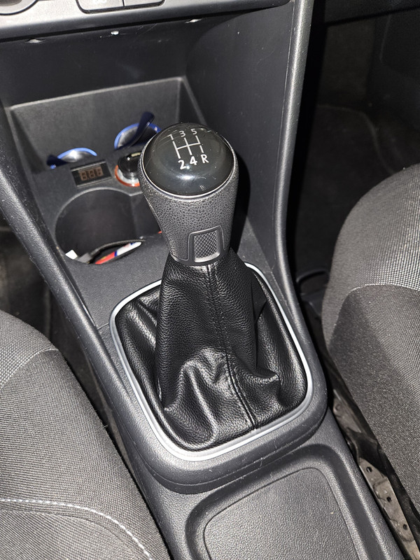

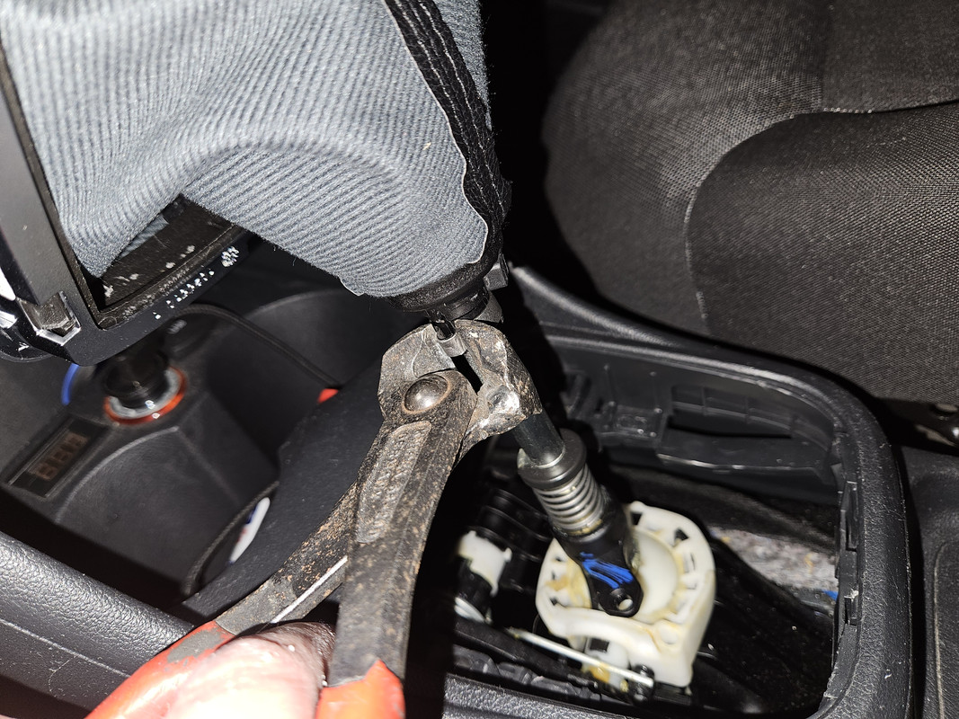

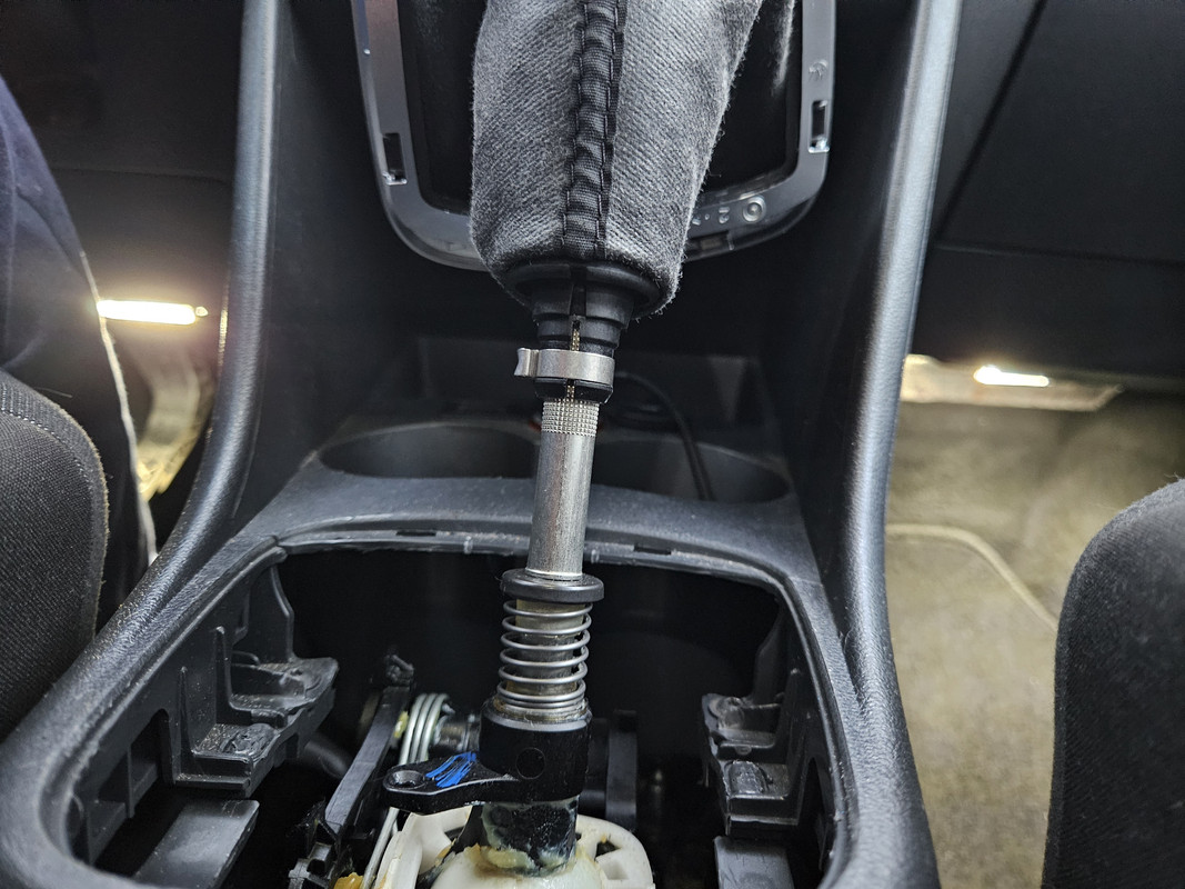

Place in place, tighten the clamp and you're done.

Don't experiment here... No means No. :lol:
5G0941431AF ... AUTO, F&R fogs, red backlights, etc.
It is available on Ali and Autodoc at prices for all budgets.
https://www.aliexpress.com/item/3305100 ... ry_from%3A
POLO 6C (10-pin red connector).

Yep,
this is also an alternative. Right now the switch I have is working fine, so I'm in no hurry to replace it.

what is part number of light switch with led backlight which is similar to 6RD941431A? :idea:

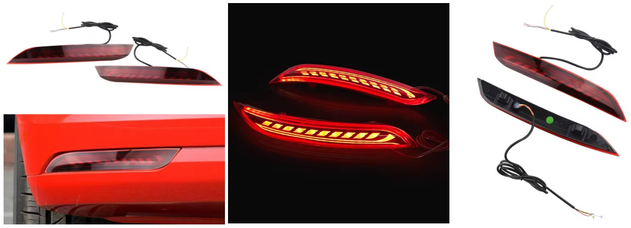

Hello,
I bought a pair of these lights 3 months ago that replace the rear bumper reflectors. From the well-known Chinese store.
https://www.aliexpress.com/item/1005006 ... 180275C9tP
They piqued my curiosity when I saw them on the internet and bought them. I haven't decided yet whether I want to put them on or not. My concern is that the red reflective elements are also a safety feature and I wouldn't want to cancel them. On the other hand, these lights look very nice and can be connected in 3 ways. Either as a running light, or as a brake light, or as a dynamic turn signal, or of course in any combination of these three.
What is your opinion ?
