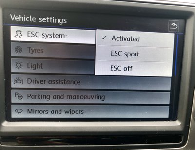

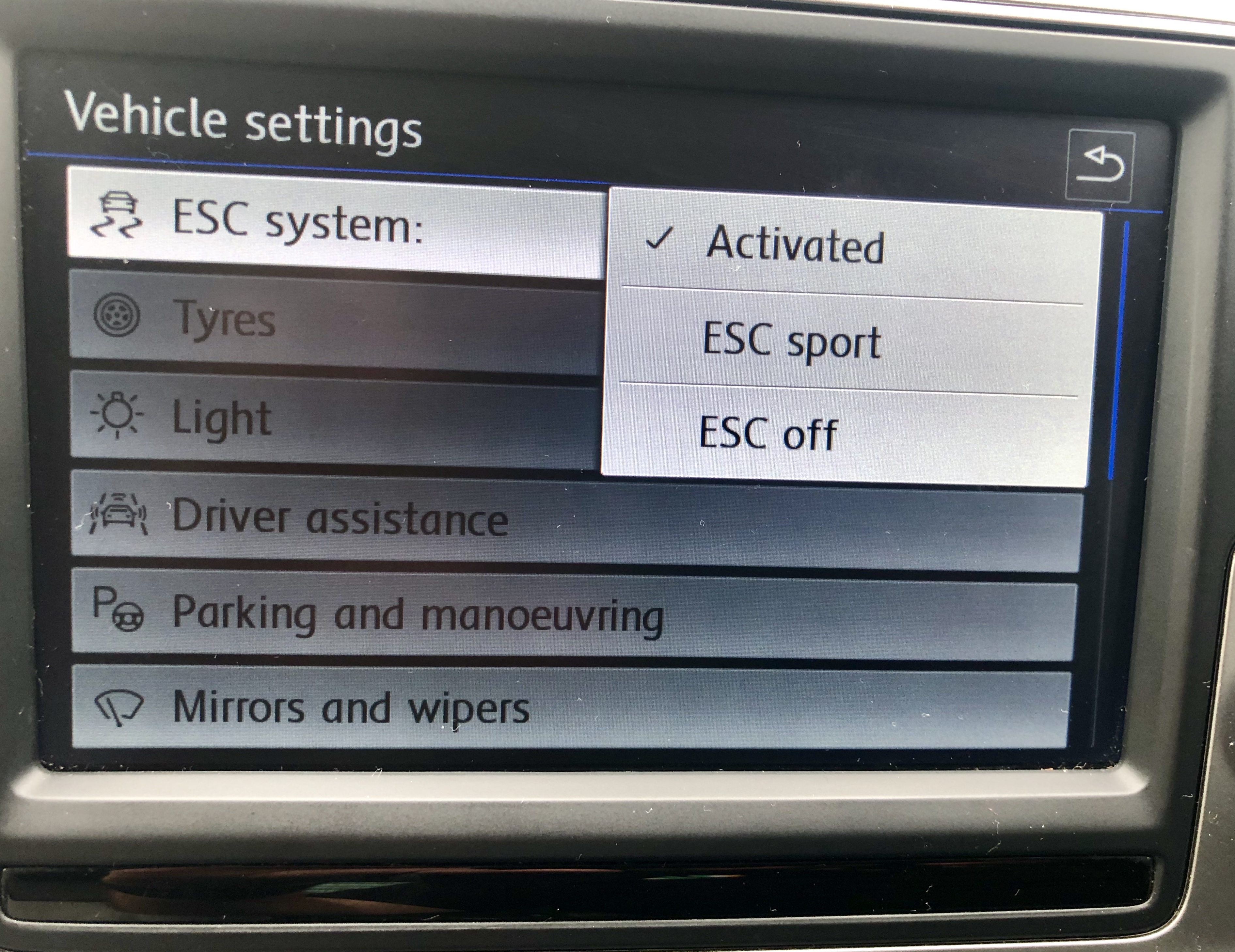

Polo 6R ABS CODING
miky396
- Posts: 21
- Joined: Tue Feb 05, 2019 10:46 pm
- Drives: 6c 2014 1.2 tsi 66kw
- Location: Romania
Re: Polo 6R ABS CODING
Yea of course, on friday i will post this for you, thank u veru much!
miky396
- Posts: 21
- Location: Romania

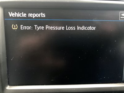

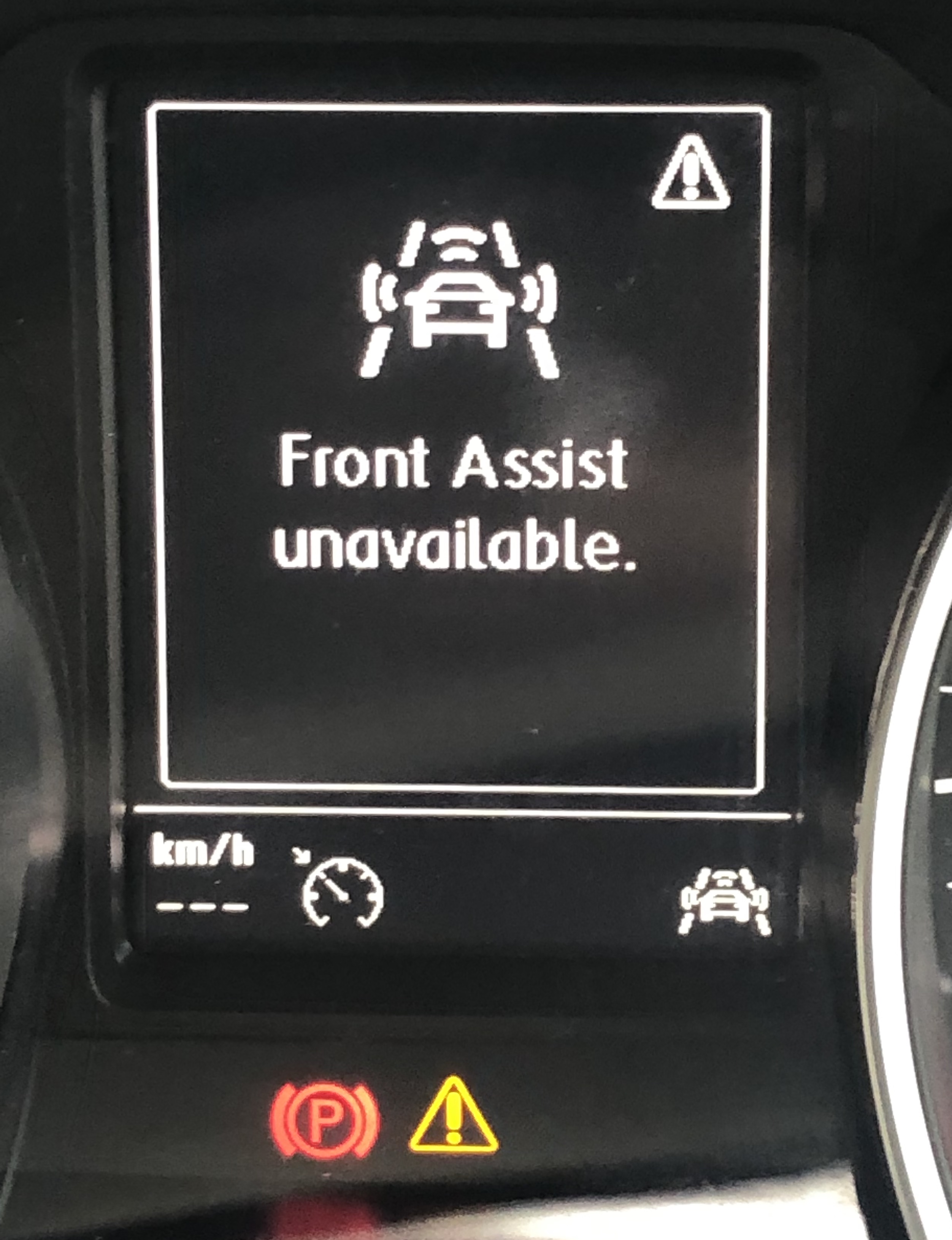

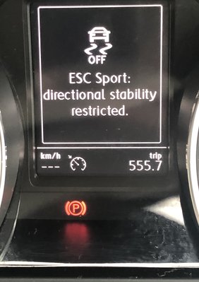

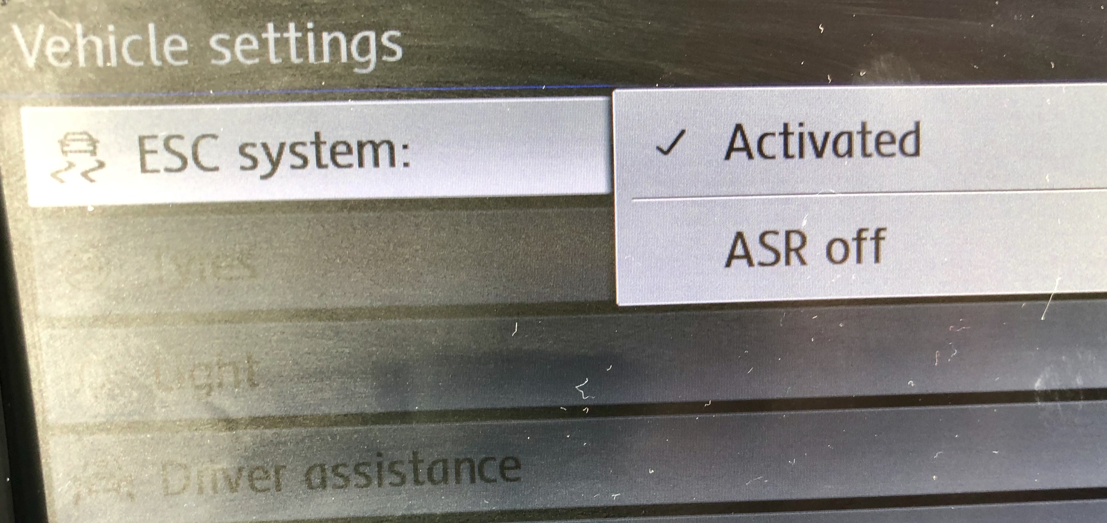

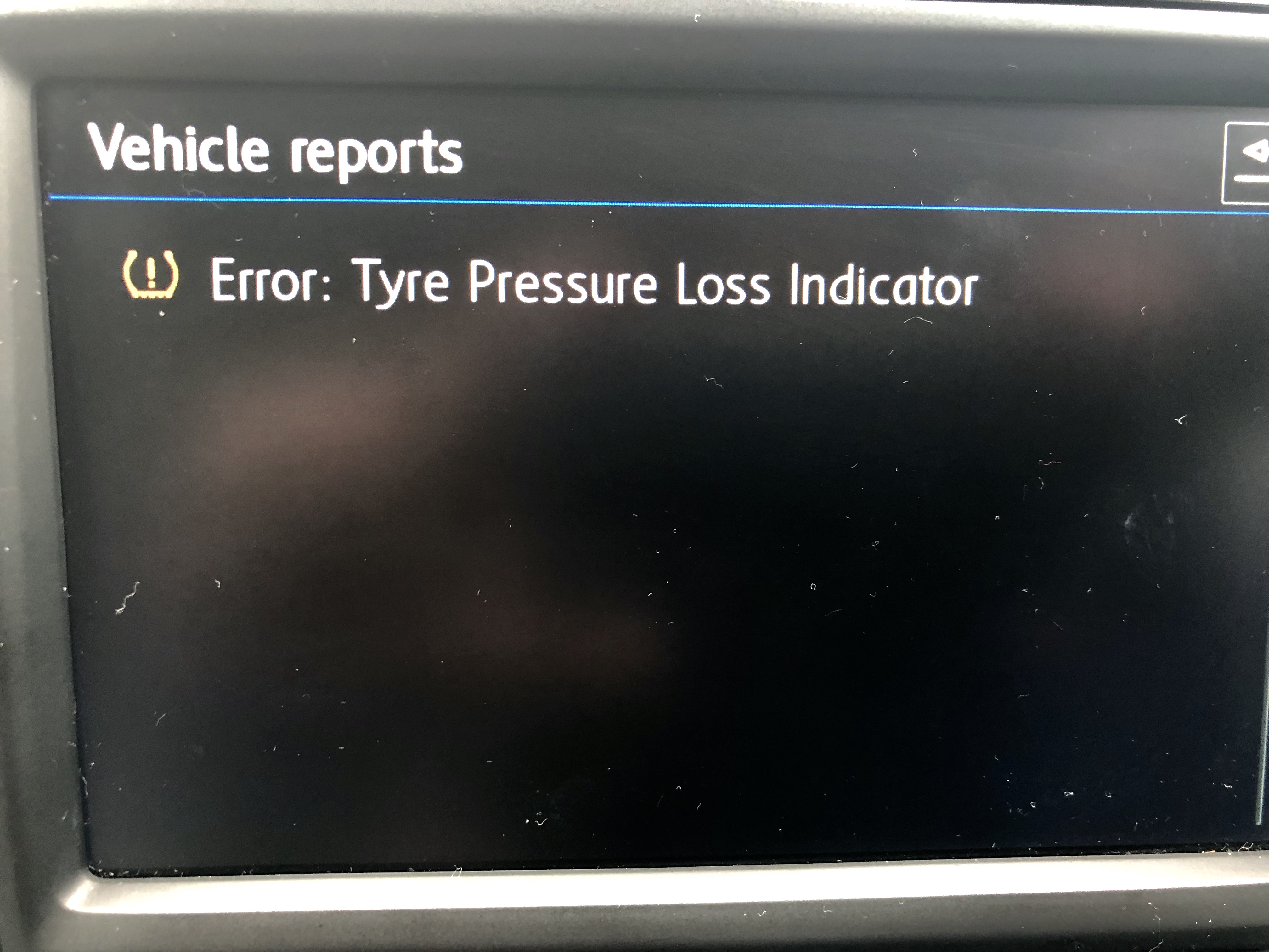

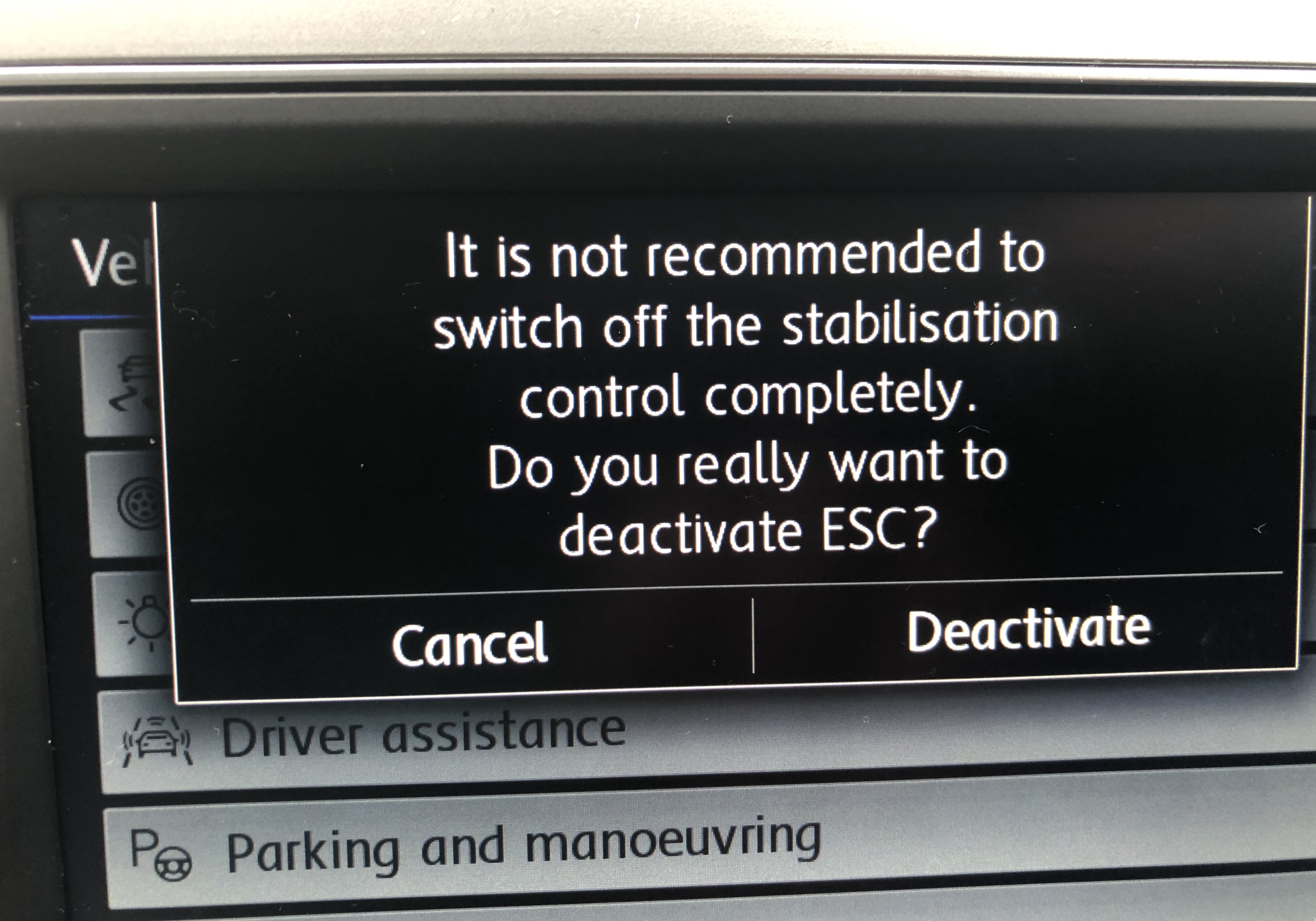

This is my vcds scan for that esp question. Thanks a lot!

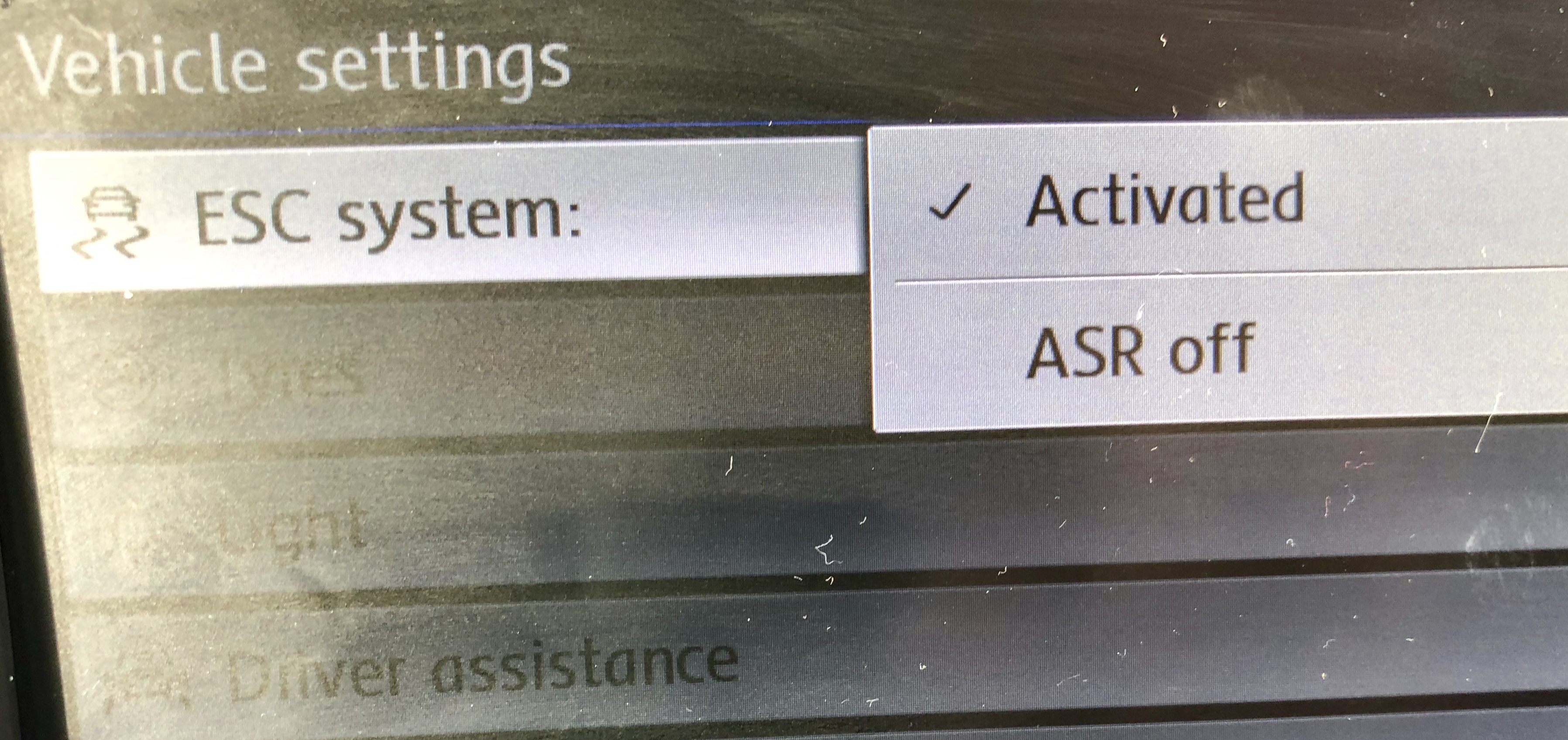

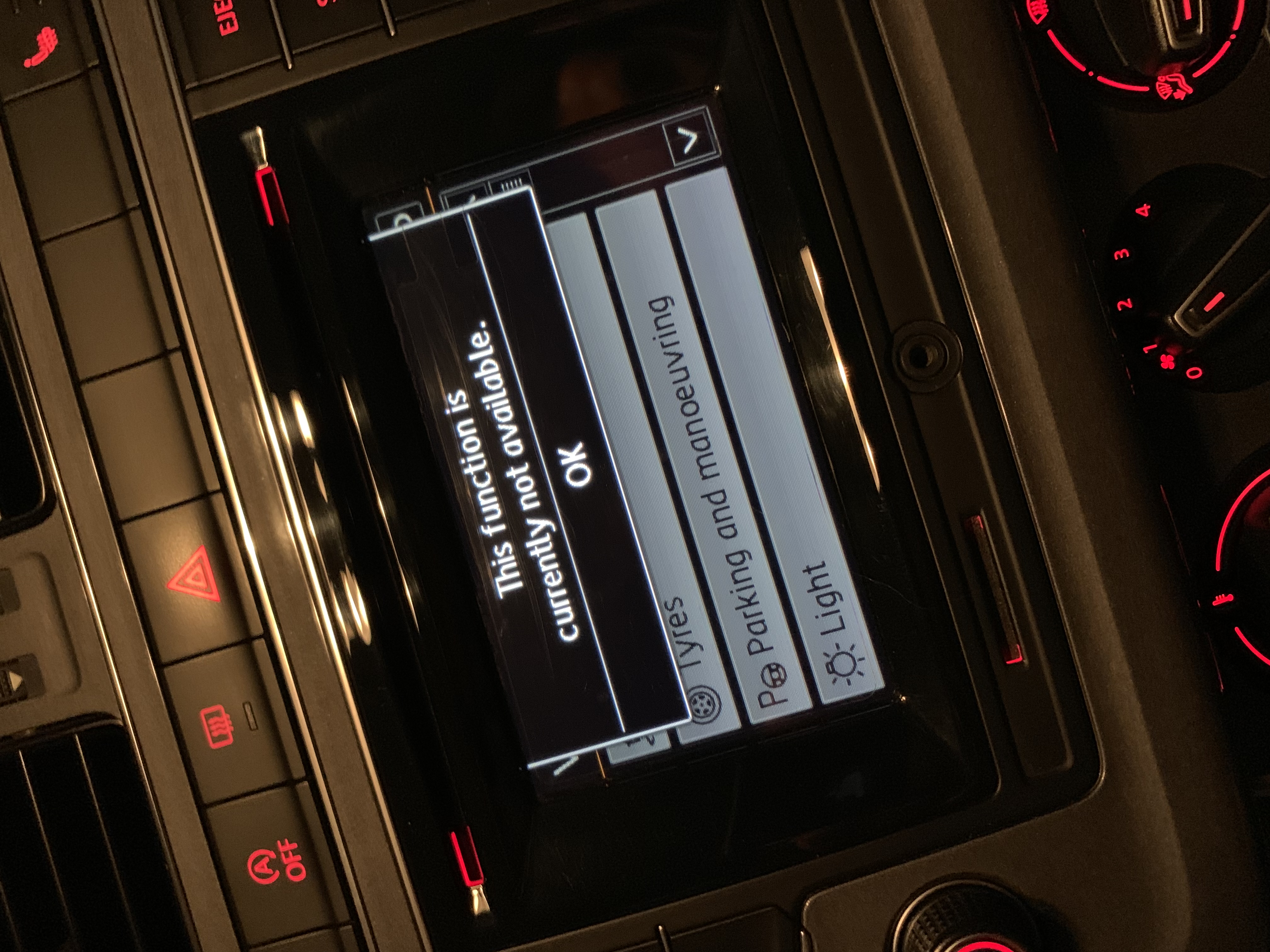

So i made the coding change my C7 with CB DB and it accepted my coding but in mu multimedia it said that this function is not available( i made it show esp system) and with EB doesn t accept the coding

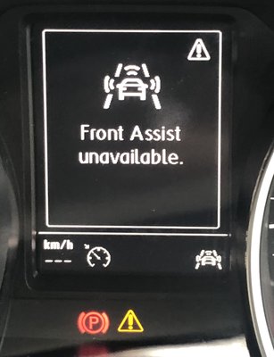

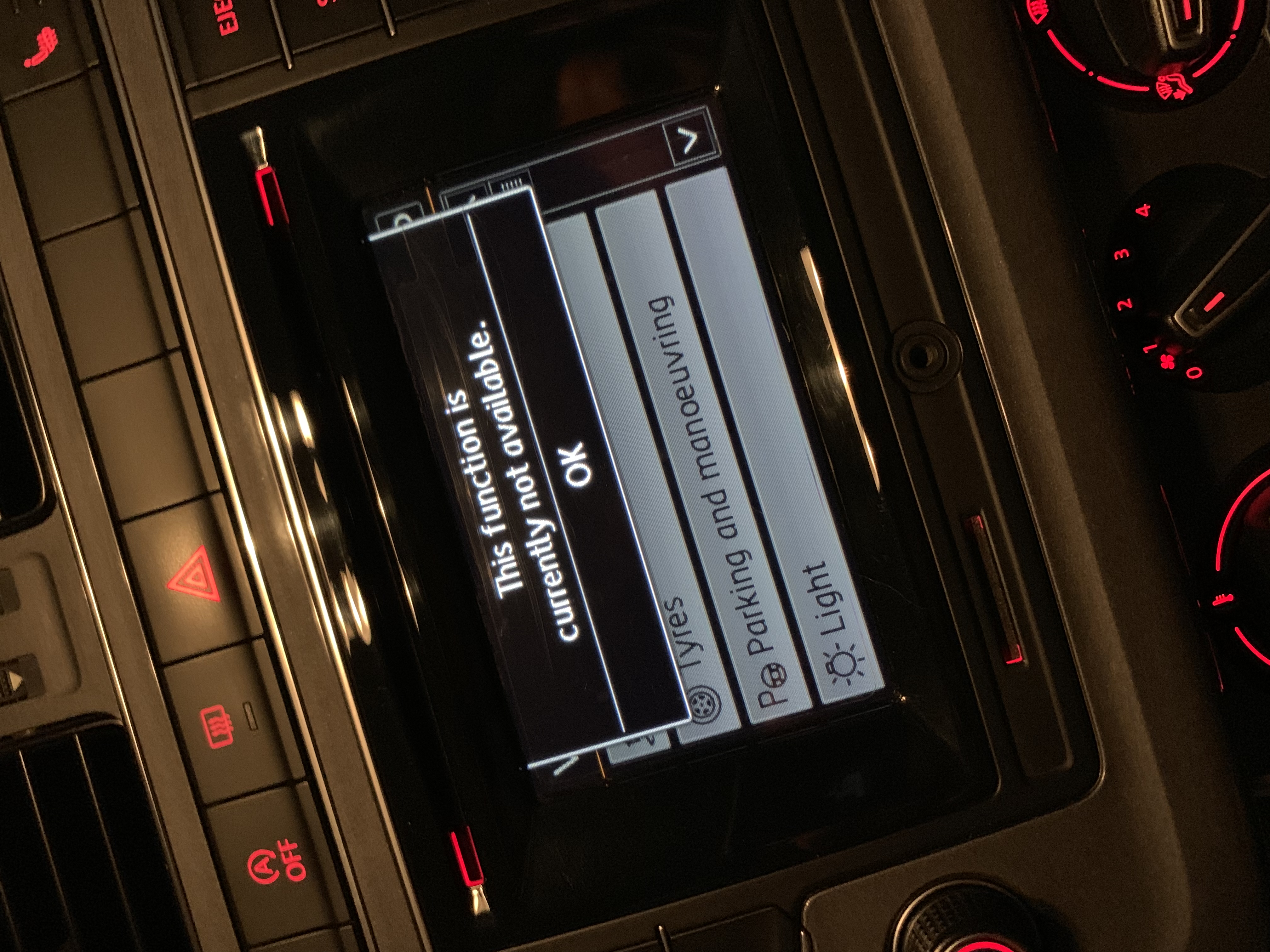

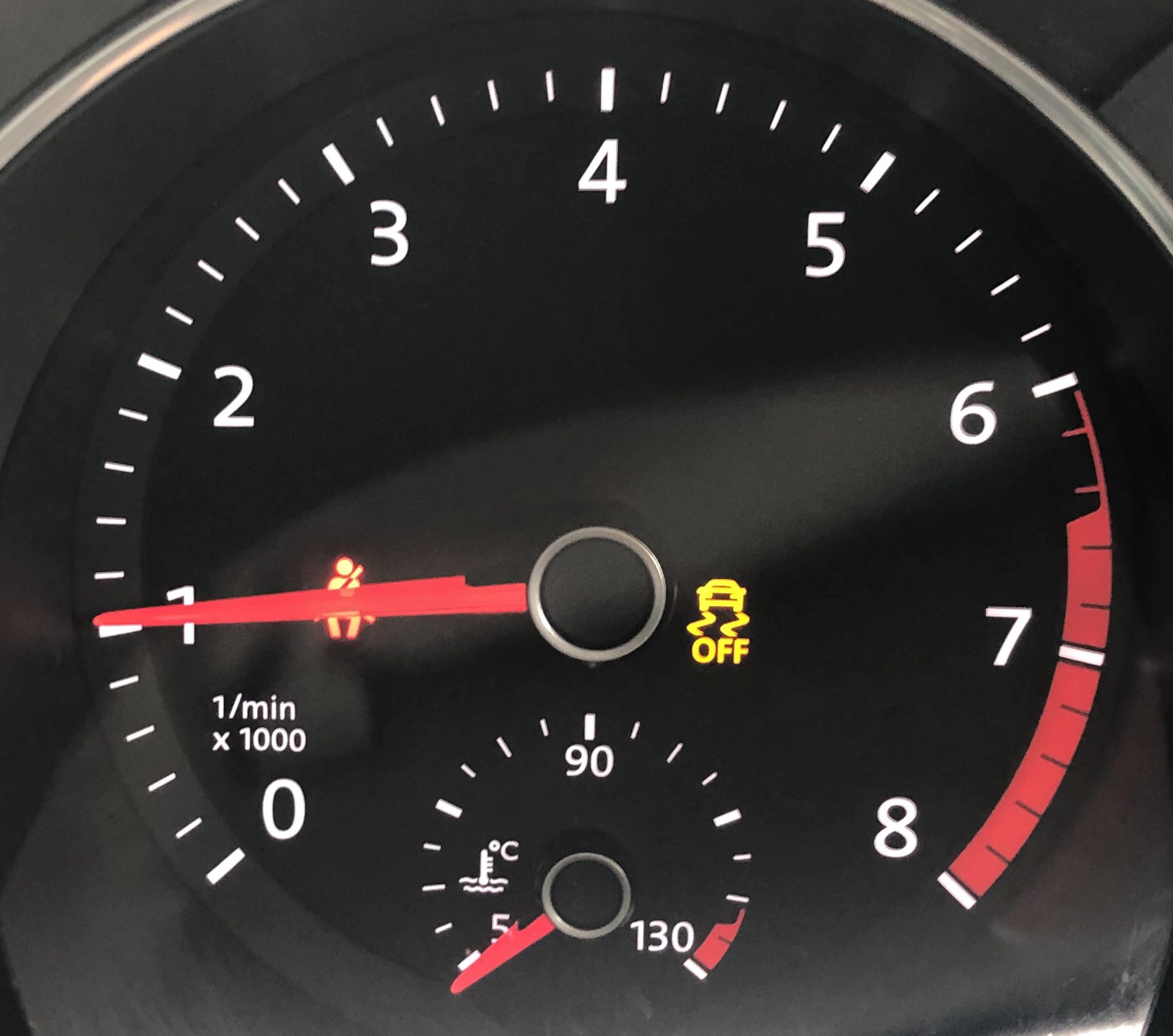

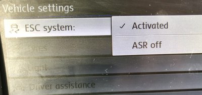

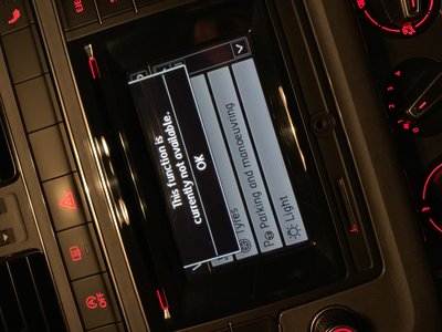

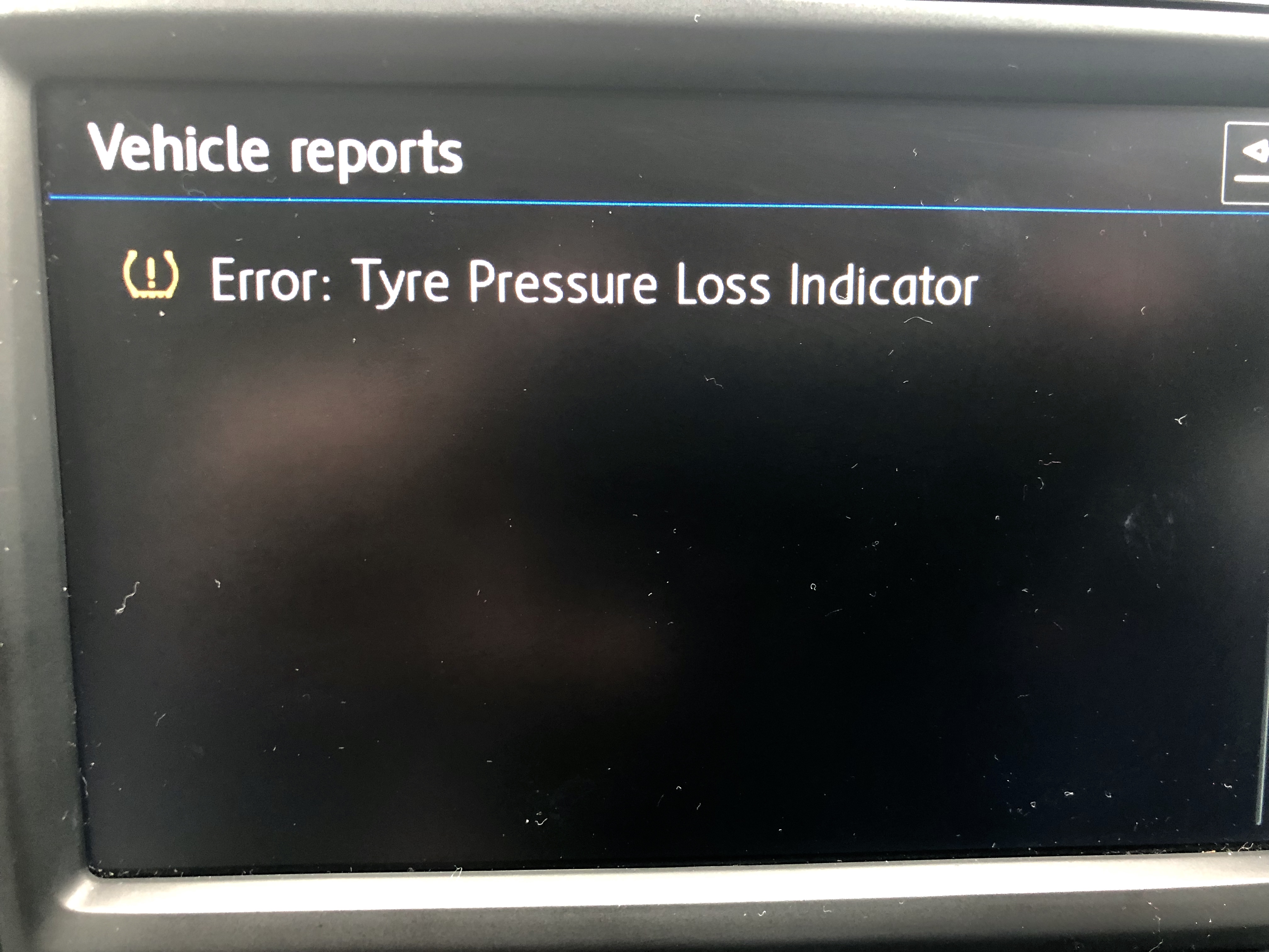

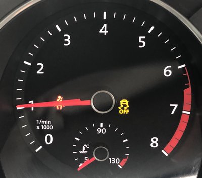

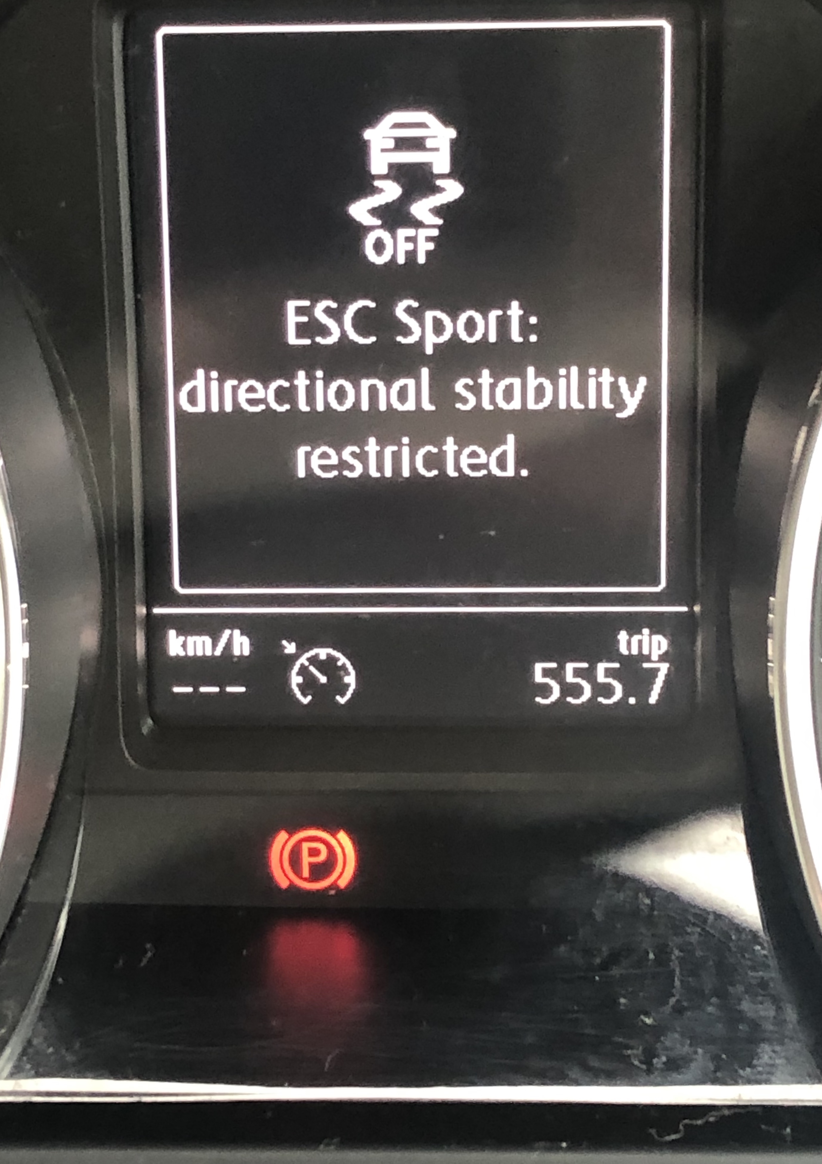

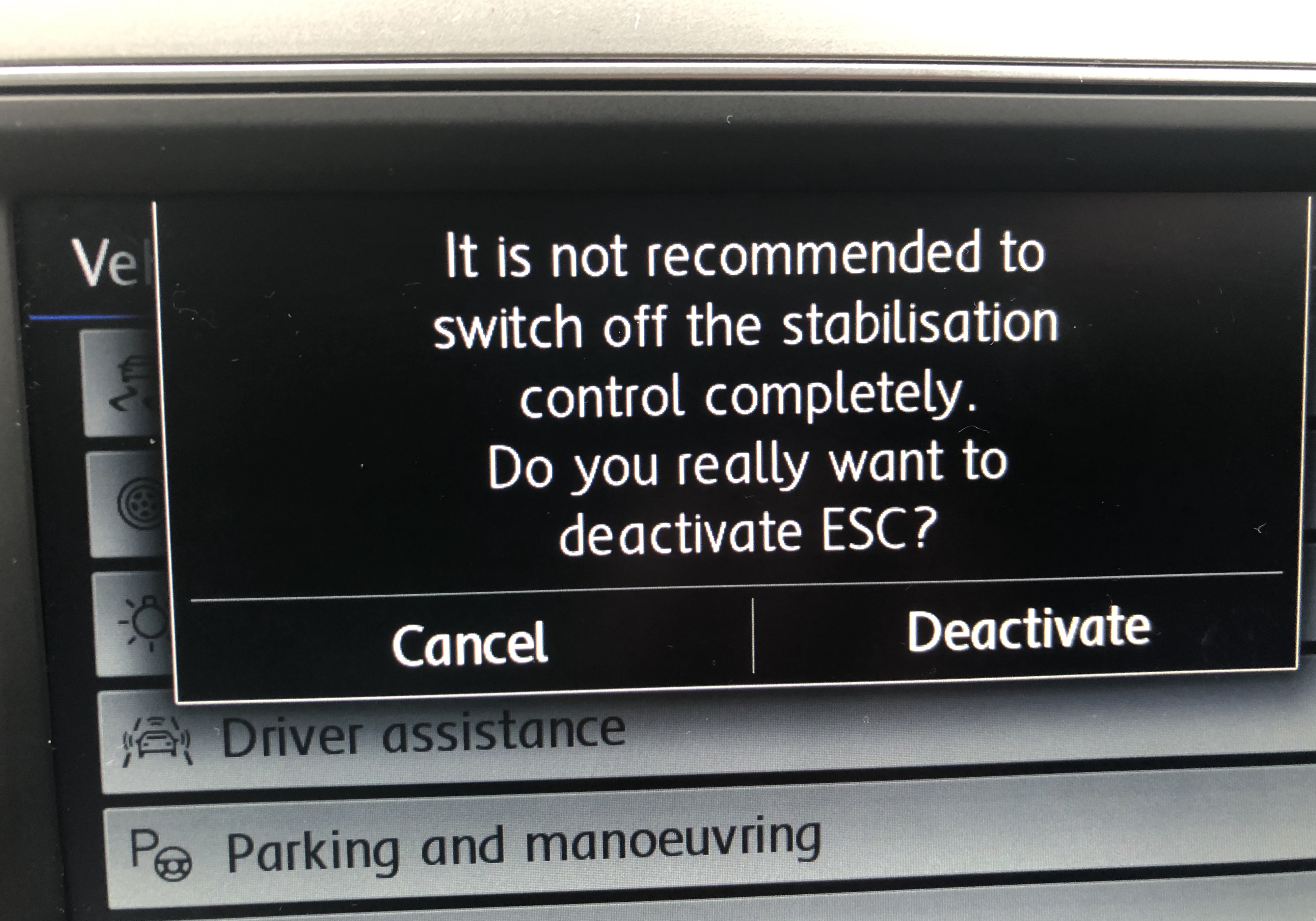

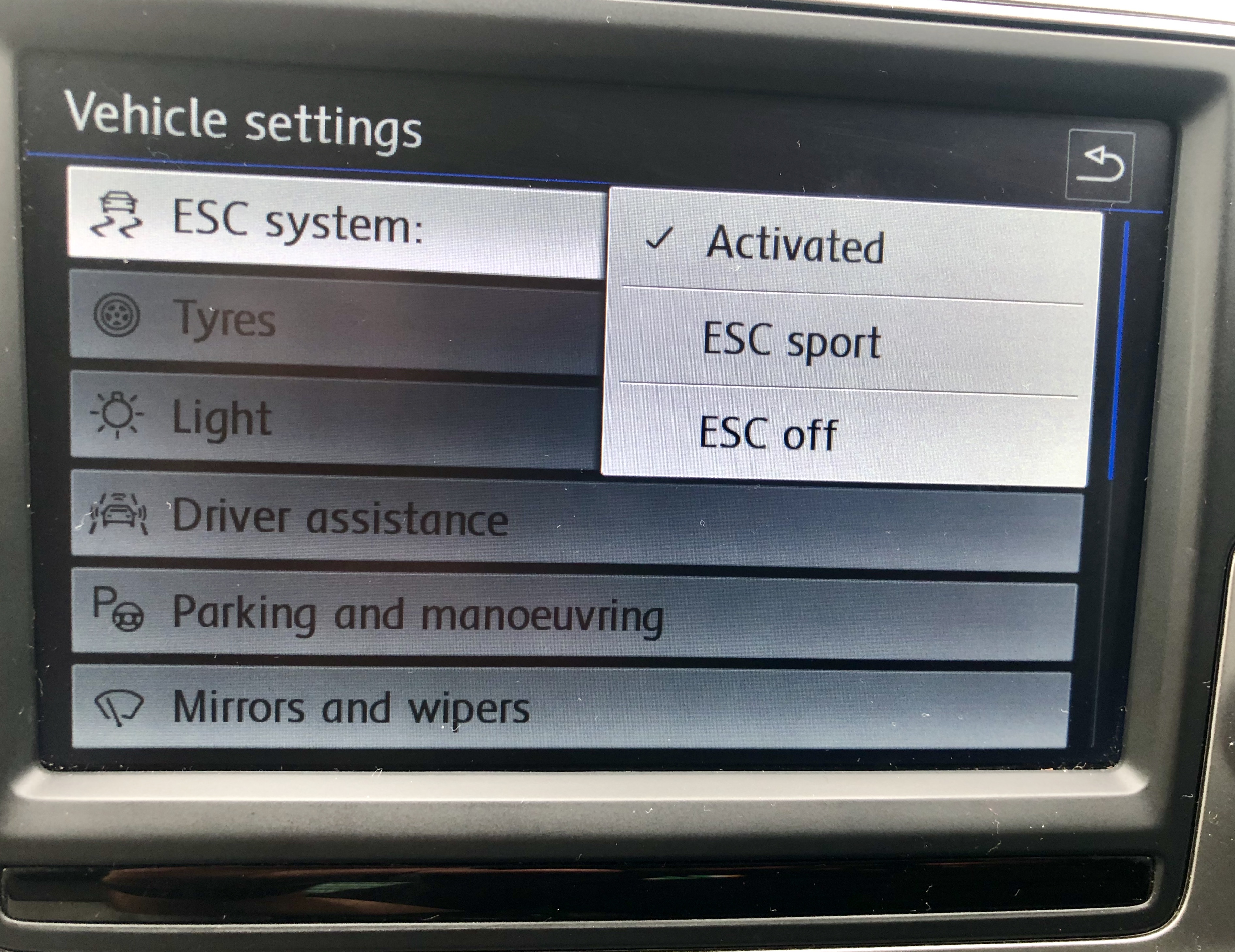

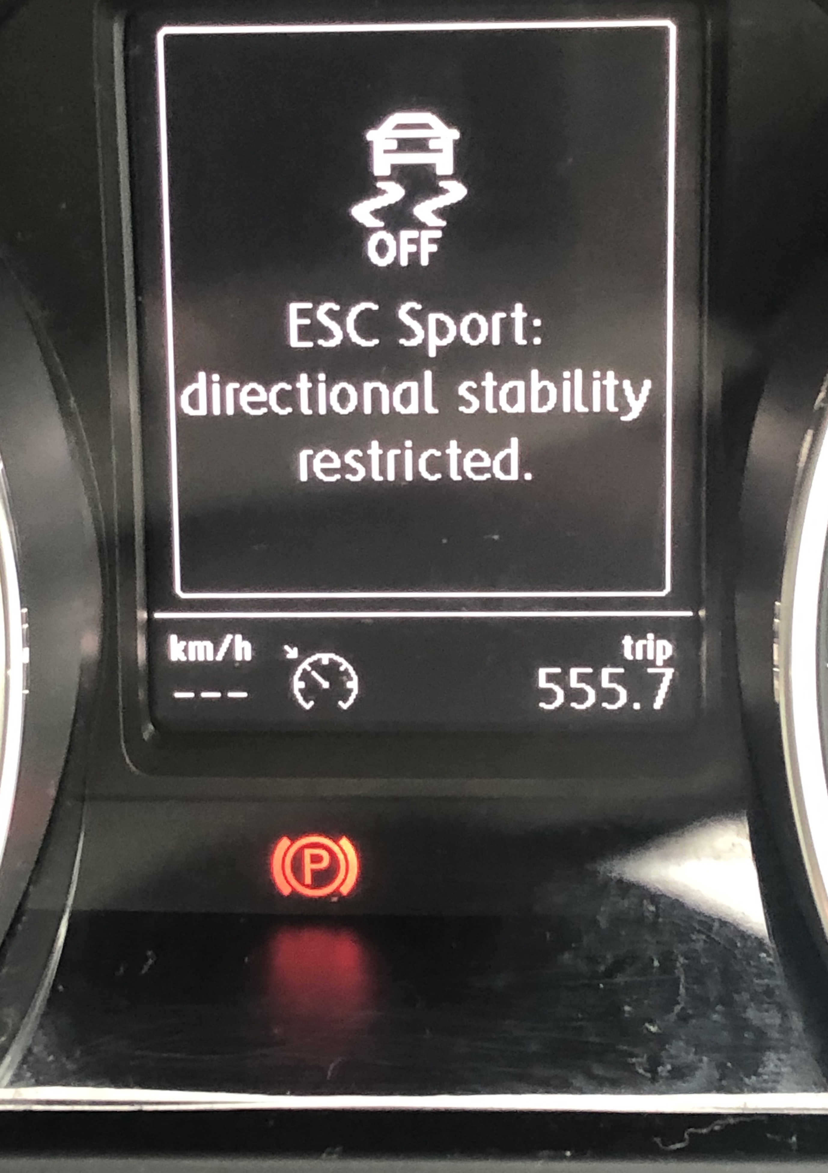

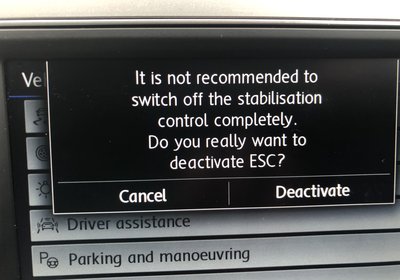

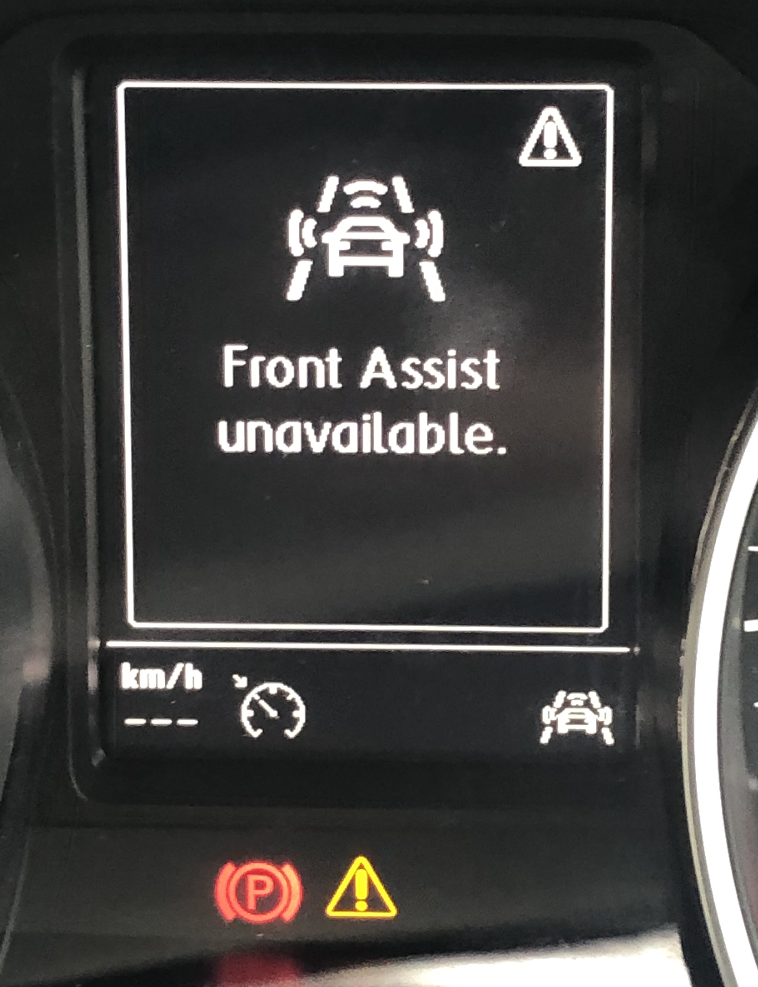

ok so I changed the CB value in the abs coding to DB and this is what happened... I was sweating it
Menu got updated: Couple Errors popped up as soon as I changed the value: Front Assist not available and Tyre Pressure Loss Indicator. I switched off the ignition and switched it back on and all the errors were gone.
When I activate ESC Sport in menu I get the following reports in my car:
When I try to activate ESC Off I get the following message.... didn't go further after that
So changing that Byte changes the options in the menu. Now could there be some other coding or adaption to be done? that's the question...
massimo23

21 DD 28 85 49 26 33 C0 09 18 10 6B 00 59 84 14 92 CC 90 08 00 05 DB 09 0C 00 Yours
23 DD 24 85 49 25 33 C6 09 1A 10 6D 00 59 C4 24 92 CC 90 08 00 05 CB F9 8F 00 Mine
09 0C and F9 8F mmmmm...
can you check your adaptions against mine just to see any difference..
We need to decipher this abs coding
