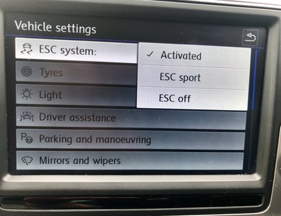

This is what is on the menu:
I have a feeling that the 5f shows the proper option based on the abs setting. that's my theory :)

So i made the coding change my C7 with CB DB and it accepted my coding but in mu multimedia it said that this function is not available( i made it show esp system) and with EB doesn t accept the coding
Re: Polo 6R ABS CODING
Posted: Fri Feb 15, 2019 3:43 pm
by massimo23

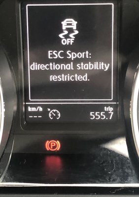

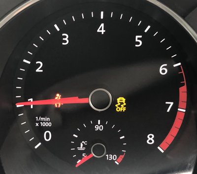

ok so I changed the CB value in the abs coding to DB and this is what happened... I was sweating it :)
Menu got updated:
Couple Errors popped up as soon as I changed the value: Front Assist not available and Tyre Pressure Loss Indicator. I switched off the ignition and switched it back on and all the errors were gone. :))))
When I activate ESC Sport in menu I get the following reports in my car:
When I try to activate ESC Off I get the following message.... didn't go further after that :roll: :
So changing that Byte changes the options in the menu. Now could there be some other coding or adaption to be done? that's the question...
