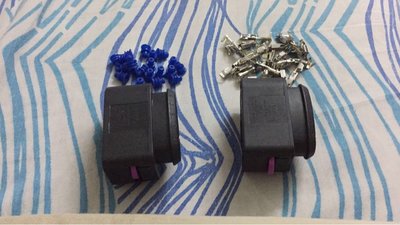

For installation of twin barrel headlamp on H4 headlight setup we need to transfer all wires from 4 existing connector (indicator, headlight range control , indicator, parking light) to an new 10 pin connector & add 1 wire between T17 light switch connector and headlight relay
Following material is needed to Installation
1) 4 wires 1sqmm with 0.5m length
2) 2 10 pin connector
3) insulated tape
4) Terminal extracting tool
10 pin connector
10 pin connector
Remove existing headlight and it's 4 connectors extract all wires from existing connector by using terminal extracting tool and transfer to new 10 pin connector one by one.

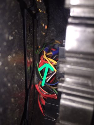

Thin yellow wire of headlight relay
Wire connected to T17/7
Connect 1 sqmm wire to T17/7
Look for the thin yellow wire connected to headlight relay behind relay carrier that's the T5zv/2 cut and isolate existing wire and connect new wire coming from T17/7 by crimp or scotch lock.

Excellent, thank you very much for show us this job. 8)
The last image is somewhat confusing because it seems that the arrow points to the T17/4, it does not matter, the idea is what it's worth.

Post edited and uploaded correct pic
Actually forgot to click pic of T17 connector so attached the pic randomly
Got the pic from thakur s post...
