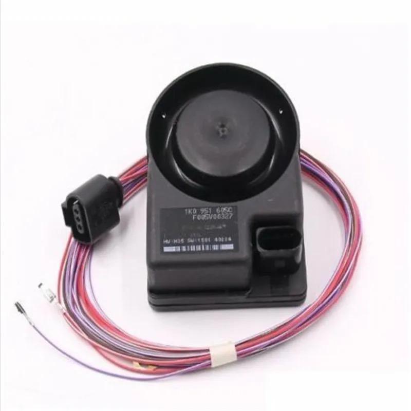

New Mode: Alarm horn (H12)
WhatsApp Image 2023-06-09 at 22.20.11.jpg (36.67 KiB) Viewed 8090 times
   Revision: B9084001    Serial number: 2502 306190145
   Coding: 2AB0393E4EFF201281280EC17EEB9FDDF88E6600608D79C072A4003F0860
   Shop #: WSC 12345 123 12345
   VCID: AD0CE4A37D142EB214D-80F8
   Component: RLS 230916 03  37  0059
   Coding: 0228EE
   Component: J386__TSG_FT  002 3313
   Component: J387__TSG_BT  002 3313
   Subsystem 4 - Part No: 1K0 951 605 C
   Subsystem 5 - Part No SW: 7E0 959 442 A    HW: 7E0 959 442 A
   Component: E221__MFL-DC1  H02 0103
   Serial number: 39180000000570018056
   Coding: B4FFFF

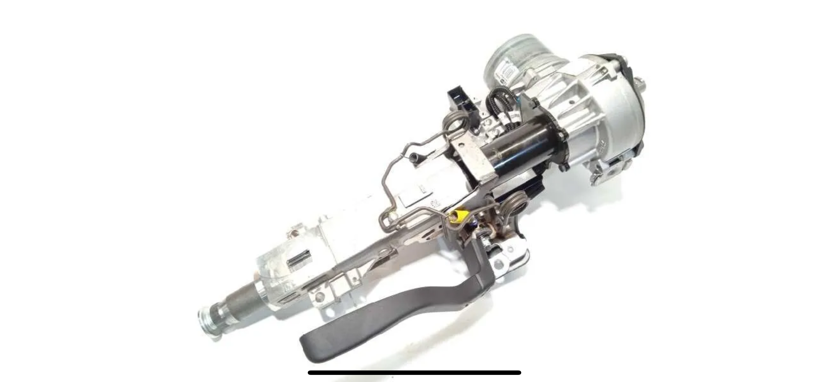

5 Faults Found:
10531840 - Steering angle sensor
          B1168 54 [137] - Missing Calibration / Basic Setting
                    Fault Status: 00000001
                    Fault Priority: 4
                    Fault Frequency: 1
                    Reset counter: 154
                    Mileage: 303021 km
                    Date: 2023.10.18
                    Time: 00:10:15
                    Engine RPM: 0 /min
                    Vehicle speed: 0 km/h
                    System status: Malfunction
                    Terminal 15 status: On
                    Voltage terminal 30: 12.11 V
                    Power steering current consumption: 0.5 A
                    max.value: 0.5 A
                    End stage temperature: 0  C
                    Steering assistance: engine output: 100 %
                    Engine angle: 65535
                    Electric motor speed: 45535 /min
                    Steering assistance: target engine torque: 0.0 Nm
                    Steering torque: 0.0 Nm
15793408 - Crash Shut-Down Activated
          P1609 00 [137] - -
          [DEM_FRONT_CRASH_STEERING_ANGLE_FAULT]
                    Fault Priority: 4
                    Fault Frequency: 1
                    Mileage: 303021 km
                    Date: 2023.10.18
                    Time: 00:10:15
                    Engine RPM: 0 /min
                    max.value: 0.5 A
                    Engine angle: 65535
10552320 - Control Module Incorrectly Coded

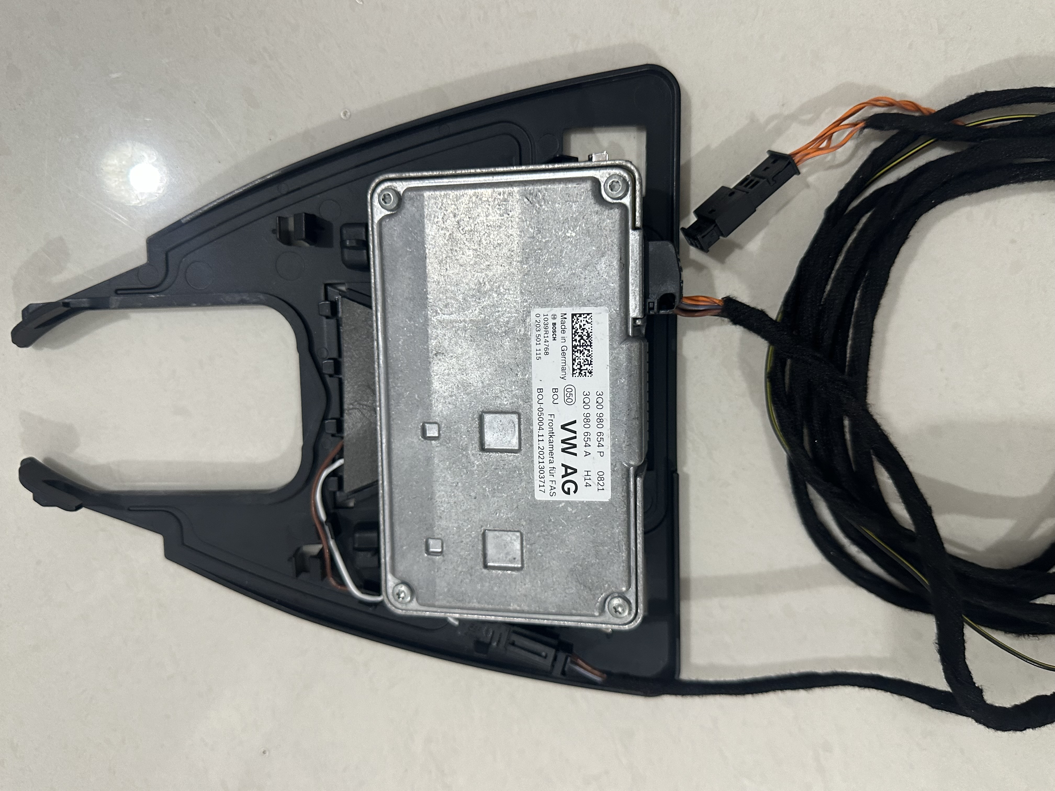

Address A5: Frt Sens. Drv. Assist (R242)       Labels:| 3Q0-980-65X-A5.clb
   Part No SW: 3Q0 980 654 P    HW: 3Q0 980 654 A
   Component: MQB_B_MFK     H14 0821
   Serial number: 04112012P13717 Dataset Number: V03935308DF 0001
   Coding: 01020706000004010002105481D6840084000E01002000
   Shop #: WSC 31414 137 00001
   ASAM Dataset: EV_MFKBoschMQBB 002041
   ROD: EV_MFKBoschMQBB_002.rod
   VCID: C4DAA107CE1ECFFAEB3-8090
2 Faults Found:
0768 - No Basic Setting
          B2010 00 [009] - -
          [Calibration_VIN_mismatch]
                    Fault Priority: 4
                    Fault Frequency: 1
                    Reset counter: 154
                    Mileage: 303021 km
                    Date: 2023.10.18
                    Time: 00:10:15
                    Control Module temperature: 38  C
                    Outside temperature: 24.0  C
                    Vehicle speed: 0.00 km/h
                    System run time: 788.7 s
                    Voltage terminal 15: 12.1 V
                    mid: 00 53
                    Status of camera: System malfunction
                    Engine_Running_Info: 0
                    Software_Info_4: 1
                    Software_Info_3: 2
                    Software_Info_2: 8
                    Software_Info_1: 0
0658 - Control Module Incorrectly Coded
          U1014 00 [009] - -
          [Crosslinking_variant]
                    Fault Priority: 4
                    Fault Frequency: 1
                    Reset counter: 154
                    Mileage: 303021 km
                    Date: 2023.10.18
                    Time: 00:10:15
                    mid: 00 2B
                    Software_Info_4: 1
                    Software_Info_3: 2
                    Software_Info_2: 8
                    Software_Info_1: 0
