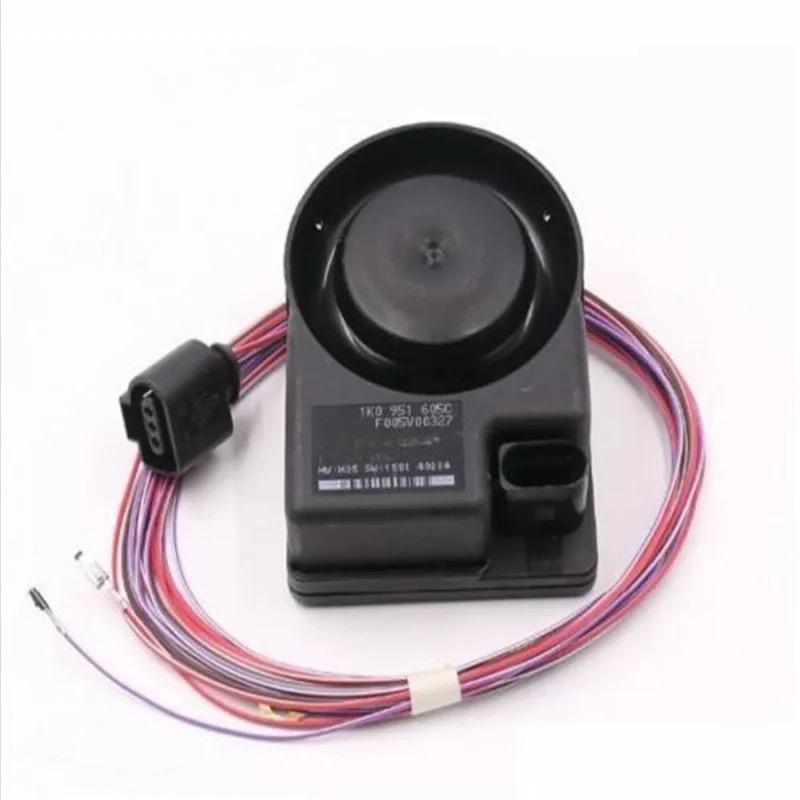

New Mode: Alarm horn (H12)
WhatsApp Image 2023-06-09 at 22.20.11.jpg (36.67 KiB) Viewed 8106 times
   Revision: B9084001    Serial number: 2502 306190145
   Coding: 2AB0393E4EFF201281280EC17EEB9FDDF88E6600608D79C072A4003F0860
   Shop #: WSC 12345 123 12345
   VCID: AD0CE4A37D142EB214D-80F8
   Component: RLS 230916 03  37  0059
   Coding: 0228EE
   Component: J386__TSG_FT  002 3313
   Component: J387__TSG_BT  002 3313
   Subsystem 4 - Part No: 1K0 951 605 C
   Subsystem 5 - Part No SW: 7E0 959 442 A    HW: 7E0 959 442 A
   Component: E221__MFL-DC1  H02 0103
   Serial number: 39180000000570018056
   Coding: B4FFFF
