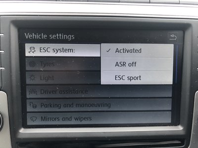

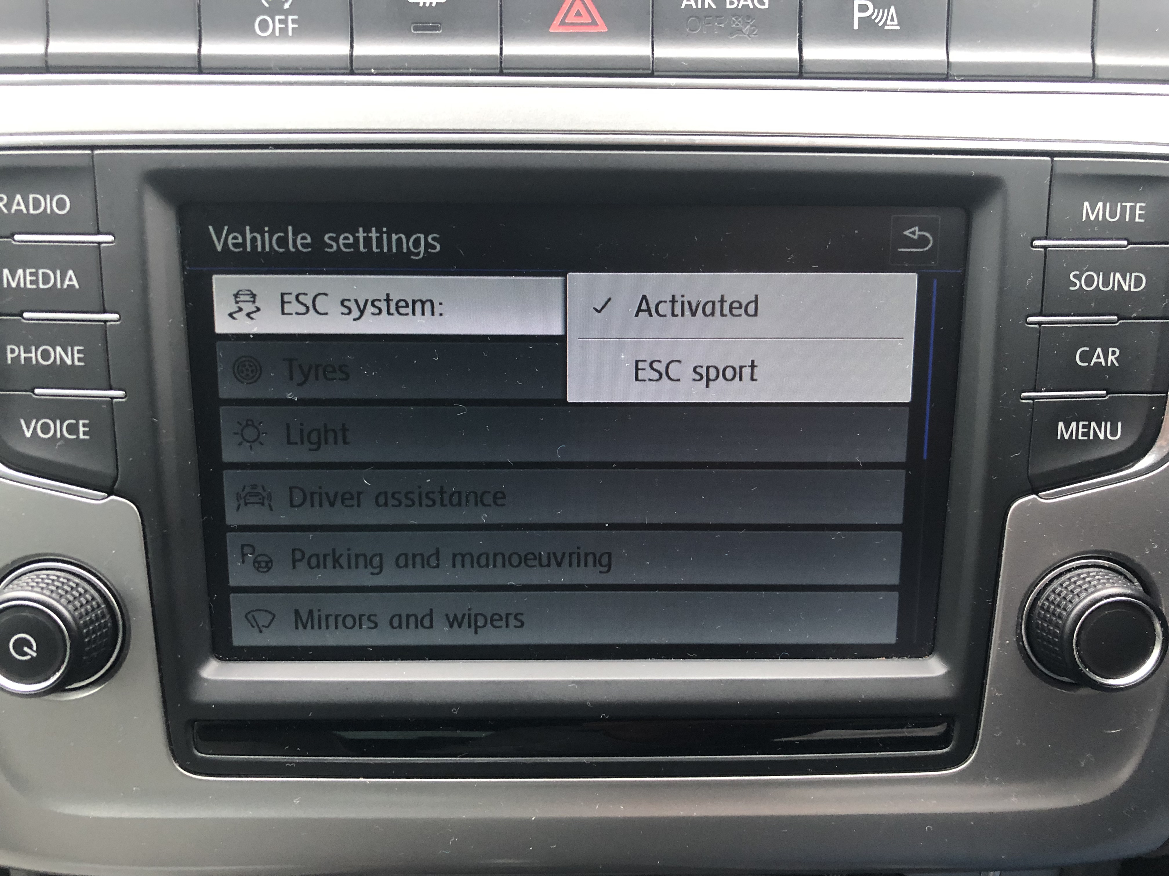

So i changed byte 22 of Abs to CF and the Esc System menu changed to this:

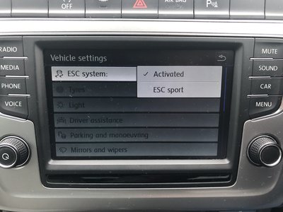

And again with value E7:
