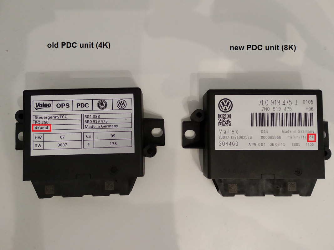

Yesterday I got the PDC 8K unit which replaced my old 4K unit so I could finally test the front PDC but I encurred a problem: often obstacles are showed when there are not!
Here's a video:
https://youtu.be/o3p6xUWndm4
What do you think will cause the problem?
I thought sensors were dirty but I have cleaned them and problem remanins.
All sensors and PDC unit came from aliexpress so I was thinking problem cluld be related with the bad quality of front sensors (anyway rear sensors came from aliexpress too but they work perfectly).
Here's a video:

I think that the Aliexpress PDC units have a new software wirh more functions, check if the words 'ghost detector' is written on the Aliexpress PDC unit.
Now seriously:
According to the video it seems that the problem only happens when the rear sensors are also active.
Check the connections (terminals, wires, connectors) that reach the PDC unit.
By other side, there is a 6R PDC button that is sold on Aliexpress that is not correct for 6R, maybe this is the problem.
This also happened to another Italian mate, but now I don't remember who.
Now seriously:

Now that I check your autoscan, are you sure your PDC unit is fully compatible with PQ25?

I didnt think about itciclo wrote: Thu Aug 29, 2019 9:18 pm I think that the Aliexpress PDC units have a new software wirh more functions, check if the words 'ghost detector' is written on the Aliexpress PDC unit.
Thank you ciclo, unfortunatelly I noticed front sensors do not work properly even when rear sensors are off (for example sometimes they have so long response time that I hear the beep when I'm nearly to hit the car in the front).ciclo wrote: Thu Aug 29, 2019 9:18 pm According to the video it seems that the problem only happens when the rear sensors are also active.
I'll check the connectors and the wirings but I'm pretty sure everything is fine because I checked them several times.
Maybe I can try to disconnect rear sensor connector and see if that affects the front sensors
Anyway I read that a single faulty sensor may make the control unit go crazy so maybe a possible solution could be replace them all..
Yea I had a talk with that guy sometime ago but I purchased a genuine PDC buttomciclo wrote: Thu Aug 29, 2019 9:18 pmBy other side, there is a 6R PDC button that is sold on Aliexpress that is not correct for 6R, maybe this is the problem.
Sorry ciclo that autoscan had been made before I changed the PDC unit.Now that I check your autoscan, are you sure your PDC unit is fully compatible with PQ25?
I've not actually a recent autoscan but here are some more details about the unit I received:
https://it.aliexpress.com/item/32977210 ... 4c4dN7u392

There is something in your autoscan that confuses me
Address 10: Park/Steer Assist (J446) Labels: 7E0-919-475.clb
Part No SW: 7E0 919 475 L HW: 56D 919 475
Component: PARKHILFE 8K H02 0106
Revision: -------- Serial number: 20231629400567
Coding: 108001
Shop #: WSC 12345 123 12345
ASAM Dataset: EV_VW75XPakrAssis8K 001003
ROD: N/A
VCID: 3B72ECAEB2FEE099FC-806E
No ASAM data for: "EV_VW75XPakrAssis8K" (VW25)
Such HW is for other platforms (Passat B7, Golf 6, etc.).
Has it been flashed?

Thanks Fernando, in the end I had to follow your suggestion and replacing the whole unit since replacing the battery did not solve the problem with the old alarm..ciclo wrote: Fri Aug 30, 2019 7:31 pm Great!![]()
I suppose the best thing would have been to change the alarm horn since the original horn began to fail, however you already have the experience of installing the batteries in this model of alarm horns.
It has been a great idea to install the 'F' model, which is the one that replaces the 'C' model (etka).
I just hope purchasing a more recent replacement decreases the risk to face again the same problem very soon!
Sorry but I don't know If it had been flashed.ciclo wrote: Fri Aug 30, 2019 7:31 pm Such HW is for other platforms (Passat B7, Golf 6, etc.).
Is there any way to know If It had been?
When you talk about flash are you refering to the software?

Well, reading that HW could also be a mistake in your VCDS cable.
With flashing I mean update/modify the original software.
In the image in your previous posts it seems clear that the unit has not been flashed, you will have to investigate the malfunction in the PDC sensors.

Thanks ciclo, I'll follow your suggestion checking the PDC sensors.

PDC Update
Hi guys, after replacing the brand new sensors purchased on aliexpress with a genuine used set, font PDC works correctly.
Be carefull buying cheap replacement from China! You risk to spend money twice.
