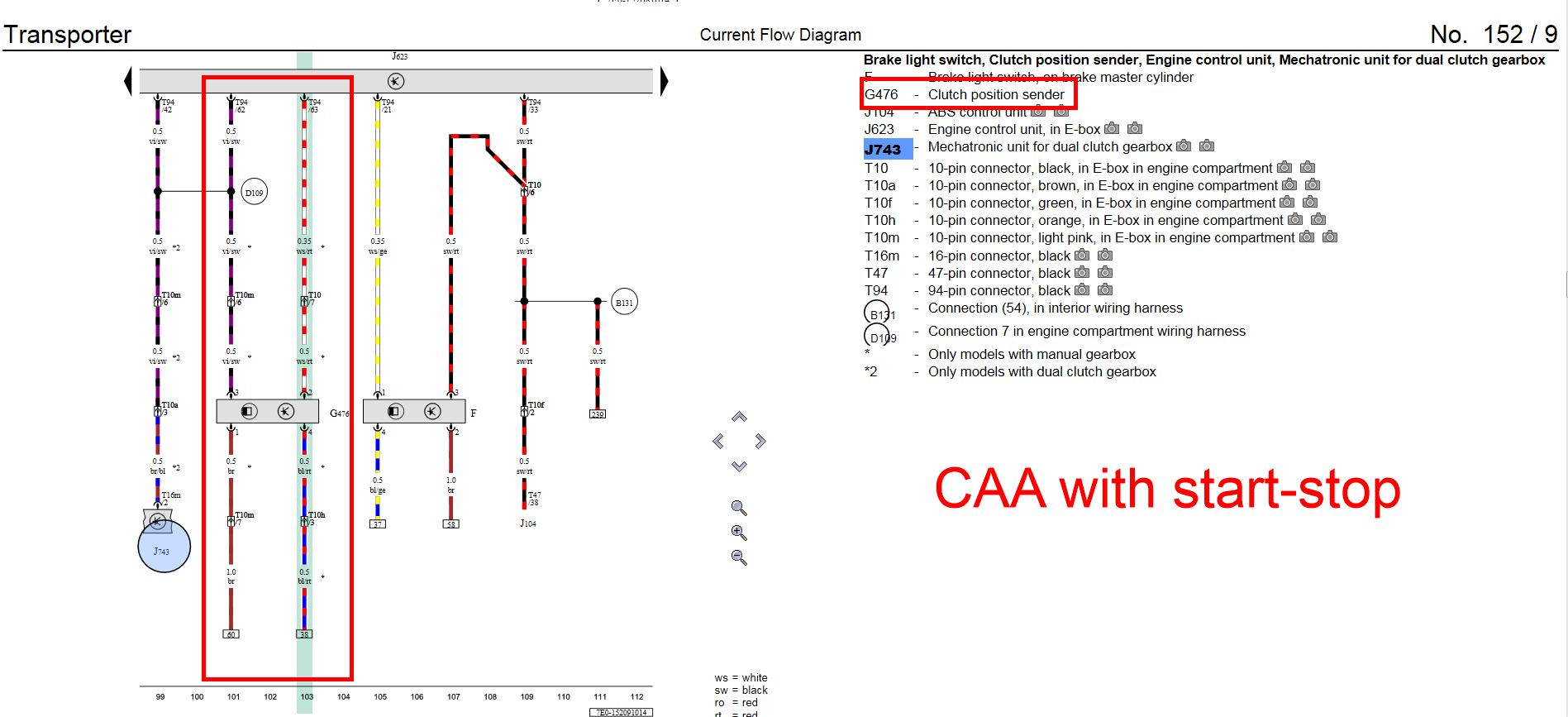

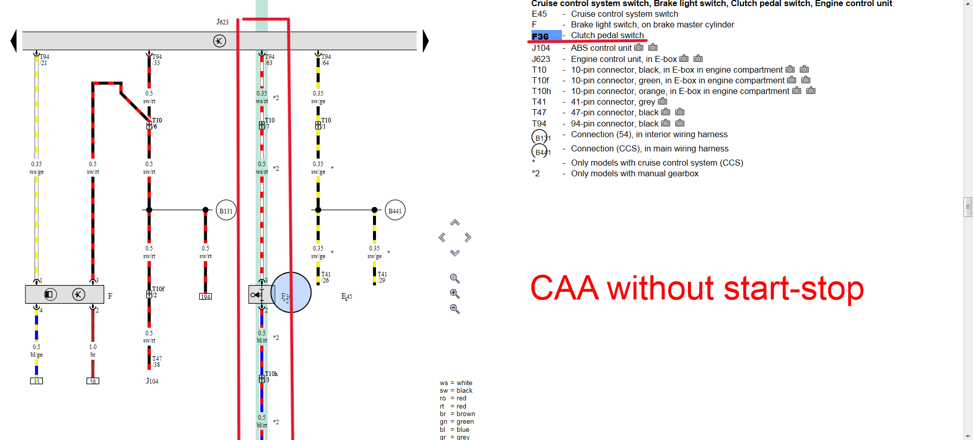

after a long research why my elv didnt send 50kl signal to start the car..
the biggest possibility was that ELV is not knowing that my clutch is pressd
so after a quick look at elsa :-
So my van has a basic clutch padle switch
But in CAA with start-stop elsa shows a different case :-
I have immediately ordered this part and installed it ..
2 wires are repined + new GND wire + one new wire to the ecu
and after testing still no progress :cry: :cry:
I was thinking maybe I should also flash ECU to support (start-stop) to get this new line working

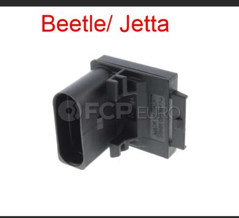

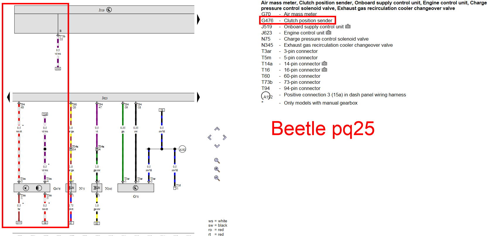

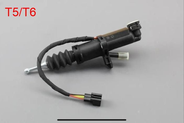

two days later I asked my self so how a manual beelte and jetta with kessy knows when clutch is pressed
after checking elsa I found this :-
after checking the beetle clutch position sensor I found that its nothing like the T5
WhatsApp Image 2023-11-26 at 23.12.25_55796abd.jpg (21.33 KiB) Viewed 7037 times
WhatsApp Image 2023-11-26 at 23.12.25_4731a748.jpg (28.2 KiB) Viewed 7037 times
But If we look closely at the wiring diagram, all the wires seem to be similar, so I decided to give it a try and rotate the new wire to T73b/55
and when made a test I was surprised, kessy start is starting to work
with full clutch and a long press only, it will start the car
a press with out clutch paddle with turn on 15kl, but I wont be able to start the car with a second press with clutch, instead the second press turn of 15kl
