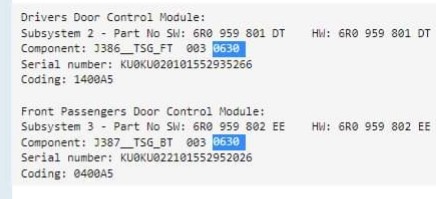

Hi Cyclo, let me dig out the topicciclo wrote: Thu Sep 02, 2021 8:20 am
It's really simple:
WRM = Window Regulator Motor. (door units managed by BCM)
SW = Software.
- Your WRMs don't have the proper SW.
- Forget the "rain closing" function, and the "automatic folding mirrors" function with remote/key fob.
Your WRMs: (Red = software)
Podsystem 2 - Oznaczenie elementu SW: 6R0 959 801 AK HW: 6R0 959 801 AK Plik etykiet: 6R0-959-801.CLB
Komponent: J386__TSG_FT 007 5110
Numer seryjny: --------------------
Kodowanie: 020000
Podsystem 3 - Oznaczenie elementu SW: 6R0 959 802 AR HW: 6R0 959 802 AR Plik etykiet: 6R0-959-802.CLB
Komponent: J387__TSG_BT 007 5110
Kodowanie: 020000
The SW must be 8612 or higher.
what is your idea of making windows in the rain / folding mirrors with a remote control?
What motors can I put in to make it work? Since even in the Ibiza 6P, the last windshield motors 6R0959801DT / 802EE SW: 0630?
- _20220126_205838.JPG (22.57 KiB) Viewed 20977 times

Yes, I know cyclo that SW min 8612,
Only from the 6R0959801 / 2 Ibiza engines they only have the 5XXX
Any other motors I can use? The new beetle has the SW 9XXX
And what should the motor coding be then for the rain closing and the mirrors to work?
Fuse No. 18

Cyclo, will installing these motors (6R0 959 801 BD / 802 BF + coding (0200A3 / 1000A3) and the old RLS 1K0955559 AH SW: 0403 system close the windows / mirrors?KamilPL wrote: Sat Jan 29, 2022 2:42 pmciclo wrote: Thu Jan 27, 2022 3:09 amE.g:
Subsystem 2 - Part No SW: 6R0 959 801 BD HW: 6R0 959 801 BD Labels: 6R0-959-801.CLB
Component: J386__TSG_FT 003 8612
Serial number: KU0KU003041440937042
Coding: 0200A3
Subsystem 3 - Part No SW: 6R0 959 802 BF HW: 6R0 959 802 BF Labels: 6R0-959-802.CLB
Component: J387__TSG_BT 003 8612
Serial number: KU0KU006031440656541
Coding: 1000A3
Component: RLHS 220816 0 42 0106
Coding: 0228DD
