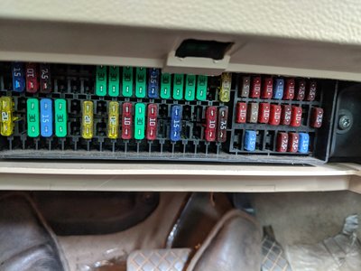

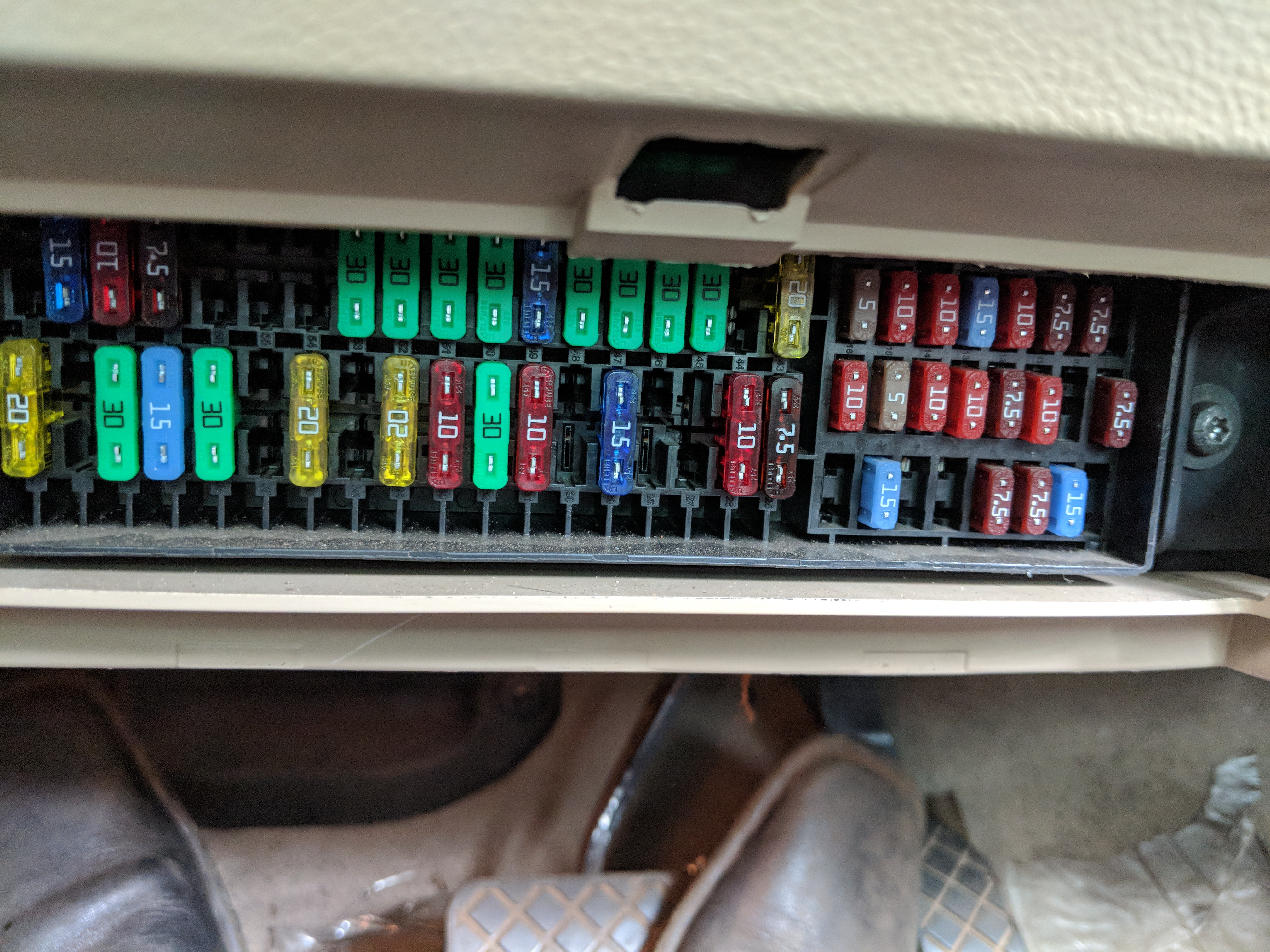

Hello everyone finally I received all required parts for AFS installation on my vento I have few queries regarding installation.
1) Can I take Power from SB10 ?
Fusebox pic attached
2) Which crimp I need to connect wire to fuse box ?
Fuse box
Fuse box
Posts: 8866
Re: RLS ,CH/LH , Auto lights , Rain sensing wiper & Auto dimming Rear view mirror on Vento
SB10b is the right place, +15 signal.
Use the JPT contact-terminal (0.5mm2 wire).

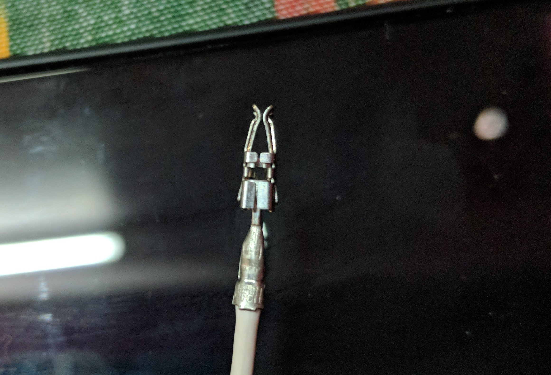

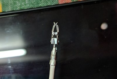

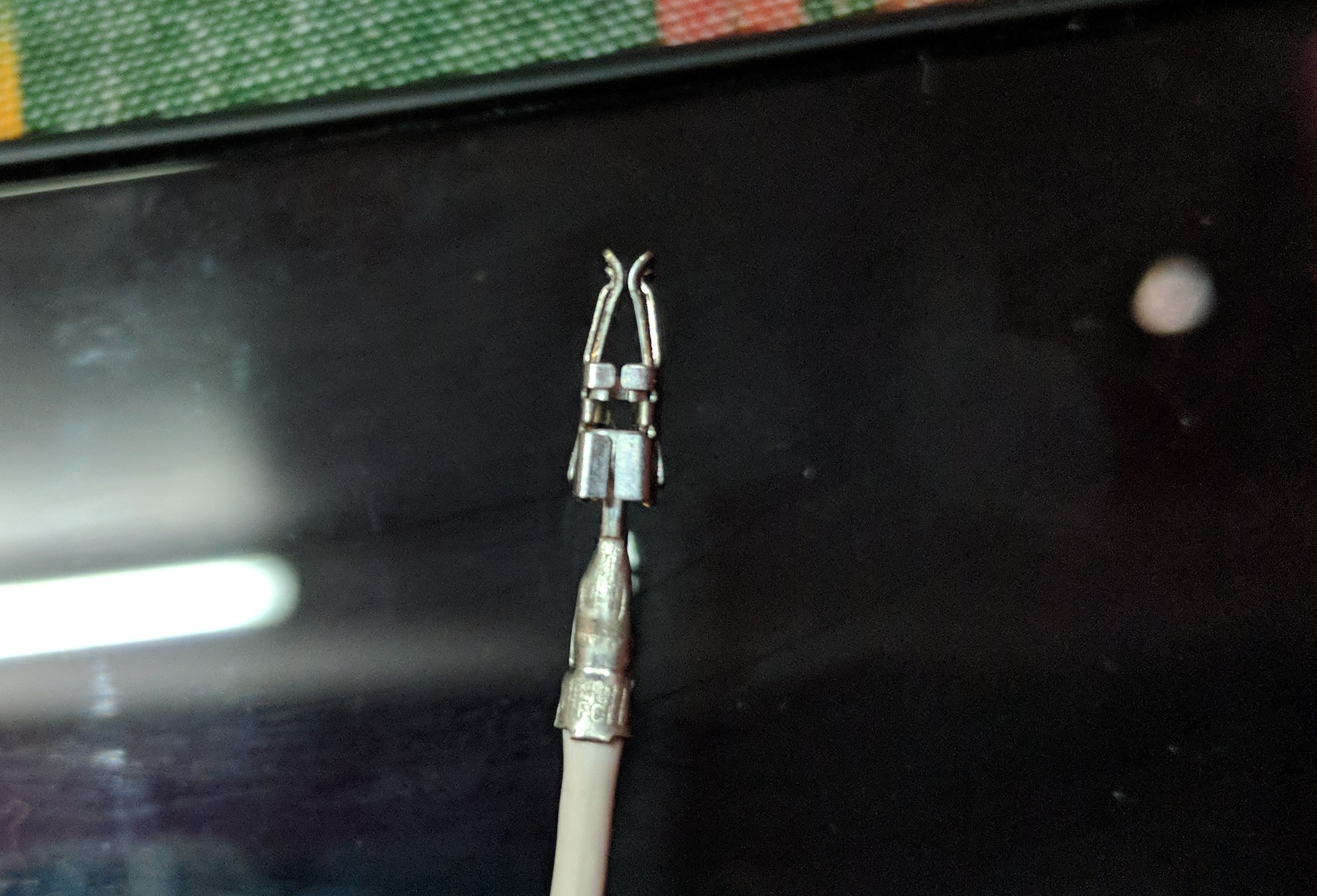

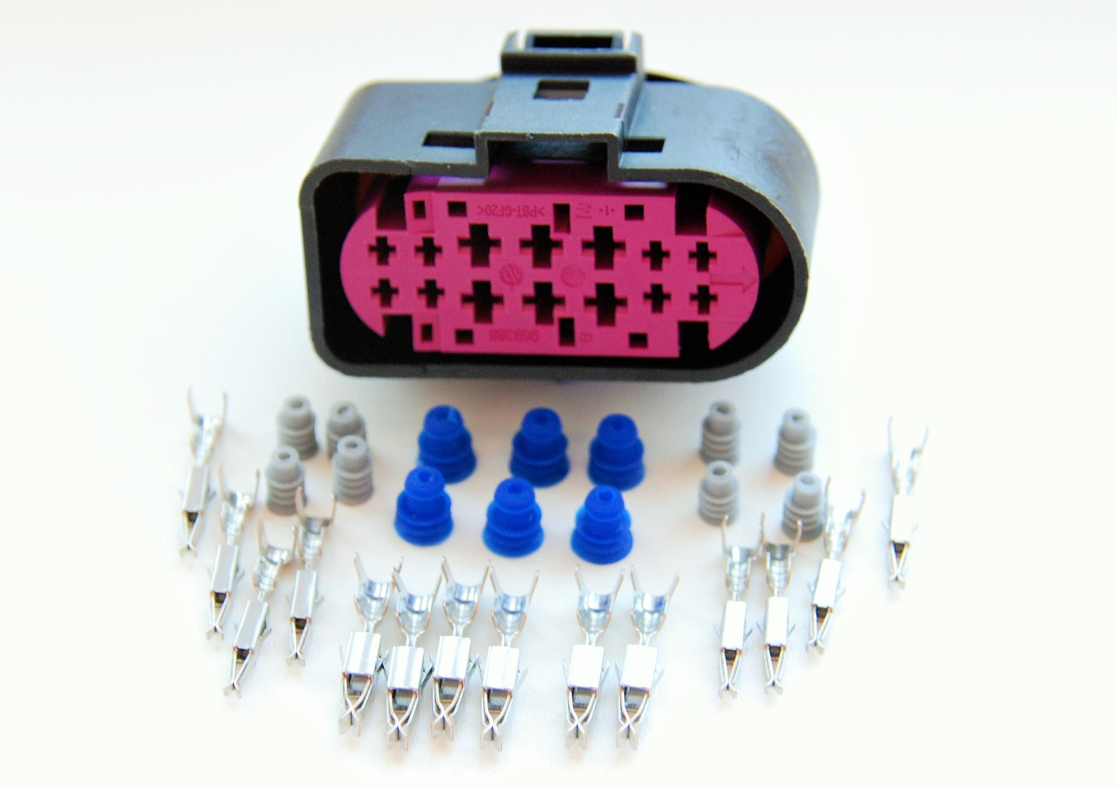

Is it the same crimp used in T14 connector?
Posts: 8866
It could be.
If you mean this T14 connector. No. (11/2011-->)
If you mean this T14 connector. Yes. (-->11/2011)
:lol:
smg_shardul
Posts: 176
Joined: Mon May 01, 2017 3:13 pm
Drives: Polo 6R
Location: Kolhapur
Post by smg_shardul »
ciclo wrote: Fri Jun 22, 2018 5:50 am It could be.
:lol:
So this is the correct one
