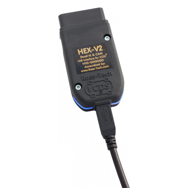

I have Hex+V2 VCDS.
The only difference to fitting the 7,5 headlights on a 7 should be the front fenders.
