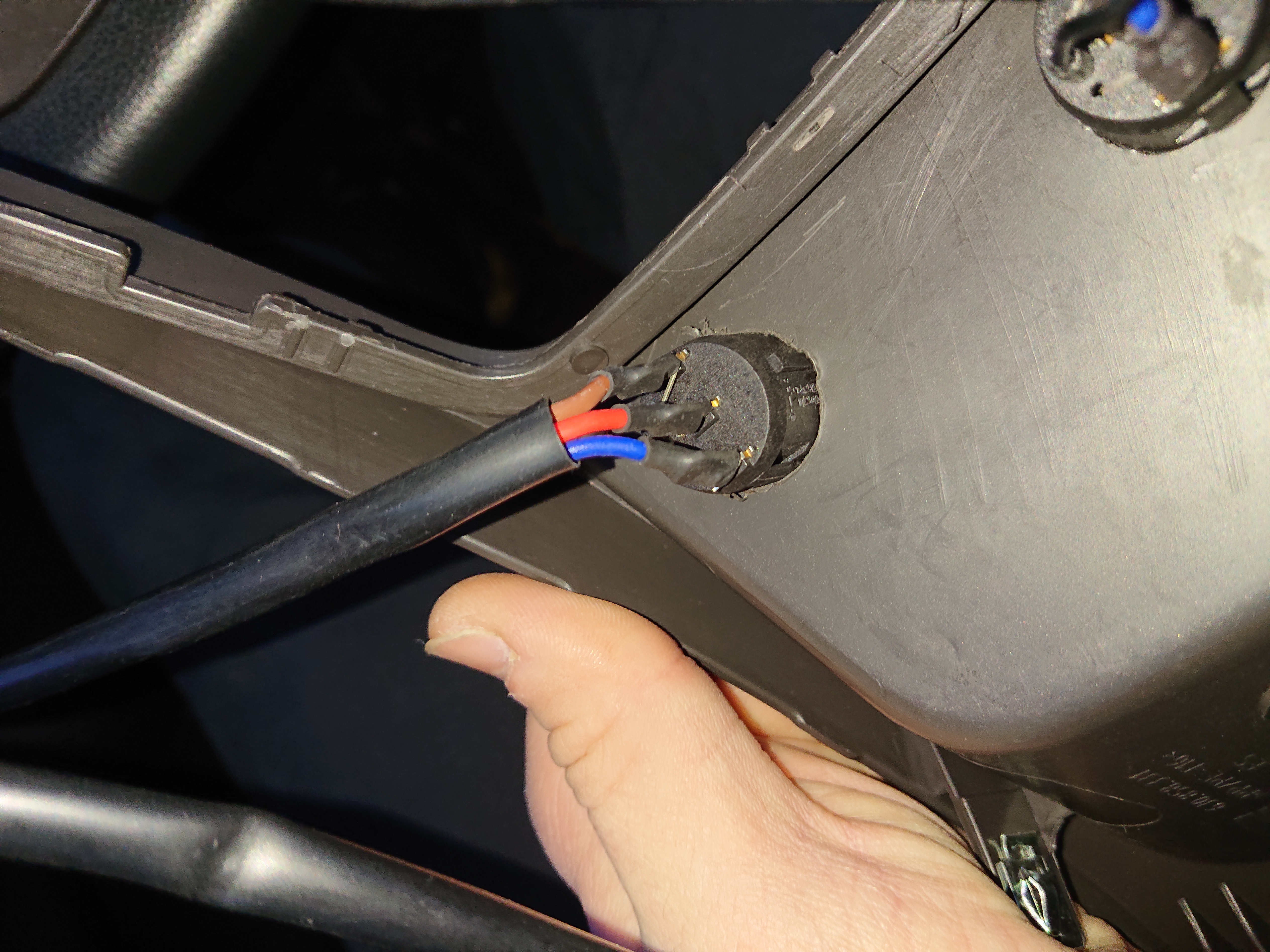

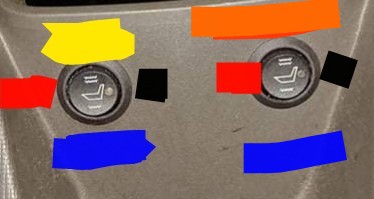

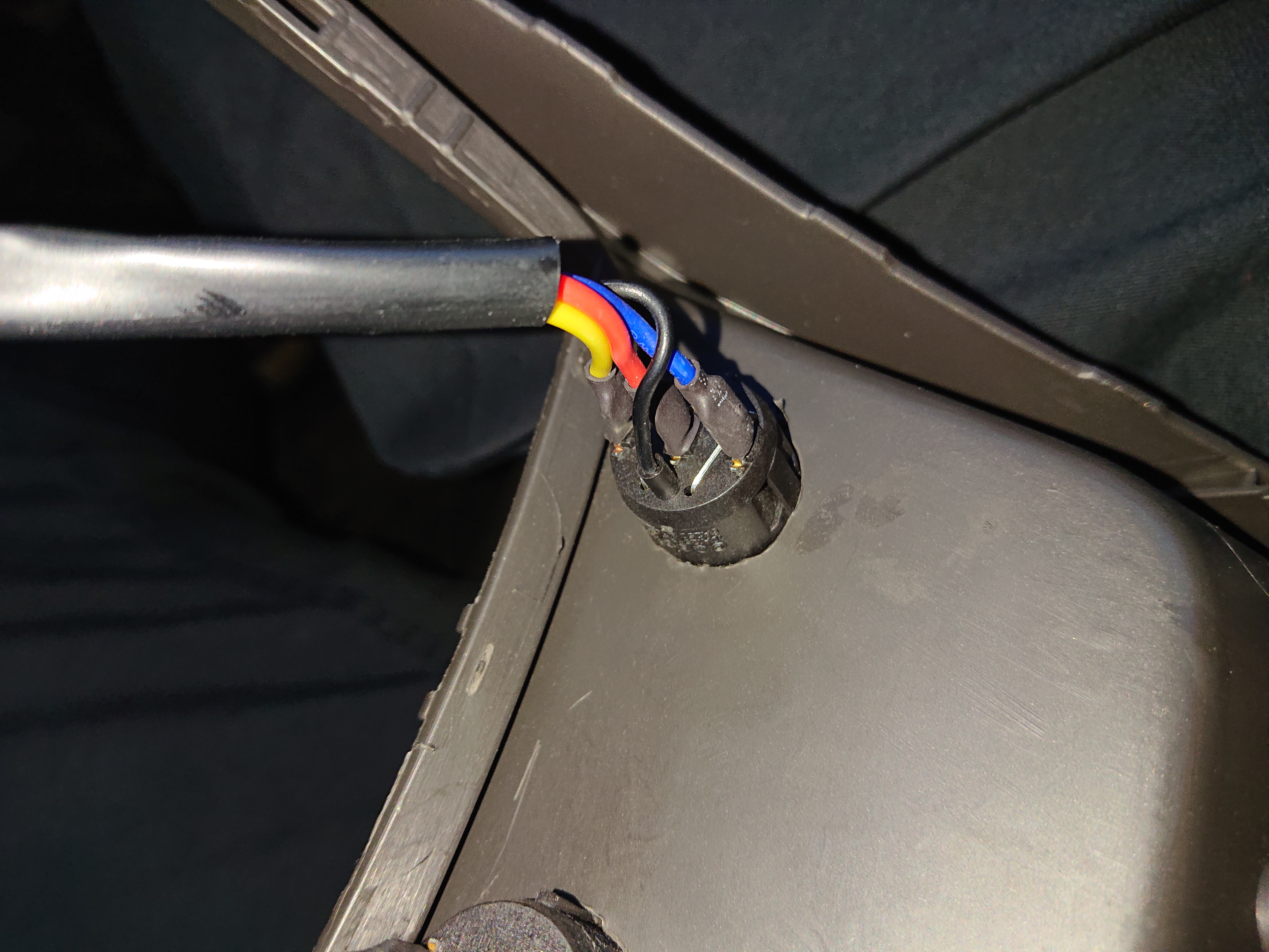

Do you have an idea how to connect heated mats to an original switch?
Red - (+)
Black - (-)
Blue - 1 heating power
Yellow / brown - 2 heating power
grzane dupy ori.jpg (289.38 KiB) Viewed 17393 times

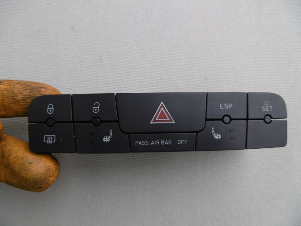

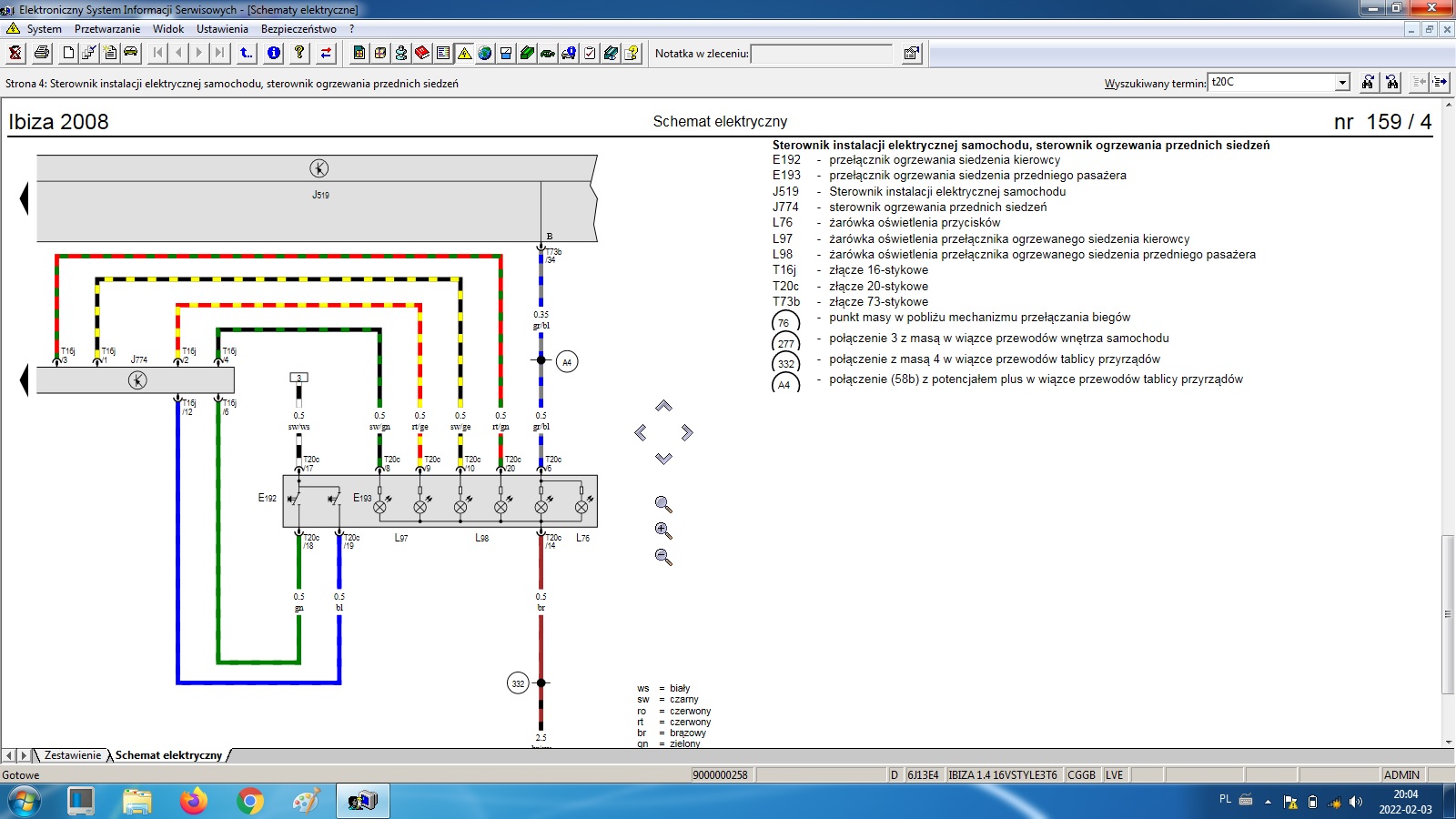

And you have an idea how to connect accessory mats to the original switch (6J0927137AB)
Bypassing the original module (6R0959772A)

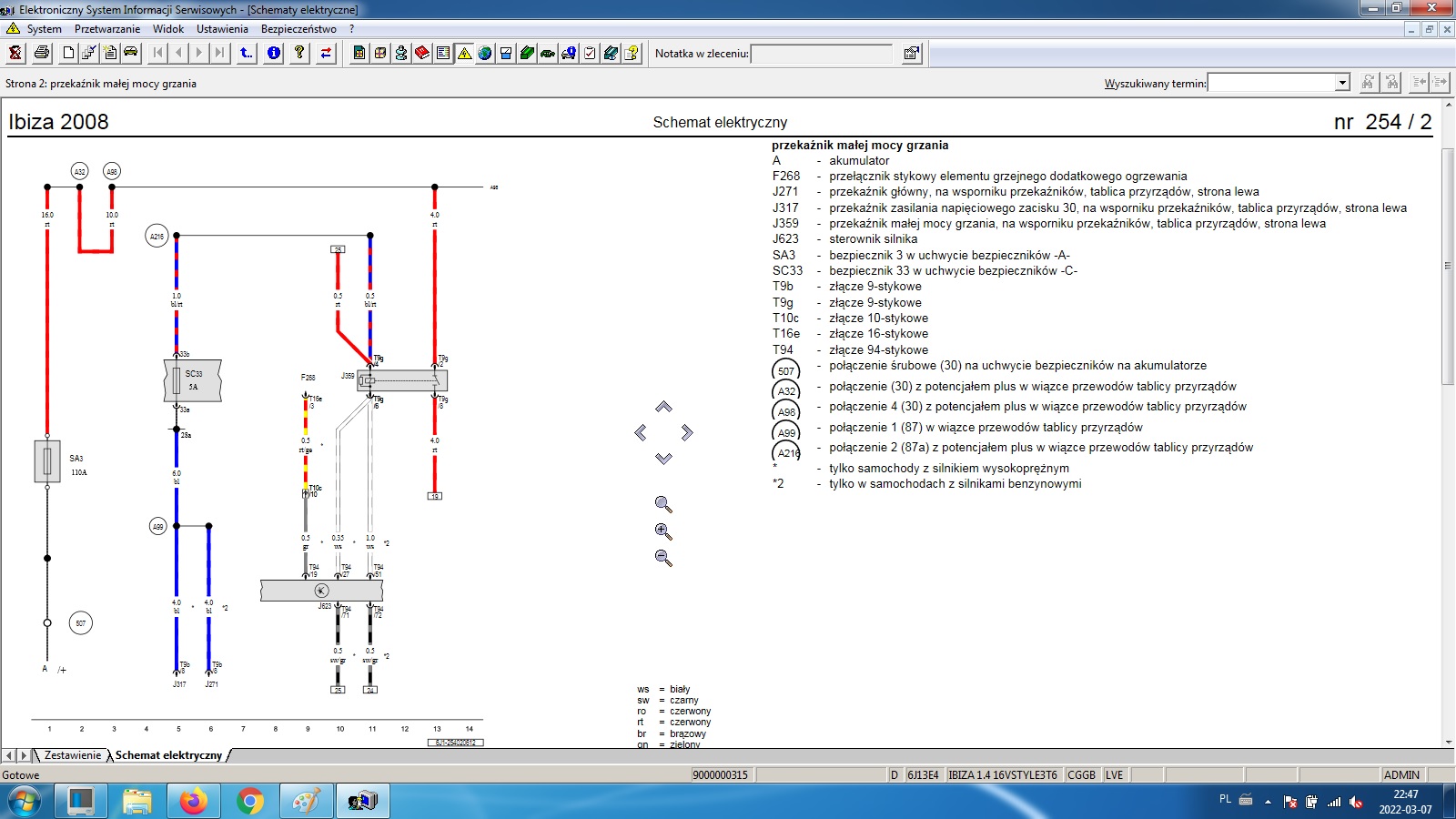

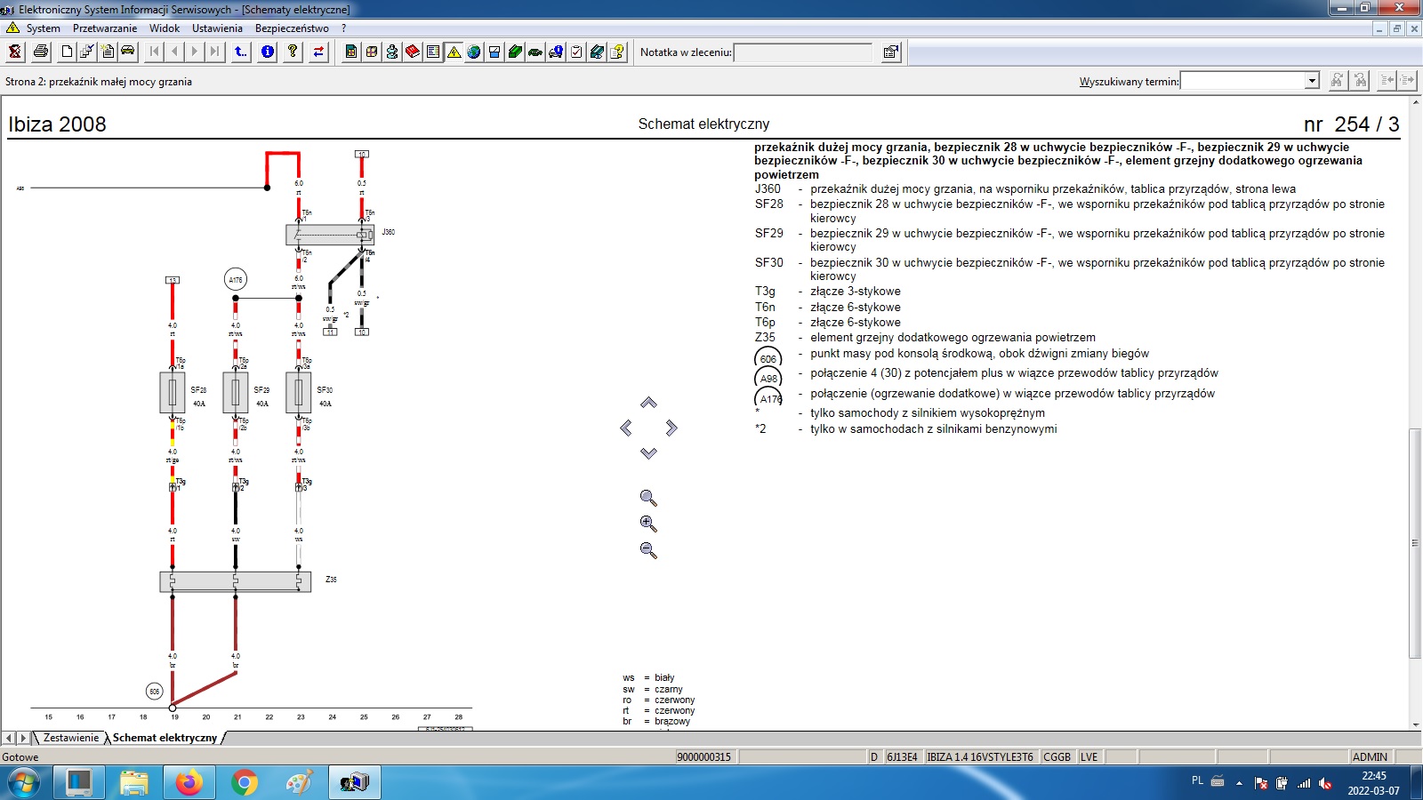

Cyclo, I'm in the process of establishing PTC. Additional electric heater. Looking at the diagram, 2 cables go to the motor controller.
Need to change engine computer encoding ??
On Polo 6R TDI, PTC heater is activated via ECU coding - code to climatronic. Not sure for older Bxx engines.

iichel wrote: Mon Mar 07, 2022 11:06 am On Polo 6R TDI, PTC heater is activated via ECU coding - code to climatronic. Not sure for older Bxx engines.
Do you know which byte / bit is responsible for the PTC?
I will do it according to the scheme from 2011 diesel / gasoline
Address 01: Engine Labels: 03C-906-024-BXW.lbl
Part No SW: 03C 906 024 CD HW: 03C 906 024 CD
Component: CGGB MM4HV G 8548
Verification: --H09 --- Serial number:
Coding: 0000071
Service code: WSC 00200 935 12345
VCID: 62CB1F8FBE4FB89BB5-5178
I honestly don't know if it's possible to do this. On Polo 6R TDI the J359 and J360 are connected to ECU, look here:

See the diagrams of Ibiza.
Sorry, I only have the Polish language version
I'm guessing
* is diesel engine
*2 is petrol engine?
the relay seems to be triggered by enabling GND connection by the ECU
so you could connect multimeter to the pins on the ECU and test how to trigger it.
I am not aware of any coding, you will have to experiment yourself.

iichel wrote: Mon Mar 07, 2022 10:11 pm I'm guessing
* is diesel engine
