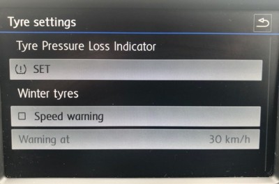

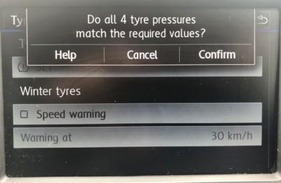

Re: Polo 6R ABS CODING
Posted: Sat Aug 10, 2019 9:34 pm
by massimo23
I have indirect tpms but no reset button. The reset function is present in the settings of the composition media unit.
Posted: Sun Aug 11, 2019 12:30 pm
by massimo23
You would need to change a byte in the abs long coding and also enable the tpms menu in 5F multimedia unit and enable tpms option in dashboard long coding.
Here is the menu:
