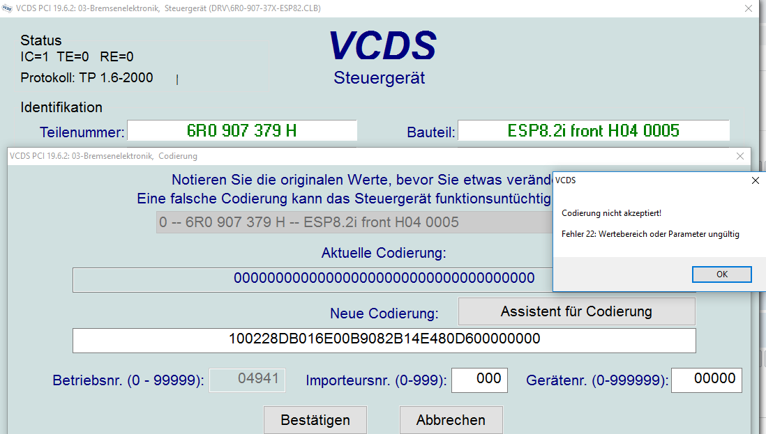

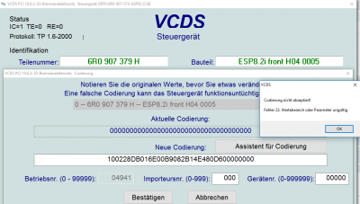

not acceptediichel wrote: Tue May 19, 2020 10:25 am Kannst Du bitte diese Kodierung probieren?
100228DB016E00B9082B14E480D600000000
Polo 6R ABS CODING

Re: Polo 6R ABS CODING
Last edited by joergleimbach on Tue May 19, 2020 10:37 am, edited 1 time in total.
Okay, pity. Next try please: 110224db416E00B9882B24E482D600400700
noiichel wrote: Tue May 19, 2020 10:35 am Okay, pity. Next try please: 110224db416E00B9882B24E482D600400700
- Posts: 6694
Next 110224db216E00B9882B24E484D600400700
no, also got disc at the rear
Last edited by joergleimbach on Tue May 19, 2020 10:55 am, edited 1 time in total.
- Posts: 6694
Can you please read the advanced ID of the engine and the immobiliser using VCDS and post it?
What happened to this car to lose ABS coding?
