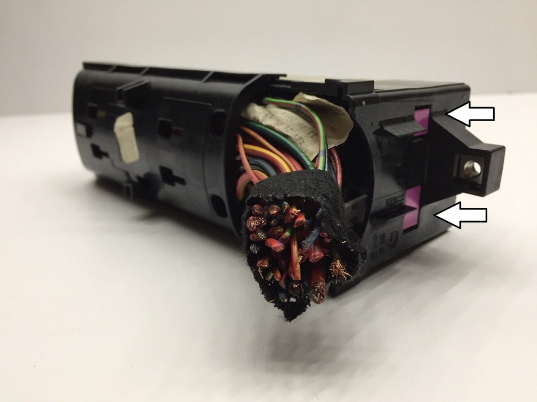

Today need to add a new wire in the fusebox for the heated washers jets.
I saw there's a locking mechanism but I do not want to risk to break something.
Do you know how to unlock it? Thanks in advance!
- Posts: 8994
Re: Franciswat's Polo 6R 1.6 Bifuel
Use a flat screwdriver to move the locking mechanism as you see in the image.
Sometimes it's a little hard the first time ... nothing will break.
