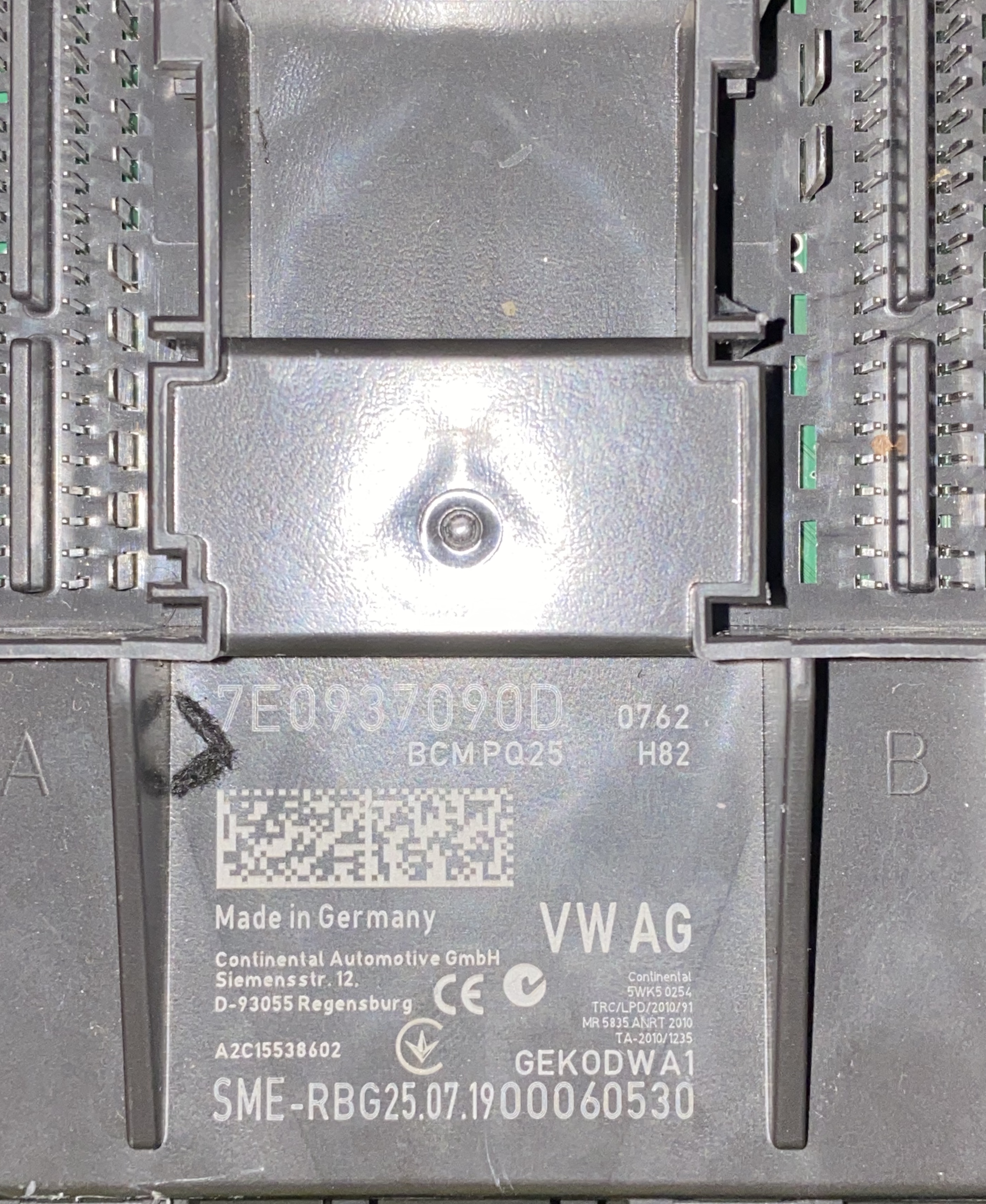

090D 0762 H82
Anyway I just find out on one of the 090D BCMs I have, when I disconnect number plate light wire T73b/7 all lights working fine ( obviously without number plate ), ilumination switches off as well
Problem with this BCM is I cant add any remote controls, Channel 1 not available

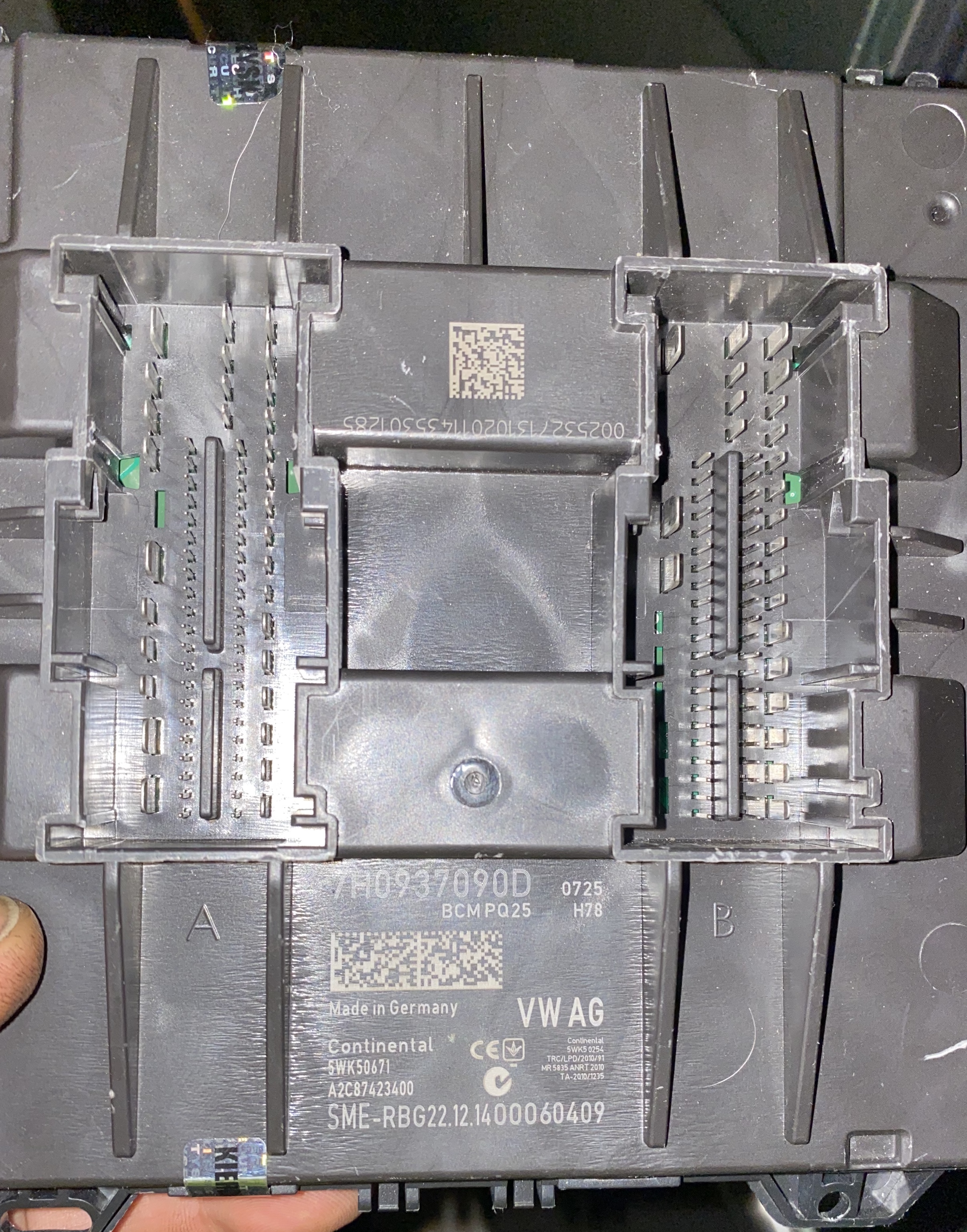

090D 0725 H78
On this one DRLs working only on O and AUTO when main beam is off, when main beam off no DRLs other lights and ilumination works fine ( obviously without number plate )
Remote controls works with this one as well

Regarding BCM in which channel 1 is not available is something we are studying. It is something new that is not yet clear. Perhaps from a manufacturing date of the PQ25 BCMs an online connection and IMMO data will be required to match the remote controls (as on other platforms).
Forget the tests you have done with this BCM, they are not useful even if the lights work.

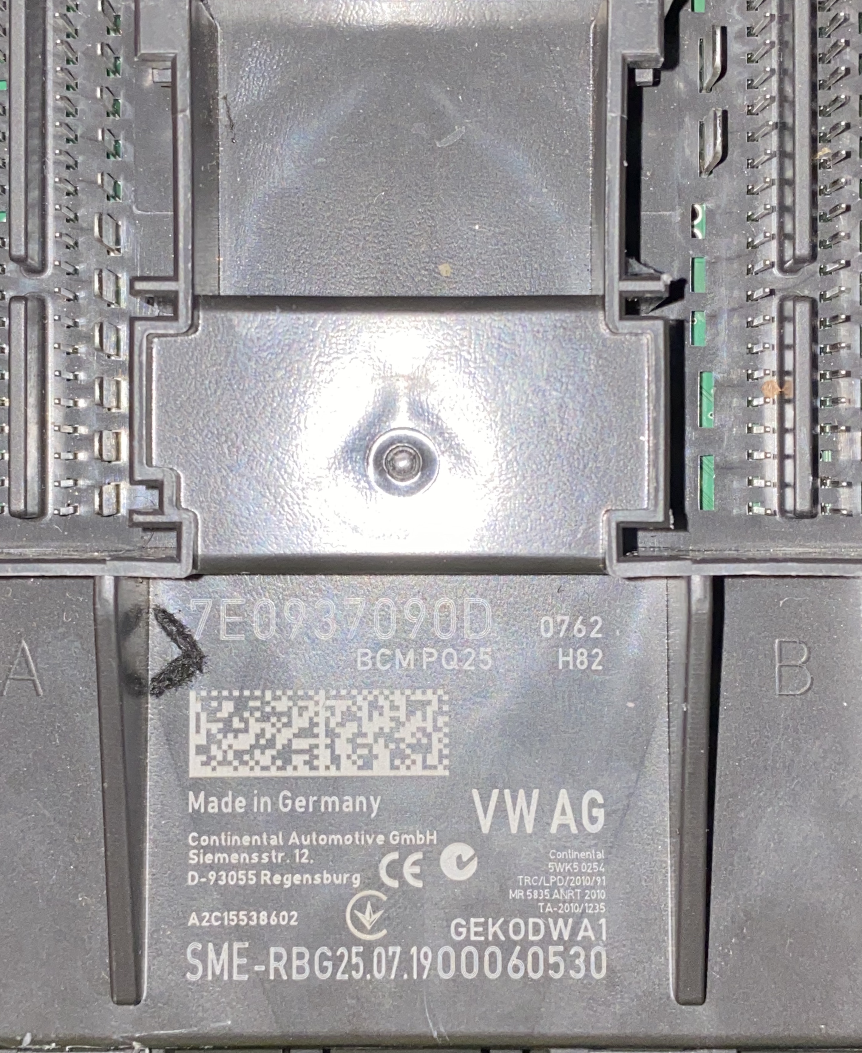

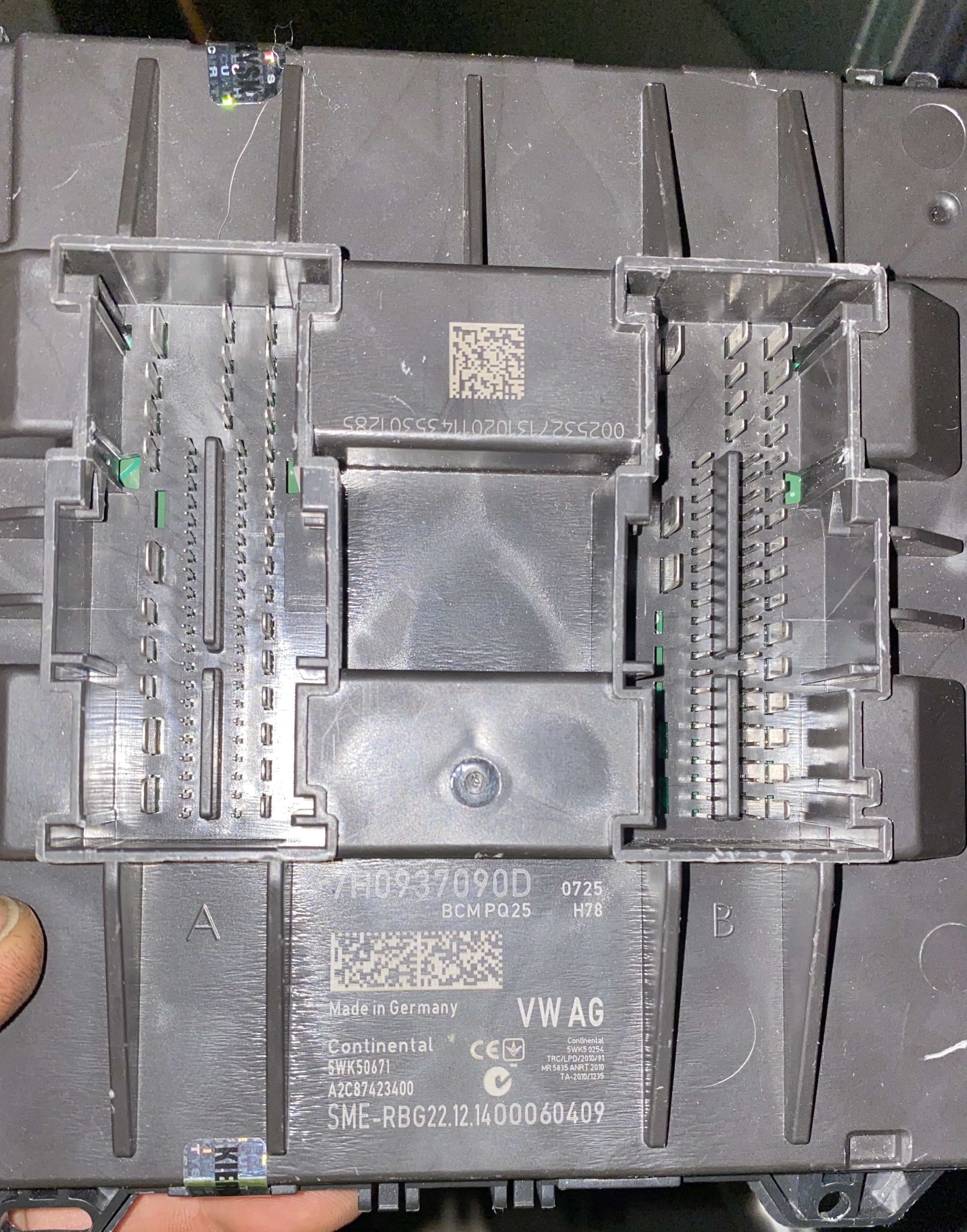

Please take two photos of the two BCMs from the area where the reference number and the info are located. Thank you.

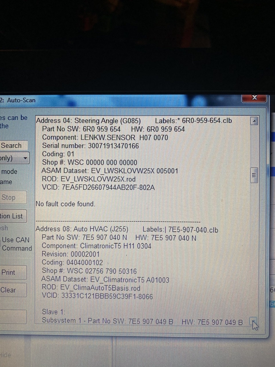

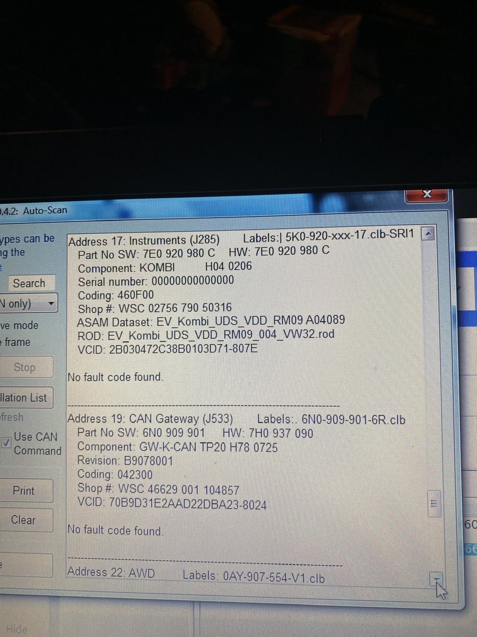

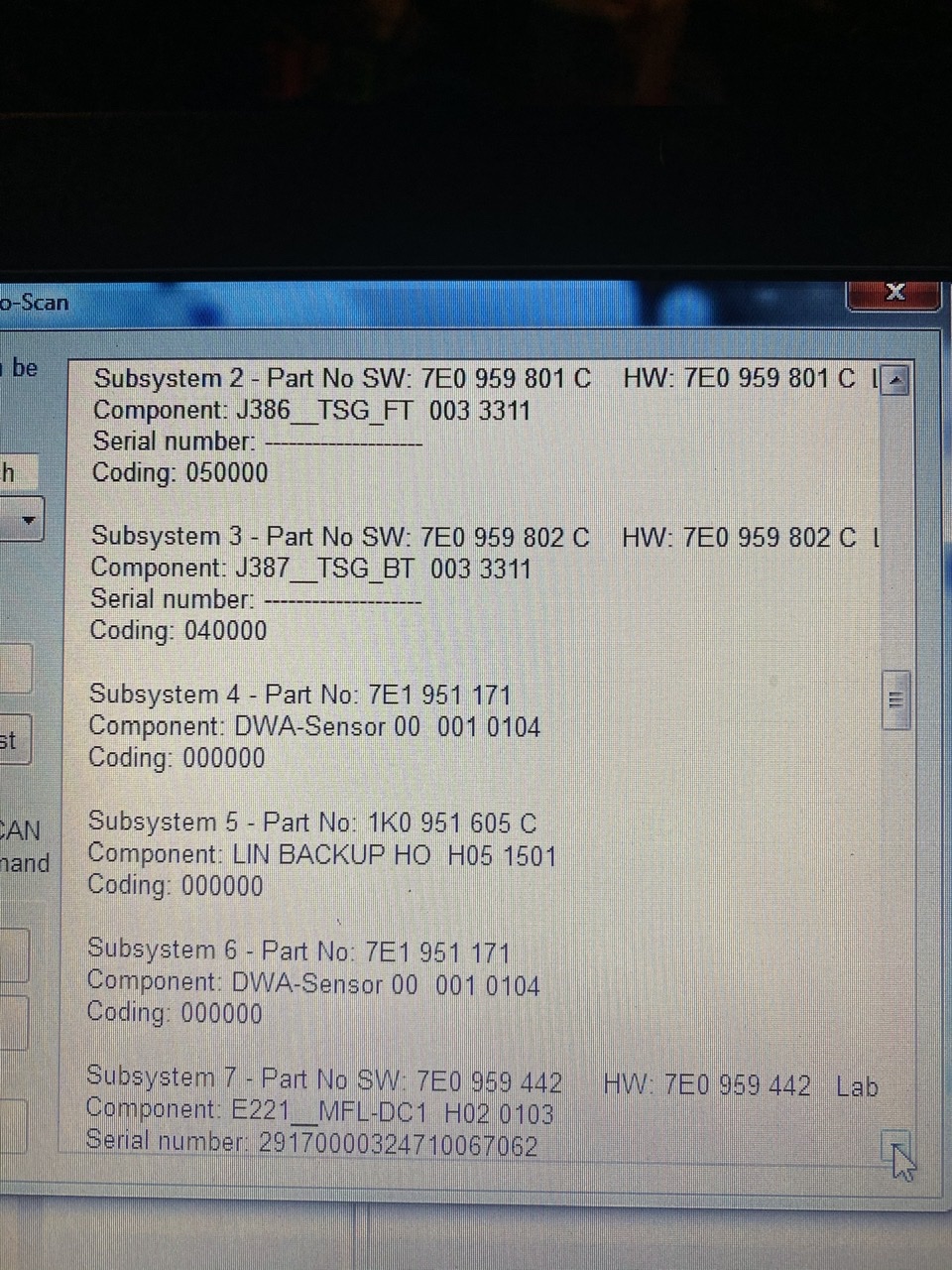

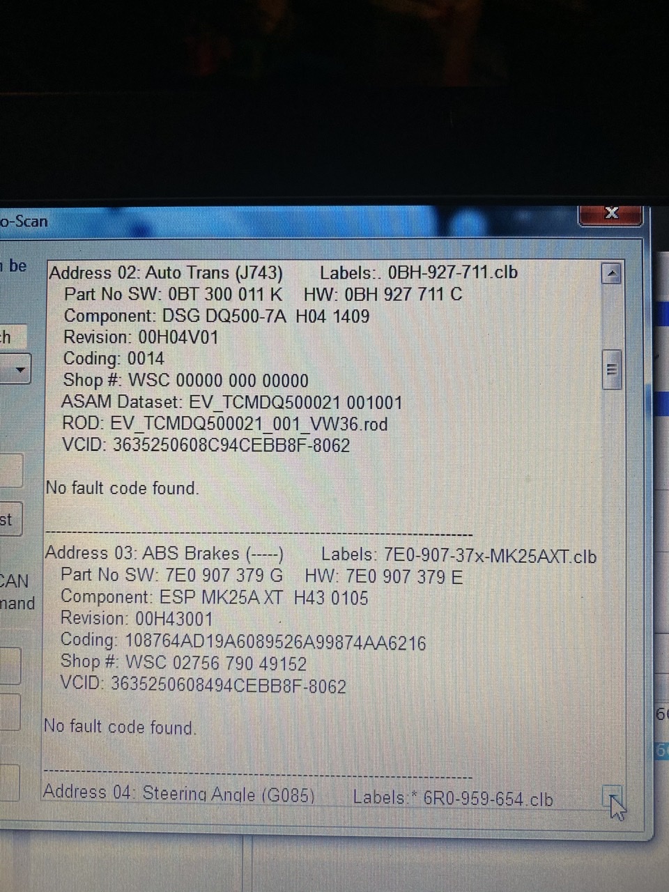

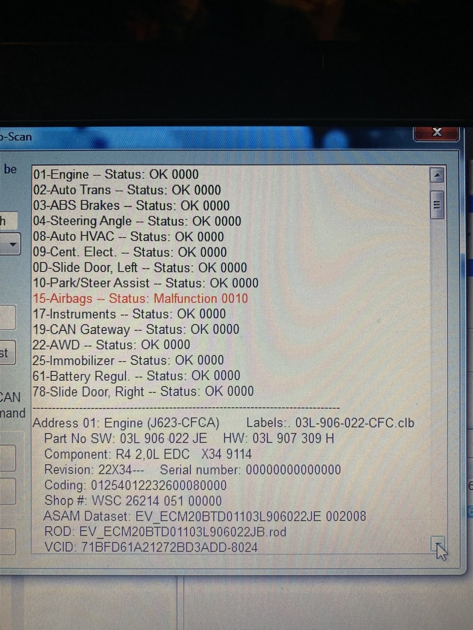

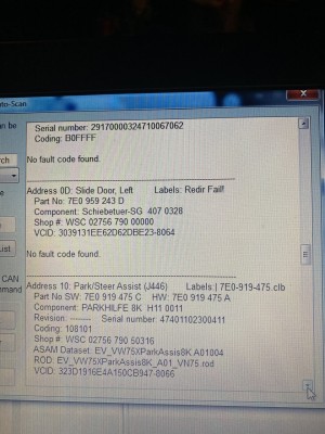

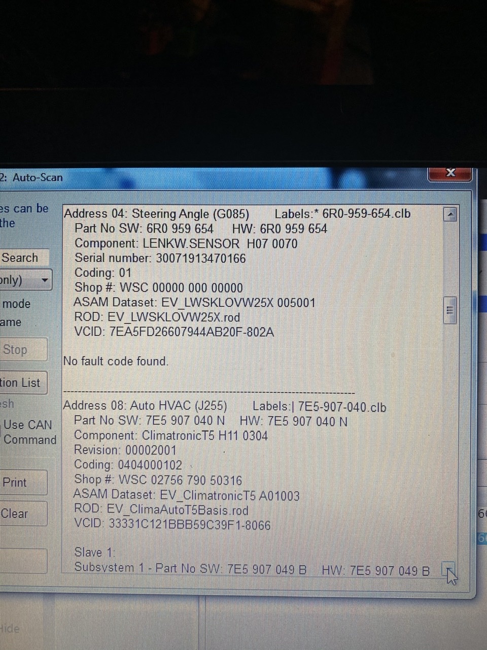

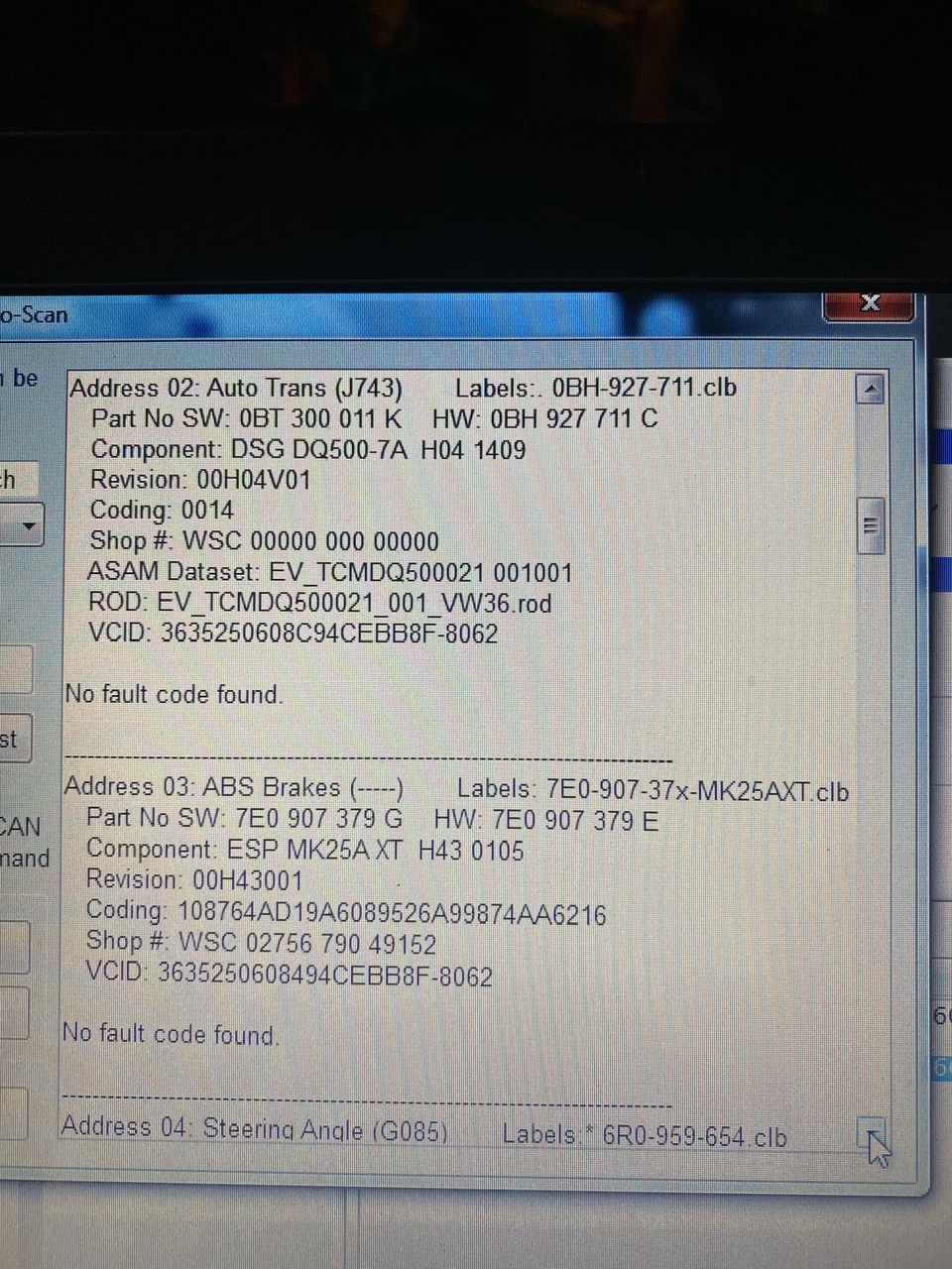

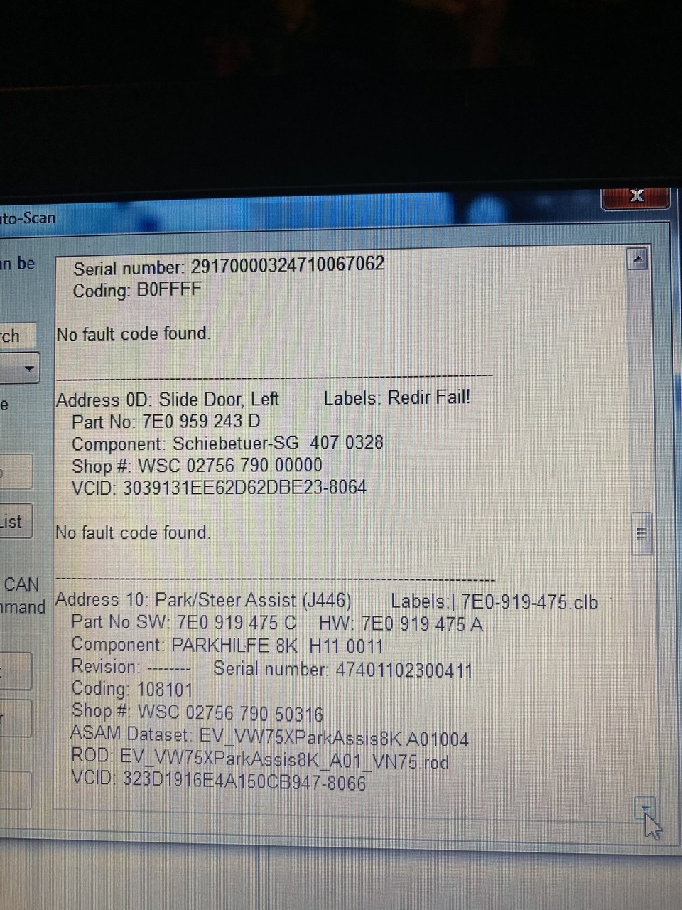

Sorry only way I dont get a message forbidden contains contact

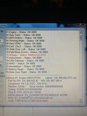

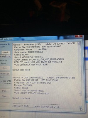

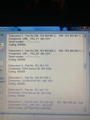

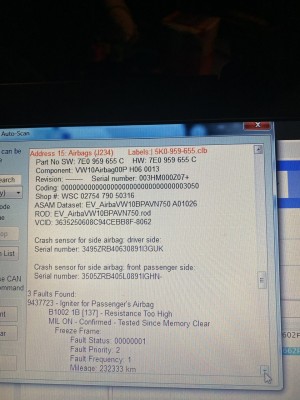

Latest auto scan
Latest auto scan

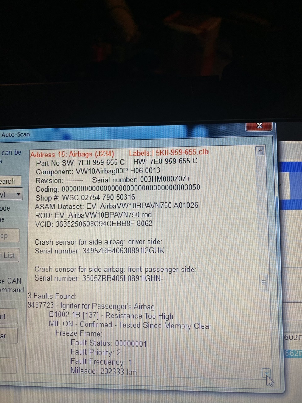

Igniter is connector under seat.

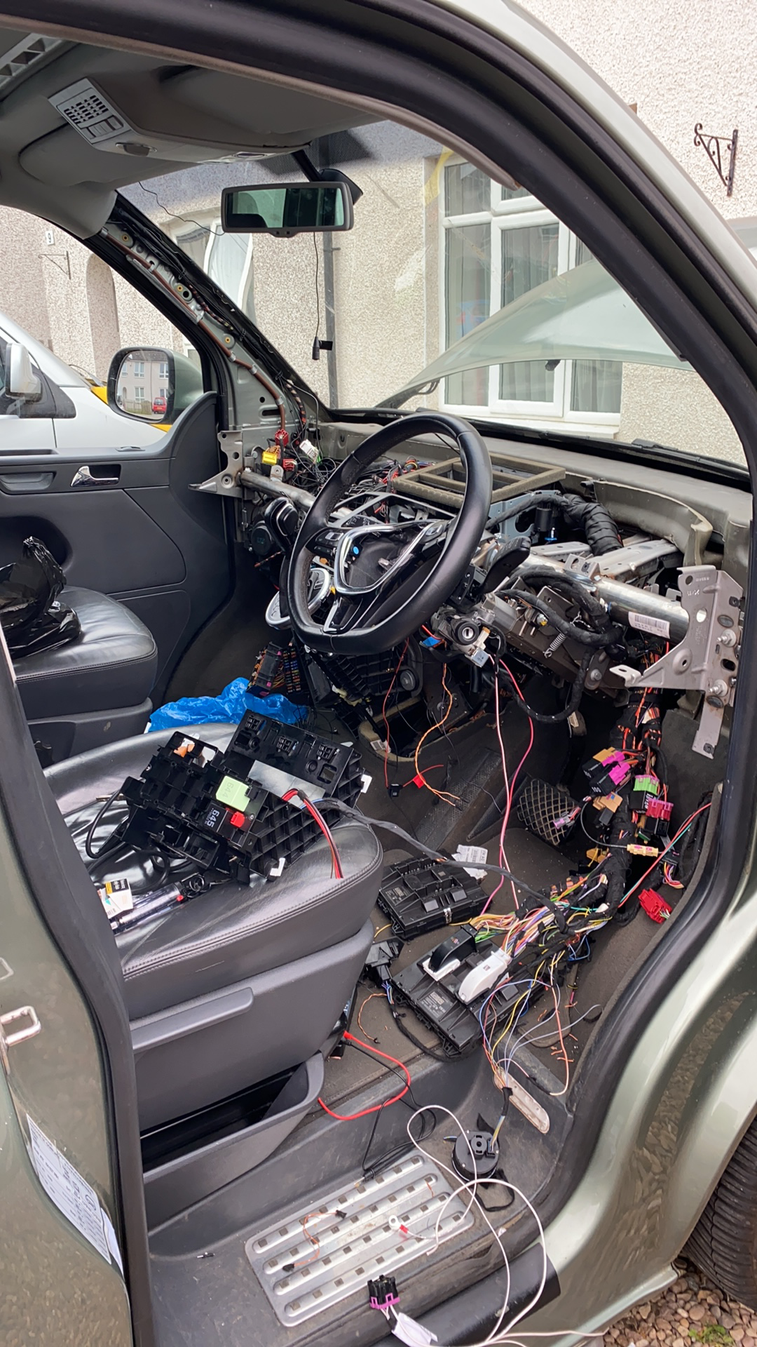

I dont have airbags connected, I dont want to put dash back on before everything works
On top of Xenon and auto lights I do T6 dashboard,
On the way back home my windscreen was hit by something and I have lovely crack all way down from top to the bottom, so I now I think about heated windscreen retrofit as well

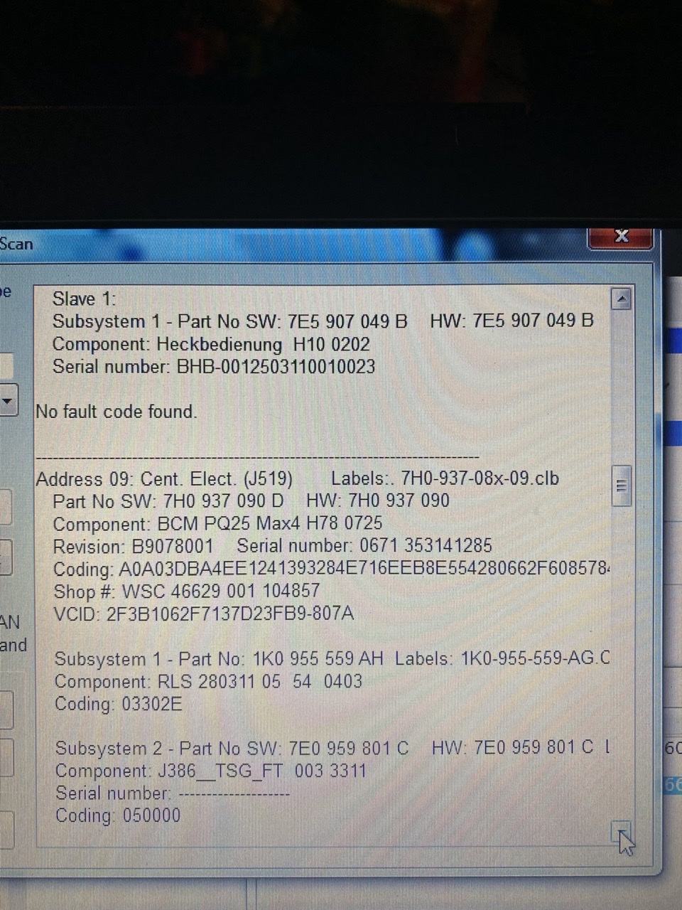

If I will send you scan just of 09 Central electronics is that any good or full scan required

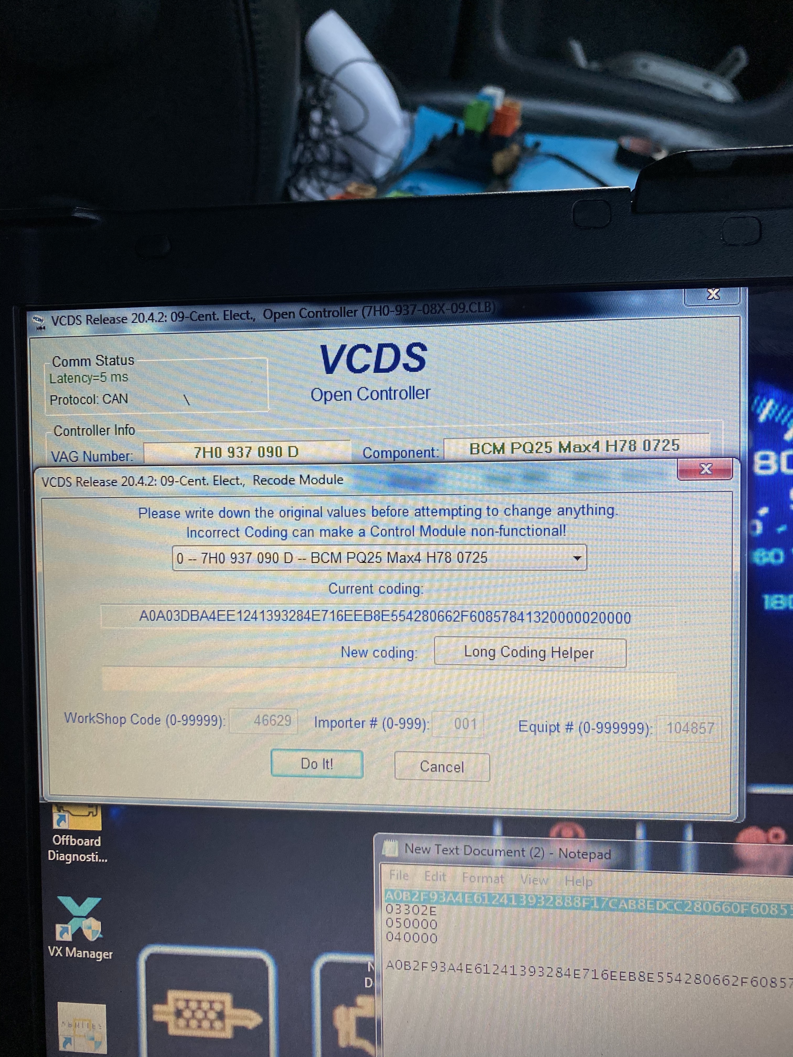

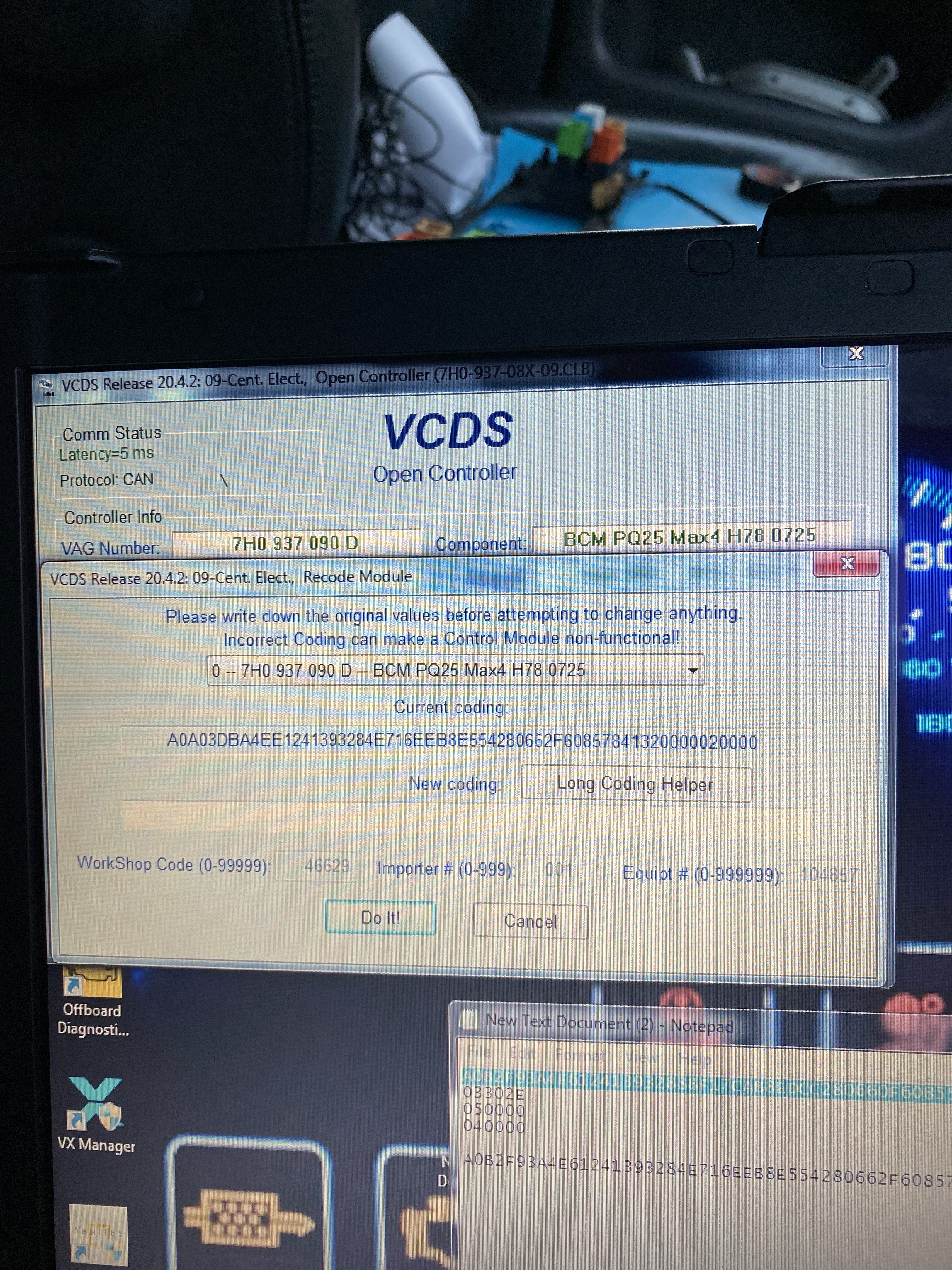

Please copy and paste the BCM coding exclusively here. I thought you would understand that this is the only way I can check your BCM coding easily, quickly and efficiently. Thanks.
With photos/images I would have to write one by one each Hexadecimal value of all the Bytes of your BCM, that's why I told you that I had no intention of doing it ...

- Posts: 8835
Thank you very much for the images.bropasiek wrote: Tue Sep 15, 2020 4:24 am Remote controls work on this one, no dimmed DRL with main beam, no DRLs on side light position, high beam not staying on
Remote controls doesnt work on this one, all lights work correct,except high beam not staying on

- Posts: 8835
Your BCM coding is correct.
A0A03DBA4EE1241393284E716EEB8E554280662F60857841320000020000
Recheck the wire T73a/62
viewtopic.php?f=56&t=70736&start=45#p528735
Recheck the wires for side/parking lights (58L/58R)
viewtopic.php?f=56&t=70736&start=30#p528541
Recheck in ETKA for the reference number of Bixenon Headlights cotrol units.
If the above is correct it may be necessary to parameterize the BCM with VCP.
