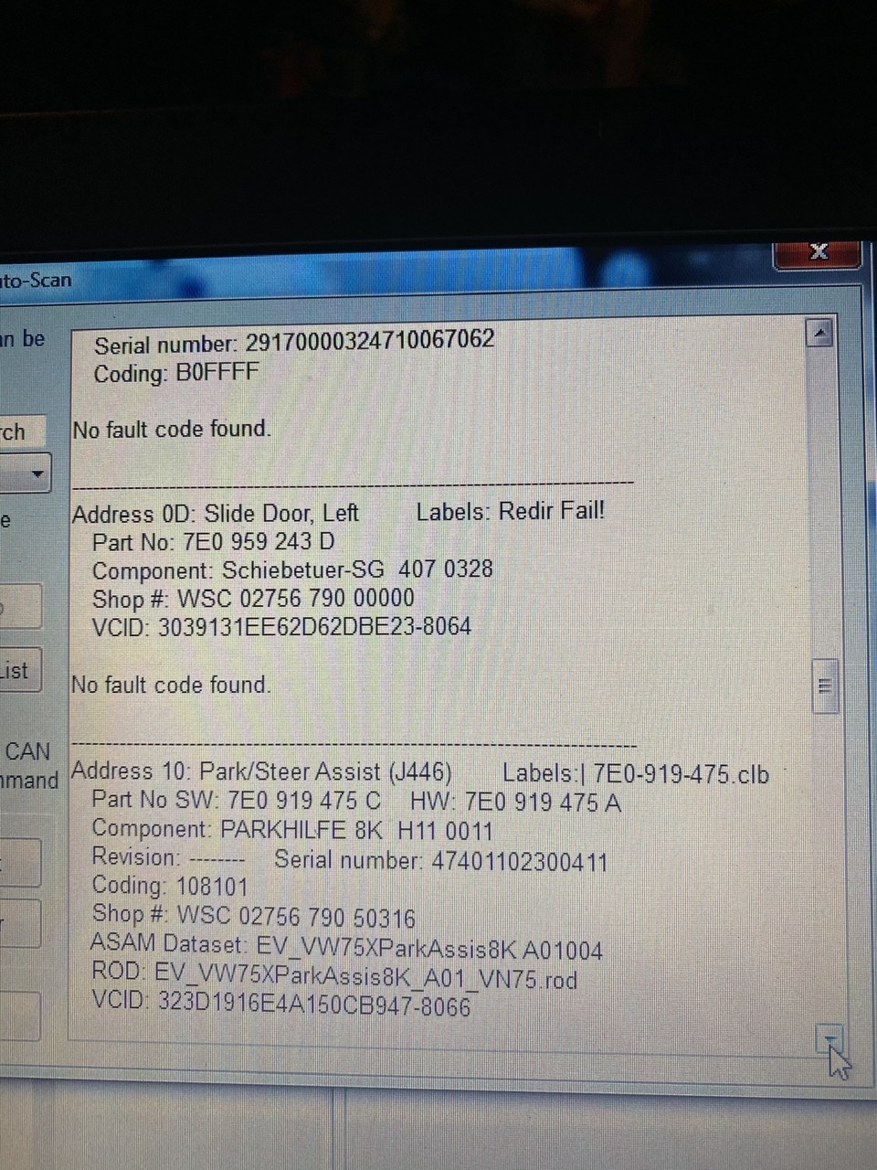

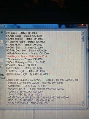

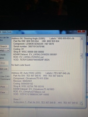

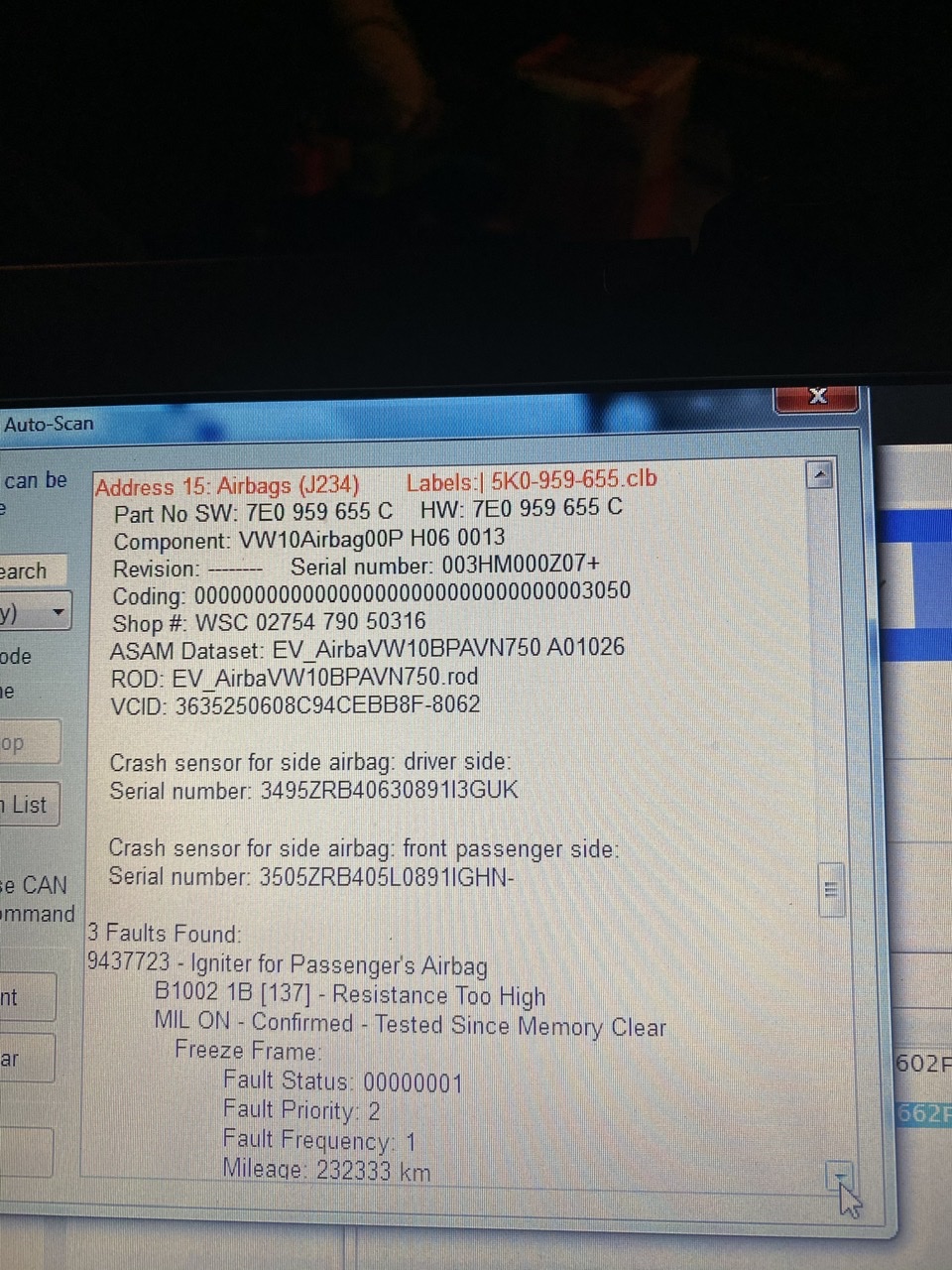

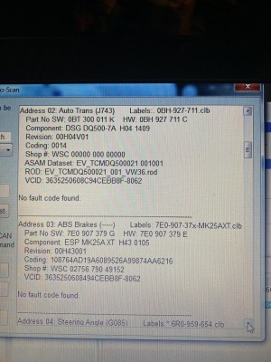

Sorry only way I dont get a message forbidden contains contact
Latest auto scan

by amer6R
Igniter is connector under seat.
Posted: Tue Sep 15, 2020 12:03 am
by bropasiek

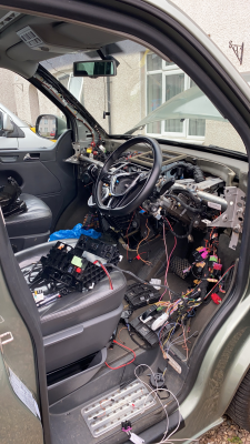

I dont have airbags connected, I dont want to put dash back on before everything works
On top of Xenon and auto lights I do T6 dashboard,
On the way back home my windscreen was hit by something and I have lovely crack all way down from top to the bottom, so I now I think about heated windscreen retrofit as well
