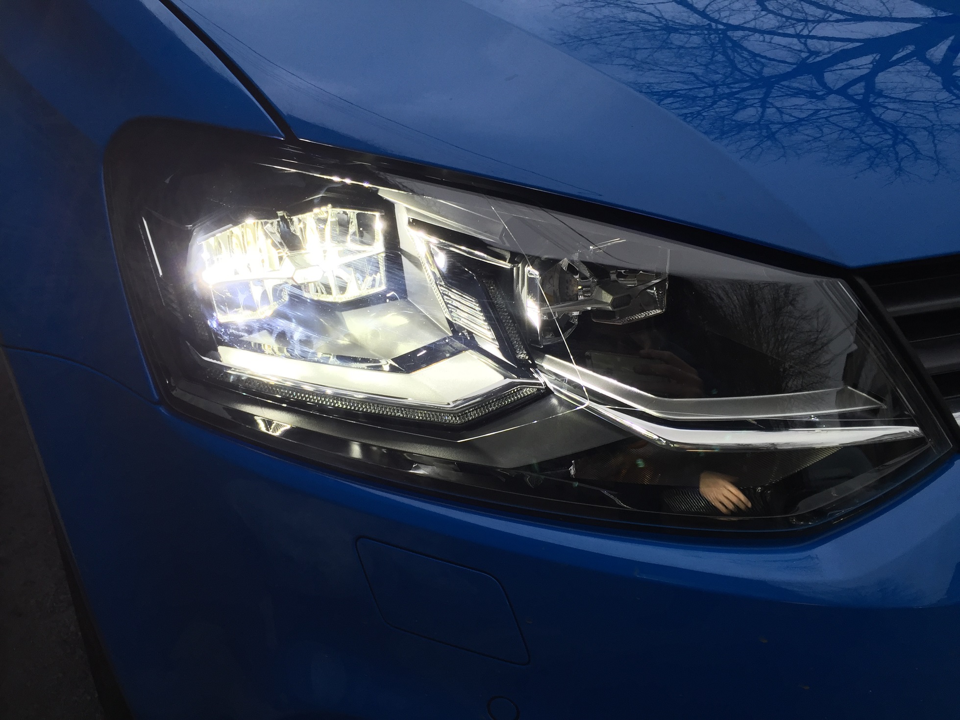

I am planning to upgrade the H7 halogens in my Polo 6R to Bi-Xenons. Before finalizing I wanted to check out the LED headlights as well. The LED lights look much cooler than the BiXenons, but performance is the primary criteria for me as I often drive in winding roads in mountains.
From an earlier comment from "ciclo", one drawback in the LED headlights is that they do not have the cornering lamps that are present in the BiXenons. In the winding hill roads that I drive often, a cornering light is a boon (the cornering light function in my fogs is as good as nothing). So lack of cornering lights in the LED headlights is a big drawback.
Has anyone had a chance to compare the OE BiXenons and the LED headlights back to back? How is the lighting of the LEDs compared to the BiXenons in terms of beam pattern, brightness etc. Is there any feature where the LED lights outperform the BiXenons?
- Posts: 6695
Re: Polo LED headlights
I have had both in my cars. I think the bi-xenons and LEDs put out about the same amount of light.
The plus of the LEDs is that they have a seperate high beam so double the light. The bi-xenons have a lens that pops up
The plus of the bi-xenon is the excellent static cornering light.
Living in Switzerland myself, I rate both very well for rural driving. To say which one is better, I don't know.
I prefer the looks of the LEDs and they are a bit more rare, so that's why i'm driving them.
Thank you so much for the feedback.iichel wrote:I have had both in my cars. I think the bi-xenons and LEDs put out about the same amount of light.
One advantage I was considering with the BiXenons compared to LEDs is the dynamic cornering where the Xenons track steering wheel movement. From your comment in the other thread, the Xenons for Polo 6R do not have left right movement, only up and down, which should be available in the LEDs as well. As you have said that in terms of performance, both are equal, the only advantage of the BiXenons is the cornering lamp. And the LEDs have the advantage of being cool and unique. This is turning out to be a tough decision indeed!
Have you taken any video or pictures of the LED headlights in terms of light output, low beam and high beam spread etc?
Also, are the LED bulbs replaceable like replacing a HID or halogen bulb?
It is certainly a difficult decision. Remember that the Static Cornering Lights only work up to 40 km/h and with a large angle of steering wheel (roundabouts and intersections mostly). Maybe bixenon headlights have no better utility than Led's headlights for those mountains.
