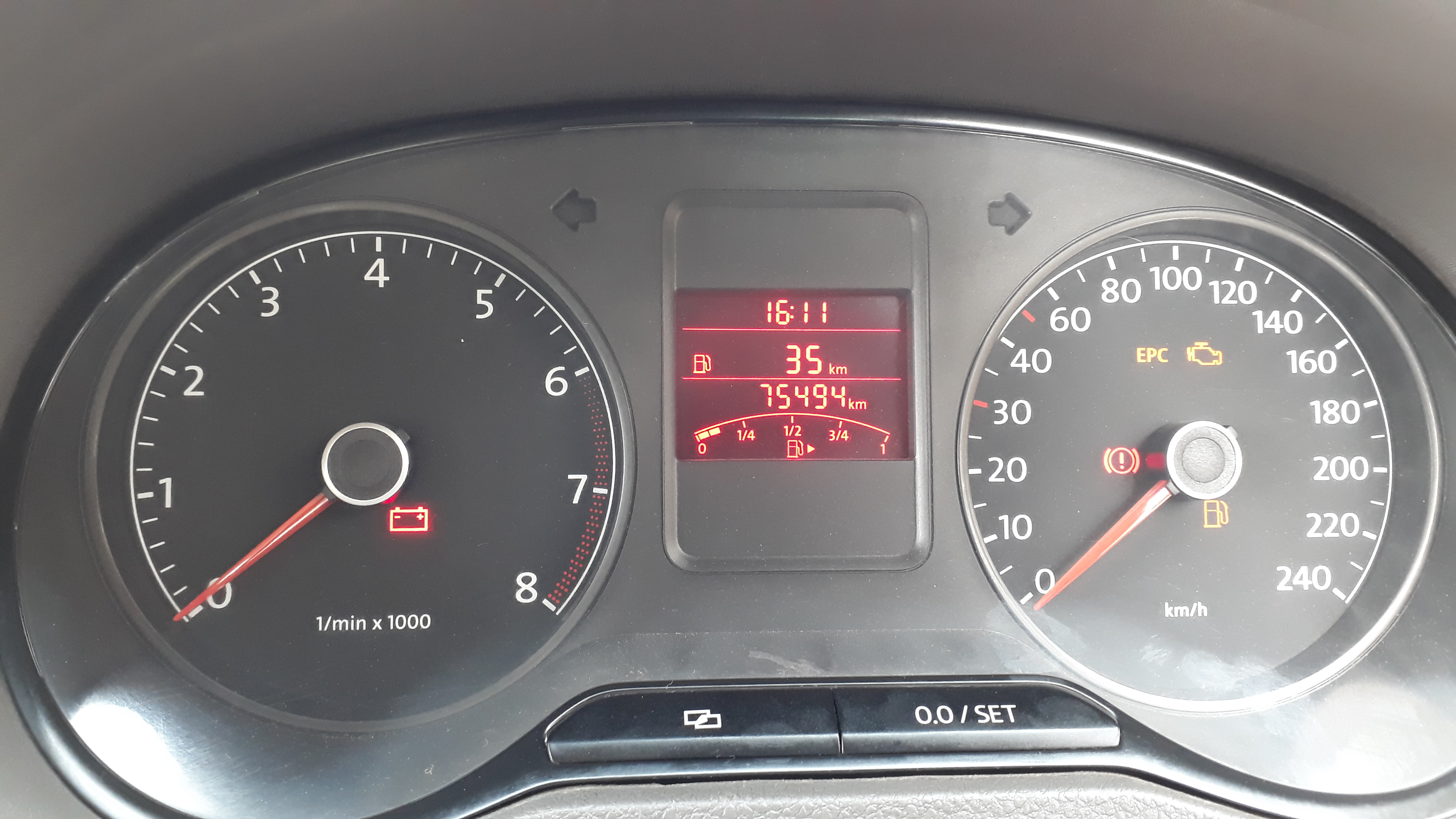

Hi folks
I have a VW Vento (polo sedan) 2010, I have attached the image of the cluster and wanted to know if it is possible to activate the needle sweep on that cluster? also does the BCM has to do anything with the activation of needle sweep feature? My BCM part number is 6RU937086B.
Please throw some light on this
Thanks in advance :D
Re: Needle sweep
If you have VCDS, have a look at the adaptation channels of your instrument cluster. Look for 'staging' or 'indicator celebration'
