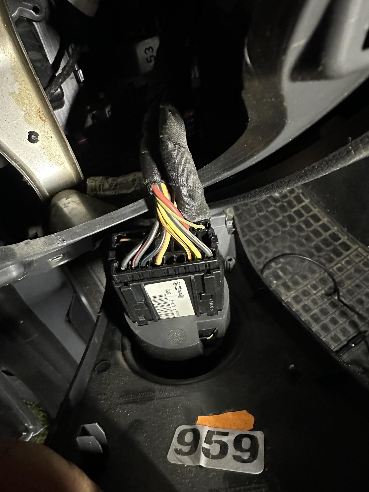

please help. i installed new original headlights + wiring harness kufatech. daytime running lights work when i start the engine and the light switch is in the zero position. low beam, high beam work + turn signal but no daytime running lights. no parking lights
i don't have automatic lights
module is 7H0 937 090

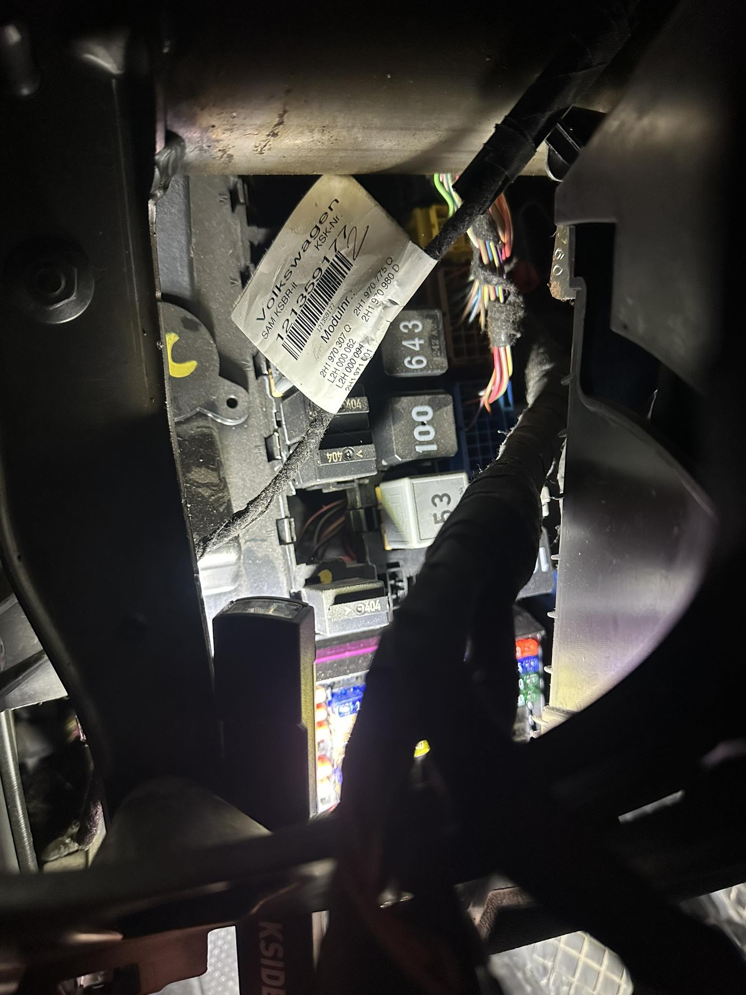

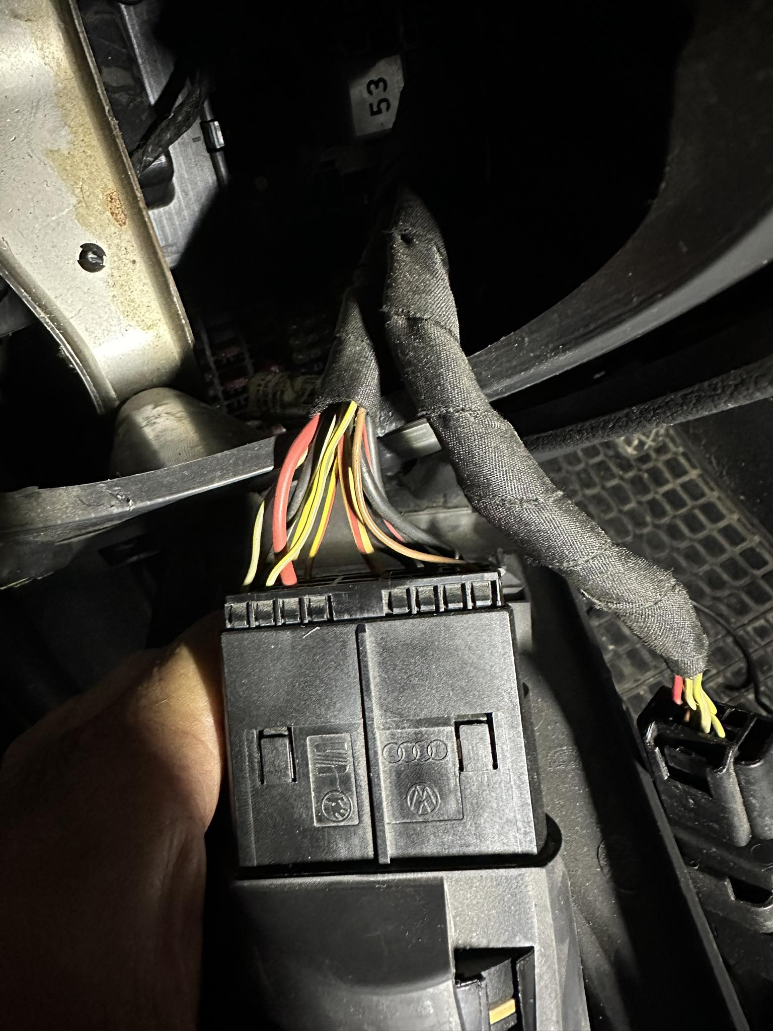

hello, according to the wiring diagram of my car, it shows that there are cables from pin 4 of the headlight to the bcm.
Posts: 8982
Re: Help with PQ25 Max BCM and bi-xenons
T10/4 is for the DRLs, and you say the DRLs are working properly.
T10/10 is for the parking/side lights, which is what you say doesn't work.
The question is, is the T10/10 wire correctly connected to the BCM? (as shown in the diagrams I post previously)
There are two possibilities:
- Connected to T73a/40 and 41, which is incorrect for bi-xenon headlights. (usually for halogen headlights).
- Connected to T73b/5 and 6, which is correct for bi-xenon headlights.
