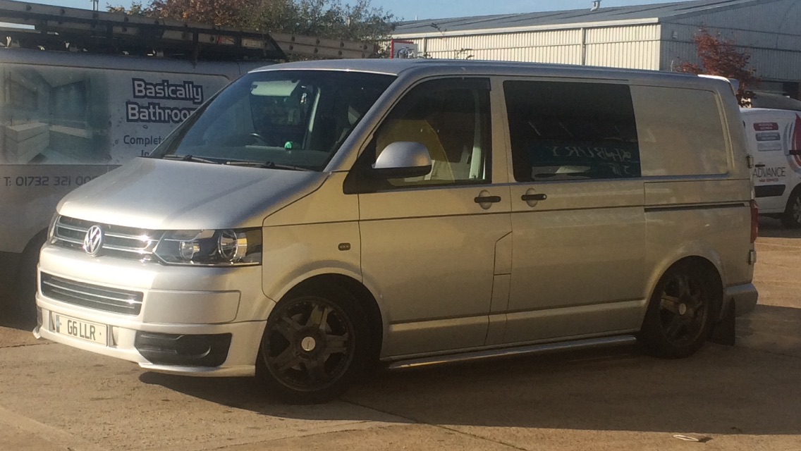

Wow great work!
I too have a Vw but mine is a 2005 trendline with the T5.1 facelift.
Hybrid turbo with bigger injectors etc..
Had it nearly 10 years now and still love it. Also the wife’s got a VW Eos and my daughter has a 1.2 polo s as her 1st car.
Keep up the good work!
BJ.

Builderjay wrote:Wow great work!
BJ.
Nice T5 [emoji41]
I went down that rout with my caddy (hybrid, injectors etc) and it was epic, but as it’s used as a daily for work it was t practical and if any problems were to arise it wouldn’t be as easy and quick to fix as if they were standard parts, a remap is in order when the warranty runs out tho [emoji16]
