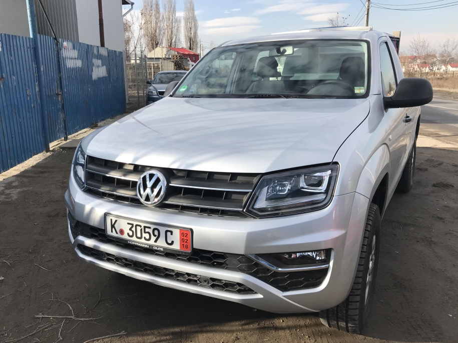

georgenis
- Posts: 72
- Joined: Tue Feb 06, 2018 2:55 pm
- Drives: Amarok
- Location: Romania
Re: Amarok Oem Bixenon retrofit
The low beam and high beam and range button are working now. They cannot be left like now?
