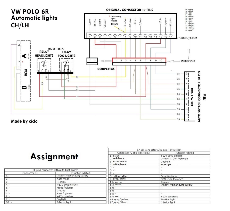

Due to the autoscan, who made and installed your wiring for automatic lights?
Check it.

Did it myself according to your diagram, will double check later today
t17 to t10 alw.PNG (257.1 KiB) Viewed 867 times

ciclo wrote: Fri Feb 19, 2021 5:51 am Due to the autoscan, who made and installed your wiring for automatic lights?
Check it.
Of course! it was my error.. It's fixed now, and everything works perfectly!!! :mrgreen: :mrgreen: :mrgreen:
Thank you for all of your help! It's much appreciated !
