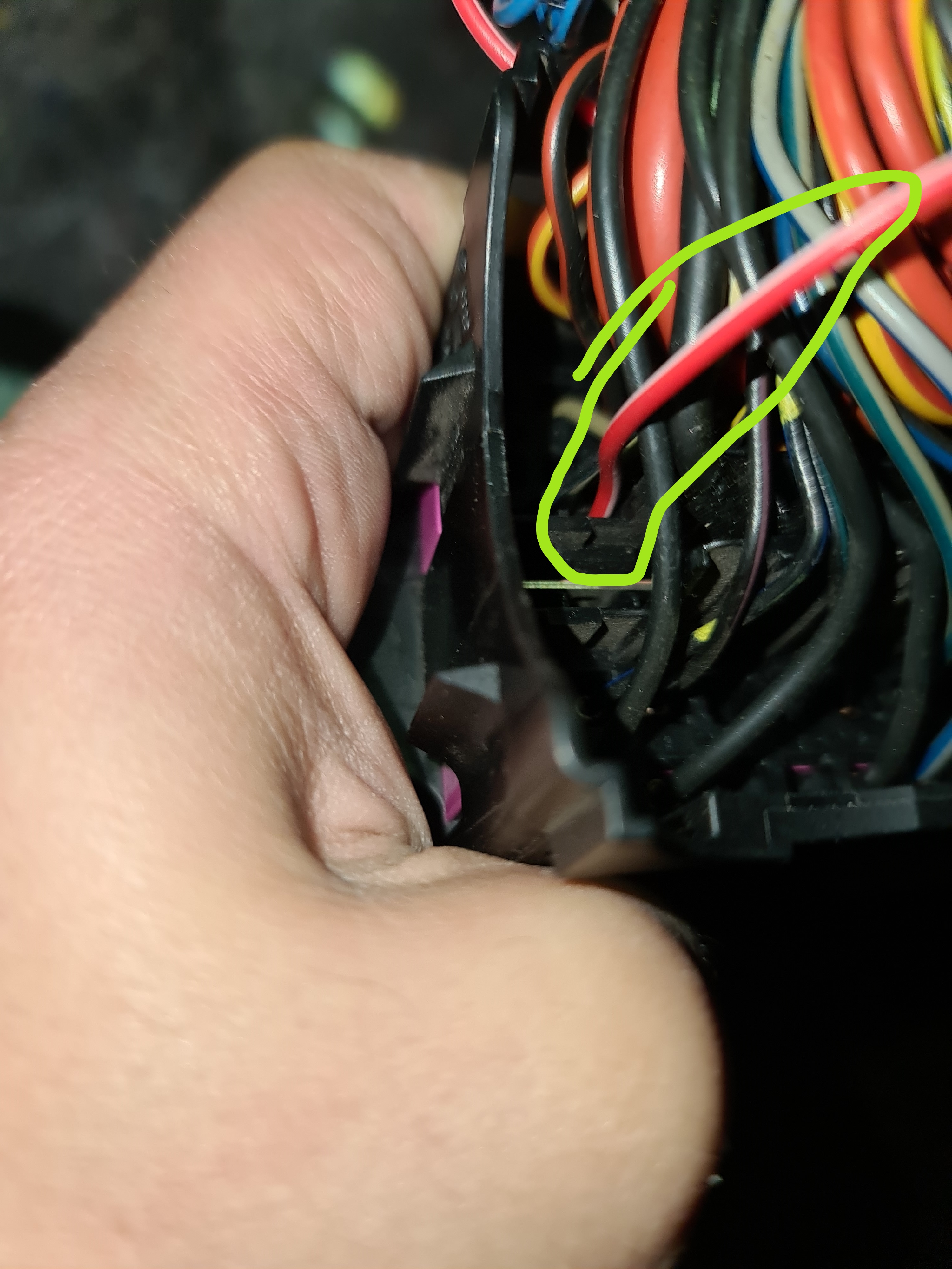

ZahariGeorgiev wrote: Fri Nov 05, 2021 2:52 pm I will say this: ciclo you are a GOD man:)
Thank you so much for the support!
I just coming form the garage and enter this code: 3EB82BBF48A10000013806F13CEB9FD9FF80600F60053041200000020000
And YES, finally working front parking lights. They not work exactly well - when i put lighting switch to off position - parking lights are on at full power-->in these conditions they are not the parking lights, they are the "DRL", it is totally correct, when turn on auto position - they are not so bright, same is for parking light position and low beam (I am not really sure is this the right behavior)-->it is as it should be
, and they don't turn off when got blinkers on ---> New BCM coding 3EB82BBF48A10000013806F13CEB9FD9FF80600F600530C1200000020000.
Also low beams doesn't activate when i put the switch to low beam... only when the switch position is to off position first time i unlock the car. Still got the error for Non coded module and no basic settings in headlights, and of course cannot perform them - Coding rejected.Error31: Request out of range. Still flashing lamp and AFS error on dashboard.
This strange behavior of the lights is related to the faults shown in the diagnostic. Install new dimmer and retry basic setting for headlights and coding for unit 55.
You may need to parameterize the headlight control units, as iichel told you, I am not aware of these details for the 6C LED headlights, but it is something that I had to do at my wife's Golf.
About the auto lights - you did the wiring for me... wiring for gods.
For the HBA still waiting to figure out what and where new cables i need to connect and i am still stuck at the led headlights and leveling system ....
About that leveling system, i still dint change my original dimer switch with manually adjustable headlights. Got the new one 6Q0941334 and the question is do i have to connect new cables (if yes, maybe that's my problem) just to plug new one ? You don't need to install any new wire for this, please install the new Dimmer (yes or yes).

Those eror was from my first scan with non original VCP, after i got the original one, and clear and then check, only 2 left - no basic settings and control module not coded.
That new BCM code is prefect ( DRL are turning of when blinkers are on ), BUT everything is perfect until i start do drive the car and spin the steering wheel... last night i drive it and it was just terrible, only with DRL light at the night with ~ 140 km/h ... never gonna do that again until i fix my lights!
I change the dimmer, try again basic setting and coding the module, still no success... i am really not sure where is the problem
... at the module - 6R0907357C (brand new), the rear axle sensor (used, from Polo) or the headlights itself (used)

Please post a full scan with the Original VCP.
Where did you get the power for unit 55?

Will send you email with the instructions from kufatec, which i followedVCP+K v8.8.0 16.08.2021 "Keep Hope Alive" Autoscan protocol 2021-11-06 17:18:59.367

Really?ZahariGeorgiev wrote: Sat Nov 06, 2021 6:26 pm
I did EXCEPTIONAL wiring for you viewtopic.php?p=565798#p565798 for BCM Max and Auto lights installation (which got everything working perfectly
In that poor installation guide, the wires installation for leveling unit 55 is not contemplated. ... and it doesn't answer the question I asked you.
Where did you get the power/feed for unit 55?
I mean the yellow/black wire that can be seen in the original diagrams of LED Headlights for 6R and family.
https://drive.google.com/file/d/17JQ98q ... sp=sharing
As you can see, it goes from leveling unit 55 (J431) pin T26a/23 to a fuse. Please explain in detail how you made the fuse part.
Thanks for the autoscan, it will help us.

For the power/feed for unit 55, i have to disassemble my car again and see where is it connected, because the wirings was connected by one local electrical guy, and I don't know where he connected them. When i unplug the connector from unit 55, the headlights don't go up and down anymore when i start the car and the low beams are active. When plugged back, they are go up and down ... and i am not sure is it about the power/feed or some faulty unit or maybe f****d up headlights..

Just come from the garage and i found this:
The other end of the T26a/23 is connected here in the fuse box, but i cannot see which number is it
- Inked20211107_152914_LI.jpg (2.48 MiB) Viewed 3052 times
- Posts: 9037
Re: 6C Full LED Headlights number
Ok, thanks for the image and the effort, I appreciate it.
Clear up one of my doubts about it. The wire is in one of the possible correct places, +15, ... in the fuse box that you show us the +15 power bar can be seen.
Possibly here:
I'll tell you some more things shortly ... I'm looking for information on my laptop.
Stay tuned... if you want...
Possibly here:

Your DSG gearbox (02) and G85 Steering angle sender (04) are working fine, but your G85 (6Q0959654D -ESP-) may be out of date. Your 6R is a MY 2011, and the G85 was upgraded for MY 2013 onwards to 6R0959654 -ESP-.
Perhaps this could be one of the causes of poor communication between units and it could be that the behavior of your LED headlights in the video in which you turn the wheel could be influenced in this regard. Well, this is just a guess, so it will be relegated to another time.
As for the behavior of the LED headlights when they go up and down when starting it is correct, which means that your new 55 unit does its job, but the basic setting and coding must be done.
- For the basic setting it may be necessary to enter a security access (SA) before doing it.
Try with, 96428, or 20103.
- For coding try to enter the Bytes one by one, not the entire coding at once.
