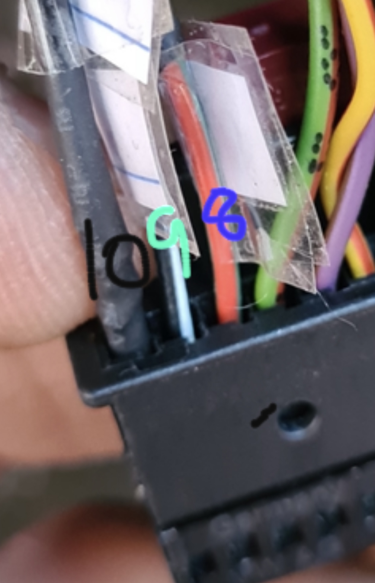

Re: Giannis20vt's Polo 6c 1.0MPI
the schematic is:Atalv wrote: Sat Mar 12, 2022 6:05 am Hi sr, what number of pins were used in the wiring of your installation, thank you very much for the contribution
The contacts are all MQS (micro quadlock system). pin type: 000979009

TCP & TPMS buttons
I decided to fit buttons for TCS and TPMS set. Both of them to the center console.
I bought those buttons from Aliexpress.
The connectors and the wiring
The schematic:
Testing the wiring and the buttons.
The illumination looking good.
Next step is the fitting.
I had to remove the RCD, the center console and the
A mess...
On the top there are the 2 connectors from Hazard warning lights and Heated rear window.
According to the schematic, the illumination wires should are No3 and No6 and should be connected to No3 and No6 of the Heated rear window connector.
And the final result :
I haven't connect the other cables yet, i have to drive 2 of them to the engine compartment and another one to SC30.
So long those buttons are for decoration purposes only. I have to do the rest of the wiring and some coding with VCDS.

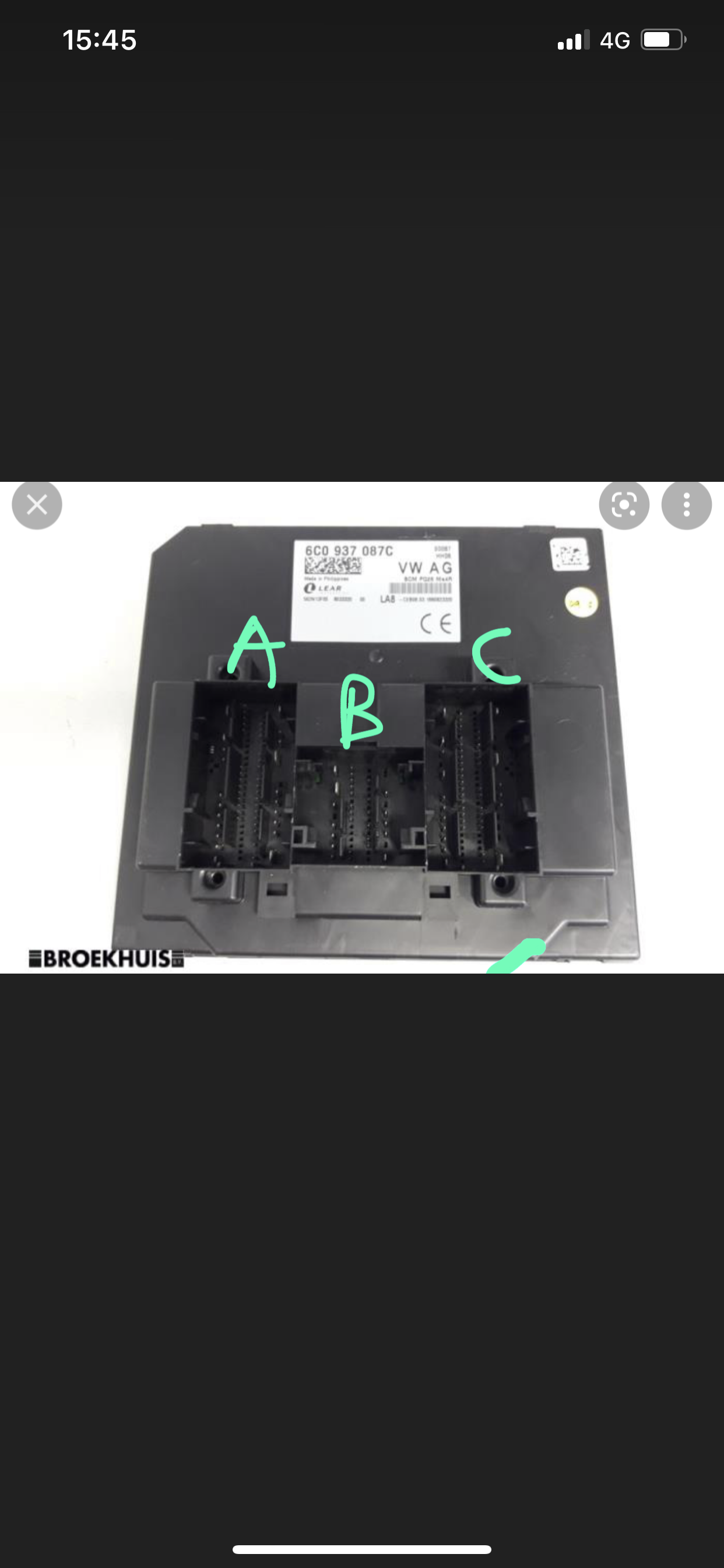

Hello.
I have trouble swapping the BCM module. I have tried so many times with the help of a technician who has on line connection with the VW servers (ODIS etc)
I have bought 2 BCMs (used) with codes 6C0937089C and 6C0937089D, (mine is 6C0937087C)
All the times at the end, ODIS couldn't completed the procedure, the message on the screen says "Component protectionfor Data not yet coded in diagnosis interface. Perform task""19 - Diagnosis interface for Data, component protection (Basis)""
So i wonder if the swap isn't possible using Used BCM and needs only new one.
Is there anyone who have done this procedure to help me please ?
Also another question, i am willing to install RLS (rain light sensor) on my car, is this possible with the 6C0937087C BCM ?
I bet someone found a way to virginize the bcm

- Posts: 8994
Sure, I understand you perfectly, many of us have already gone through projects similar to yours.
I think your current viable option is to install a New BCM in order to remove the CP and continue with your project.
As I told you, for some months it is no longer possible to install some components/units in used condition (BCM, IC, etc) because it is not possible to remove the CP through an online connection with the VW servers (The wall
I do not know if there are other options, such as virginizing a used BCM, but it would be great if that were possible.
Good luck with your project!
