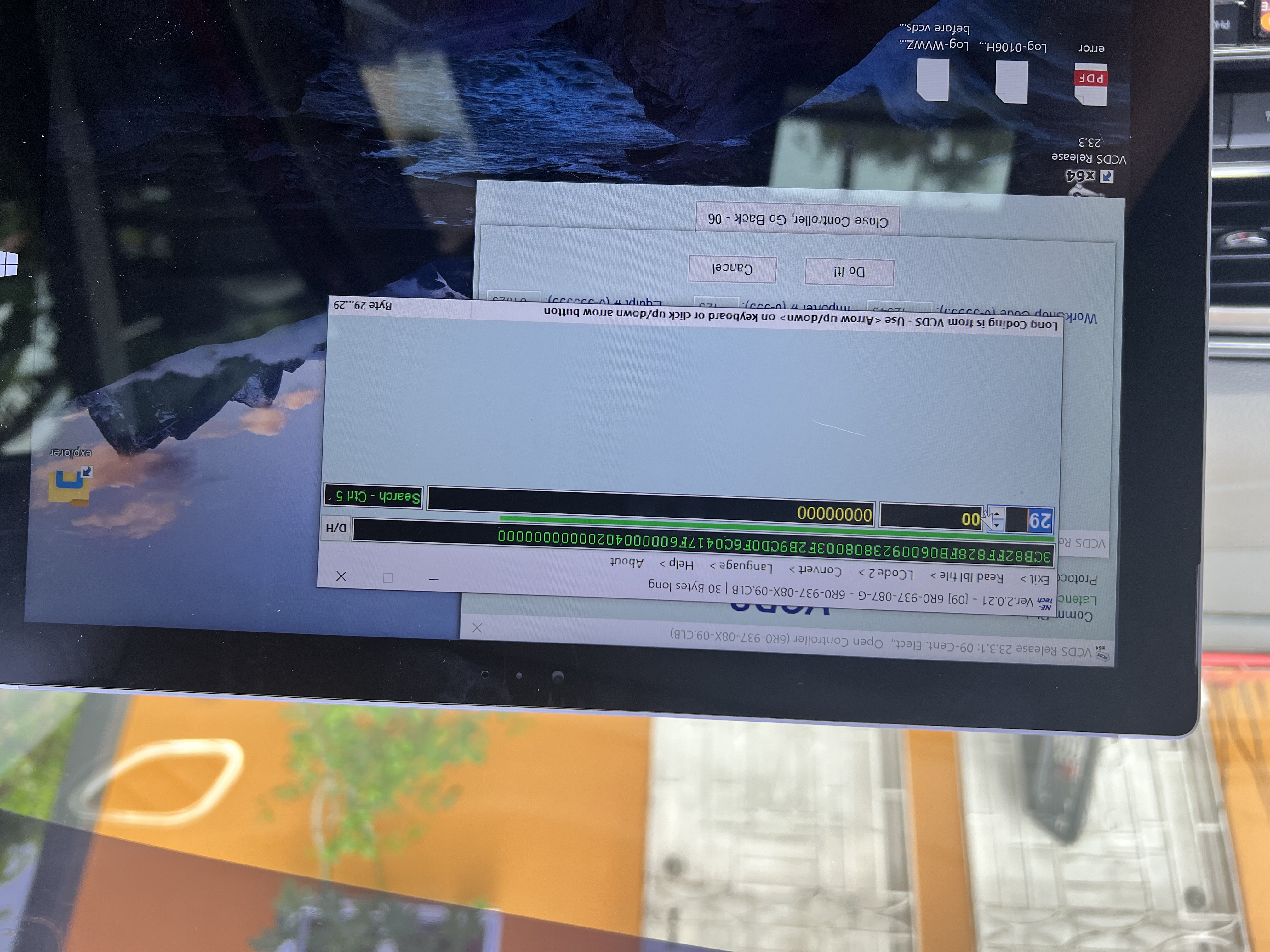

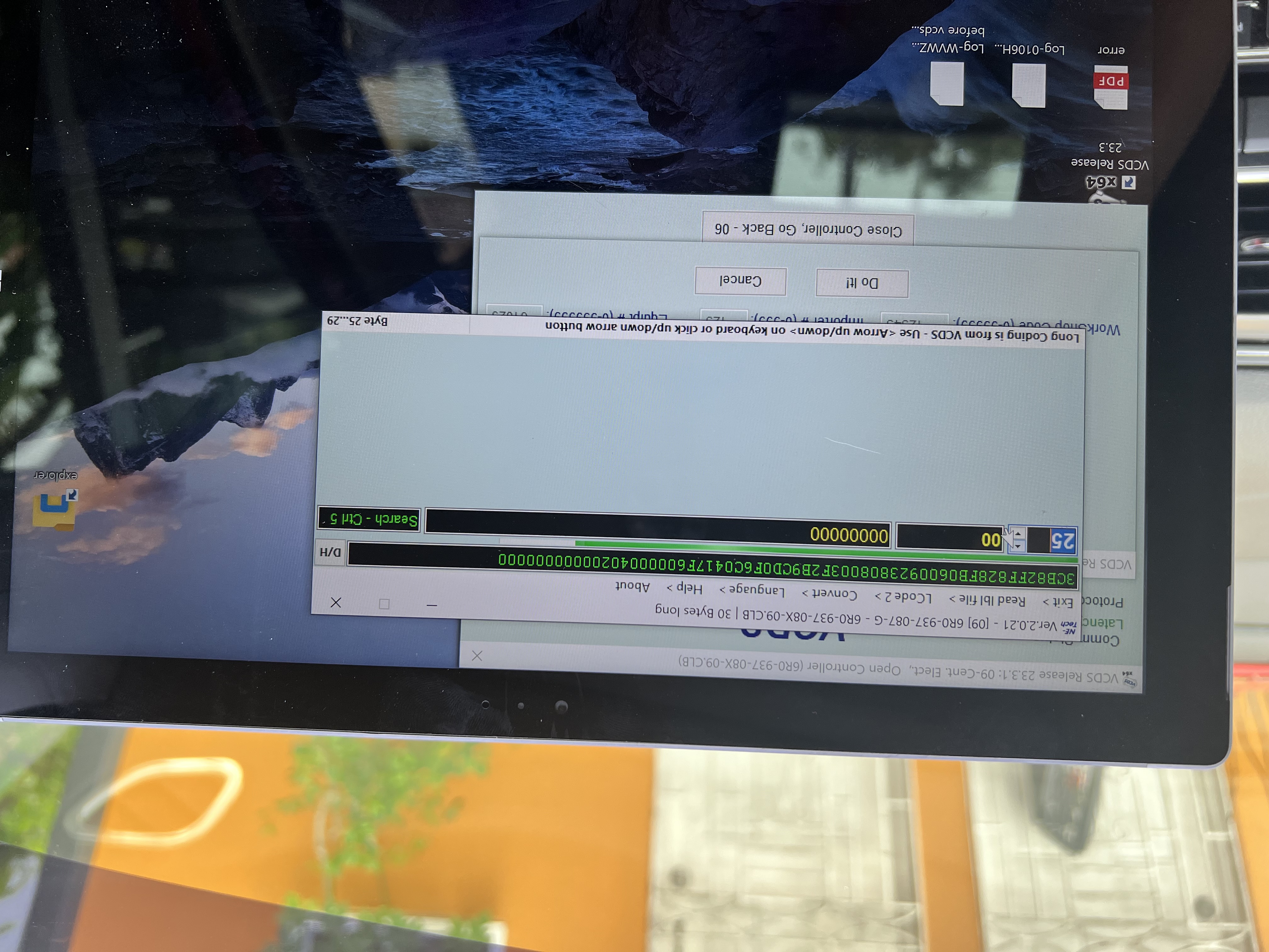

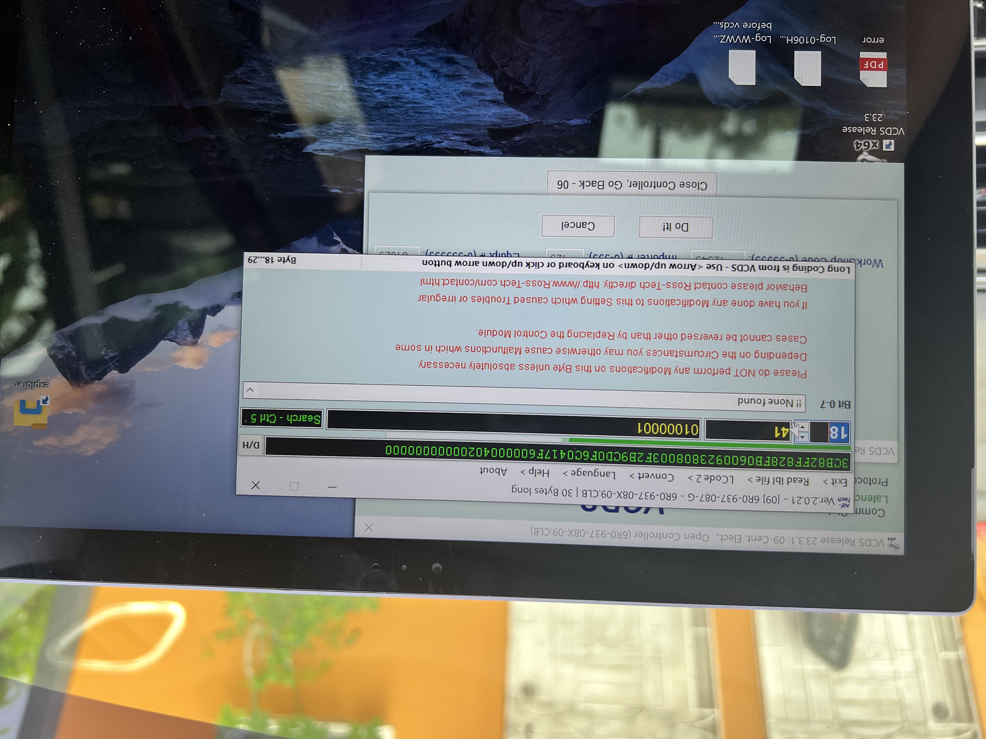

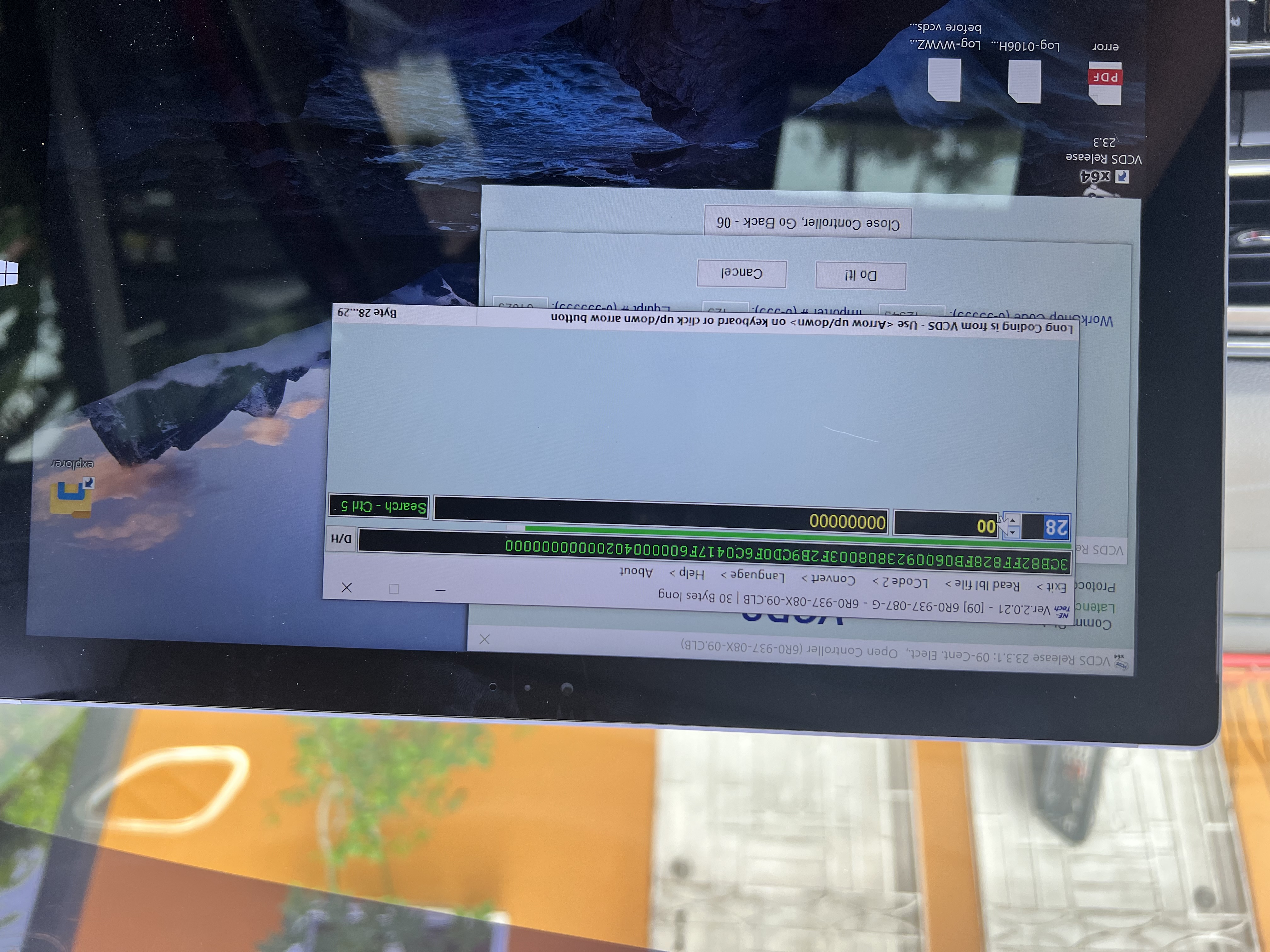

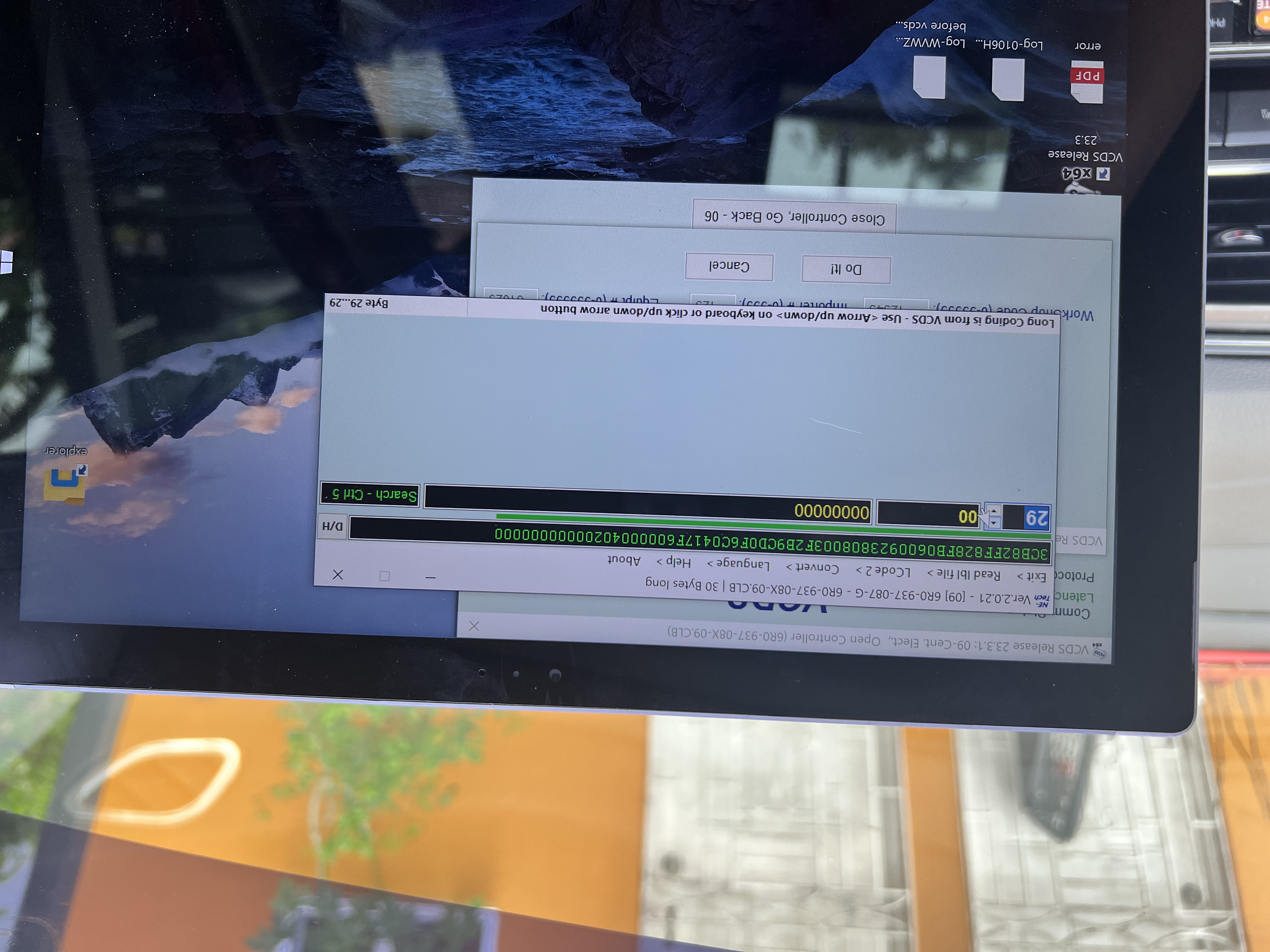

Continue ……
- IMG_0964.jpeg (3.36 MiB) Viewed 1831 times
- IMG_0959.jpeg (2.76 MiB) Viewed 1831 times
- IMG_0963.jpeg (3.2 MiB) Viewed 1831 times
- IMG_0962.jpeg (2.84 MiB) Viewed 1831 times
- IMG_0961.jpeg (2.91 MiB) Viewed 1831 times
- IMG_0960.jpeg (2.8 MiB) Viewed 1831 times
- IMG_0958.jpeg (2.72 MiB) Viewed 1831 times
- IMG_0957.jpeg (2.99 MiB) Viewed 1831 times
- IMG_0956.jpeg (2.98 MiB) Viewed 1831 times
- IMG_0955.jpeg (2.99 MiB) Viewed 1831 times
- IMG_0954.jpeg (2.97 MiB) Viewed 1831 times
- IMG_0953.jpeg (2.96 MiB) Viewed 1831 times
- IMG_0952.jpeg (3 MiB) Viewed 1831 times
- IMG_0951.jpeg (2.9 MiB) Viewed 1831 times
- IMG_0950.jpeg (3.06 MiB) Viewed 1831 times
- IMG_0949.jpeg (2.96 MiB) Viewed 1831 times
- IMG_0948.jpeg (2.96 MiB) Viewed 1831 times
- IMG_0947.jpeg (2.98 MiB) Viewed 1831 times
- Posts: 9037

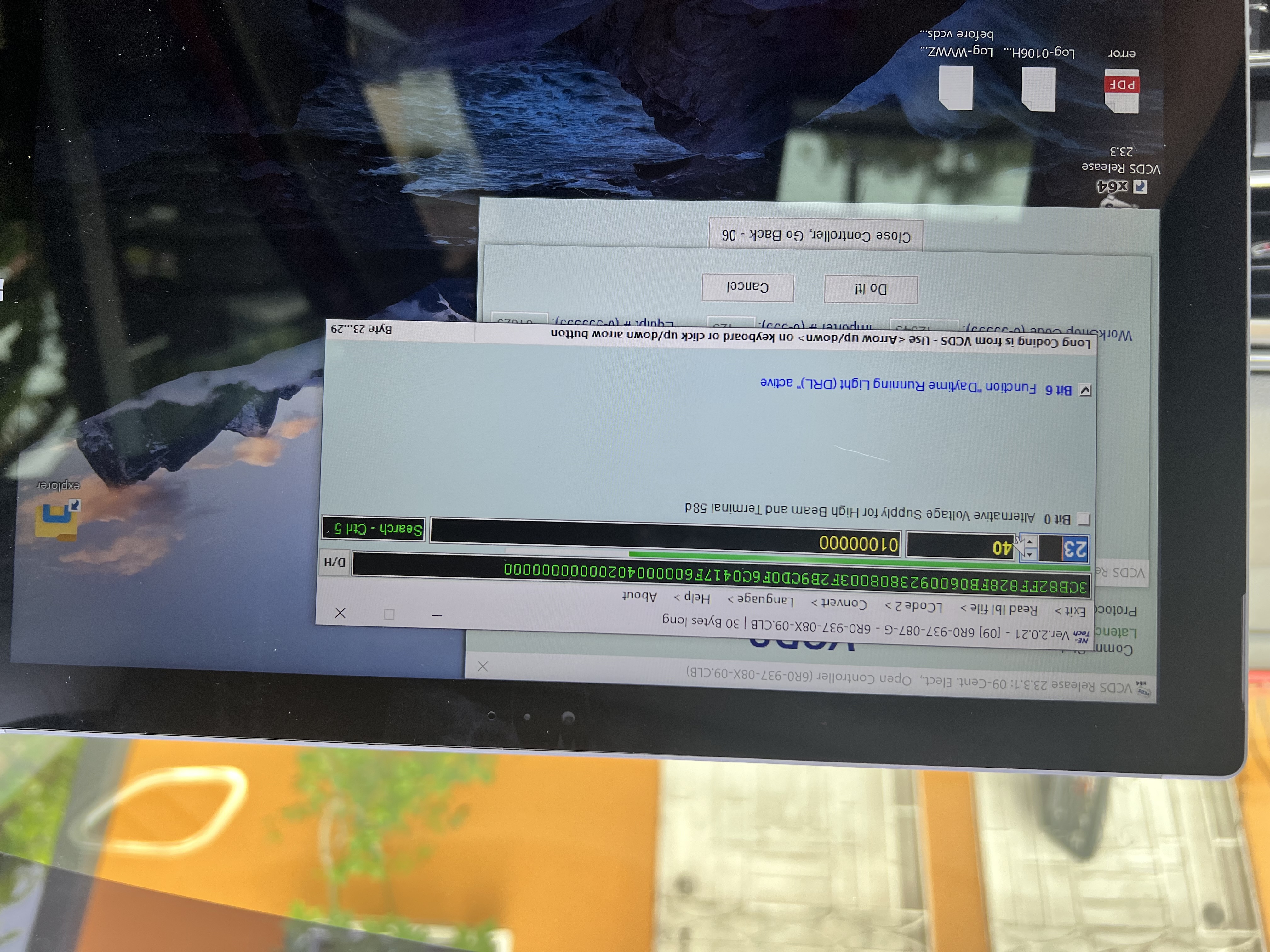

Re: BCM Upgrade and not able to match the key
If it's a RHD
New Engine coding:
002500F6202500080000
New GW coding:
002300
Thanks for the pictures of the Auto light switch. It's the correct one.
New Engine coding:
New GW coding:
002300
- Posts: 9037
The images you just posted are enough, it is not necessary to install the old BCM.
I will do a new revision of your BCM coding, please wait for a while for a new BCM coding in next post.

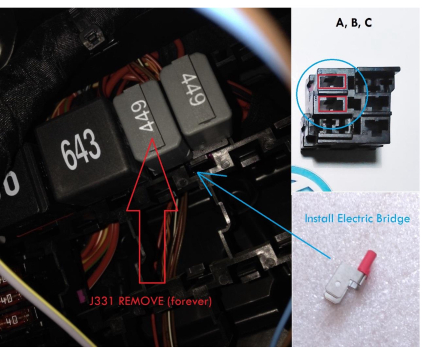

a input for fuse39 & 59 is from the main line (not sure the correct terminology or not, it’s directly from the battery fuse 30)ciclo wrote: Mon Nov 04, 2024 6:42 pm How are you feeding the 'a' inputs of fuses 39 and 59? +30 power is required.
Have you permanently/4ever removed the J331 relay?
'Example' for J331 relay (page 7):https://drive.google.com/file/d/0B2nv91 ... QkQNBJAwgQ
Auto lights.
Are you sure you have installed the wires in the relay adapters correctly?
Any special reason for a 6R LHD to be in Jamaica?
Communications here are very bad due to the catastrophic rainy season that we had, I even think that sometimes the posts sent are not loaded.
I apologize.![]()
J331 is removed and the bridge is installed. Right now it’s with temporary 10AWG wire connecting 3 & 5 of the relay.
I followed this picture. And now yesssss it clicked me of the relay pin arrangement in the two new ones. I’m gonna check it when I can go outside. I’m beating my head right now. If it is the case, it’s my stupid mistake. Thanks for your kind help

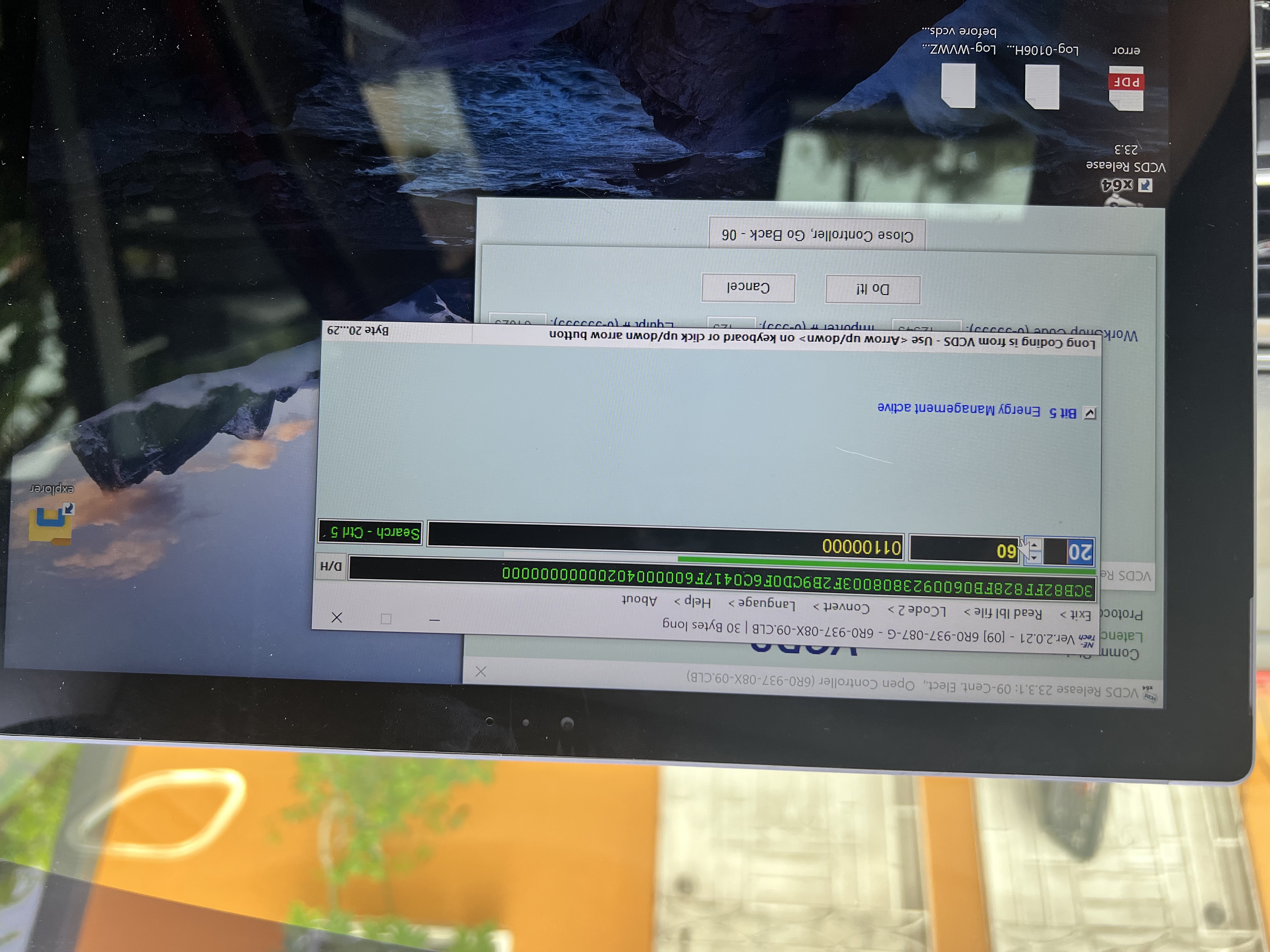

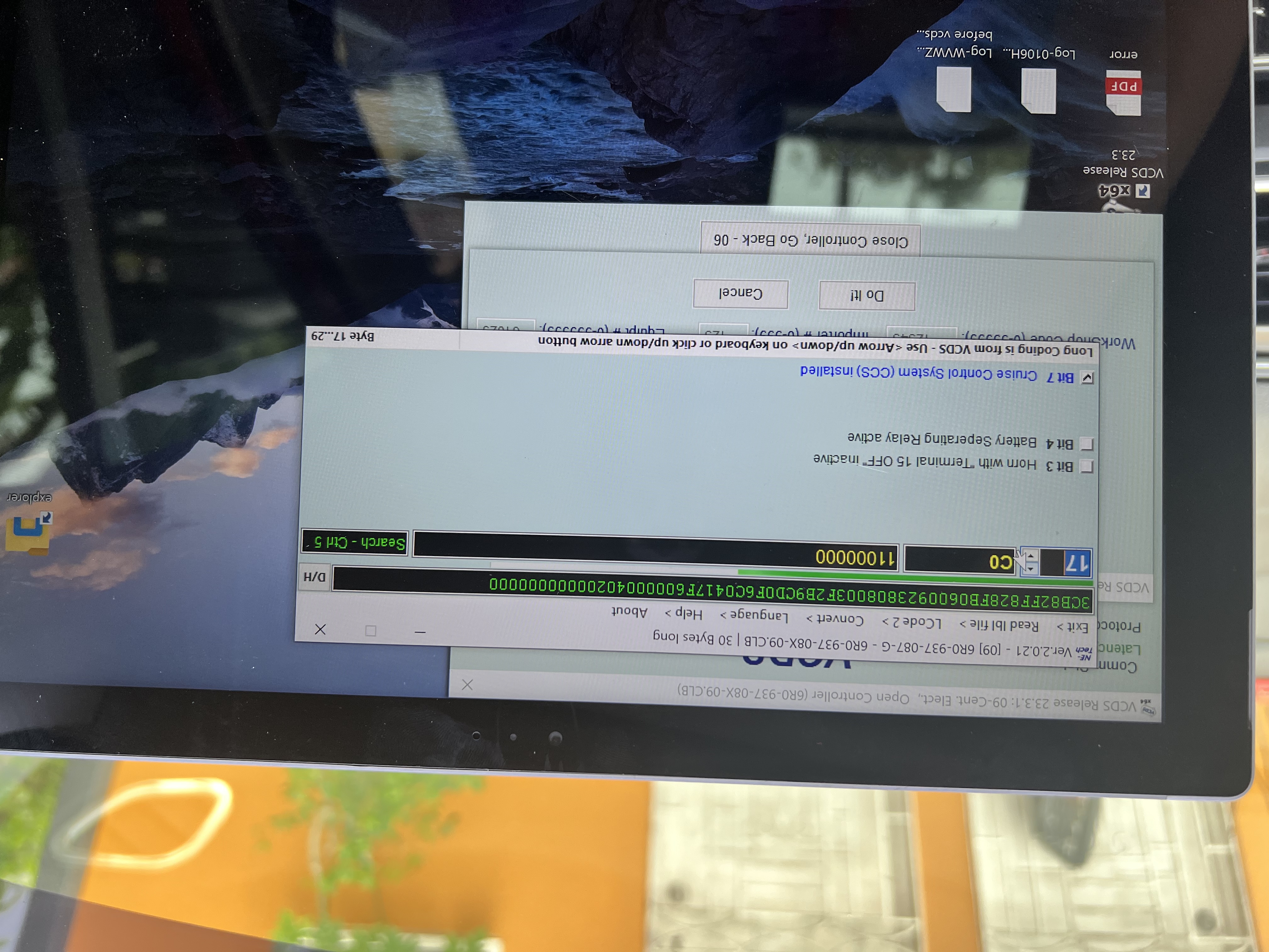

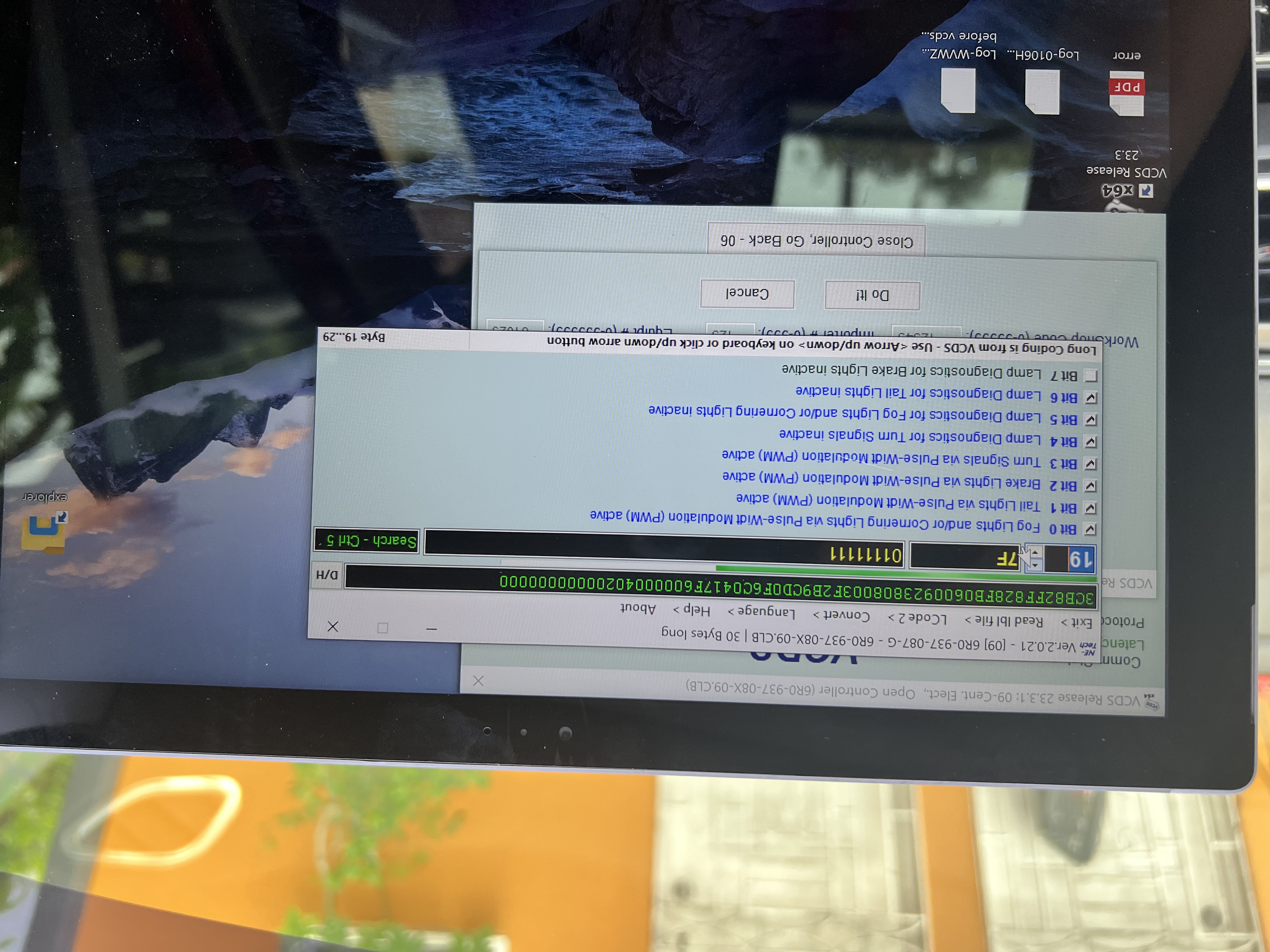

- Posts: 9037
New BCM coding: (also provisional)
3CB82FBF28FB2400B33806B07CEB96D15FC0612F608C20D1200000020000
This new coding is to see what is the problem with the alarm, and everything else...
Good luck with your checks, don't worry, even the gods make mistakes and the planet keeps spinning just as well every day...
The forum is not working properly for me, I get kicked every time I try to edit a new post and I have to log back in every time...
Sometimes the forum doesn't kick me and I can edit a new post without problems...
Thank you master!!!!!
That’s why master will always be master!

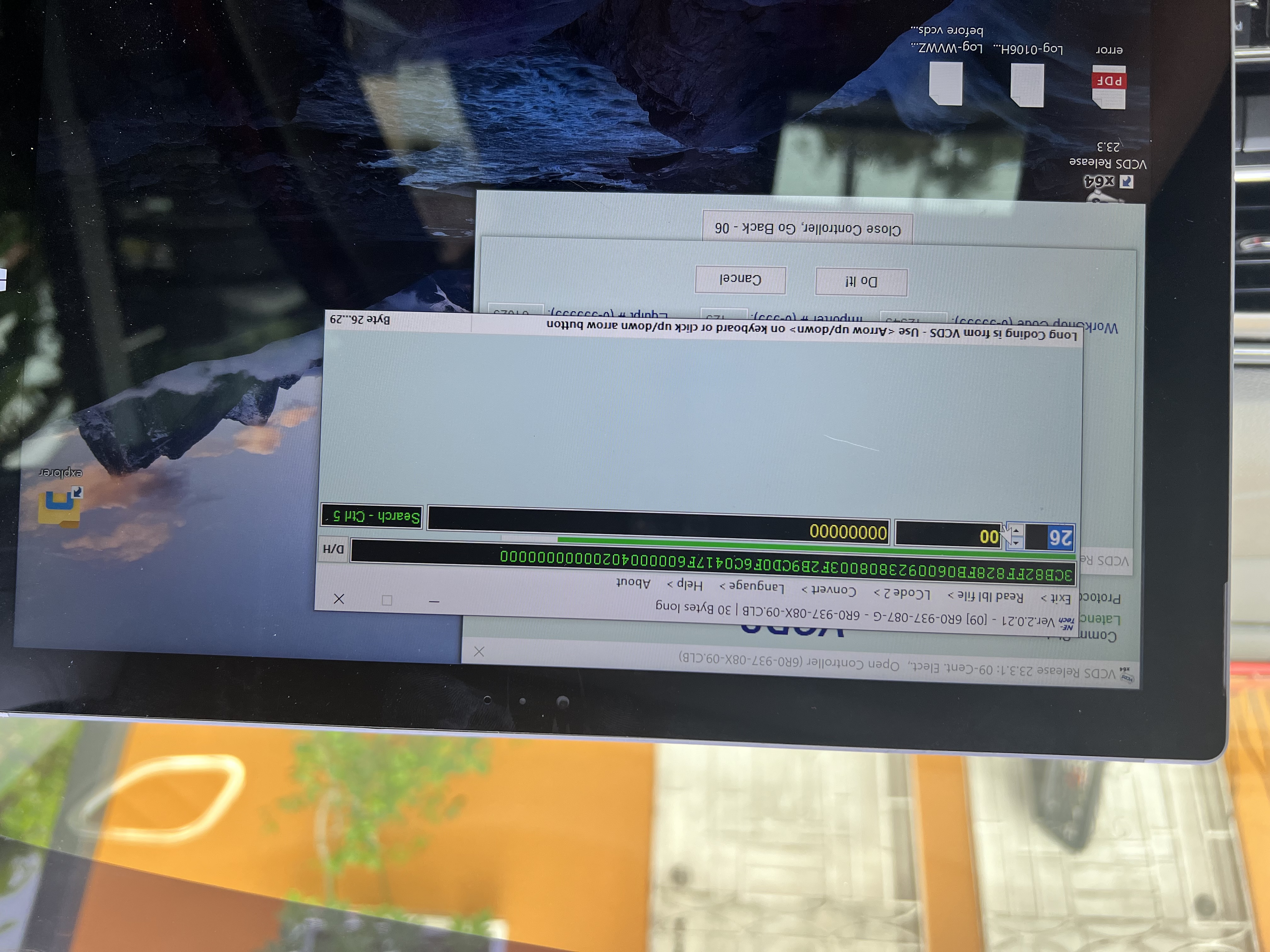

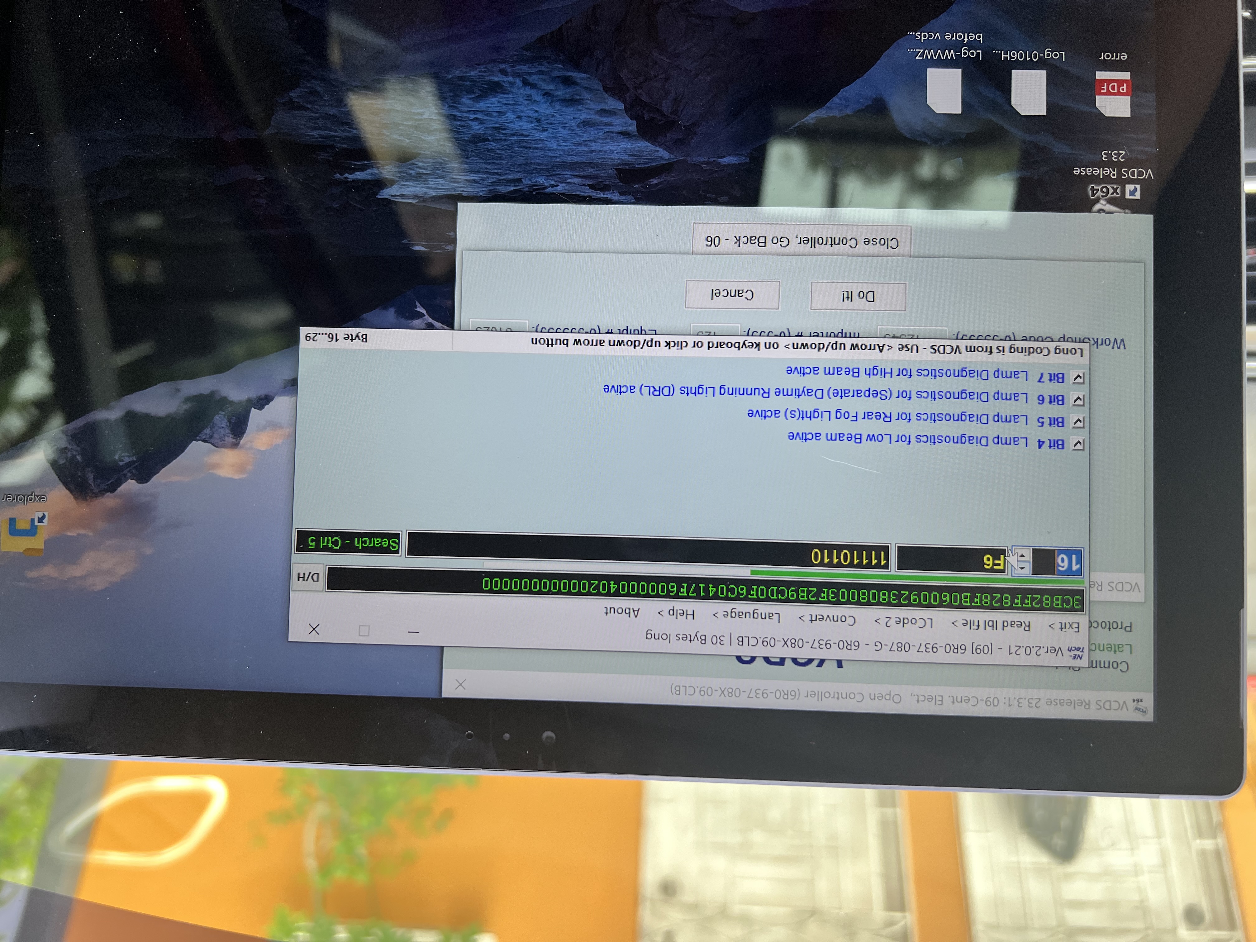

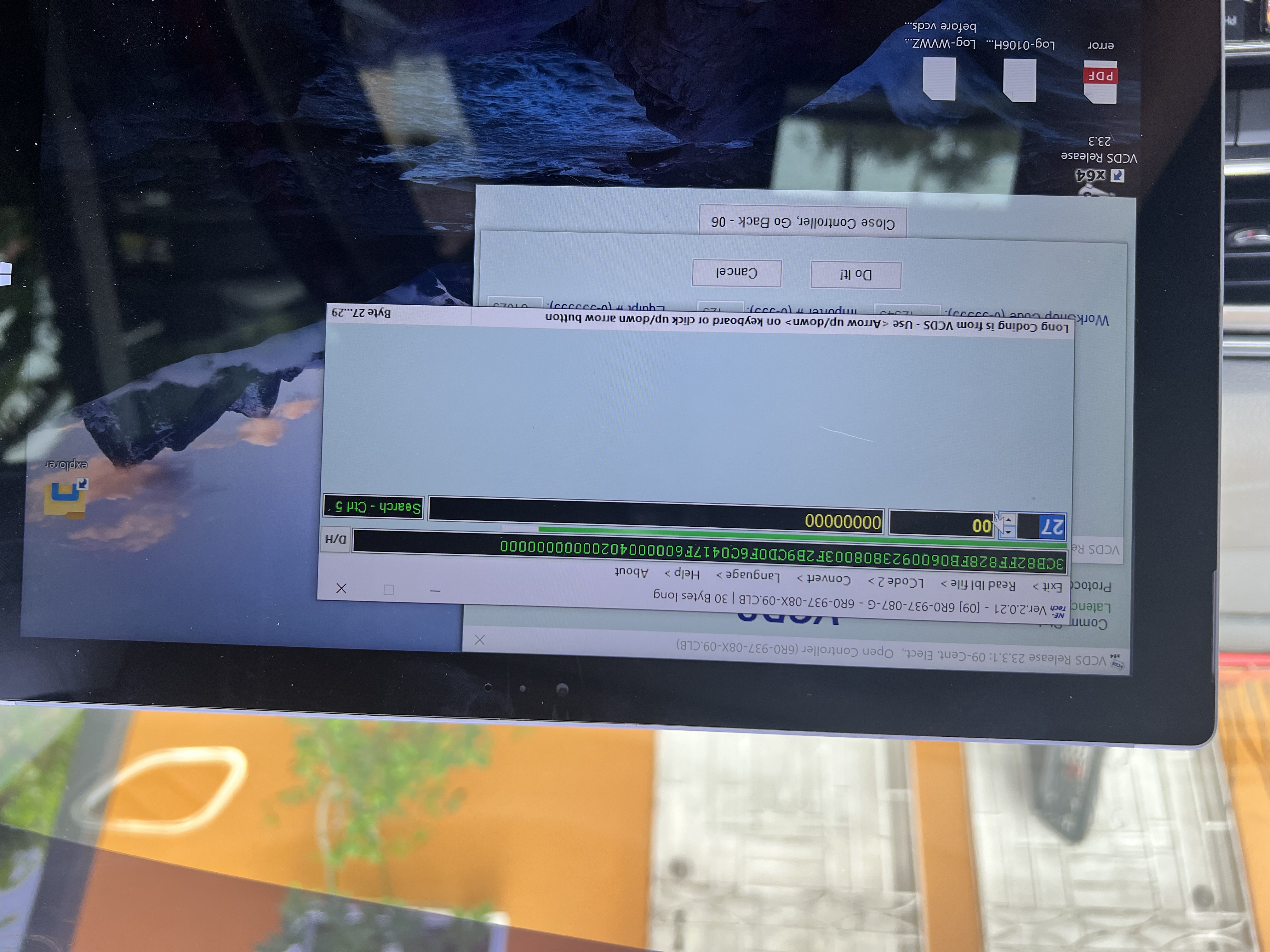

Yes indeed I’m stupid enough to wire the relay wrong.
I changed the wiring. And apply the coding that you provided.
So here is the output now.
Both front and rear fog lights working with pulling the switch.
When park light is on, DRL off
DRL on when the park light is off and handbrake is off
Corning light working.
However,
The alarm horn is still not working (no sounding)
The right rear light is doing funny thing, when I on turn signal to right, both the right park light and brake light blink alternatively. Not the turn signal light.
I’m getting the adaptation map and new scan. The forum kept kicking me out when I post something so I had to keep re-writing it again and again.
Thank you so much master, thanks for you kind help coz I truly understand it’s consuming your personal time while helping me.
However,

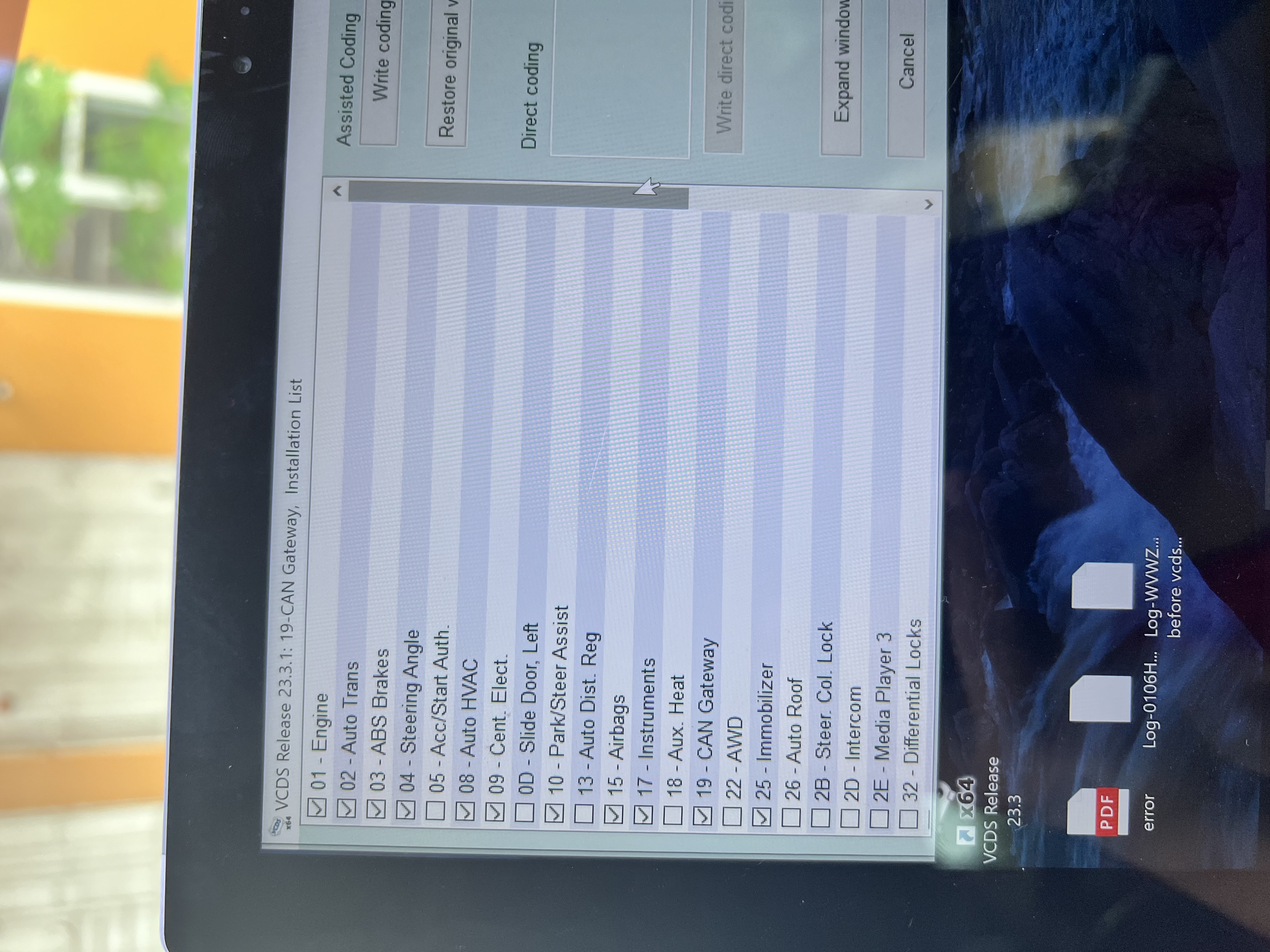

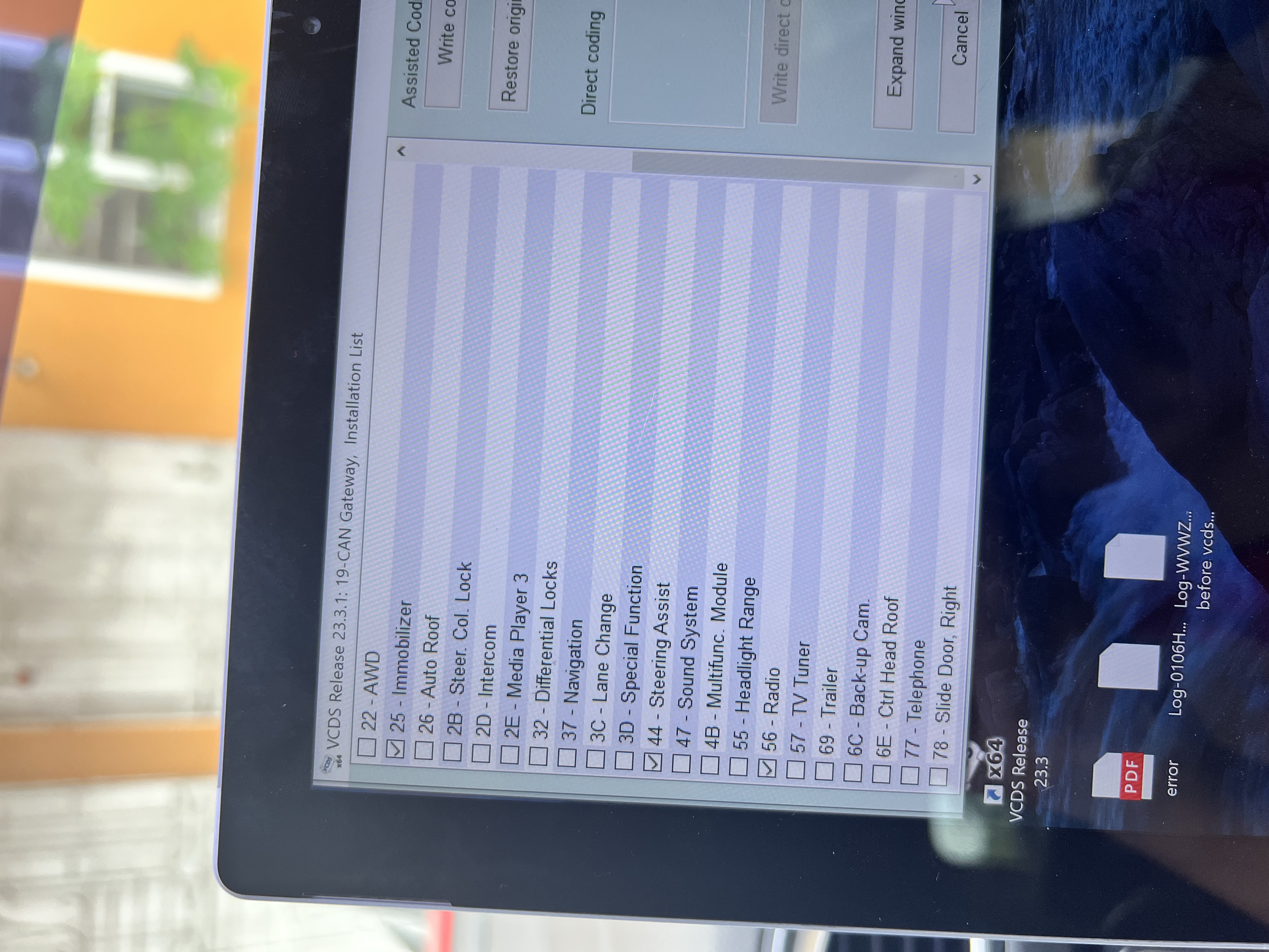

Friday,08,November,2024,12:01:59:38219
VCDS Version: 24.7.1.0 (x64) HEX-V2 CB: 0.4656.4
Data version: 20240919 DS356.3
www.Ross-Tech.com
VIN: WVWZZZ6RZBU037606 License Plate:
Mileage: 194790km-121036mi Repair Order:
Chassis Type: 6R-VW25 (7E0)
Scan: 01 02 03 04 08 09 10 15 17 19 25 44 56
VIN: WVWZZZ6RZBU037606 Mileage: 194790km-121036miles
56-Radio -- Status: OK 0000
Address 01: Engine (J623-CBZB) Labels:. 03F-906-070-CBZ.clb
Part No SW: 03F 906 070 BQ HW: 03F 906 070 D
Component: SIMOS10.20H02 9849
Revision: -------- Serial number: CVN: 949FC520
Coding: 002500F6202400080000
Shop #: WSC 12345 123 61029
ASAM Dataset: EV_ECM12TFS02103F906070BQ 003010
ROD: EV_ECM12TFS02103F906070BQ_003.rod
VCID: 72BDCB884426752A59F-8026
VINID: 9E69EAAAA1A2A929400C718018574E6D87
Readiness: 0110 0101

Hiroki
- Posts: 47
- Joined: Mon Feb 27, 2023 5:34 pm

- Posts: 9037
You have to change the BCM adaptation channels 53 and 54 from 1 to 0.
I think I already mentioned this in a previous post.
