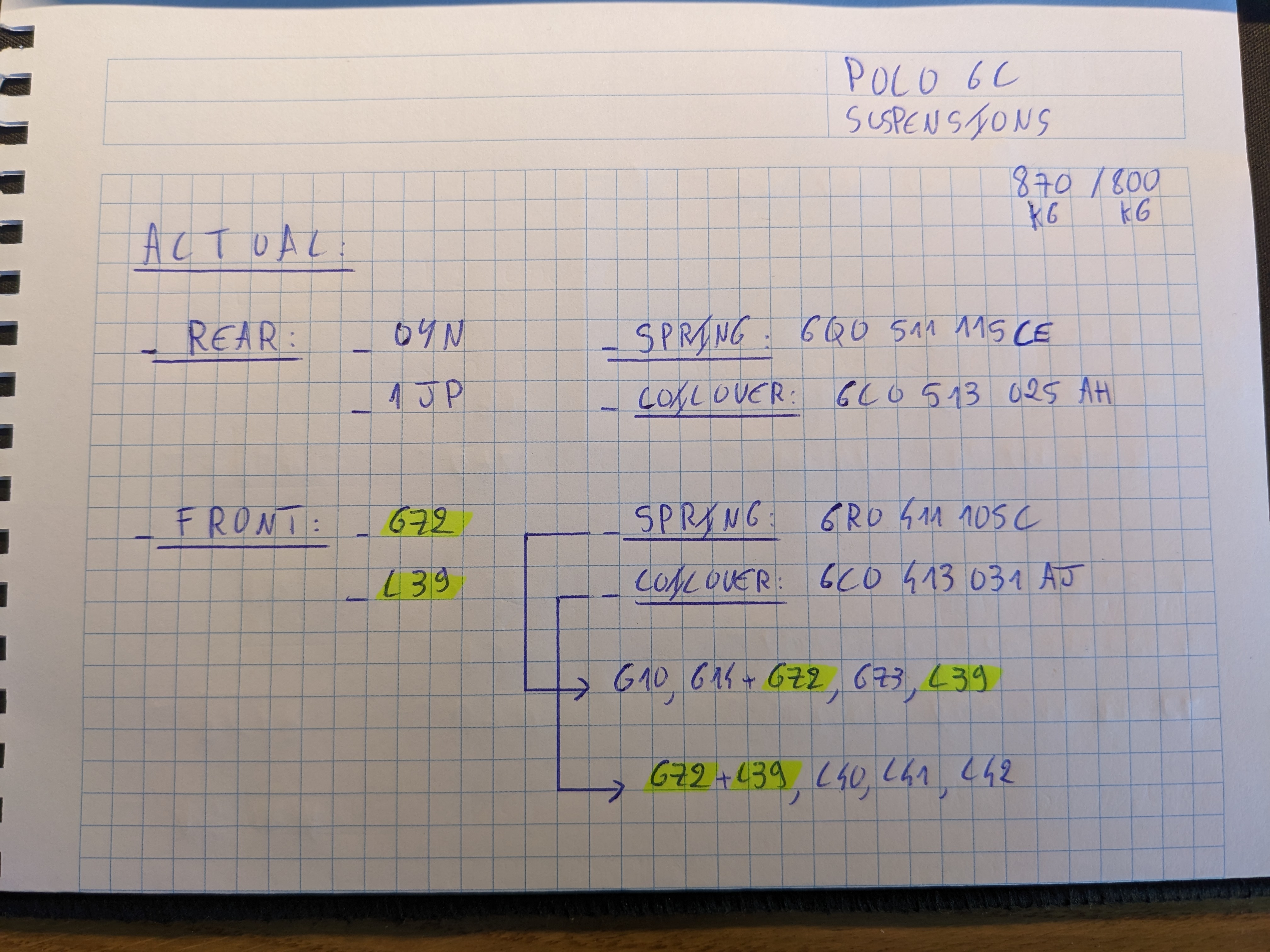

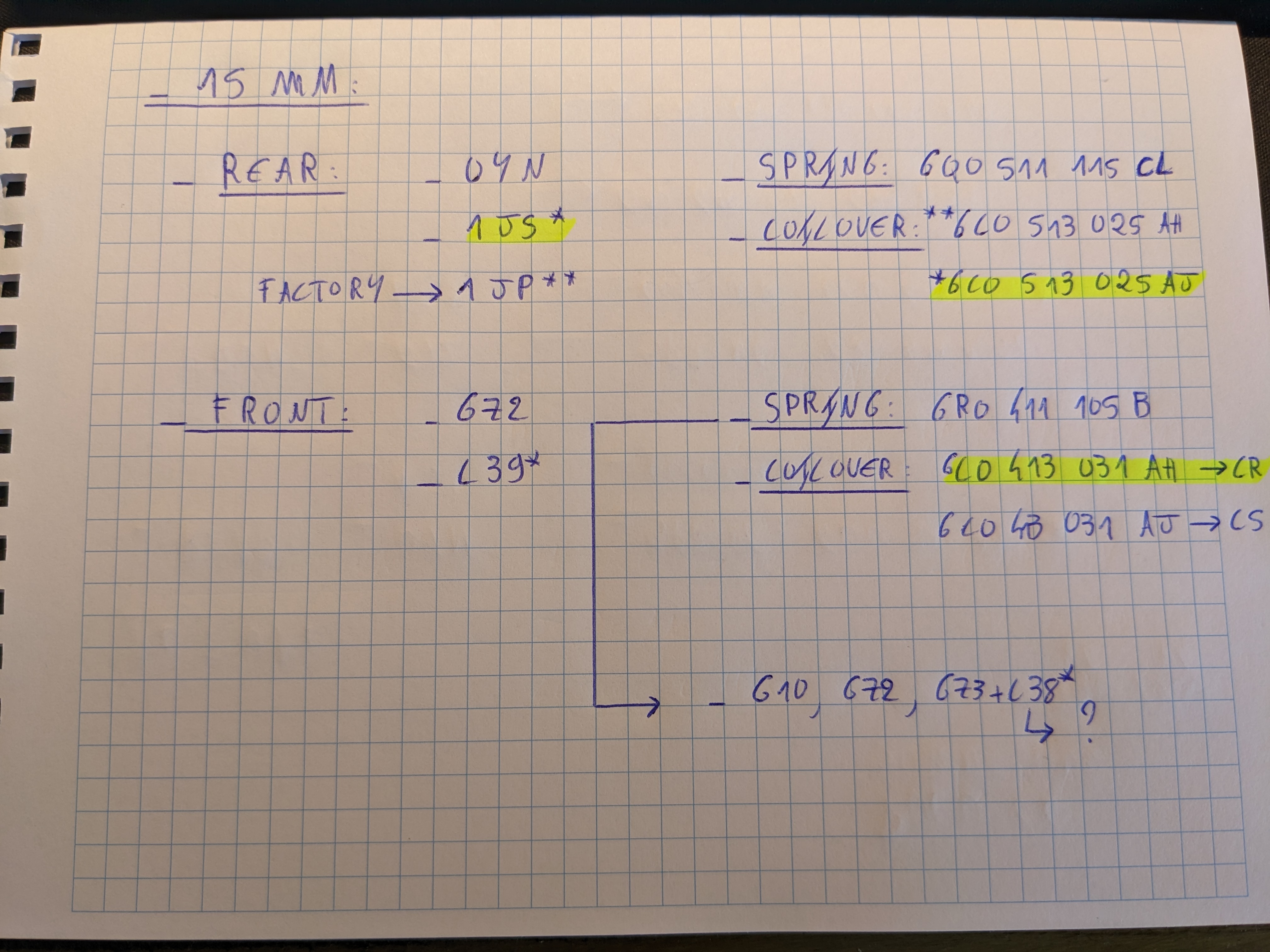

Hello all, hope you are doing well.
I'm sorry for the topic digging but I prefer asking now just to be sure.
Here, the current setup of my car with the dedicated PR codes: Rear axle is pretty straight forward as the front one with G72 and L39 for the axle load.
Remember, my front axle max capacity is 870 kg and the rear is 800 kg.
Where I have concerne is for the front axle spring's choice, or more precisely, it's PR code about the weight "range". For the back it's will be pretty simple as my current setup is:
-0YN
-1JP
So for the spring, I could easily swap to:
-0YN
-1JS
With for the spring, part number "6Q0511115CL", matching perfectly my rear axle load.
For the shock absorber, I could have the choice bewteen the factory one (1JP), part number "6C0513025AH"
or
the "sport" (1JS), part number "6C0513025AJ"
But, my main concern is about the front spring.
As you already said, you guys, put the following part number "6R0411105B"
Both of your car have an 860 kg maximum permitted load on your front axle, while mine is 870 kg. 10 kg seems quite light but, still I'm a little bit concerned by the difference between the PR code.
The -15mm front suspension, with the spring "6R0411105B" has an L38 PR code while my factory spring "6R0411105C" have an L39 PR code.
I search everywhere, on ETKA: impossible to found information concerning the range of those "L39" and "L38" PR code.
Maybe it has a link between the lowering spec or not. If you have any informations, I will be grateful

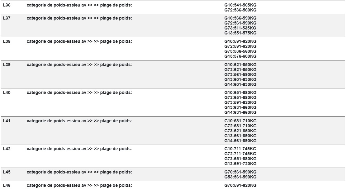

Okey, I found something interesting:
So, If I understand, my current setup for the front suspension is G72 + L39.
It means my current load goes from 621 to 650KG.
But with the "6R0411105B" spring (-15mm), I'm not sure about how handle those numbers/table.
PR codes for this spring are: G10,G72,G73+L38
