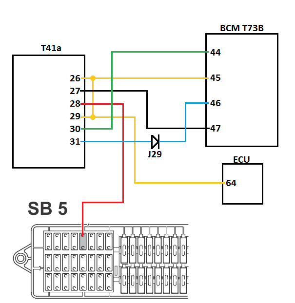

I would like to install a cruise control in a Skoda Fabia II 1.2 TSI 105 HP car (model year 2012, because there is the letter C in the VIN number). The car was made in the Czech Republic. I searched various forums and drew a diagram.
If possible, please check if I drew everything correctly and if my connections are correct.
Could someone write what the J29 diode should be?
Regards and please help

- Posts: 6695
TSI engines take cc to T94/45
- Posts: 8982
+1 .... 45 instead of 64 (most diesel engines)

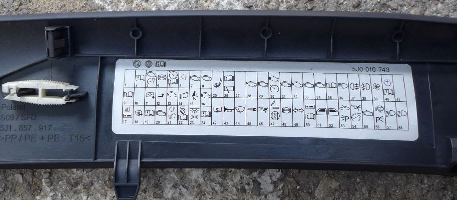

SB5 is a positive signal +30 "on POLO 6R" and the CCS uses a positive signal +15.
So where to connect this cable then? With gasoline engines, I found information that it connects to the SB5 (5A)ciclo wrote: Sun Oct 31, 2021 6:30 pm SB5 is a positive signal +30 "on POLO 6R" and the CCS uses a positive signal +15.

Well, this is very easy to check with a multimeter.
On the side of the small fuses of the fuse box, you have fuse slots that are empty, that's where with the voltmeter you should find an empty slot with a +15 signal.
+15 is active only when you turn the ignition key. (no need to start engine)
+30 is always active.
Then you put a mini fuse 5 Amp in the slot to feed that power wire for your CCS.

So my diagram should look like below?
I understand that these are all connections and I don't have to make any other?
