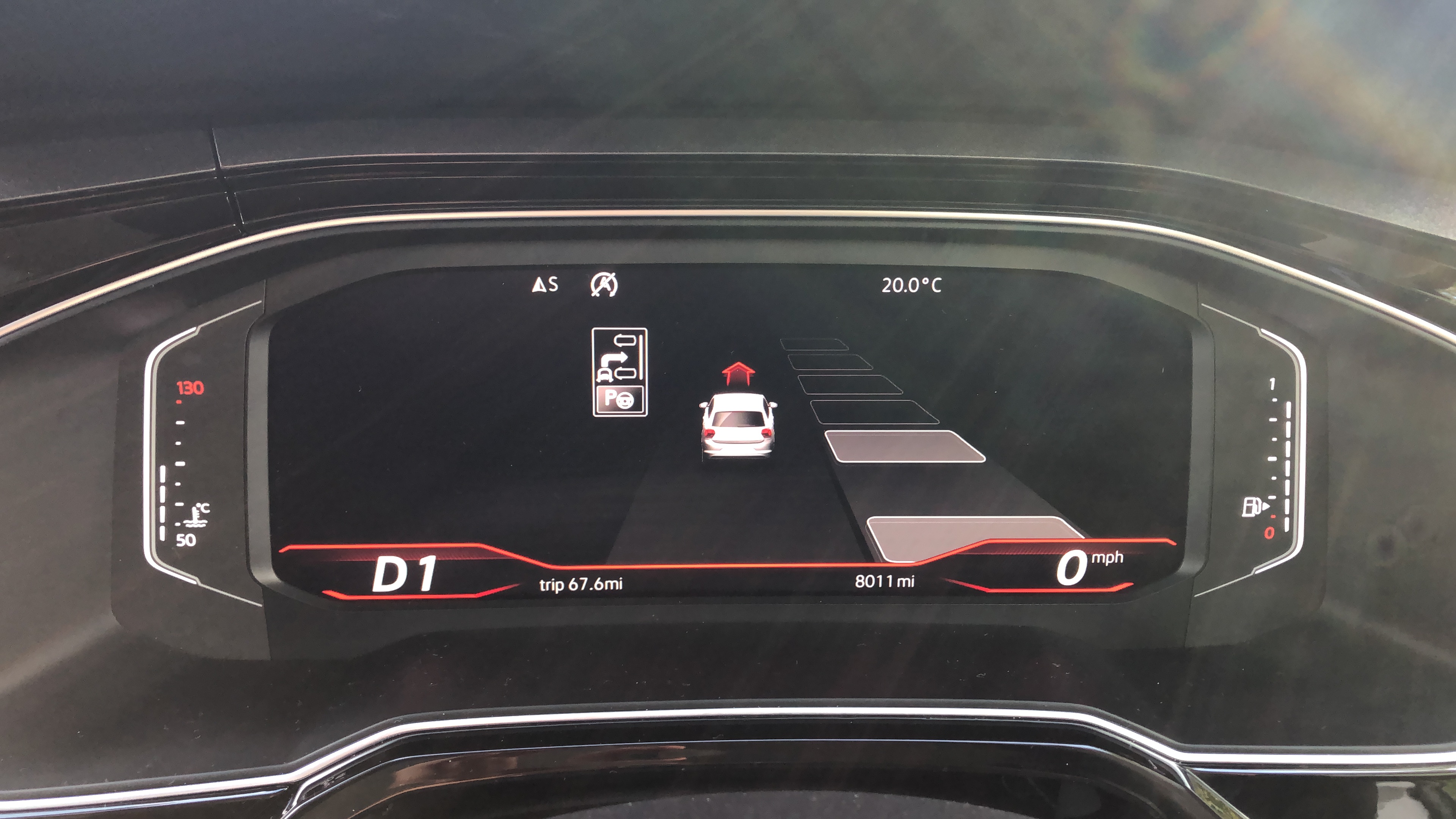

That would be great !phillos wrote:These edits I did here, do not require the use of "apps" that costs credits.peeceeuk wrote: Tue Aug 27, 2019 11:48 amInterested in this.phillos wrote: Mon Aug 26, 2019 9:52 pm Fiddled around with OBDeleven tonight.. made a couple of changes to my AID. I really like version 1, but 2 and 4 are good as well. The standard red version 3 is ugly.

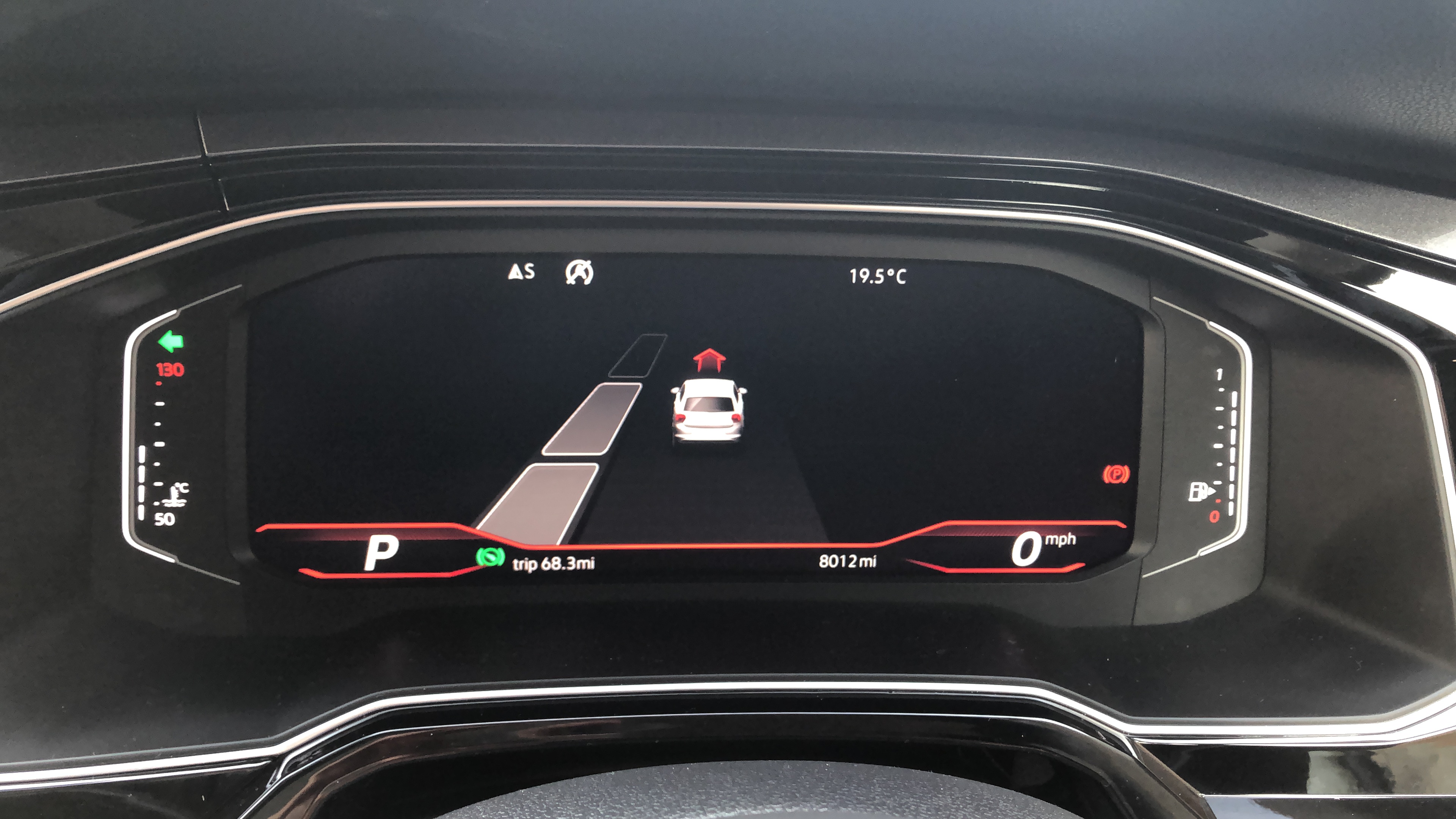

Changed speedo final value to a more reasonable 260, rather than the stock 280. (There’s even a 300 version![]()
I also coded 10s instead of 20s steps on the speedo! IMHO much more usable in daily driving.
Pictures of dash versions:
https://imgur.com/gallery/e7mEcoS
OBDeleven uses a credits system to use some of their one-click changes.
Are these AID changes included in the preset options and if so, how many credits does it take to use them?
You need to change settings in the "Adaptions" part of the "Dashboard (module 17)". In order to do this however, you need to have unlocked the 'pro' version of OBDeleven. Once you know which bits to change, you can change them endlessly to your hearts content![]()
