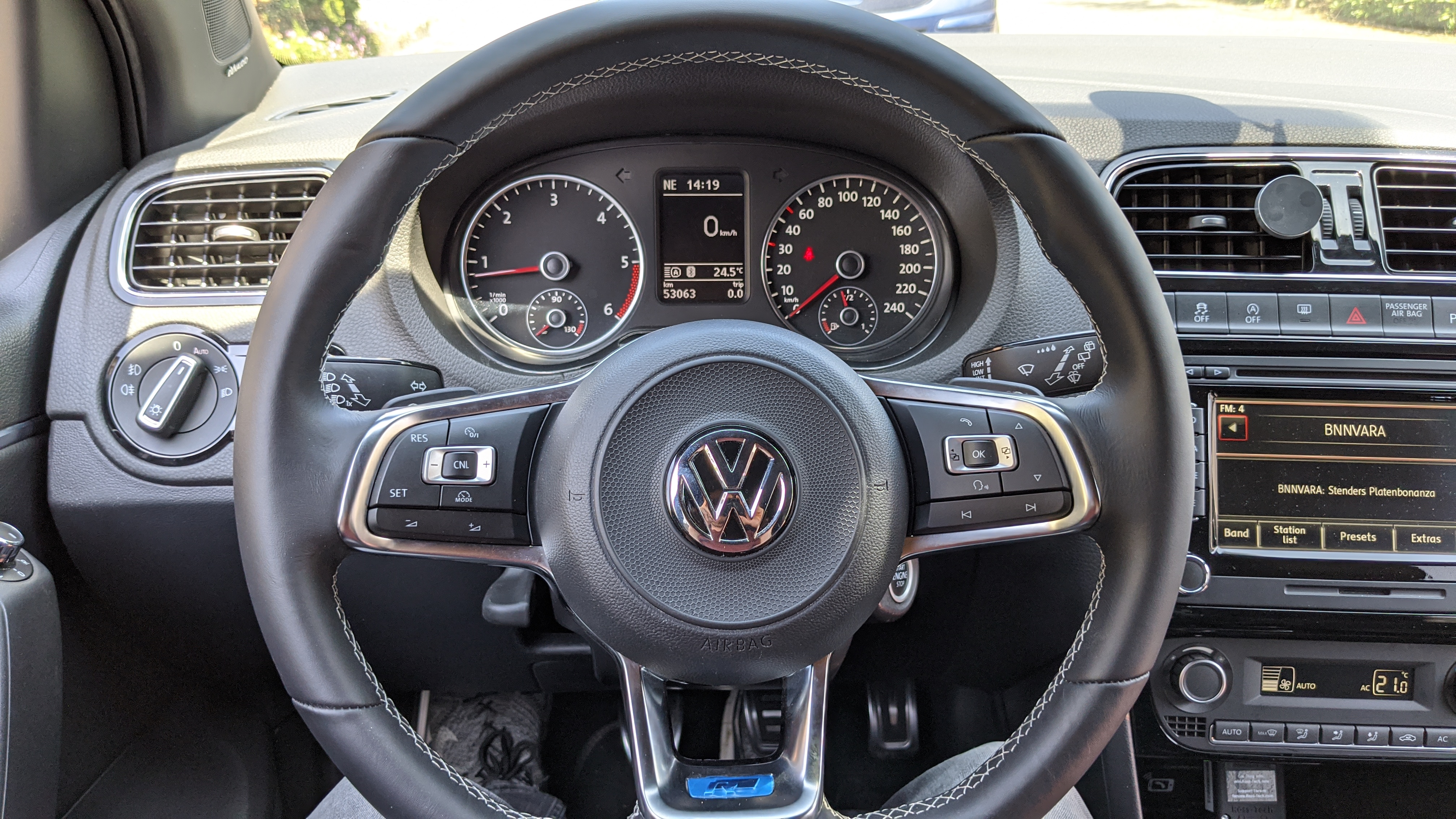

I'm planning to do a MFSW with cruise control with the help of MaDwArLoCk's emulator module.

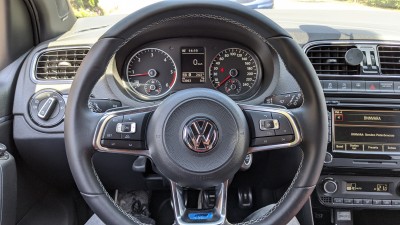

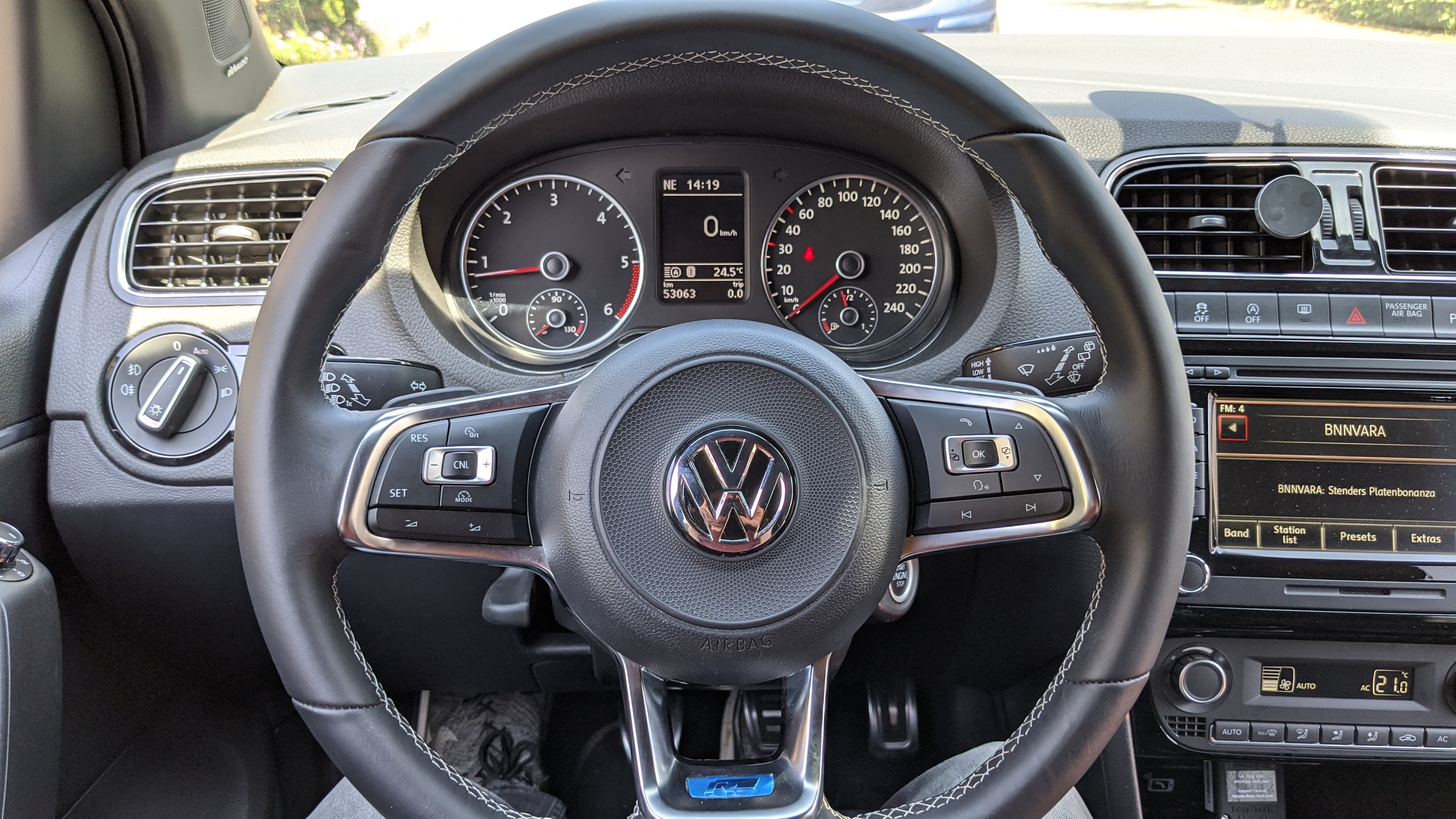

Re: iichels Polo 6R 1.2TDI Bluemotion --> OEM++ R-Line conversion
Yee Ha :mrgreen:
Thanks to MaDwArLoCk
GRA high on TDI
Thanks to firegrafik and RoFireman from Russia
