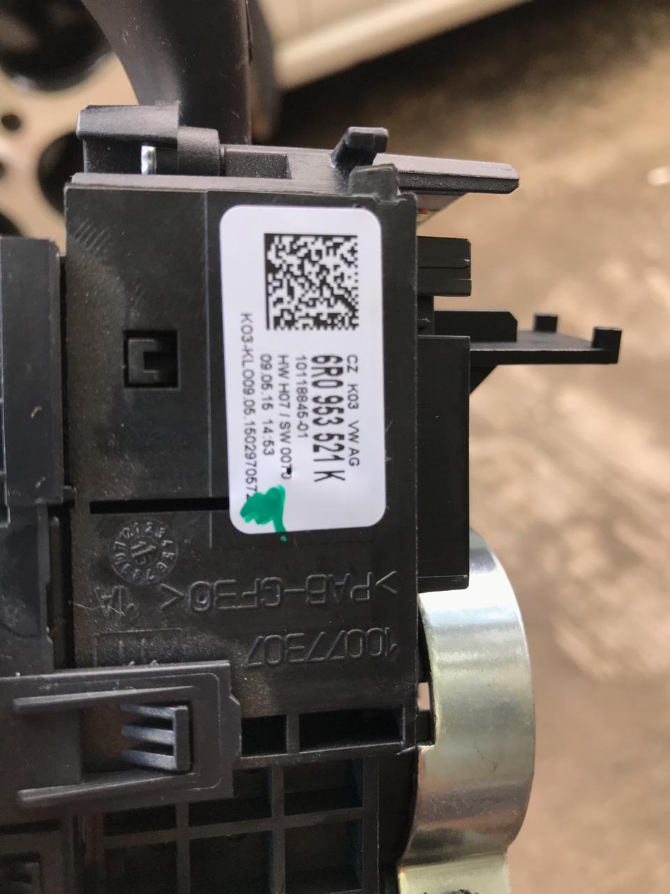

Re: Retrofitting of Cruise Control by MFS on Polo 6R, T5, T6
Could you perhaps post a photo of your current stalks?
poethardo
Posts: 14
Joined: Mon Feb 11, 2019 9:36 am
Drives: VW polo 1.2 TSI
Location: Indonesia
Post by poethardo »
hii iichel,
this my current stalk
thank you
waiting for your advise
If you want cruise control via the stalk, you should order the 6r0 stalk. Not the 6c0, in any case. If you plan to fit mfsw with mfa buttons, you can install stalks without mfa buttons.
