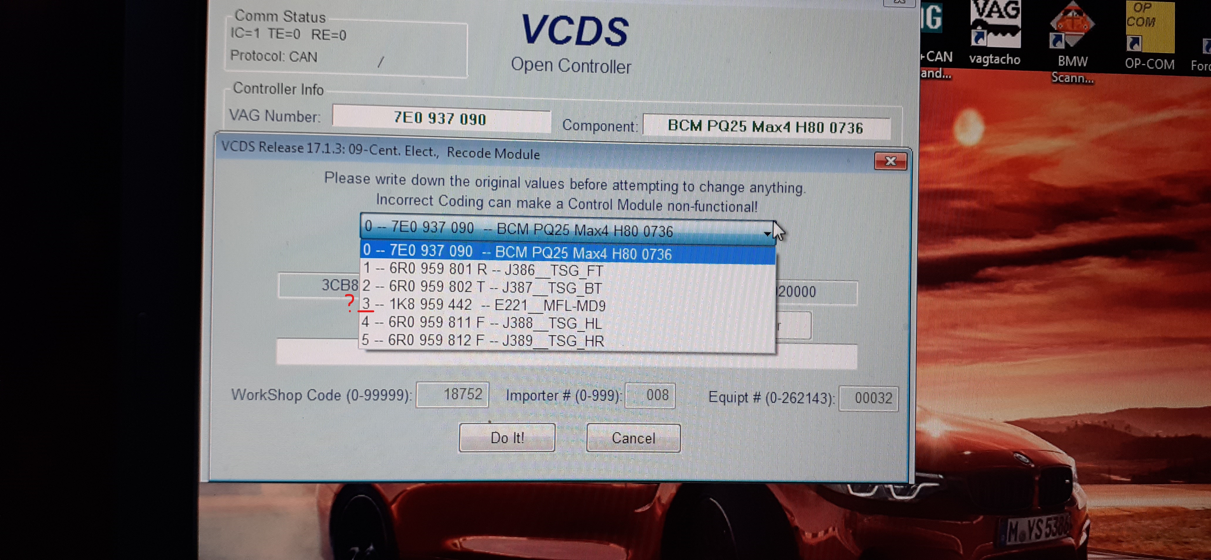

The RLS label is inside the BCM (09 Address), in the drop-down panel.
Read the VCDS coding in the installation guide for automatic lights, you have images with the drop-down panel in pg 18.

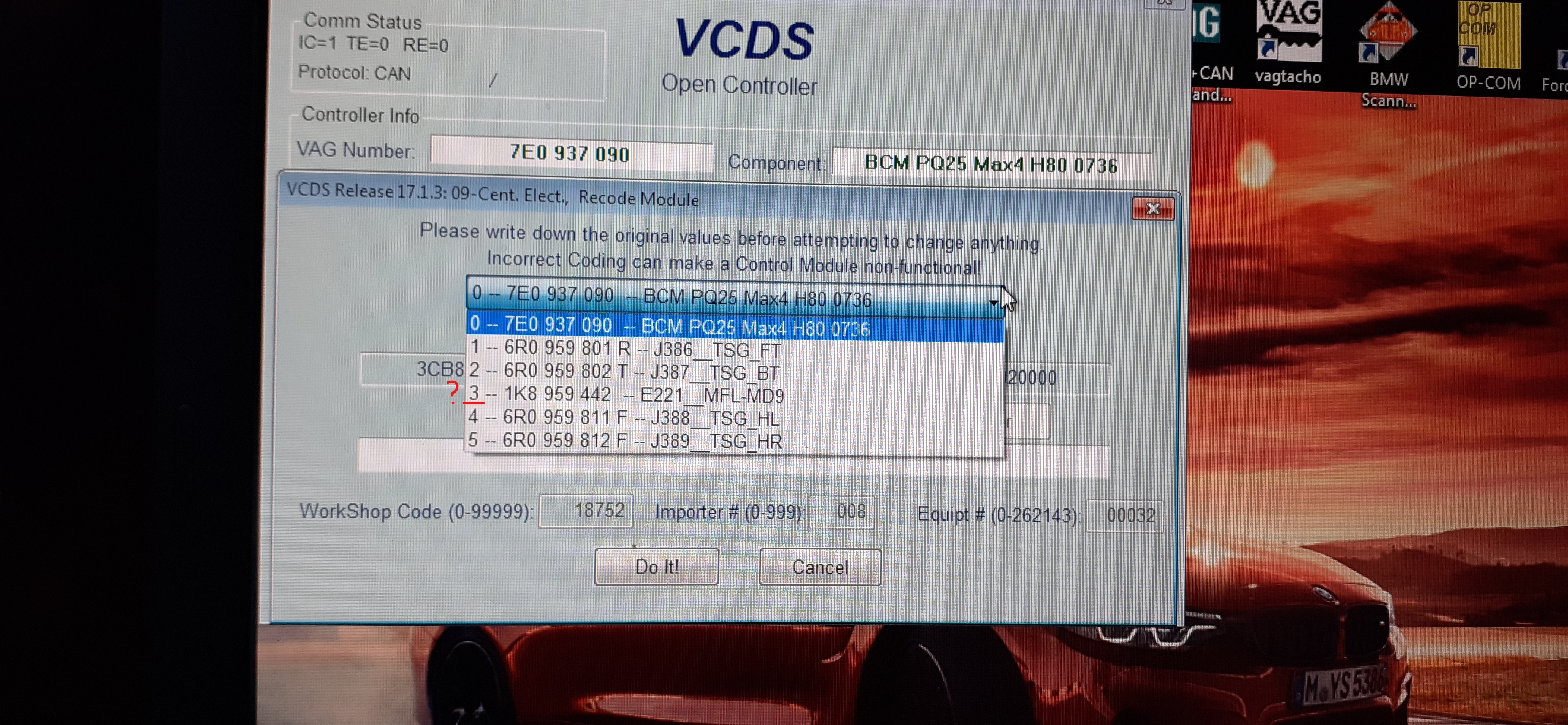

The problem is: that i don't see RLS in the drop box menu..
Is it this one:
Re: Reverse Lamp and Camera disappeared after BCM max Upgrade
No that is your MFL (Multi Funktion Lenkrad) = MFSW
The RLS is not in your first autoscan, correct? Is it installed correctly?

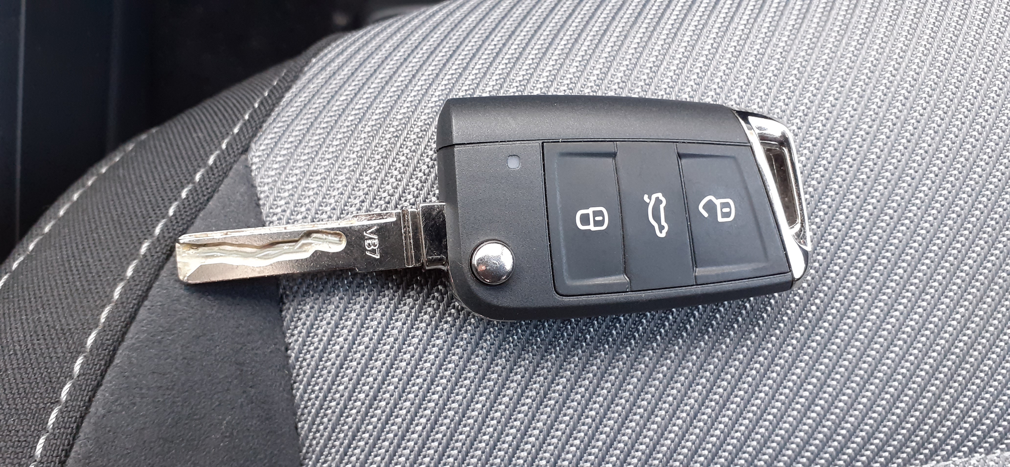

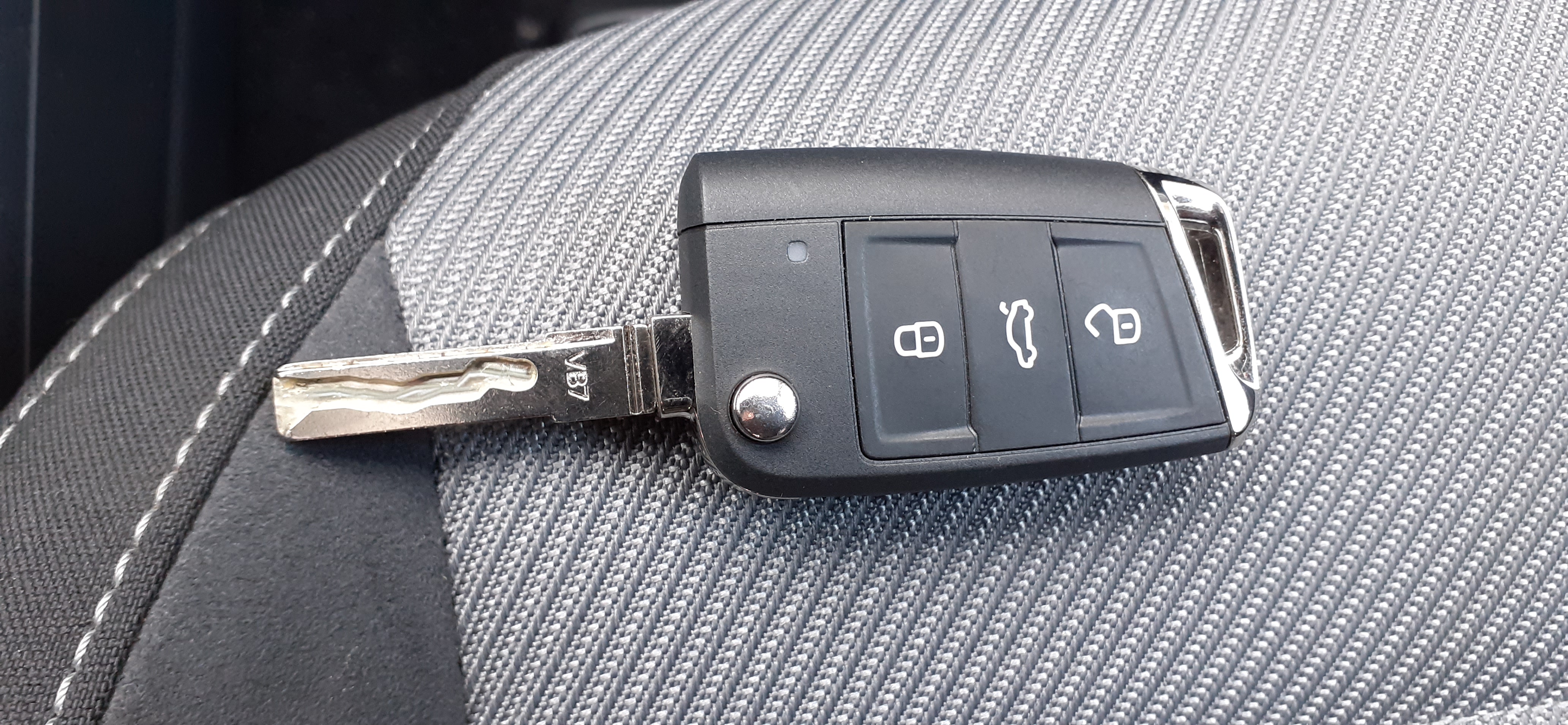

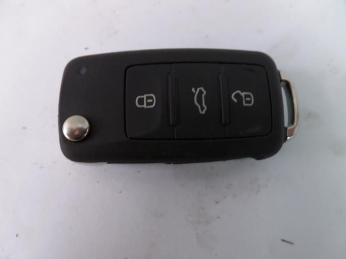

For Immobilizer fault: one of my key is broken. Already got 2 new (just have to learn them)

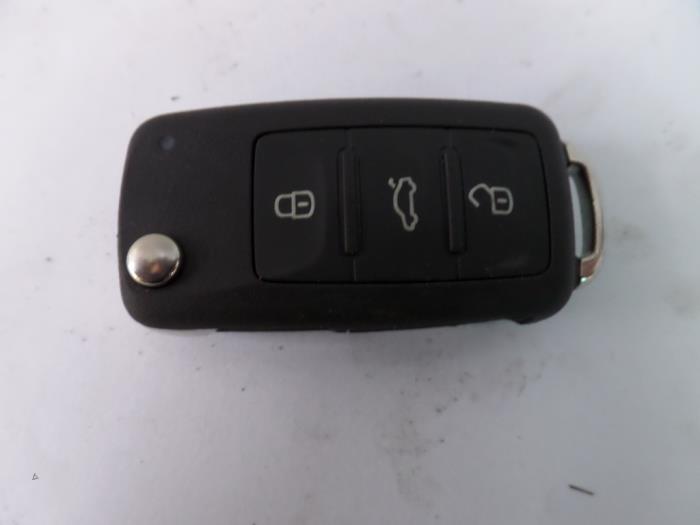

Till i am waiting for the new RLS, i try to fix problem with my key, and I bought one used remote key from Golf 7. The problem is that when i change the flip key blade with new one, that new one was terrible and the key couldn't unfold. So is there any OEM blades or some high quality aftermarket?
ag69
Posts: 436
Drives: 1.2TSi 77Kw 7DSG
Location: Earth
Post by ag69 »
Did your original keys are/were as same as this key fob?
ZahariGeorgiev
Posts: 118
Joined: Mon Dec 10, 2018 4:14 pm
Drives: Polo 6R 1.6 TDI
Location: Bulgaria
Post by ZahariGeorgiev »
Nope, they are not the same.
It is like this one:
