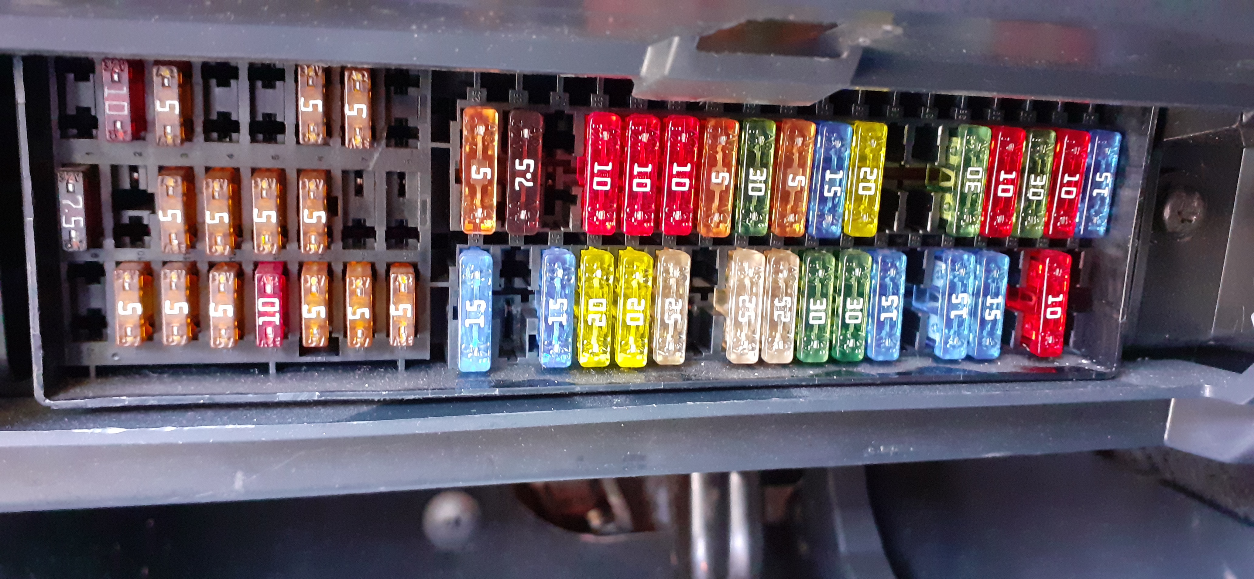

ZahariGeorgiev wrote: Thu Jan 23, 2020 6:28 pm i found this instructions:
https://drive.google.com/file/d/0B2nv91 ... k2Q1E/view
And to fix my problem (reverse light and camera) i have to complete wiring from picture WL0 and WL 2(already did WL 1 to fix illumination of instrument cluster) Is that right, or i should also do WL 3 wiring?
This installation guide is for a 6R RHD from India, your 6R is an LHD from Europe, so this installation guide is not applicable to your 6R under any circumstances.
Put in your mind that no two POLO 6R are alike in the world (this statement is not true, but each 6R has its own particularities), it's just for you to consider so that the installation you plan to do ends up being a total success in your 6R (B model year).
Please, post a picture of your fuse box under the steering wheel and I will tell you what installation guide you should use for you can build the BCM Max adaptation wiring and the wiring for automatic lights.
Due to some reason I don't know, I subscribe to this thread to answer the future questions.
Please, ask only one question in each post, do not take the opportunity to ask 1000 questions in each post :lol:,
I will try to answer each post individually.
Thank you.
ZahariGeorgiev
Posts: 118
Joined: Mon Dec 10, 2018 4:14 pm
Drives: Polo 6R 1.6 TDI
Location: Bulgaria
Re: Reverse Lamp and Camera disappeared after BCM max Upgrade
Post by ZahariGeorgiev »
Hello ciclo,
I am very grateful for your help!
Here is the picture of the fuse box:
Posts: 9037
Follow this installation guide for the manufacture and installation of wiring looms:
https://drive.google.com/file/d/1cXw67i ... sp=sharing
Download it.(PDF file)
I will provide you with BCM and RLS codings according to installations.
