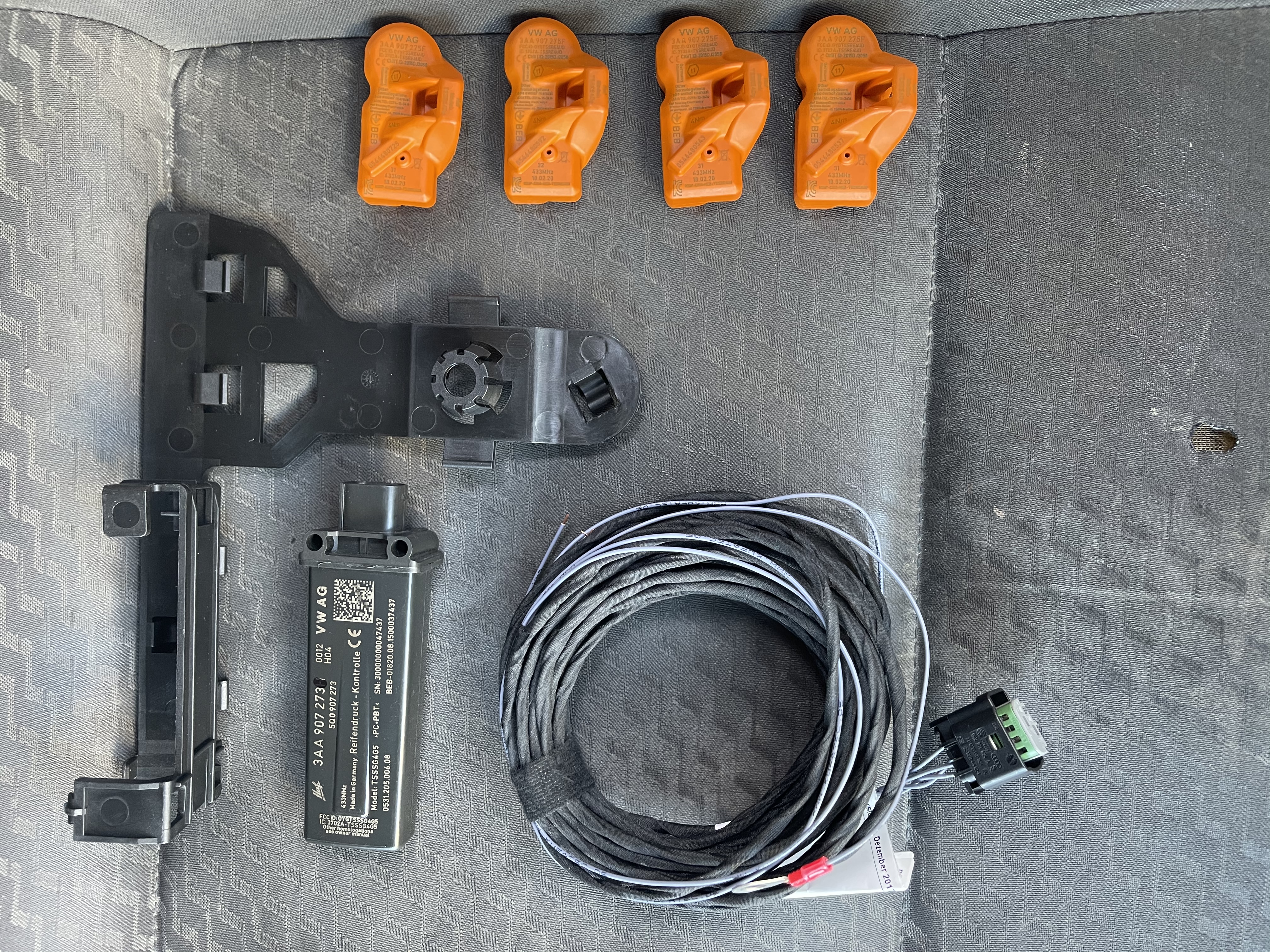

Finally, I’ve got all parts for TPMS
I have connected all wires :-
Canbus high/low
+30
Ground
My BCM version is H80, I didn’t find tire pressure in Can getaway installation list (address 65), I think I need another BCM with H81
Ciclo can you confirm ??

I have had all the 7E0 937 090 (434 Mhz) installed in my 6R (7E0 ... / B / C / D / E) and from 7E0937090 B you already have address 65 available in the GW installation list.
However, the availability of the 65 address is more dependent on the BCM manufacturing date than on the BCM reference, being possible that there are current BCMs Max without an index and have the 65 address available.
To be sure, get a C, D, or E.
Contact firegrafik to get a new one. :wink:

Shadow109 wrote: Fri Mar 19, 2021 4:26 pm Finally, I’ve got all parts for TPMS
Canbus high/low
+30
Ground
Hey, could you possibly confirm which canbus pins the TPMS needs connecting to for Transporter? Just to save me trawling through everything :D I plan to connect mine tomorrow assuming my foglights come to life.

@Shadow109 did you try your new TPMS unit on your existing H80 BCM?
I would expect it to work even though 65 is not present on CAN Gateway INSTALLATION LIST.
By the way you can get second hand 7E0937090 Max BCMs from Poland for approximately €60 :wink:

There are only two possible CAN BUS to connect RDKS in the PQ25, ... or in powertrain CAN lines, or in the new dashboard/instrument cluster CAN lines, in no case in the convenience CAN lines.
The recommended one, and according to diagramas for Amarok, is the powertrain CAN.
The cheapest way to get a good 7E0 937 090 BCM Max with the latest SW (E_0772) is to properly flash it with the proper file. Price = 0.

Yes, All the wires are connected, I have coded the TPMS in the Cluster, but nothing showed up
I have already ordered a new bcm, but thanks anyway

I have received the new bcm 8)
I have noticed that T73/b-63 Pinout is missing :!: :?:
I have coded it., (I didn't forget to code channel 54 for HBA)

Issues:-
HBA isn't working
new Instruments fault
TPMS didn't show anything on. the MFD
edit : I have noticed that the TPMS Controller (3AA 907 273 H) is ending with H Not F
Re: BCM Max Transporter 2013
Posted: Wed Mar 31, 2021 4:31 am
by ciclo
Have you coded BCM channel 53 also to '1'?
For Direct TPMS to work on PQ25 it must be:
Address 65: Tire Pressure (J502) Labels: 3AA-907-273.clb
Part No SW: 3AA 907 273 F HW: 5Q0 907 273
Component: RDKBERU30 H04 0011
'H' it is for other platforms, doesn't work for PQ25, ... accidentally tested. :)
You need to flash that TPMS unit with the correct firmware, ... then you must load the zdc file with the parameters of the tire pressures that you have chosen.
