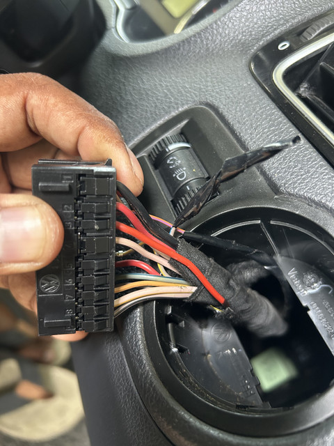

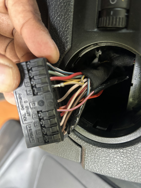

One quick query on the BCM max adaptation wiring.
For BCM max CAN lines has to be routed from BCM to IC -> T73B54 and T73B57
I already connected PDC CAN lines with IC lines - terminal 28, 29
Still should I isolate the original CAN lines? or should I tap?
- Posts: 8959
Re: Polo 6R 1.2 GT Tsi RHD
Connect the new CAN lines (wires) for the instrument cluster (IC<->BCM).
You must isolate any free contact terminals from the 'old' powertrain CAN lines/Inst Cluster, these lines are completely 'live' for other very important systems.
CAN powertrain wires are fine with PDC.
