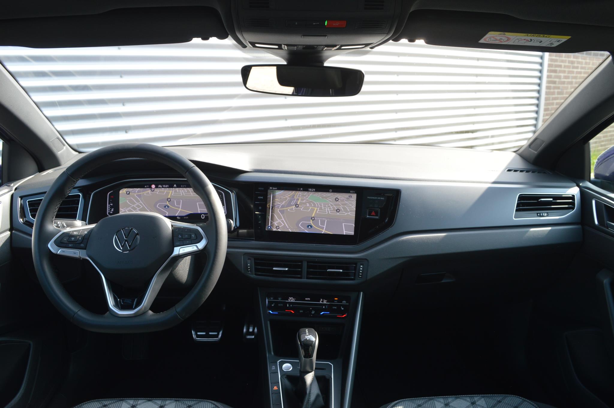

I've read only Discover Pro can display navi on both screens at the same time.
Not sure if correct.
In my polo R-line (MIB3) with Discover Pro it works
In our T-Cross with the Discover Media (MIB3)
It normally never does it, sometimes it does in a glitch, but after selecting radio or other it just displays compass

Maarten wrote: Tue Feb 28, 2023 7:27 pm I've read only Discover Pro can display navi on both screens at the same time.
Maarten, I absolutely agree with you.πŸ‘
I was playing around with adaptations of new MIB2.5 Discover media and momentarily I got maps on both AID as well as MIB. There is an adaptation to simultaneously display maps on both AID and MIB, once enabled it works only temporarily until next ignition. Sorry for confusing you or rather perplexing you and others.
The catch was in caption I wrote above the picture.😁

No no I was hoping you found a way for both screens with the Discover Media. :lol: 8)

patil wrote: Wed Mar 01, 2023 4:30 pm
Maarten wrote: Wed Mar 01, 2023 4:22 pm No no I was hoping you found a way for both screens with the Discover Media. :lol: 8)
Honestly speaking I thought I had a Eureka moment.. but the moment was short livedπŸ˜‚
Only pro can sadly. There's a way to show appconnect map on media unit and built-in nav on digital cluster.

When using e.g. Waze or other navi app the build-in navi will only display position with map on AID. the navigation itself will not play simultanious.
Tried it on my polo with Discover Pro. (of course I can display build-in navi on both screens, but that was not the question)
It is the one of the other

Maarten wrote: Wed Mar 01, 2023 8:19 pm When using e.g. Waze or other navi app the build-in navi will only display position with map on AID. the navigation itself will not play simultanious.
Mib3 can't, mib2 has been hacked to bits in that regard

Post by Maarten »
My polo my 2022 has the MIB3 with Discover Pro.
So I can display both.
Just be as confusing to hear both navi voice say something slightly different.
