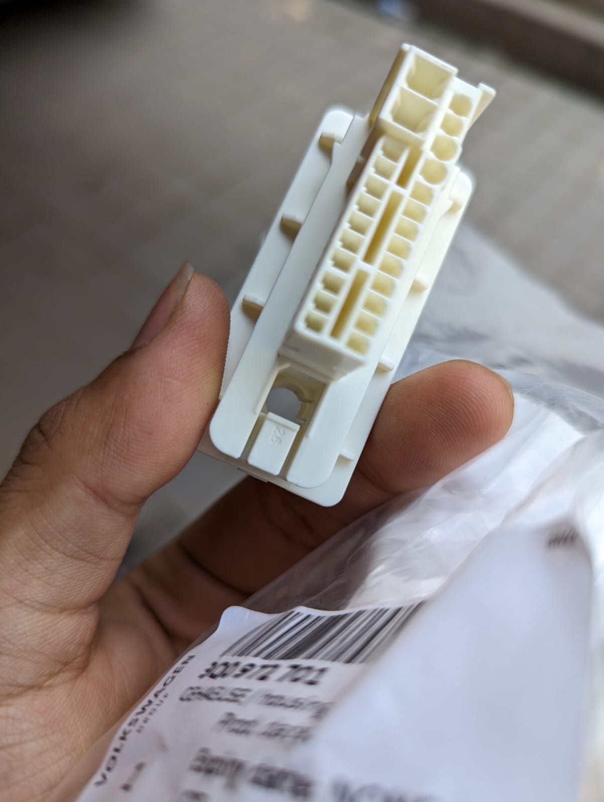

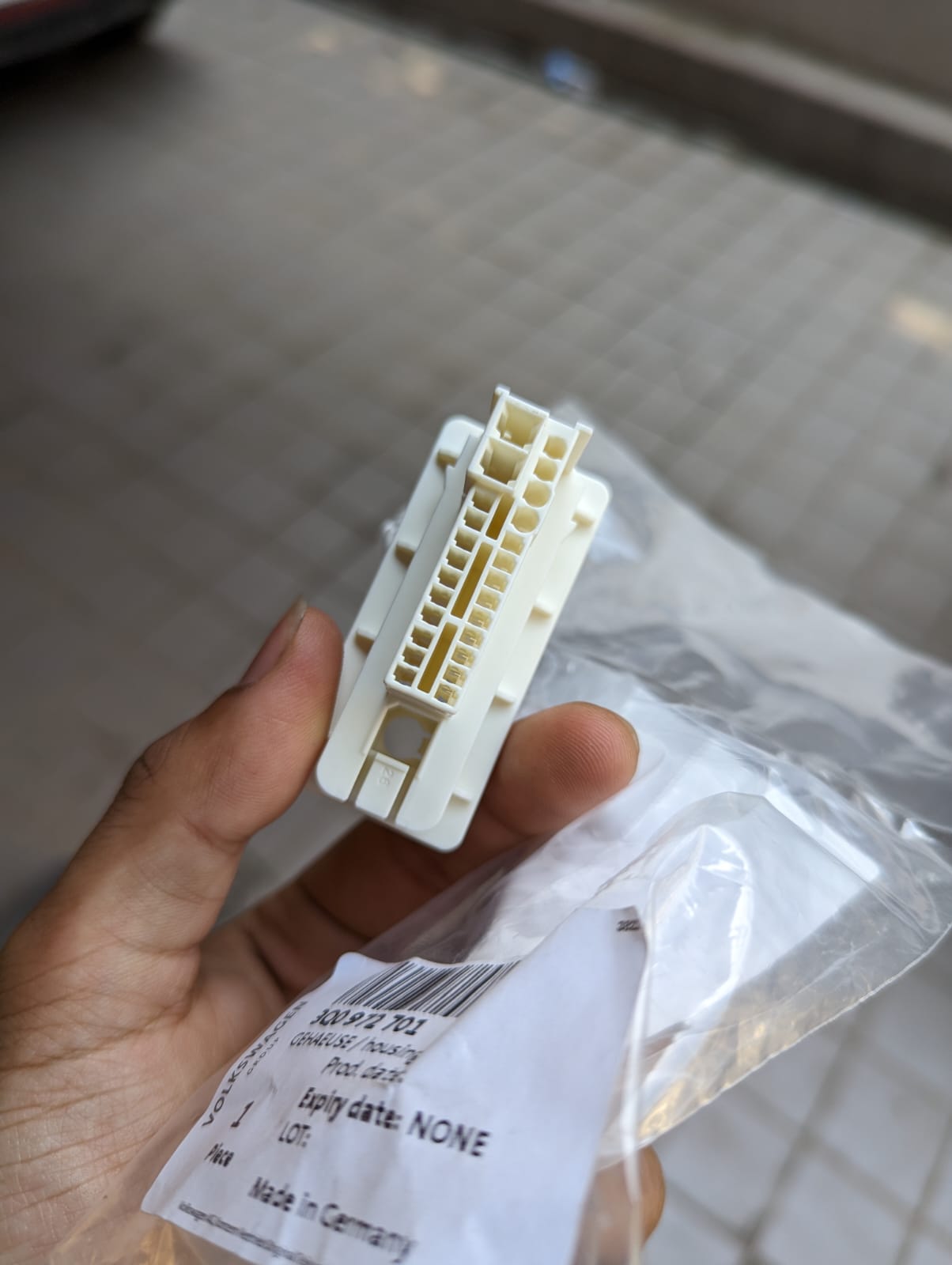

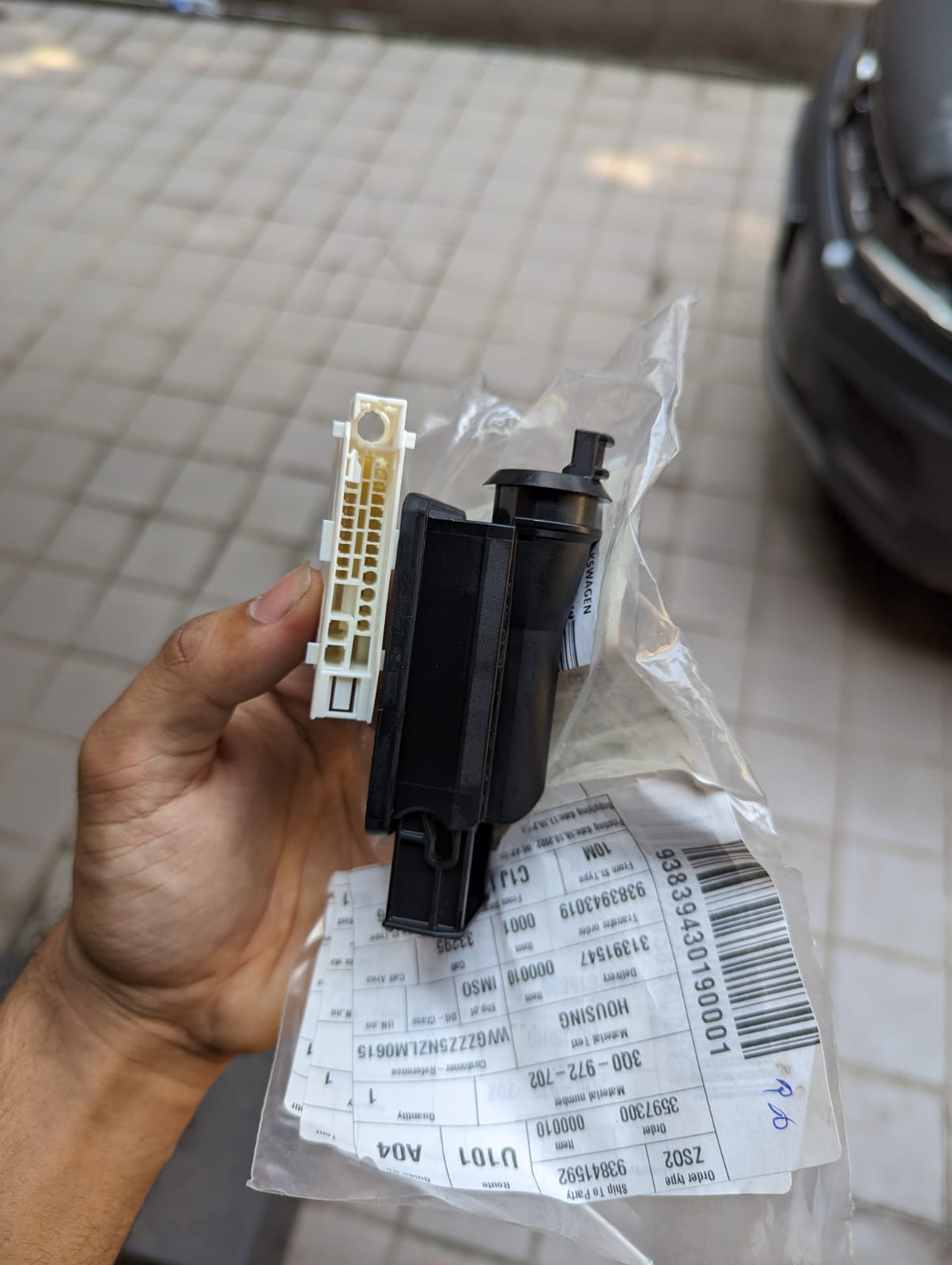

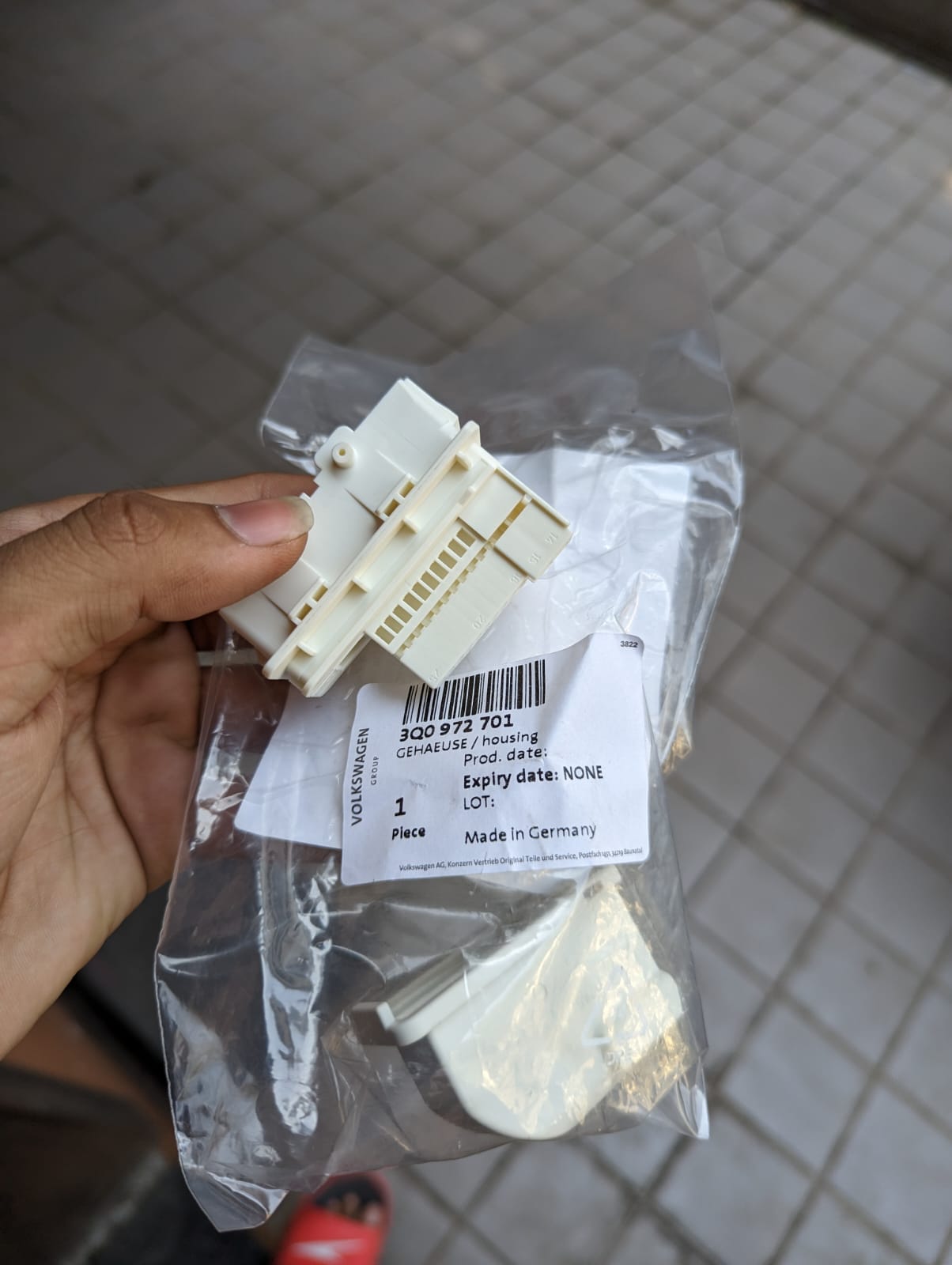

iichel wrote: Sun Apr 23, 2023 2:53 pm So, allow me to do share a nice retrofit, the 360 Area View / Overhead View camera.
- 1x Camera module 5Q0 907 556x
- 4x camera 5Q0980546A
- 2x bracket for mirror camera's 3G0857689
- 1x foam for below right seat 3G0907285, to mount the module
- 1x 3G0927132J (or without PLA another module) buttons in dash
- Wiring looms for module and video feed cables to all four camera's
- 2x 8R0972702 and 2x 8R0972701 connectors for door wiring loom in A pillar
- Remove the door panel and lead the cable to the A pillar connector. I opted not to change the 27-pin connectors to 8R0972702/701 but use MCON in the four available holes
- To connect the module to the car, I took the original +30 cable in the right hand side sill and spliced into it. There, the wire to the RVC compact is already present.
Thanks for sharing your experiences with the 360 Camera Retrofit. Are there are advantages opting for the MCON crimps, compared to the LVDS cable in the door connector? Do your wires experience a bend closer to the door connectors? This was a reason, I thought I need to find a 90 degree wire for the door connectors, suitable enough for the door connector. I have collected nearly all the parts for installing this on my father's Tiguan and I purchased 3Q0972701 and 3Q0972701 for the A-pillar door connectors. I tried searching for the patch wires that connects the Door to the Mirrors and Module to the Doors, but couldn't find it listed separately. Could you please help me find what type of connector will fit? I am attaching pictures of the door connector I bought. I already anticipate that this could be a painful task to translate all of these existing wires to the new connector. :?

Yeah, I mostly couldn't be bothered with re-pinning all these pins on the door connector and it was a real pain to source the exact correct wires and cables. So I took the easy way.
