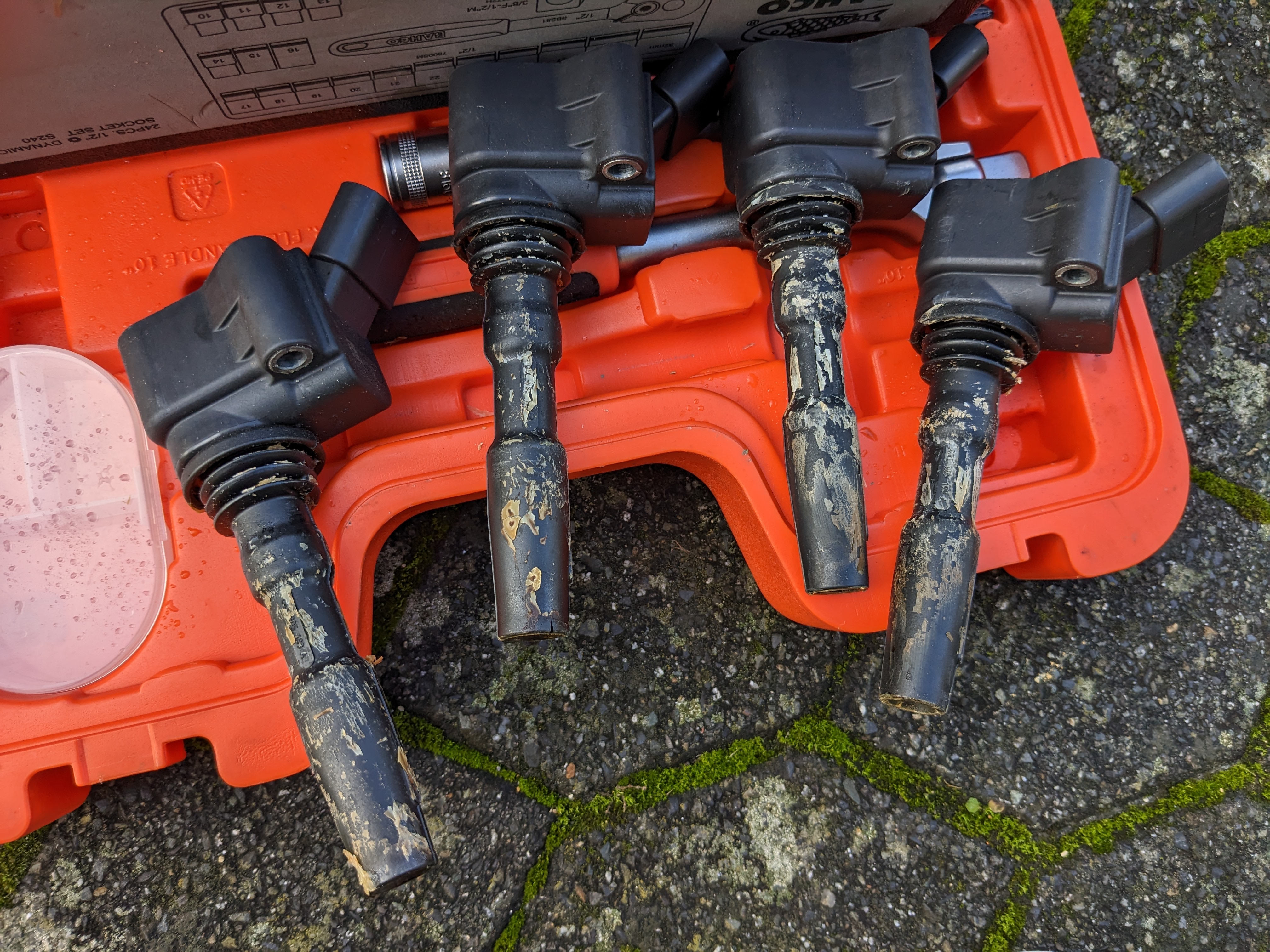

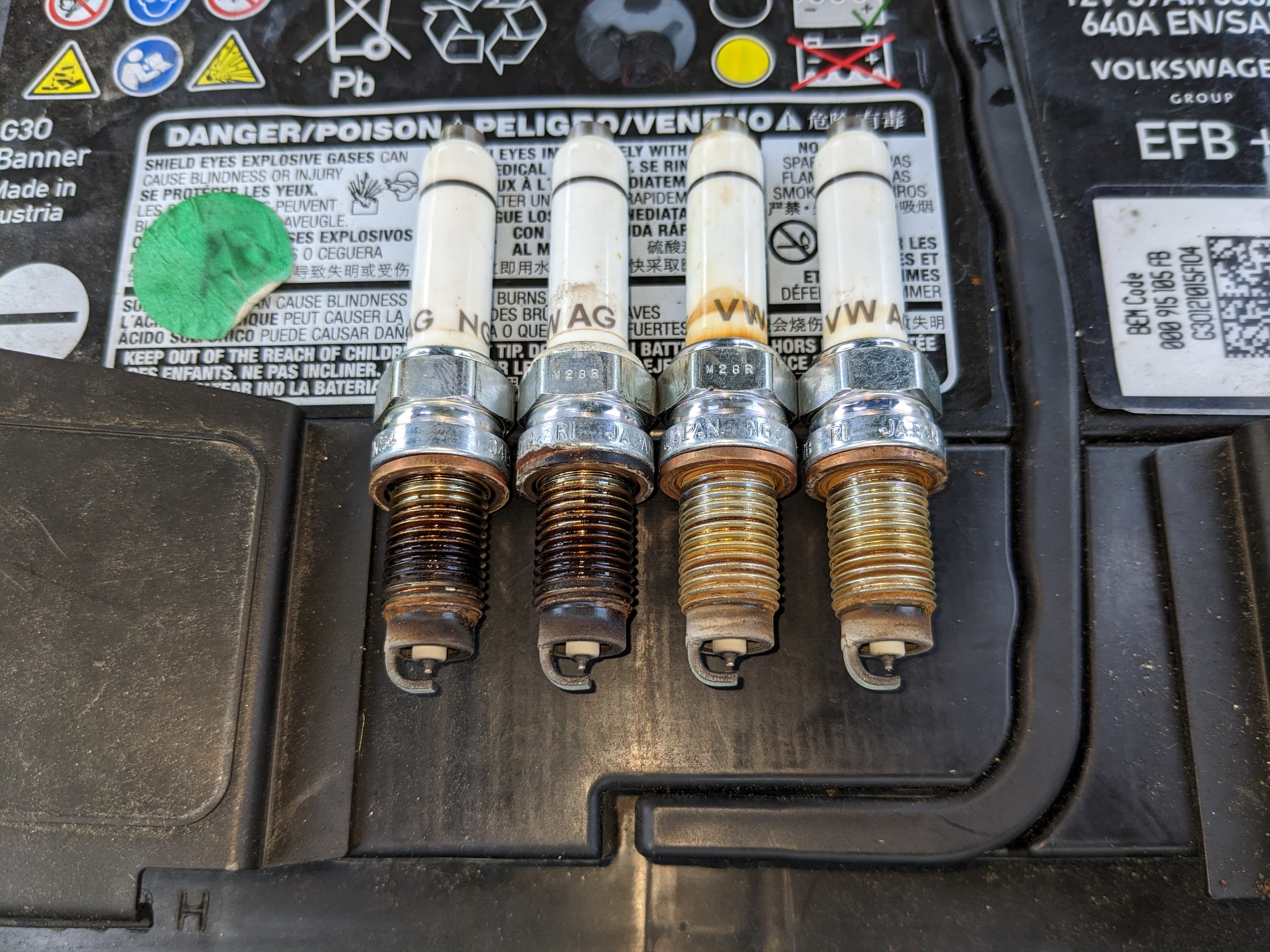

Today I change my spark plug.
Looks good but on cylinder 3 and 4, oil residus are present on the thread.
Last time they were changed by VW and those idiots put like a grease that completly dry around my coil igniter.
A terrible mess.
A terrible mess.
What the hell did they put on there? Usually the grease goes inside the boot. They use mud? :D
Weird how my engine had clean threads, no oil on them, yet I churn through oil.
At least it looks like it is burning the oil and not fouling the plugs.
I know oil on threads could sometimes indicate valve cover gasket issues; but those 2 plugs do look like they've seen some oil in the chamber. No heavy scale as on my plugs though.

2226 wrote: Sat Nov 04, 2023 5:51 pm You can use a silicone paste instead of the Permatex. Either will do. I used a generic silicone paste that I also use for brakes.
I take this statement back. Maybe don't use silicone paste:
I have a white powdery deposit around the base of the plugs now. Can only be the paste that's dried out.
This plug is only few months old.
Pulled a few minutes ago as my OBDEleven is reporting 30K+ misfires yet no misfires noticed.
