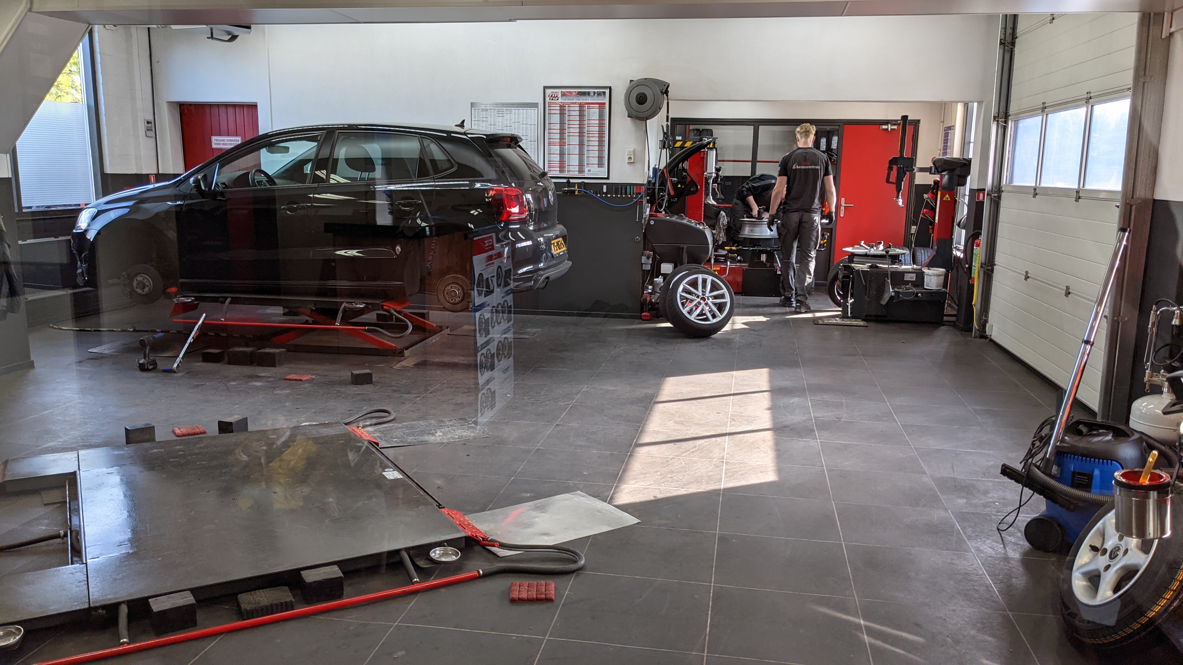

Today my new Mirabeau wheels received their TPMS sensors too. Great thanks to my local tire service company. They always help me well with alignment and tire changes.

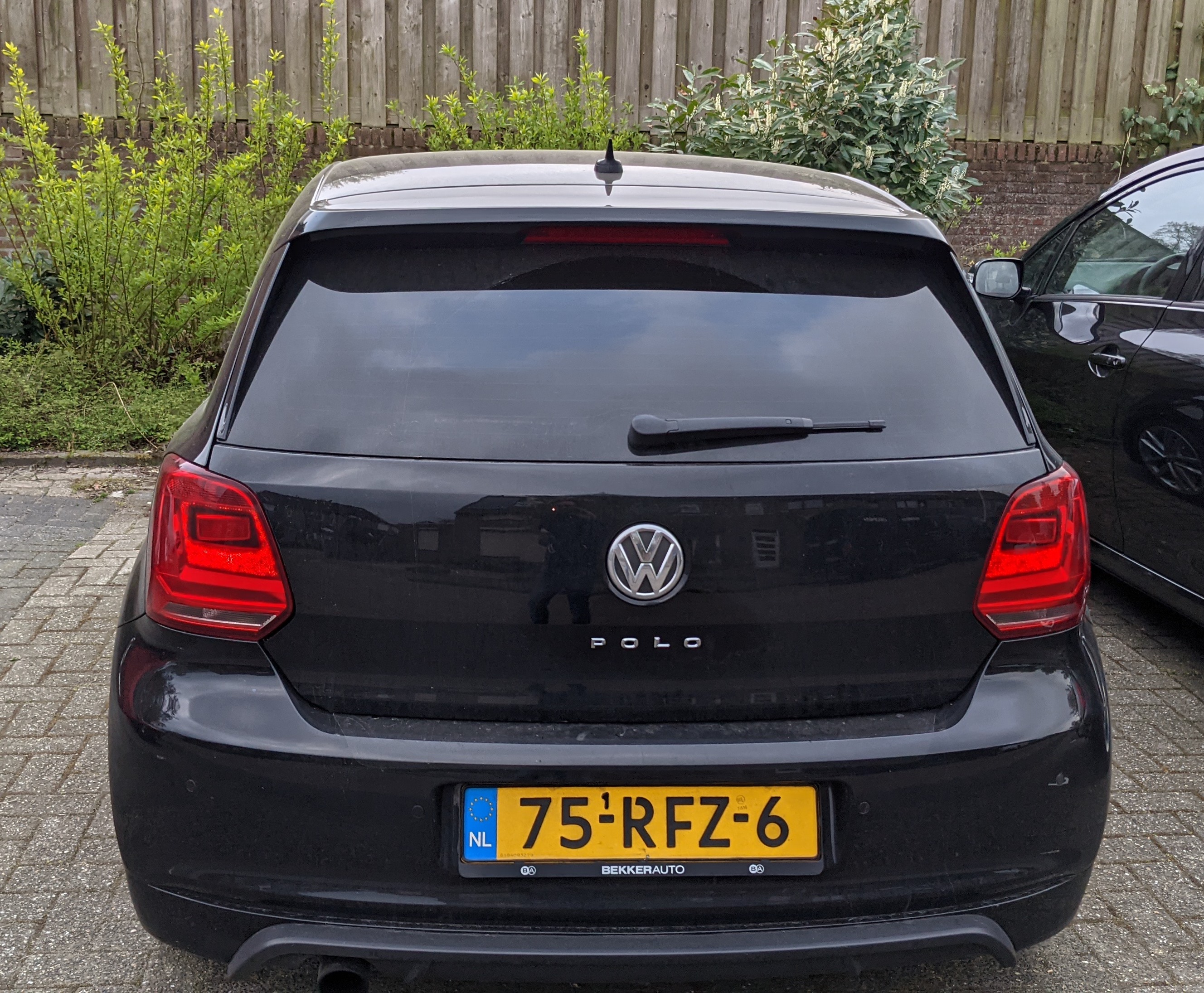

Rear Polo AW 'Polo' text --> 6N5853687 2ZZ
2021-04-29 09.15.46.jpg (1.78 MiB) Viewed 4548 times

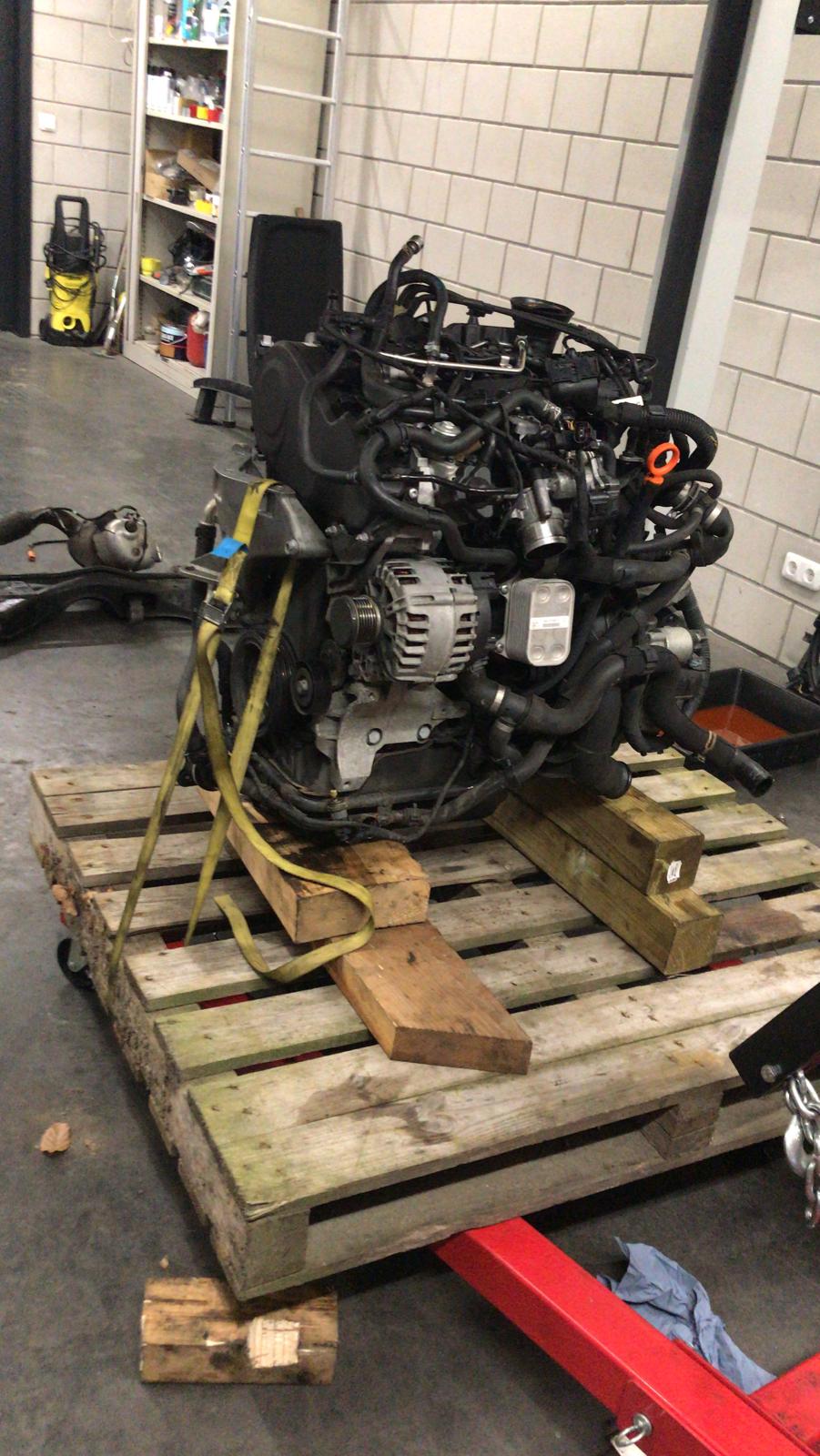

Re: iichels Polo 6R 1.2TDI Bluemotion --> OEM++ R-Line conversion
1.2 TDI engine :)
