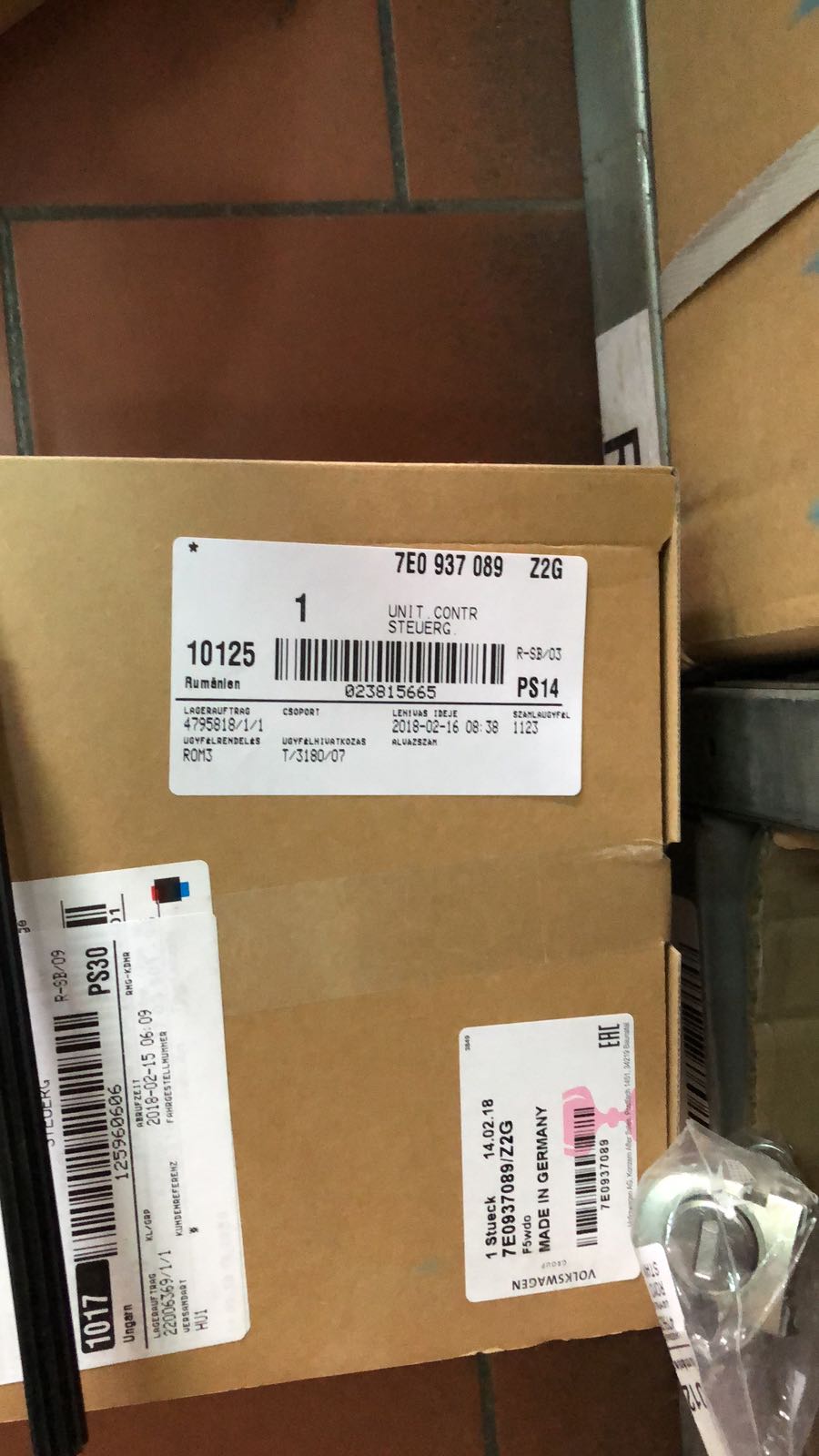

I have the BCM. In the weekend I will make the wiring. I buyed two Bcm connectors with wires from a dismantled Polo to have the appropriate pins.

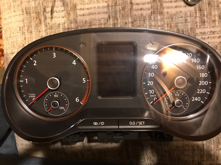

I had the feeling of brand new car when I changed my old original instrument cluster to one with MFA +.
It's a nice upgrade.
There are several of them for sale in the forum sales section.
