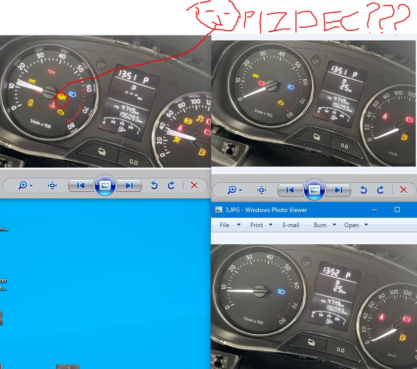

Hello, it seems to me that this lamp has already flashed before and returning to previous codes helped to make it disappear.
I'll check today if it's only caused by the last coding.
Update
Ok I double check, if i back to Fourth test code, blue lamp disappears.
6C980F2000210400000808303E4B0CC00F40730F600338C0060000164800
Two tests with this BCM coding; You must test it with the BCM 54 channel at 0, and then with 1.
It works all the time with this code but only if i turn light switch. On zero it not working, drl work, no lo no hi at all with Fourth test code :!:
As soon as I change the code to last one, blue indicator turns on immediately :!: Yes it working strange rondom as on previous video and I don't know what to add
Work now no winks
https://youtube.com/shorts/96DiPWvsbQ8?feature=share
but sometimes it flashes when driving or goes out ,I try to catch the moment when driving when it starts to flash or go out , but as I mentioned it work randomly
there is a feeling that it depends on the steering wheel and on the speed sometimes
this is what I may have damaged?
https://www.youtube.com/watch?v=LfK3KTID_KU
but why no errors
I don't remember if it was before.or that shows every test before ignition on?

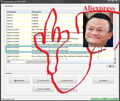

In other models (MQB, etc) the parking lights of the LED modules can be Adapted with the same brightness as the DRL/TFL, and in my humble opinion the car headlights look more beautiful/brighter... so I wouldn't worry too much if you can't find that lower brightness for your parking lights

Alex
this can be done, but it is fraught with the fact that at full brightness in the dark, the cilia can really dazzle, since they do not have a cut-off line and shine in all directions, for this purpose, the dimming of their brightness was invented when the head lighting is turned on
Anyway i try to bust that tomorrow.

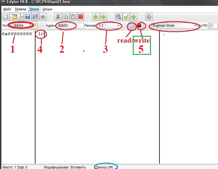

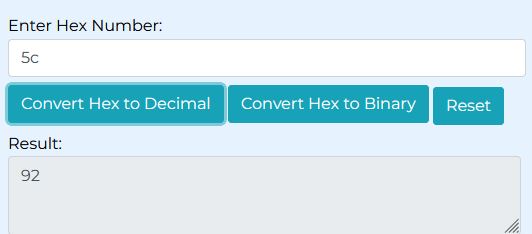

Alex, if the value is converted from hexadecimal format (HEX) to decimal, it will essentially be a percentage)
But i dont know how many % brightness drl now, 100? The tfl as i understand 28%, if i convert 1c hex to decimal=28%. I try change 1c to 5c=92
i also want make left led 10% less bright because right have defect :oops: i dont know if that possible :roll:

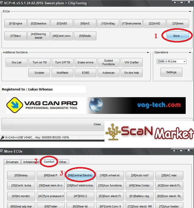

It may also be possible to edit the operating values for the turn signals, have you looked at the adaptation channels with the/'your' VCP editor for BCM PQ25?
if you talk about first method for light adaptation , i didn't access to it :oops: vcp aliexpress 8)
if it is in another meny then I will try to get through there if possible

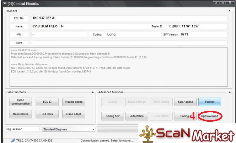

To have access to the first method that you say for lighting adaptation, the language setting of the VCP program must be in English.
Here you have a video of how to access and modify the values in a BCM PQ25. https://www.youtube.com/watch?v=16zeMCk_Ipg

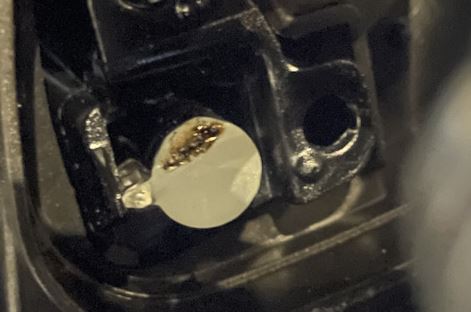

As I told you, it would be difficult to know the exact operating values or percentages of the DRL and Parking lights of those bi-xenon headlights, unless someone has published the adaptation channels of their BCM Pq26 somewhere (which I searched for, but impossible to find).
Maybe you should put a percentage of 28% for Parking lights and 50% for DRLs, it is clear that this module that you show has been subjected to high temperatures.🤷‍♂️
Finally, the turn signals appear to be built into the same LED module as the DRL and Parking lights in those Bixenon headlights, but the BCM PQ25 needs an operating value that doesn't consider it as a fault (open circuit or short to ground).
