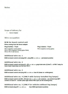

Add only the wires from lights adaptor (Kufatec) to BCM module under supplier instruction. :( :(

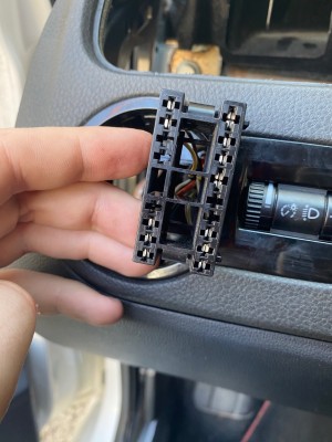

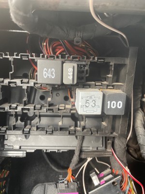

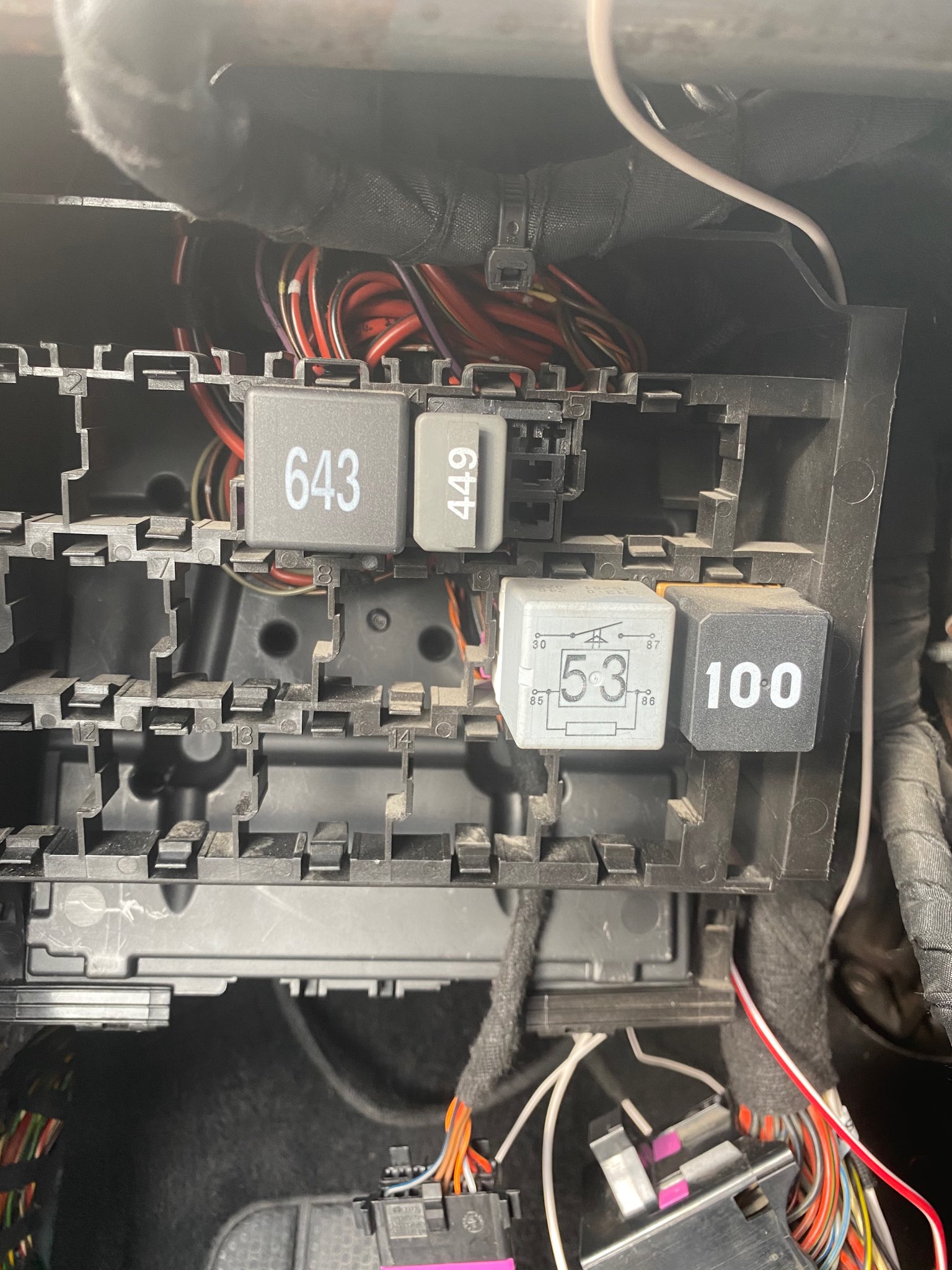

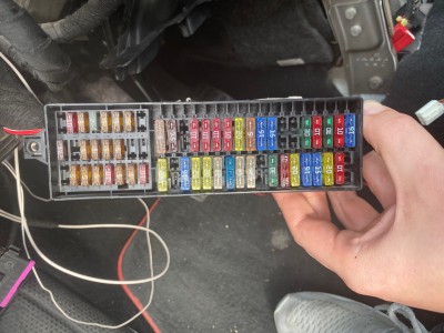

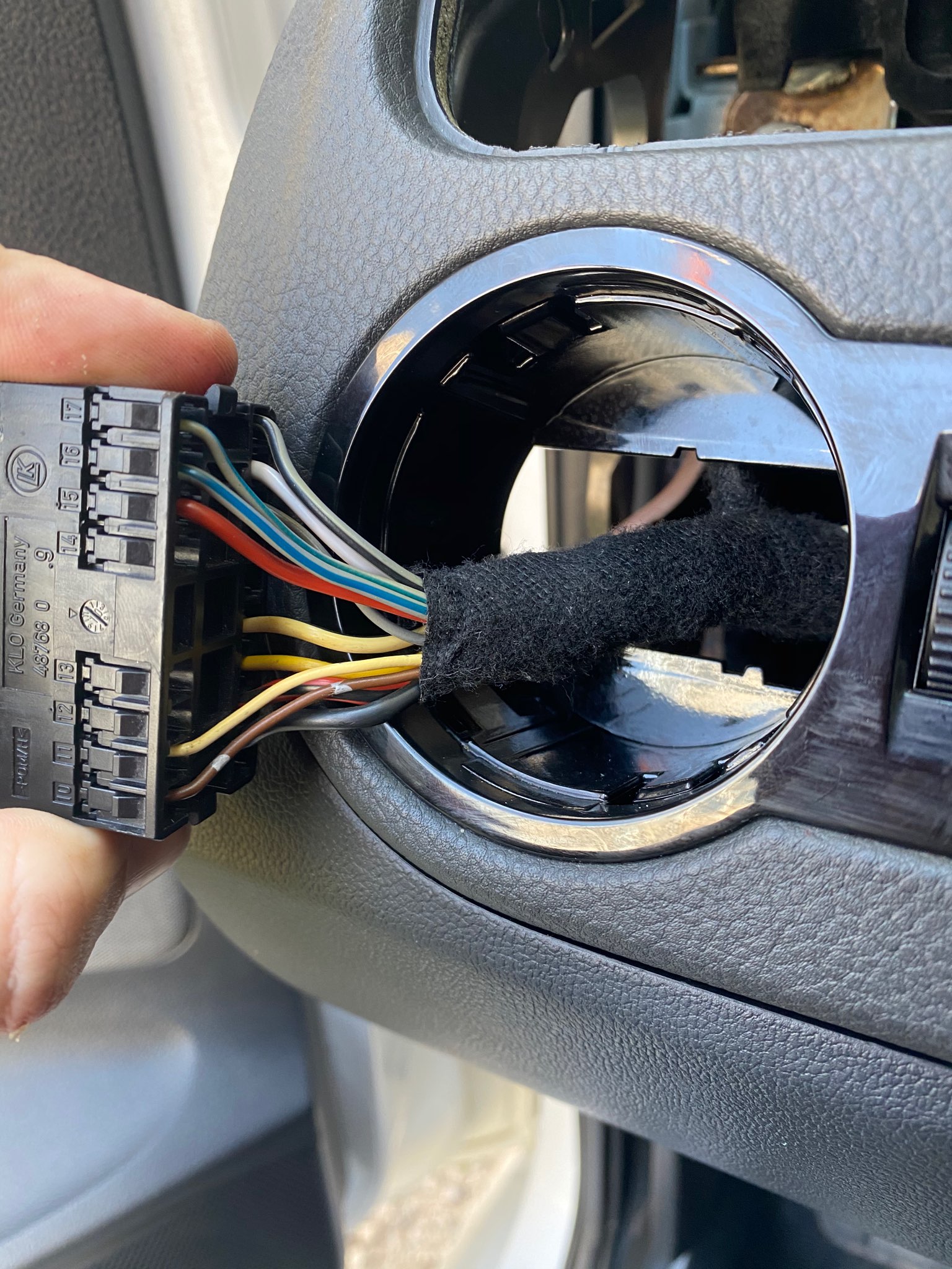

OK well then I have an idea about what went wrong. You need to do a BCM Max wiring/adaptation:
- Wiring from light switch to BCM
- Wiring from fuse box to BCM
- Wiring from BCM to external lights via fuse box
- Adjust coding/adaptations accordingly

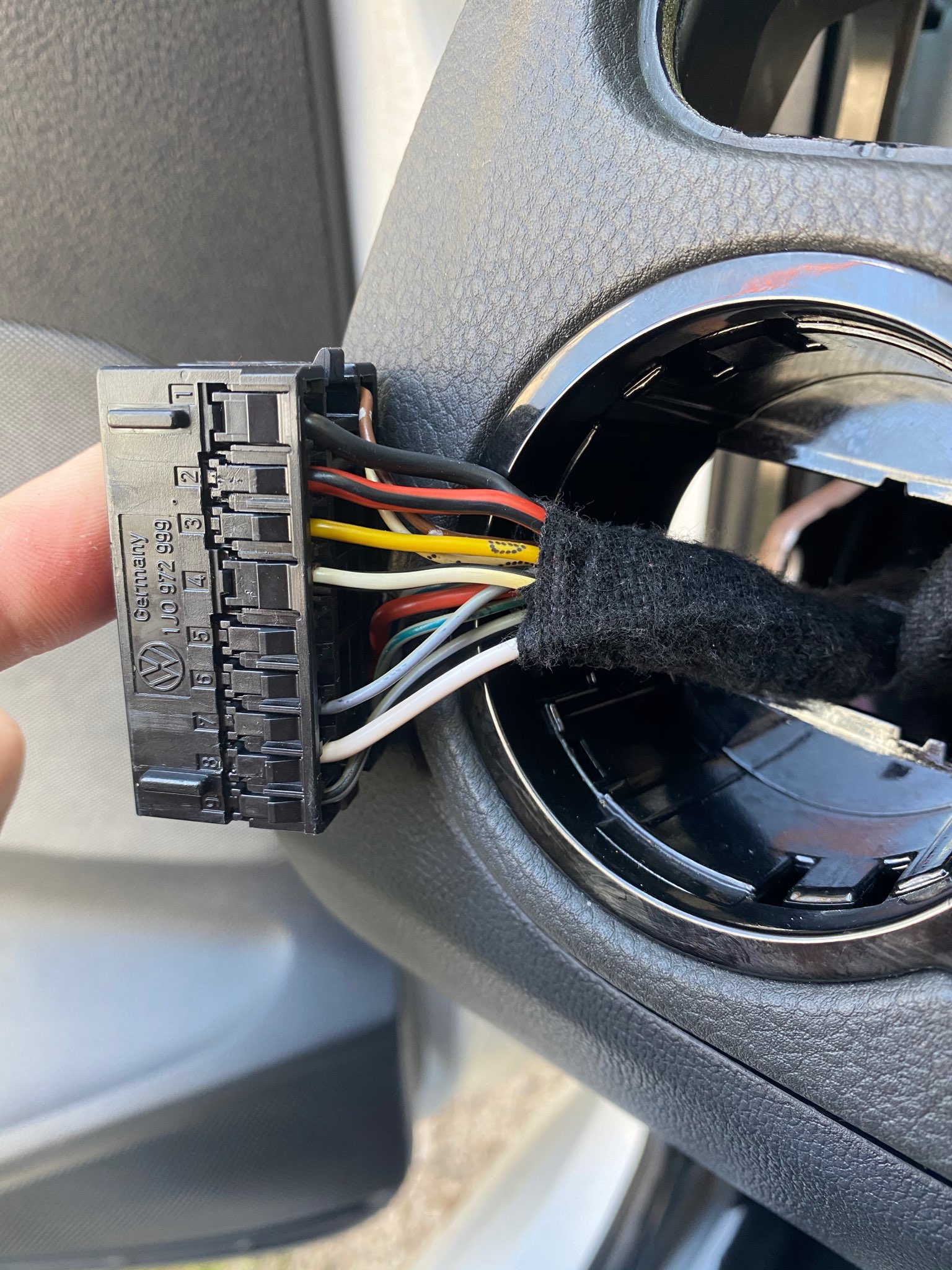

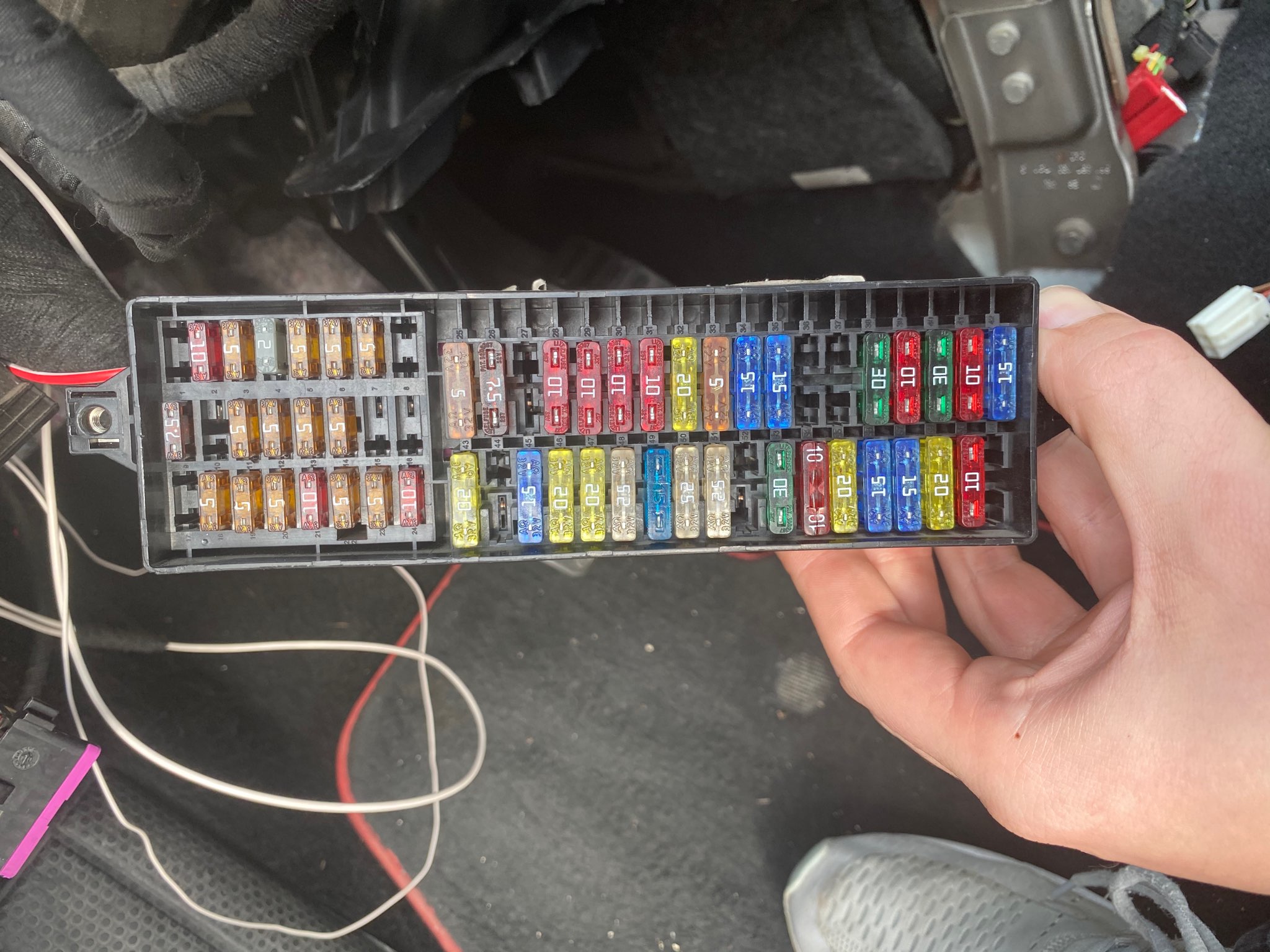

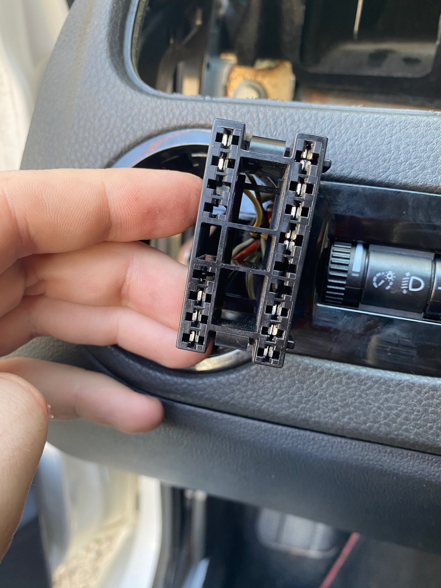

The following you may find the Light Swicht photo, fuse box imaze and ralay photo.

Fuse box imaze and relay image.

The following image is the installation guide of the xenon harness from supplier. Only these wires added to the BCM, the Light Switch and fuse box.
