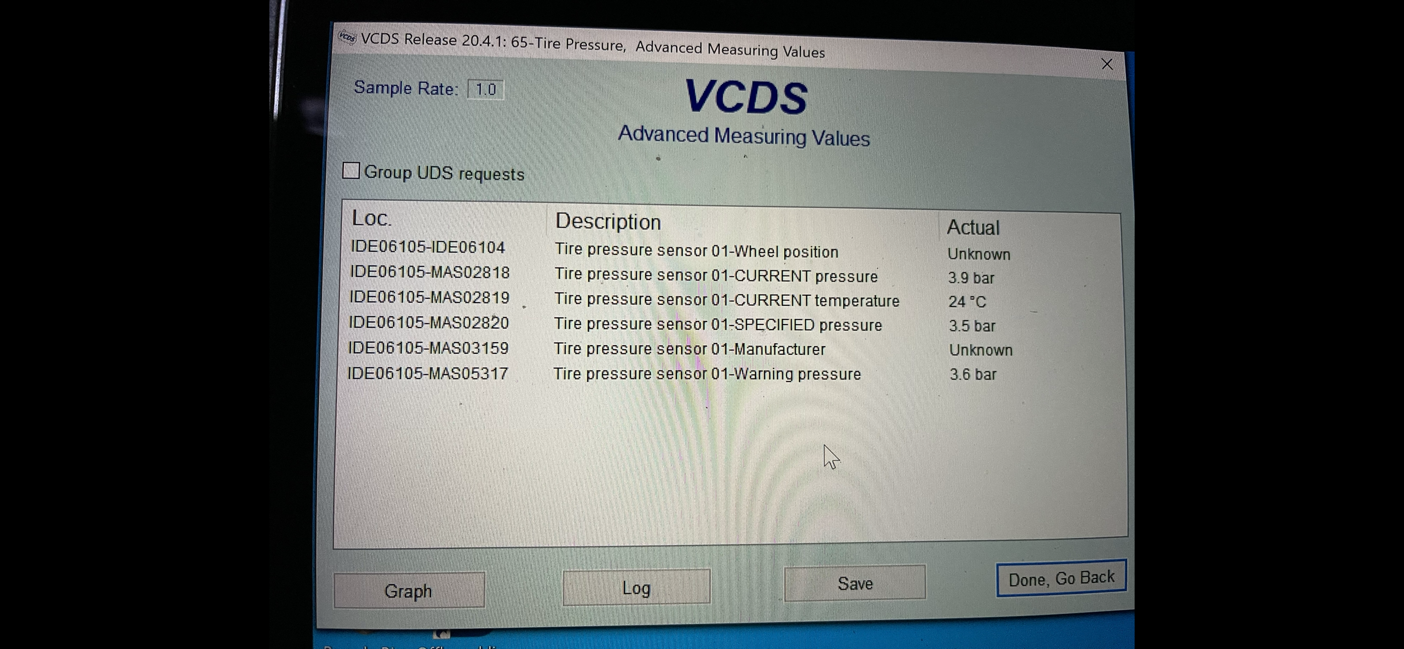

From the information you've provided, it looks like the tpms module is unable to determine the wheel position in which sensors is present.
Where have you placed the tpms module?
In advanced measuring values of address 65, the sensor location should be displayed, see mine below.

patil wrote: Thu Apr 15, 2021 3:51 am Hello shadow109
Thanks so much for the info
I guess I will try different place for the sensor

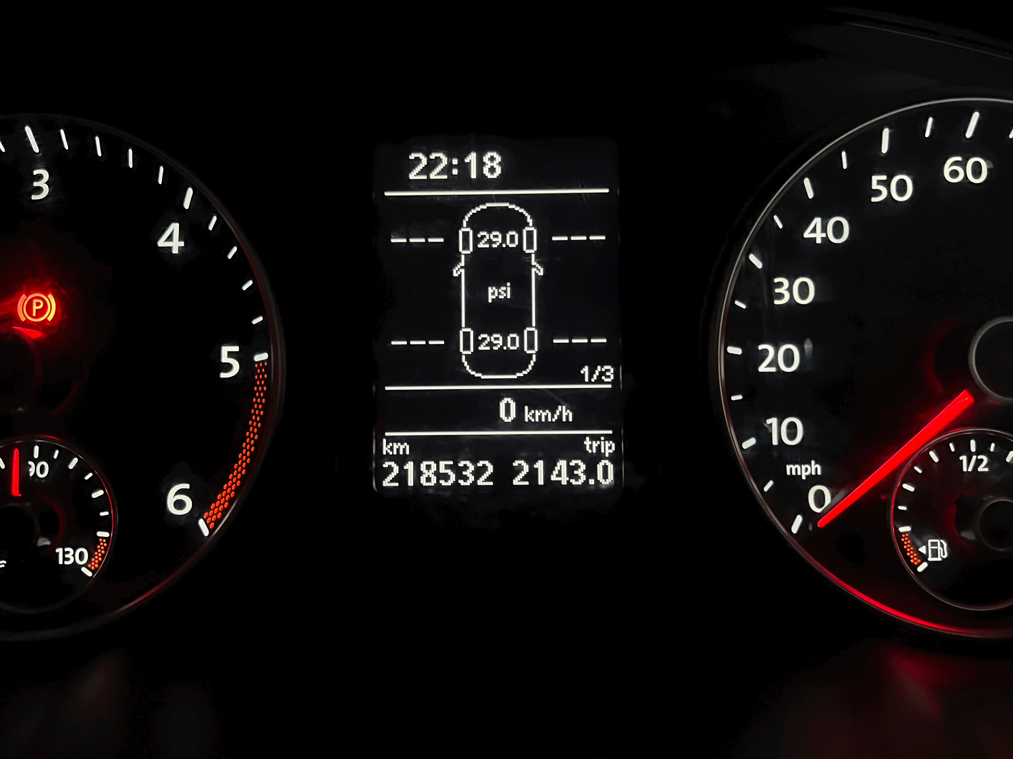

No menu will be displayed until you load the wheel pressure parameters into the TPMS unit (VCP or ODIS).
It could be for another reason, but this reason is the usual ...
