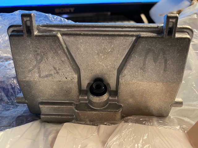

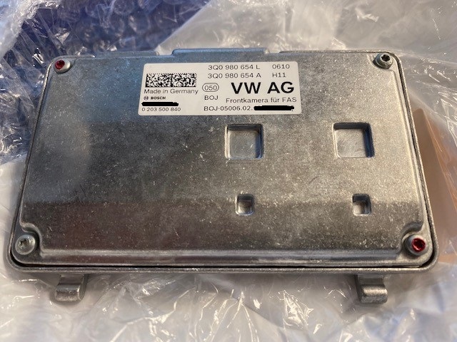

Now it is the time for the replacement of front camera 3Q0980654H series to the L series begins.
The first question I have is how to remove the current camera from its current location, and if the battery connection should be removed ?
When the camera is changed then it will be time to parameterize the camera with OdisE because it comes from a TRoc with 17 Kms.
The next thing will be to put the current long coding but adding a last pair of 00 to the byte string.
Then comes the calibration with the VAS 6340.
From Stock Golf 7.5 to….

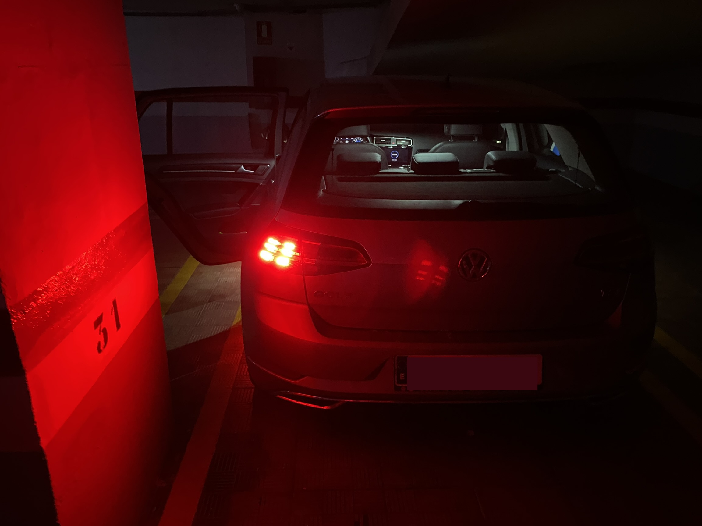

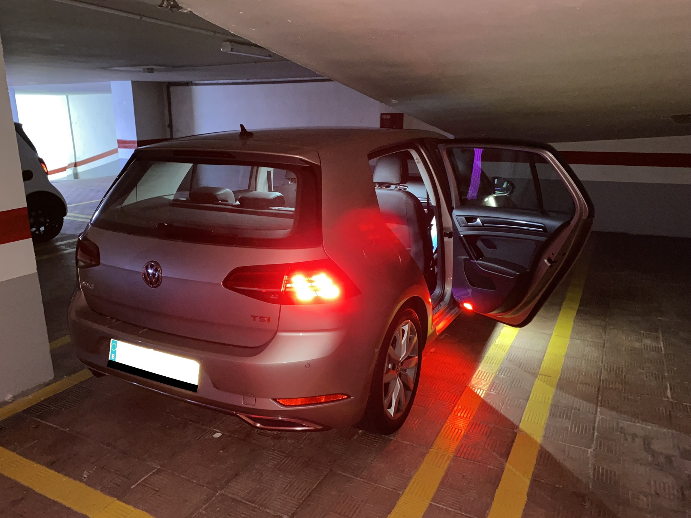

Continuing with the modification of the warning lights doors, I have found a coding that I find interesting in terms of safety.
It tries to turn on the rear brake light when the door on that side is opened.
The modification is made in the adaptations of the 09 Bcm. The channels to be adapted are Leuchte20BR LA71 and Leuchte21BR RC8.
We select Lichtfunktion B20 in this channel and introduce a value to choose between:
For the Leuchte20BR LA71.
-Tuerausstiegslicht hinten links (only rear door)
-Tuerausstiegslicht vorne links (only front door)
-Tuerausstiegslicht links (front and rear door)
We select Lichtfunktion B21 in this channel and introduce a value to choose between:
For the Leuchte21BR RC8.
-Tuerausstiegslicht hinten rechts (only rear door)
-Tuerausstiegslicht vorne rechts (only front door)
-Tuerausstiegslicht rechts (front and rear door)
And this is the final result….
