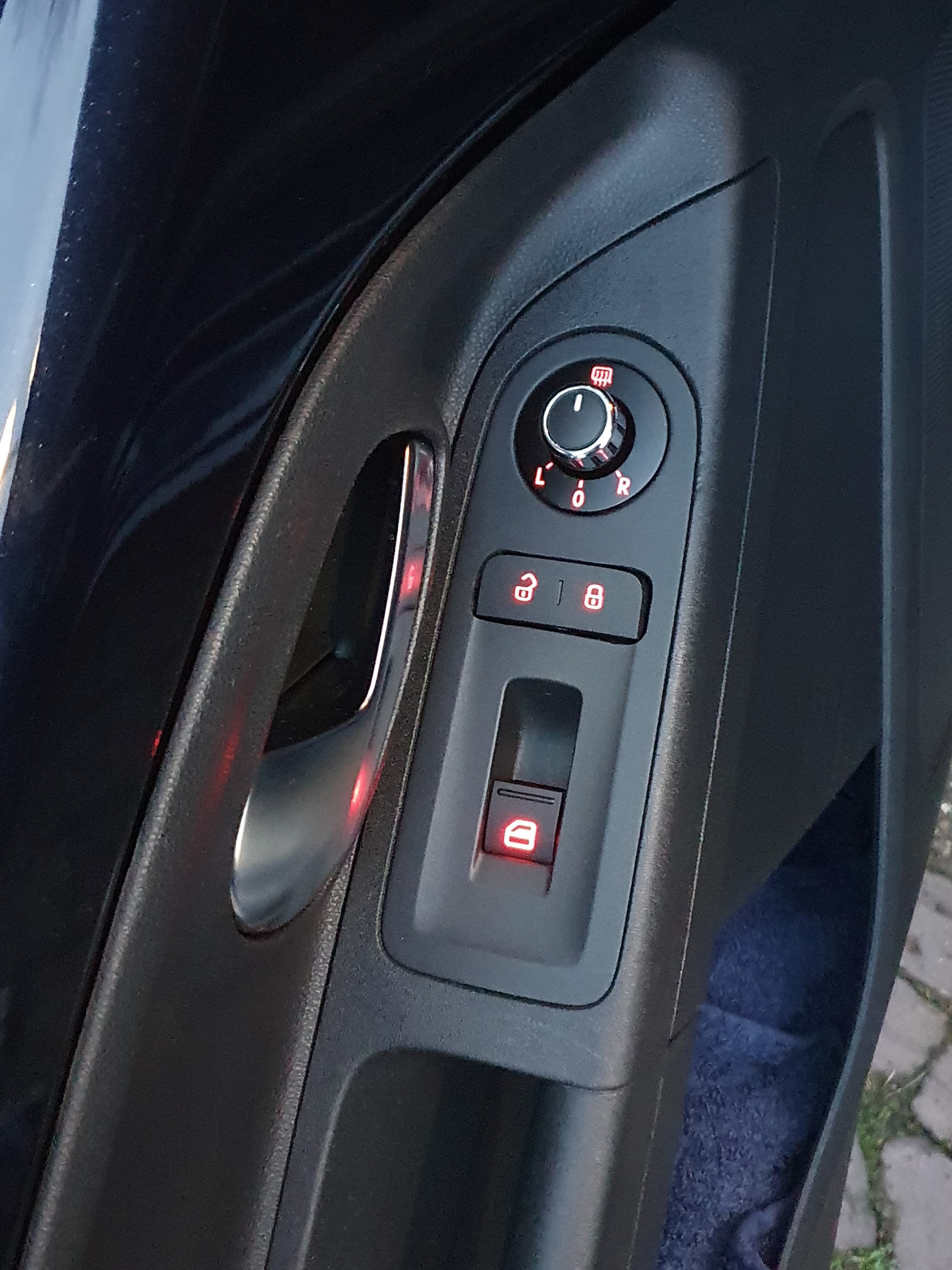

I also put in some illuminted window switches without chrome. Still waiting on China :(
Regards,
Bonny

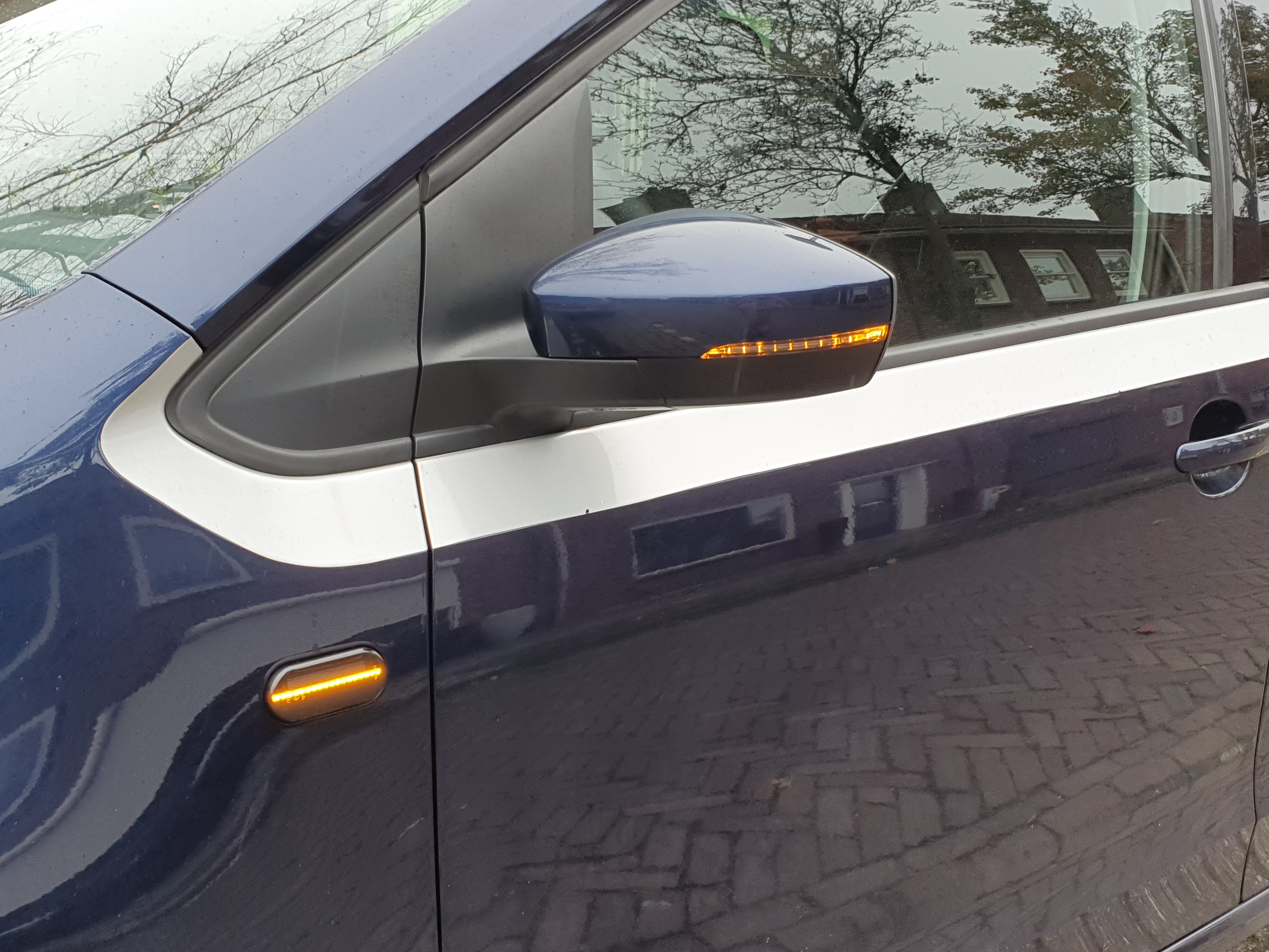

Today I replaced the existing T73b/11 fog+drl power input with a new wire.
I used a bridge in relay J33 to get permanent 12v (+30) and routed it to fuse SC50 (20A) and from there to T73b/11.
So now I'm ready to reconnect the DRLS directly to the BCM, hopefully soon...
Here's a picture of the new side mirrors with integrated turn flasher:
